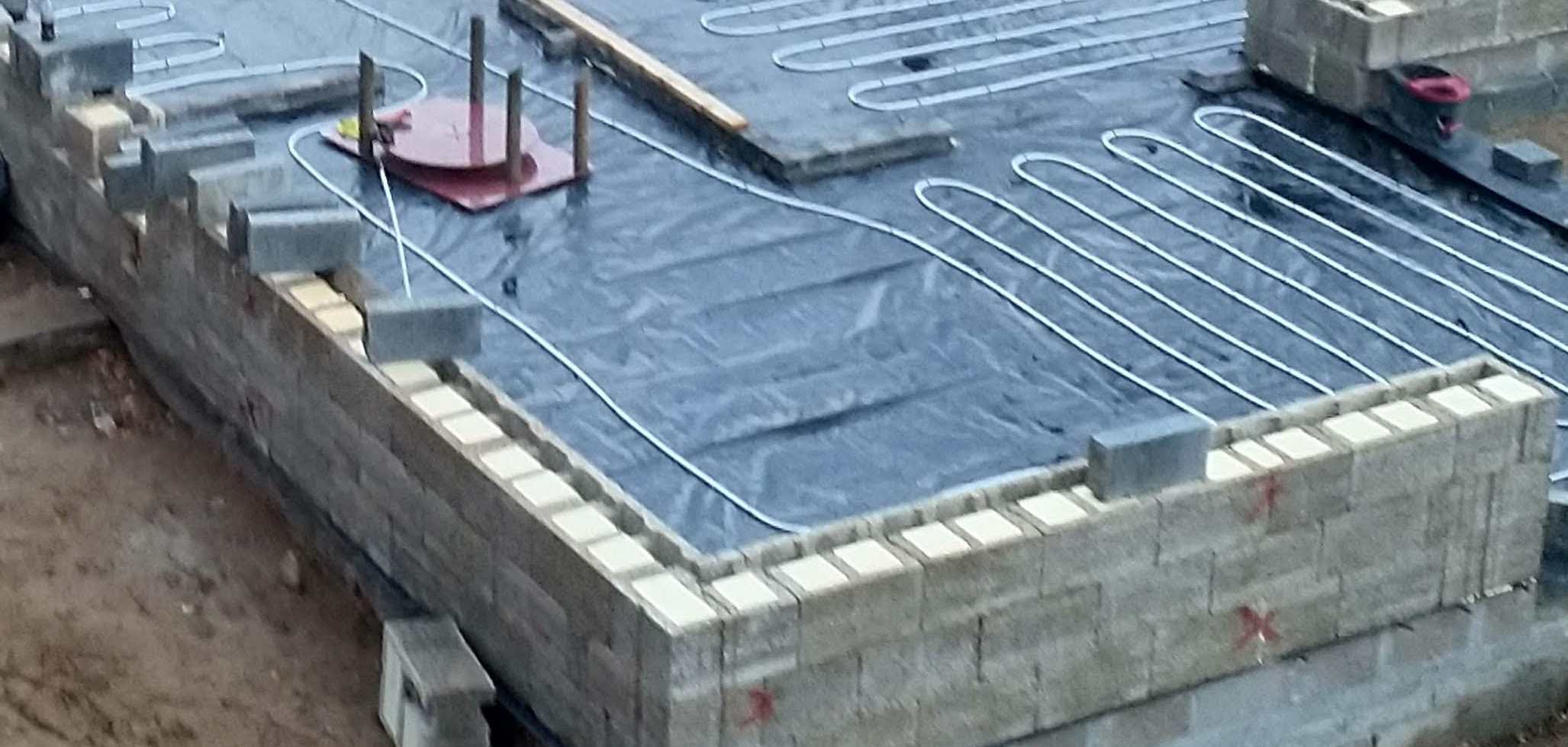

Post and beam Posted March 12, 2025 Posted March 12, 2025 Would anyone like to comment on this design proposal please. Done for me because i cannot get around Loopcads trial expiration today. I expect a Vaillant 7kw @ a 35 degree maximum flow temp if possible. do the flow rates look good? Anything else to note Drawing R2.PDF
JohnMo Posted March 12, 2025 Posted March 12, 2025 Think the person that designed has missed a trick. Study and WC could be one loop - well within 100m pipe length. 1 loop removed The hall could be heated by the pipes that transit through the hall by just spreading the pipes at 150 to 200mm centres instead of bunching them all up against the walls. Another loop removed The utility could be heated with the same loops in the kitchen. Another loop removed. So 3 loops removed without much thought. Ignore the flow rates. Flow rates, you set all flow meters fully open, set the flow temp to get the colder room to temp, rooms which are too warm reduce flow at the flow meter. This will give the heat pump the opportunity to have all the flow it wants, so it can modulate freely. This assumes no buffer, fully open system on a single zone. I have 7 loops over 192m² on a very loose 300mm centres and very rarely exceed 35 degs flow and that at around -9 outside. So you should never exceed low very low 30s, maybe high 20s ever. 1

JohnMo Posted March 13, 2025 Posted March 13, 2025 13 hours ago, G and J said: Not started thinking about UFH loop design yet but as a principle, by removing loops as you describe do you diminish or remove individual room control? As described very well above. Individual room control means zones. One of my loops does, main bathroom, then meanders around the hall near the front door area, then does the kitchen diner. All with a 100m of pipe. Bathroom is routed through first as that wants to be warmest. Just a matter of a little logic. The room isn't really warmer than anywhere else, just feels warmer because the floor is slightly warmer.
G and J Posted March 13, 2025 Posted March 13, 2025 Hmmmm, I can believe that I need to do a factory reset in my heating brain cells but I can’t find the button. I'm committed to the single zone, WC, approach, with UFH throughout downstairs and limited upstairs heating (Fancoil in bedroom and electric UFH and towel rads in bathrooms). I'd figured I’d have a loop solely for the utility room which could be turned off to start with but brought on if needed. Taking the above comments to their logical conclusion I could almost forget the internal walls and simply pipe out in the most efficient manner to give equal loop lengths. So all can be more or less left wide open. I think. 1

Mike Posted March 13, 2025 Posted March 13, 2025 Apart from the factors mentioned above: I'd run the pipes under the kitchen & utility units too. Then, if someone changes the layout at a future date they won't have cool patches on the floor (I've seen it happen). I wouldn't run the pipes directly under the WC. It will need screwing to the floor and you don't want to drill through a pipe!

JohnMo Posted March 14, 2025 Posted March 14, 2025 9 hours ago, Mike said: I'd run the pipes under the kitchen & utility units too. Then, if someone changes the layout at a future date they won't have cool patches on the floor (I've seen it happen No direct pipes in utility, as the UFH manifold is at the back of the utility so all pipes transit through, had to insulate most to keep room temp down. Don't really buy the need for loads of pipe on a kitchen either, you may be shocked how little pipe I even have in there (yes I am running a heat pump). So kitchen diner is an L shapes room. Kitchen is the bit with the single pipe in it, the pipe runs between wall units and island. Does it work - yes, kitchen is currently 20.2 degs and it was 3 degs overnight. Total floor area is 192m² for bungalow and less than 600m of pipe.
