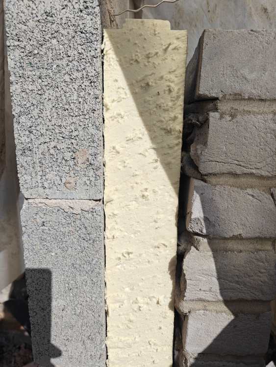

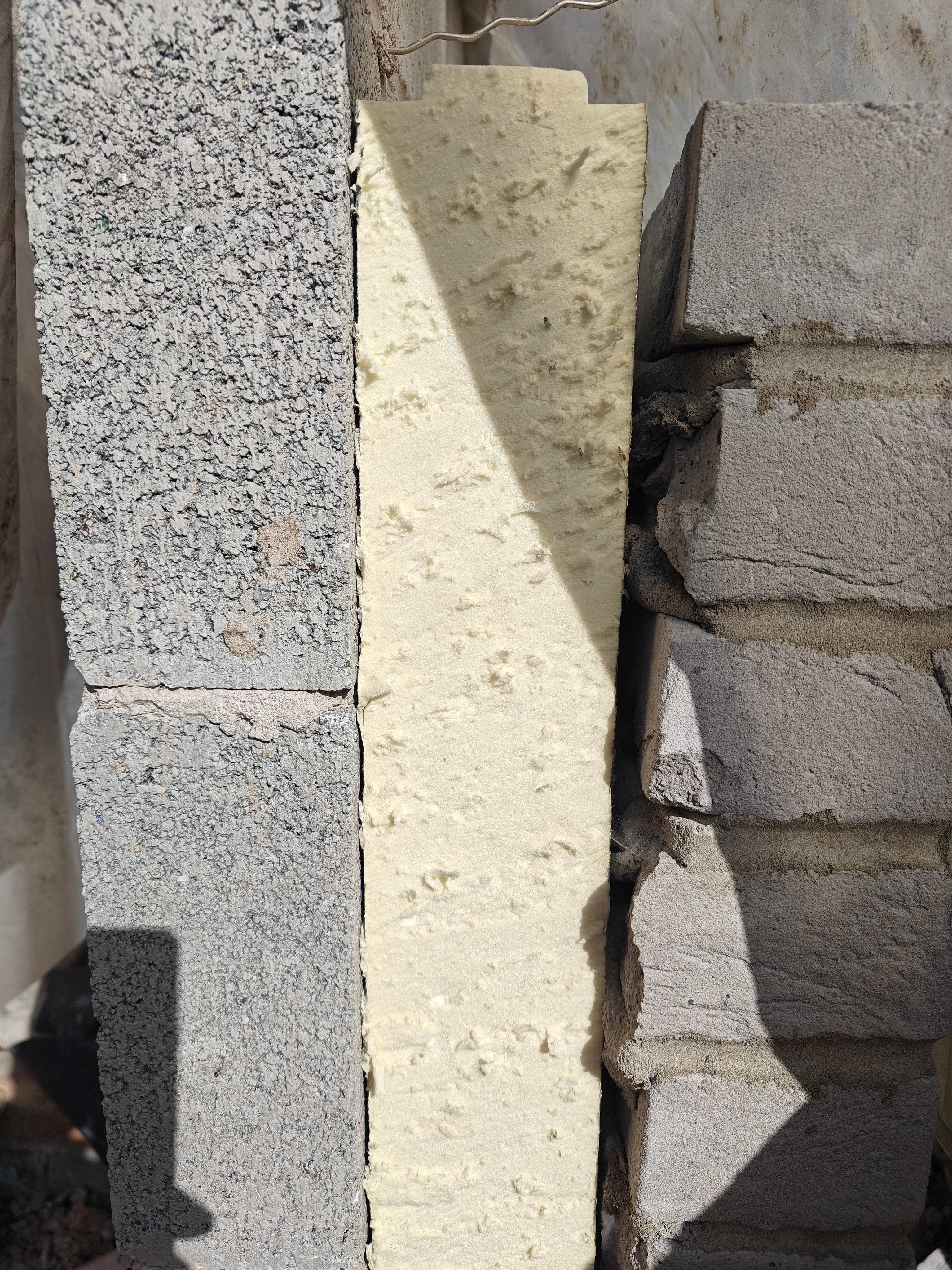

Conor Posted March 11, 2025 Posted March 11, 2025 5 hours ago, Bounce said: There is a gap here due to the insulation from a cross section pushing against this piece. I'm assuming that the brickwork in this pic is the external skin and the blocks are the inside? If so then you've a 10mm+ gap between the insulation and internal skin... Cold air will circulate through this, negating a large portion of the insulation. I.e. it'll be cold. It's needs to be rectified. 2

Iceverge Posted March 11, 2025 Posted March 11, 2025 54 minutes ago, Bounce said: Could installing insulated plasterboard help? I know it will eat into the room space... The trouble is that unless the boards in the cavity are sealed to the inner leaf and sealed to eachother you'll get wind blowing behind them and they may as well be sitting out in the garden at that rate. The same wind will blow through the blocks, ( Blocks are like rice Krispies cakes, very porus). This wind will make it's way out sockets, around skirting and your extension will be very cold. Again your extra insulation is doing little unless you prevent the wind from blowing through it. Either start from scratch or use a closed cell foam like Walltite or Technitherm to completely fill the residual cavity . You could pull out the boards that are there and use EPS beads instead. Your U value will be about 0.3 but still perform vastly better than the existing situation.
Bounce Posted March 11, 2025 Author Posted March 11, 2025 12 minutes ago, Iceverge said: The trouble is that unless the boards in the cavity are sealed to the inner leaf and sealed to eachother you'll get wind blowing behind them and they may as well be sitting out in the garden at that rate. The same wind will blow through the blocks, ( Blocks are like rice Krispies cakes, very porus). This wind will make it's way out sockets, around skirting and your extension will be very cold. Again your extra insulation is doing little unless you prevent the wind from blowing through it. Either start from scratch or use a closed cell foam like Walltite or Technitherm to completely fill the residual cavity . You could pull out the boards that are there and use EPS beads instead. Your U value will be about 0.3 but still perform vastly better than the existing situation. Or they take the outer skin down and start again? Doubt they'll want to do that though..

EdHat Posted March 11, 2025 Posted March 11, 2025 It is particularly important with this type of insulation that joints to the cavity facing side of the inner skin are struck of flush. Firstly, so that you do not get any air gaps behind between the insulation and inner skin which seriously undermines the thermal performance given in the design. Secondly, so the 10mm clear cavity between the insulation and outer skin isn't reduced. Generally, you need a 50mm clear cavity with insulation boards. Manufacturer's developed these products with a tongue and groove joint so that 100mm cavities could still be used after U-value requirements were changed. They were tested with a 10mm cavity and require this to ensure moisture doesn't pass across the cavity. Any gap behind will mean less than a 10mm clear cavity. 1

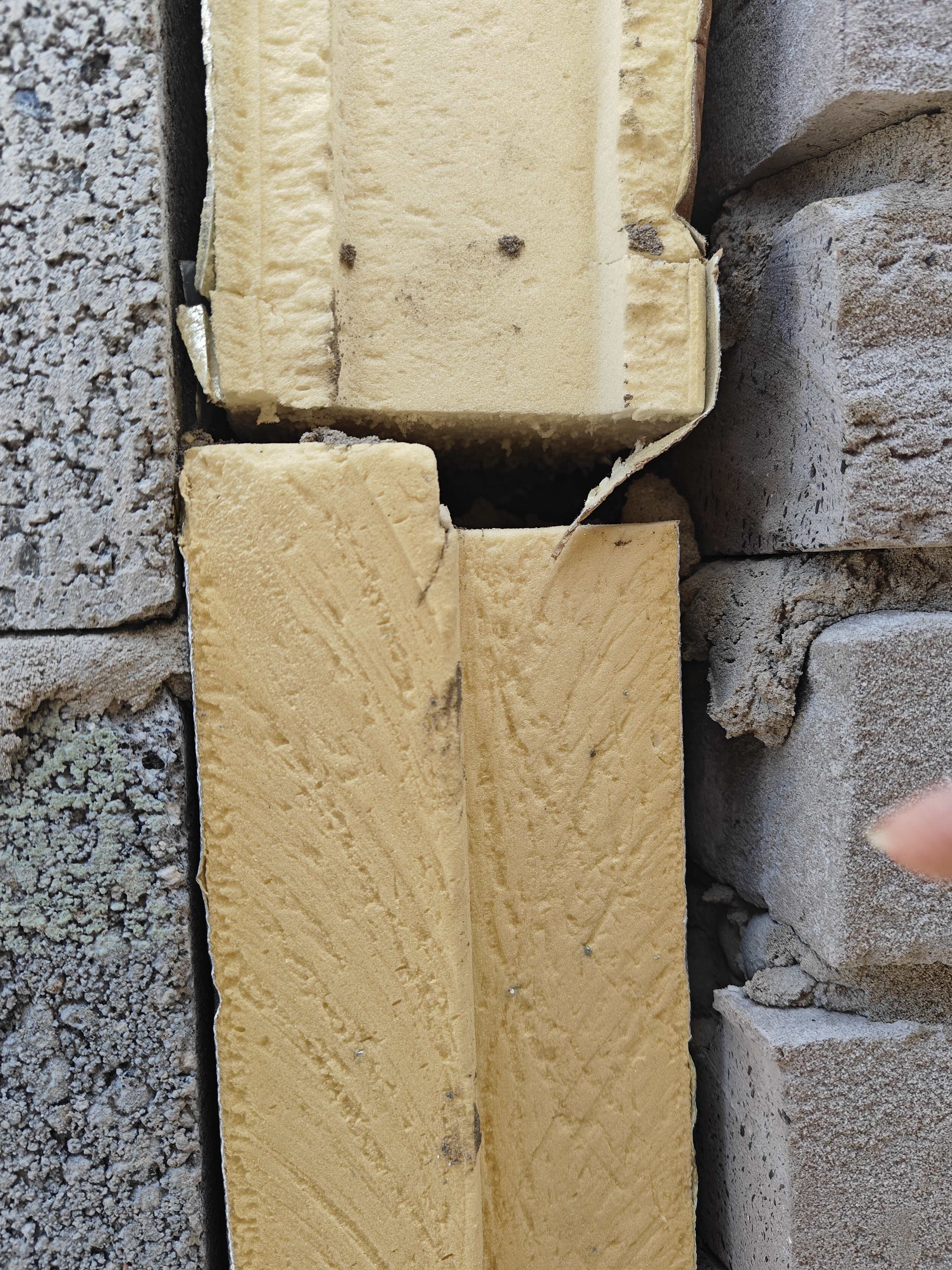

Bounce Posted March 11, 2025 Author Posted March 11, 2025 There is a gap here, as they just have cut the tongue off.
Conor Posted March 12, 2025 Posted March 12, 2025 Yeah, take it all out, full fill beads instead. At the builders cost. Will have a lower u value in paper but will perform better. I'd also be looking at insulated plasterboard.

Bounce Posted March 12, 2025 Author Posted March 12, 2025 Thanks all.. I'd spoken to recticel this morning over the phone and email. They've also confirmed in writing that it doesn't look correct. I went armed with this information and the instructions of how to Install this insulation. The building firm we've used, subcontracted the bricklaying out, and our building firm, didn't QC/Oversee it, it took me to notice it. They have agreed to rectify it from tomorrow. I think they are potentially going to take the blocks (inner skin) down and relay them, with the insulation attached properly. Do you think this possible? I've got to meet them again on site tomorrow to go over it what they will be doing. 1
