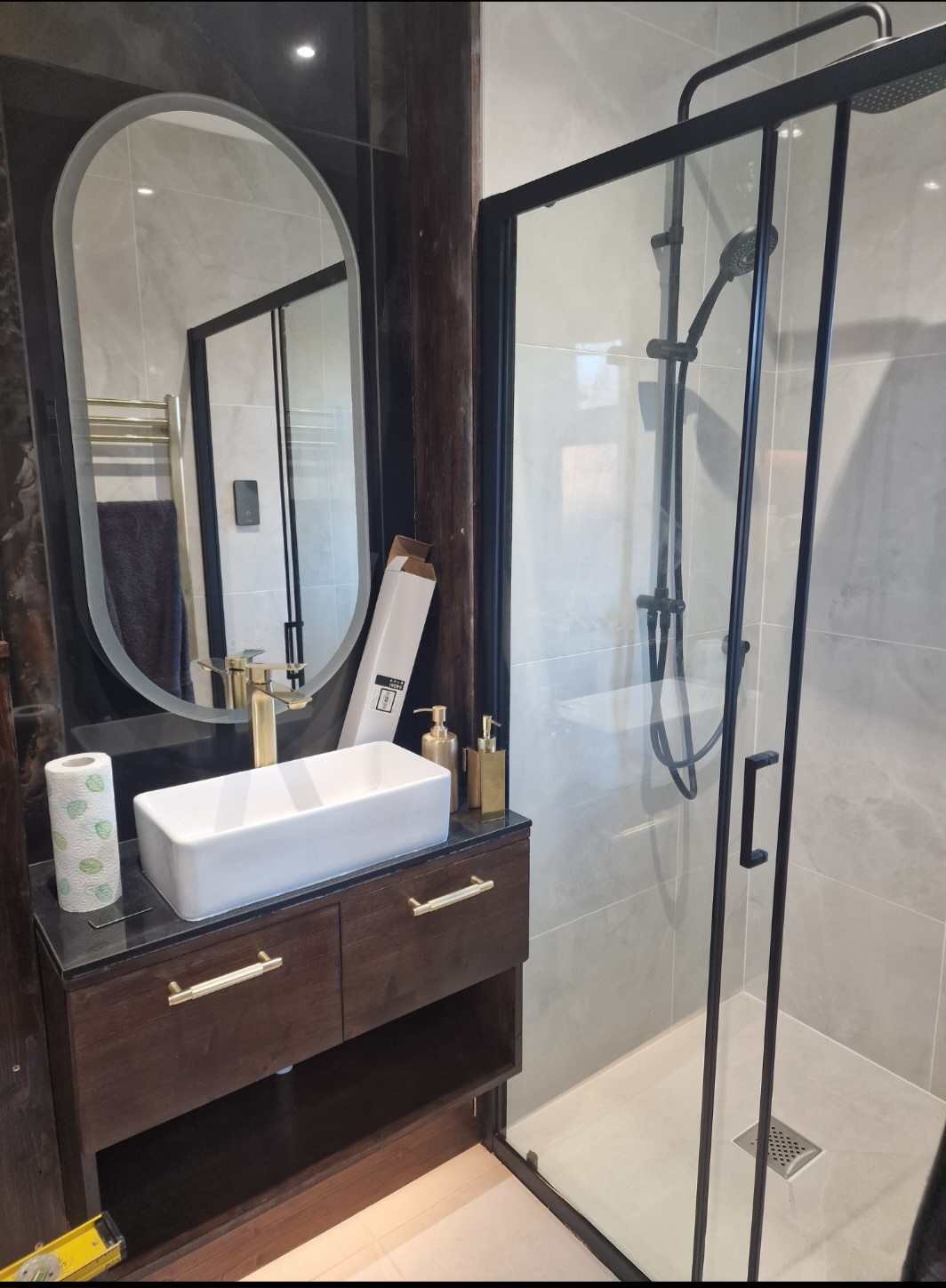

Why an electric shower in guest ensuite?
Get rid of the electric shower, it’s a choice you’ll live to regret.
UVC will have an electric immersion for fail-safe hot water.
Thermoststic mixer showers will speed up or slow down, when other outlets are opened when showering, but the cartridges will balance the flow to keep the temp stable.
In the same circumstances, an electric shower will just slow down, go red hot, and then abruptly shut off and deliver cold water (unless it’s a 7.5kw one which I can piss faster then).

Thought the electric shower would get people asking.
When we first started the work it involved taking the old oil boiler out so we had no hot water.
Electric shower went in so we could still shower, and it's not worth the effort of removing now given how often it'll be in use going forward.
Ah. Ok. Sorry, I thought it was part of your plan eg to be installed. ;)
Is a pressure balancing thingy needed somewhere to reduce cold pressure to match the hot pressure?  Presumably it’s only the showers that such a thingy needs to serve…
I'm not that mad 😁 when we moved in it was an old 7kW thing.
New one is a fancier 10kW thing with a wee touchscreen, this was the finished article.
Mrs had a requirement at least one room in the house wasn't a horrid old 70s maroon bathroom...
