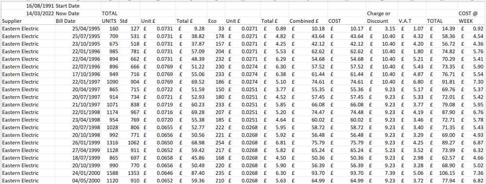

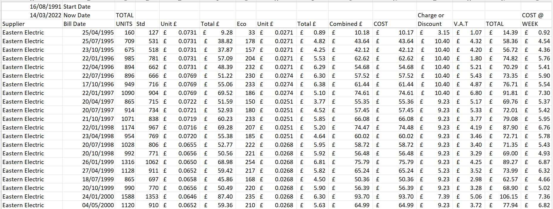

A very useful thing to do do is to record your energy usage.  If you have Smart Meters this is easy, if not, then you can get meters, or even manually daily reads.
Data is so useful, hard to overstate just how much it helps.

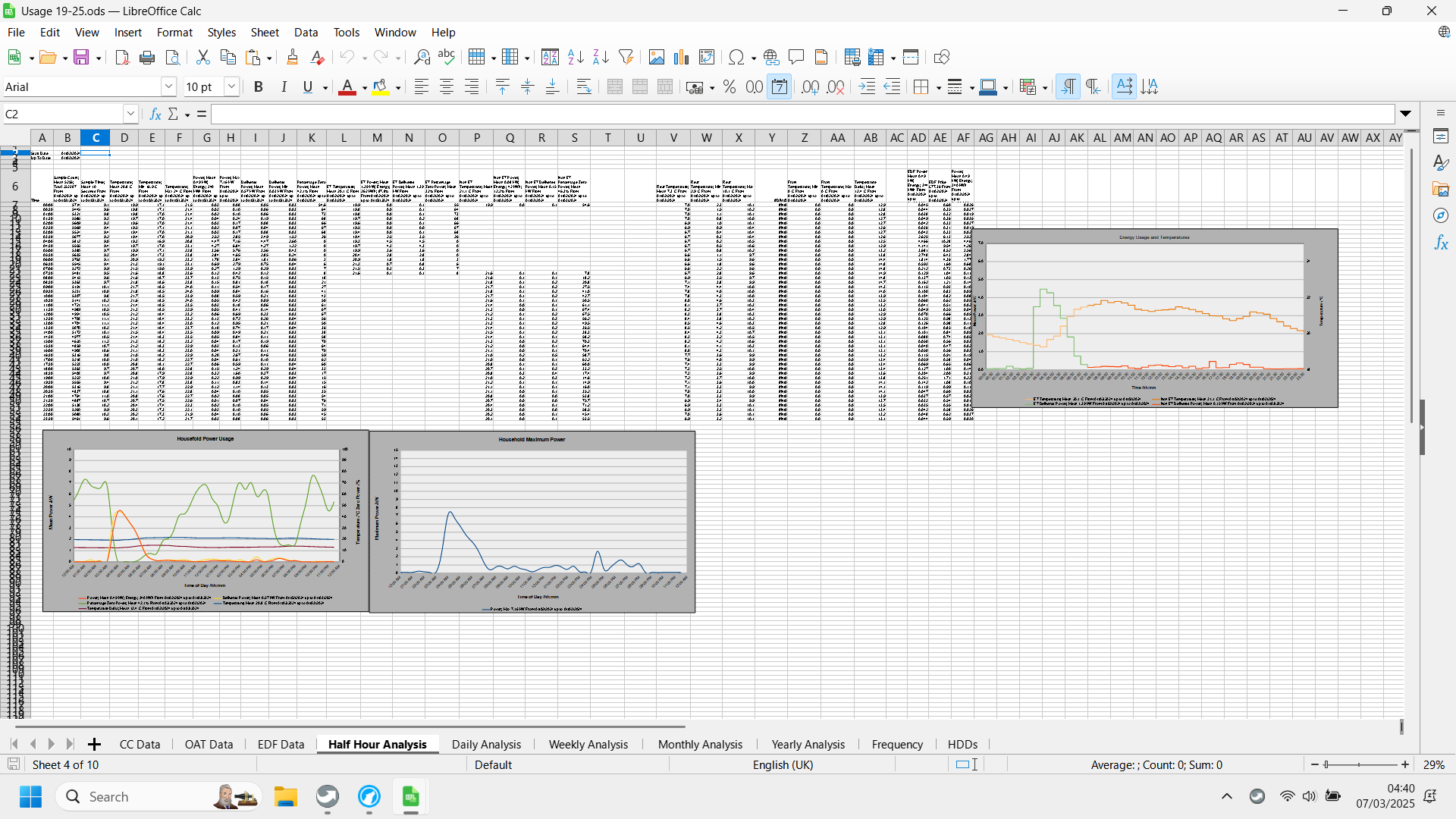

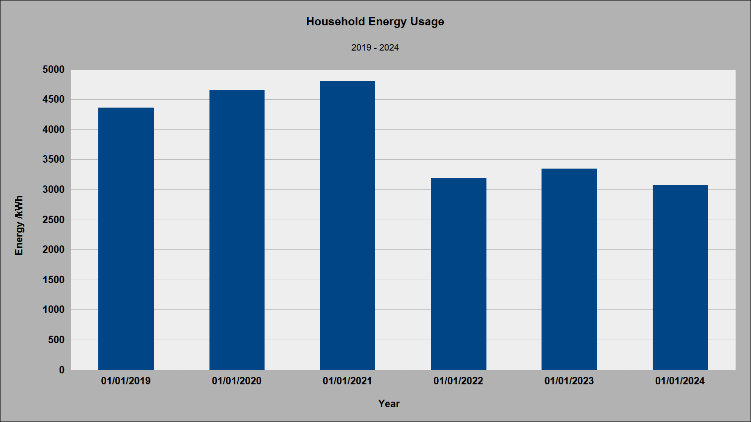

Absolutely - it also helps to correlate energy usage with HDD data - that way you can see if any improvements you make to the insulation of the house or the way you schedule the heating has a positive impact
It is however a little bit of a rabbit hole and I'm way down there now :D

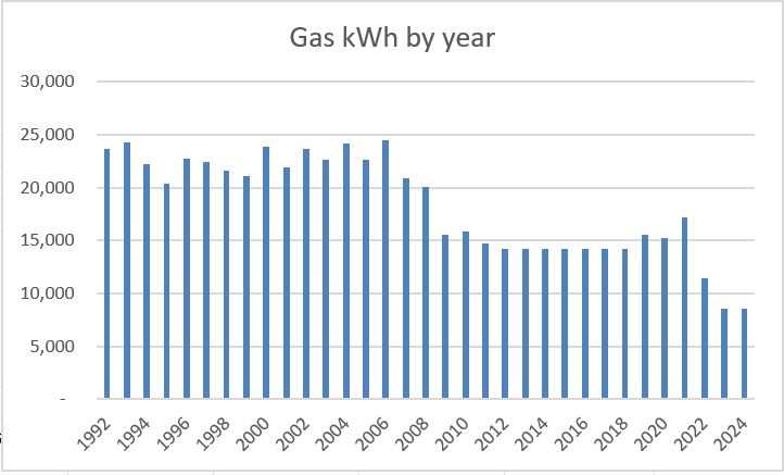

But my first point is you could probably knock down the CO2 emissions by a big margin just by getting the boiler to run effectively and well within the condensation range.
@marshian I assume the fabric improvements started in 2010, to drop gas consumption, but the biggest change was good boiler running a low temps in an
So fabric improvements about 30% gas savings.
New boiler low temperature install a further 40% saving after fabric improvements.
Total saving overall start to finish 65%
Actually before that - the data doesn't show a two storey extension we threw up on the back of the house increasing the footprint and increasing the number of external walls on two large rooms
It was built to building regs at the time so I expect a small increase in energy usage but I got a surprise it went up a lot
That set me on the path of improvements to fabric and optimisation of boiler (eventually replacing a boiler which was no longer well matched to the house heat loss and cycled like crazy)

@marshian So fabric improvements about 30% gas savings.
I'm pretty sure it's 80/20 (fabric/boiler) - energy usage has actually gone up for 2025 (prob 10%)
I'm heating 24/7 with WC for CH and DHWP (previous to this I was heating to a schedule)
Room temps are higher than when I was heating to a schedule - comfort factor is much better
I'm now in the final stages of increasing loft insulation from 70mm to 370 mm (long story not for this thread) so I hope that next winter the benefits will show up in a reduction of energy usage
