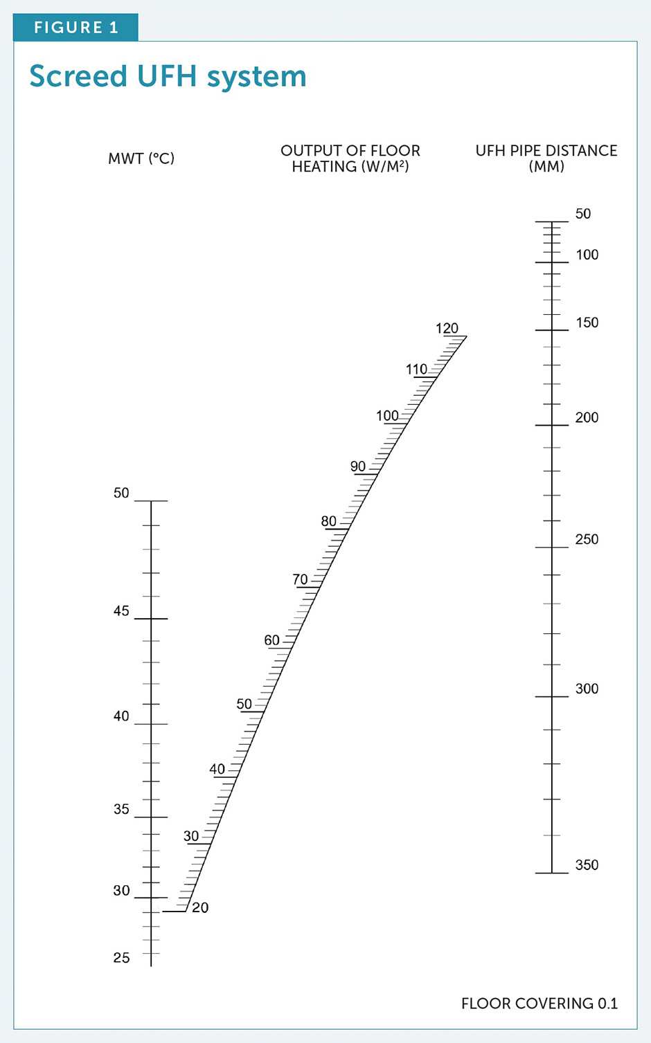

Barry1965 Posted March 5, 2025 Posted March 5, 2025 Hello all, There are several overlay panel systems that we are looking at (Wunda, Ambiente, Nu-Heat etc) that give expected heat outputs per m2 for their systems. For example, Ambiente claim that their AmbiDeck 20 Pro gives out 70W/m2 at 35C MWT with a 150mm pipe spacing and a 0 tog floor tile finish in a 20C heated room. How realistic are these claims and are there any important assumptions behind these figures that we should be aware of. Our system is to be installed on concrete slab (no insulation below) and running 24 hours a day at flow temperatures between 30-40C. Many thanks, Baz
JohnMo Posted March 5, 2025 Posted March 5, 2025 Worth a watch What ever you do do a screed on top of the pipes. I tried an overlay system it was rubbish compared to a screed system. Floor output chart h use a straight line between points - to get MWT, pipe spacing and correct output.
Barry1965 Posted March 5, 2025 Author Posted March 5, 2025 Thanks John, What was the overlay system that you used? Was it rubbish in terms of outputs or were there other issues too? We are restricted to a build up of 40mm max so are unable to use a screed system unfortunately. Are there similar output charts to the one you included for overlay systems? Presumably this output also depends on the insulation below the installed system? Thanks, Baz
JohnMo Posted March 5, 2025 Posted March 5, 2025 (edited) 52 minutes ago, Barry1965 said: What was the overlay system that you used? Was it rubbish in terms of outputs or were there other issues too It was an EPs with thick aluminium and OSB over the top (with an additional 250mm else below). Output wasn't good enough to keep room warm with out super high flow temps. Stopped using it was so bad. Output shouldn't change with insulation by much but energy input will to get same room temperature will. I would add 52 minutes ago, Barry1965 said: build up of 40mm max Add insulation and radiators - is it a boiler or heat pump? Or the one in the video could be screeded and within 40mm. Edited March 5, 2025 by JohnMo

MikeSharp01 Posted March 5, 2025 Posted March 5, 2025 12 minutes ago, SteamyTea said: Probably best never to put timber above UFH. Don't tell me this, we have 20mm Ash / ply engineered floor, 1 Tog, over ours, pipes are about 80mm down in the slab at 150mm centers. The floor people want us to keep the slab temperature below 27deg C. Doing a quick line across JohnMo's chart we should be on about 25W / m2 and we have 100 m2 of UFH so 2.5kW and we only need about 2kW so we should scrape in on worst days.

Barry1965 Posted March 5, 2025 Author Posted March 5, 2025 Thanks for your replies. We don't have any insulation below the proposed overlay system. The floor is currently concrete slab and we don't really want to start digging down, and existing doors and fittings limit us to about 40mm build up. If we were to put down an overlay system on the concrete slab then pour a thin layer of liquid screed over the top, what sort of outputs could we expect if we topped it with 10mm tiles. (assuming 20mm XPS boards, 16mm pipe at 120 spacings) Thanks again for your help, Baz
ProDave Posted March 5, 2025 Posted March 5, 2025 31 minutes ago, Barry1965 said: We don't have any insulation below the proposed overlay system. The floor is currently concrete slab and we don't really want to start digging down, and existing doors and fittings limit us to about 40mm build up. If we were to put down an overlay system on the concrete slab then pour a thin layer of liquid screed over the top, what sort of outputs could we expect if we topped it with 10mm tiles. Don't fit UFH in this situation. Your overlay boards will not have anything like enough insulation to sit directly on an uninsulated floor. If you do proceed expect a lot of your heat to go down and very poor performance. 1 1
SteamyTea Posted March 5, 2025 Posted March 5, 2025 7 minutes ago, Barry1965 said: 20mm XPS boards Has a thermal conductivity of about 0.035 W.m-1.K-1. So a U-Value of 1.75 W.m-2.K-1. So a lot of power will go into the ground. If I was at home, with a blank spreadsheet open, I would take a stab at how much goes into the room, and how much into the ground. But let us say you have 20mm of liquid screed above the pipes (same thickness as XPS below them). The U-Value would be 110 W.m-2.K-1. Now the temperature differences have to be taken into account. Initially let use say that the mean flow temperature though the pipes is 30°C, ground temperature is 8°C and room temperature is 20°C. Power to ground will be 1.75 [W.m-2] x 1 [m²] x (30 - 😎 [K] = 38.5 W.m-2. Power to room will be. 110 [W.m-2] x 1 [m²] x (30 - 20 [K] = 1100 W.m-1. Now for some reason those numbers do not look right to me, so maybe I have made a mistake somewhere (very likely) or I have picked up some duff k-Values. A 3 to 1 difference just does not look right. But if it is right, then a third of your cash is warming worms.
JohnMo Posted March 5, 2025 Posted March 5, 2025 (edited) 1 hour ago, Barry1965 said: we were to put down an overlay system on the concrete slab then pour a thin layer of liquid screed over the top, what sort of outputs could we expect if we topped it with 10mm tiles. (assuming 20mm XPS boards, 16mm pipe at 120 spacings) Use what is linked in the video. 20mm insulation is a waste of time in the grand scheme of things. Adding the insulation in this case just decouples the existing slab from the UFH. You are better having it coupled, then run low and slow per video. You will suffer downwards heat loss, but that is true with any of these systems. Not sure I would trust a super thin layer of screed on top of the 20mm insulation. Cracks etc. Edited March 5, 2025 by JohnMo
JohnMo Posted March 5, 2025 Posted March 5, 2025 1 hour ago, MikeSharp01 said: Don't tell me this, we have 20mm Ash / ply engineered floor, 1 Tog, over ours, pipes are about 80mm down in the slab at 150mm centers. The floor people want us to keep the slab temperature below 27deg C. Doing a quick line across JohnMo's chart we should be on about 25W / m2 and we have 100 m2 of UFH so 2.5kW and we only need about 2kW so we should scrape in on worst days. We also have 20mm (oak) flooring, but pipes at 300mm centres. There is zero issues I generally flow at 35 degs, floor temp has never been above about 24. The temperature through the pipes is dispersed via distance, as heat radiated outwards. Floor temp and flow temp are different things
