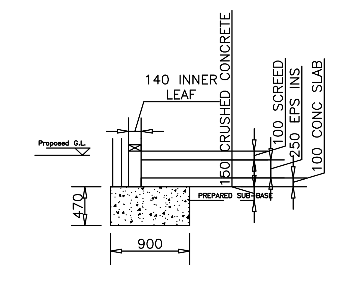

So, the project moves in and we now have a foundation design.
We’ve an A142 reinforced 100mm oversite (slab) on the asymmetric strip foundations to help make it all work.  Then 250mm of EPS, in which my poo pipes sit, then 100mm of screed with UFH pipes.   The poo pipes can’t be buried in the oversite, so when they enter the house they will have to be at an invert level of 350mm below FFL.
The longer of the two pipe runs is just under 6m, which is a 75mm fall at 1:80.   That means at the worst bit, which is the base of the soil stack, there will only be 65mm of EPS between pipe and bottom of screed.
In terms of scheduling, I can put the poo pipes in just before insulation just before screeding, so I shouldn’t be tripping over them for months.  So that sounds good.

I cannot see and issue with noise from the pipes.  The thermal expansion noise from plastic pipes is normally from the welded ones.  If this is below ground drainage they will be push fit.  Push each fitting fully home, then pull out 5mm.
Good to hear and exactly what I was hoping.   Would hate to be standing in my hall, listening to odd noises wishing I’d asked more questions.
