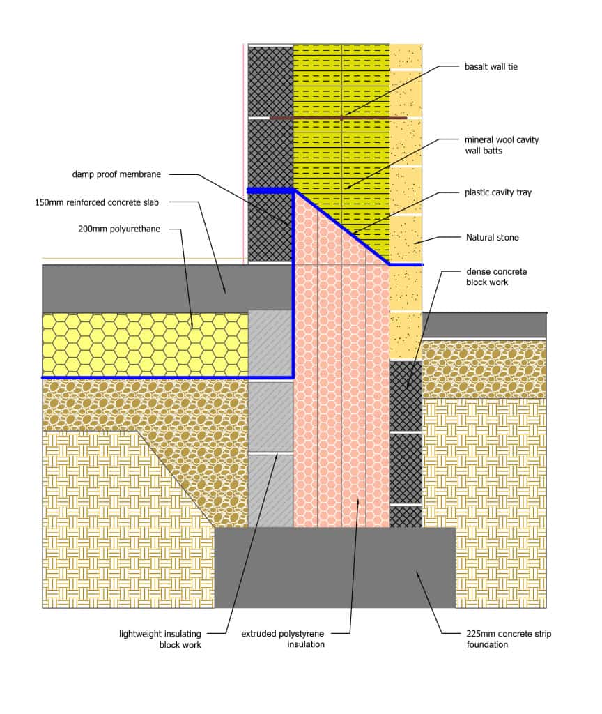

Oz07 Posted December 13, 2017 Posted December 13, 2017 Think foamglass type blocks are the accepted workaround here? Also look into using eps insulation instead of lean mix Conc in your cavity below ground. Will resist compression and reduce cold bridge. Cut a champher on top to direct water outwards. Did @joe90 do this?
PeterW Posted December 13, 2017 Posted December 13, 2017 15 minutes ago, Oz07 said: Also look into using eps insulation instead of lean mix Conc in your cavity below ground. Will resist compression and reduce cold bridge. Cut a champher on top to direct water outwards. Did @joe90 do this? No it’s me that did it and worked really well. Needs a big (600mm) step DPC but is very effective.
Oz07 Posted December 13, 2017 Posted December 13, 2017 Why, does the dpc go under the eps then? Also is this method more successful with ground bearing Slab as inside face of internal blockwork will also be at low temp in vented floor? Suppose eps could also be placed against this face for belt and braces?
joe90 Posted December 13, 2017 Posted December 13, 2017 35 minutes ago, PeterW said: No it’s me that did it and worked really well. Needs a big (600mm) step DPC but is very effective. Well great minds think alike ?, yes I also did this but slightly differently. I copied the Golcar system:- but on my builders recommendation changed it a little. The DPC being above floor level indoors led on a previous build of his led to a crack in the plaster ( slip plane) so we lowered the DPC To internal floor level, the outside level was then below ground slightly but within a french drain so the weep vents could work, we then installed a second DPC in the outside brick skin level with the internal one which was above the outside ground level.
Oz07 Posted December 13, 2017 Posted December 13, 2017 Yes now on that sketch imagine a vented floorspace inside. Just wouldn't perform as well with cold air and cold bridge of conc beams. If you brought eps up inside and also used something like hanson jet floor that would seem to get rid of the bridges.
