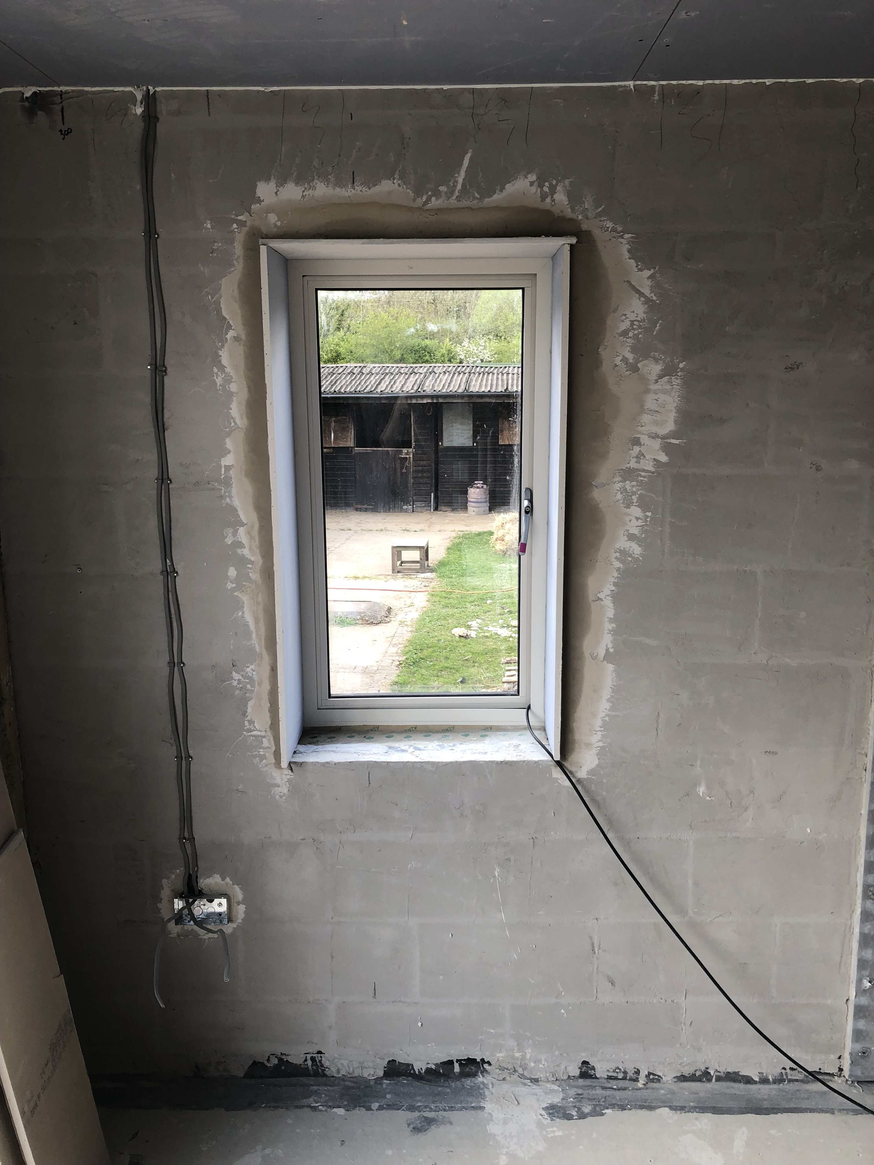

crispy_wafer Posted February 26, 2025 Posted February 26, 2025 Good Morning, Probably sounds a bit of a daft question, I'm prepping for boarding my window reveals, how much space should I leave between the edge of the window and the plastered face of board? Would you make the head same as the sides? Thanks Marek
BotusBuild Posted February 26, 2025 Posted February 26, 2025 Talk of plaster implies internal reveals? We have plaster board and plaster right up to the frames, no gap.
crispy_wafer Posted February 26, 2025 Author Posted February 26, 2025 my confusing wording wont be helping 🤣, yes to window reveals. Lets say before plasterboard I have an 80mm of frame on show from block to the bit that moves when you open the window. I was thinking after boarding to leave myself 45mm of frame showing? Would that be too little, too much, or just about right?

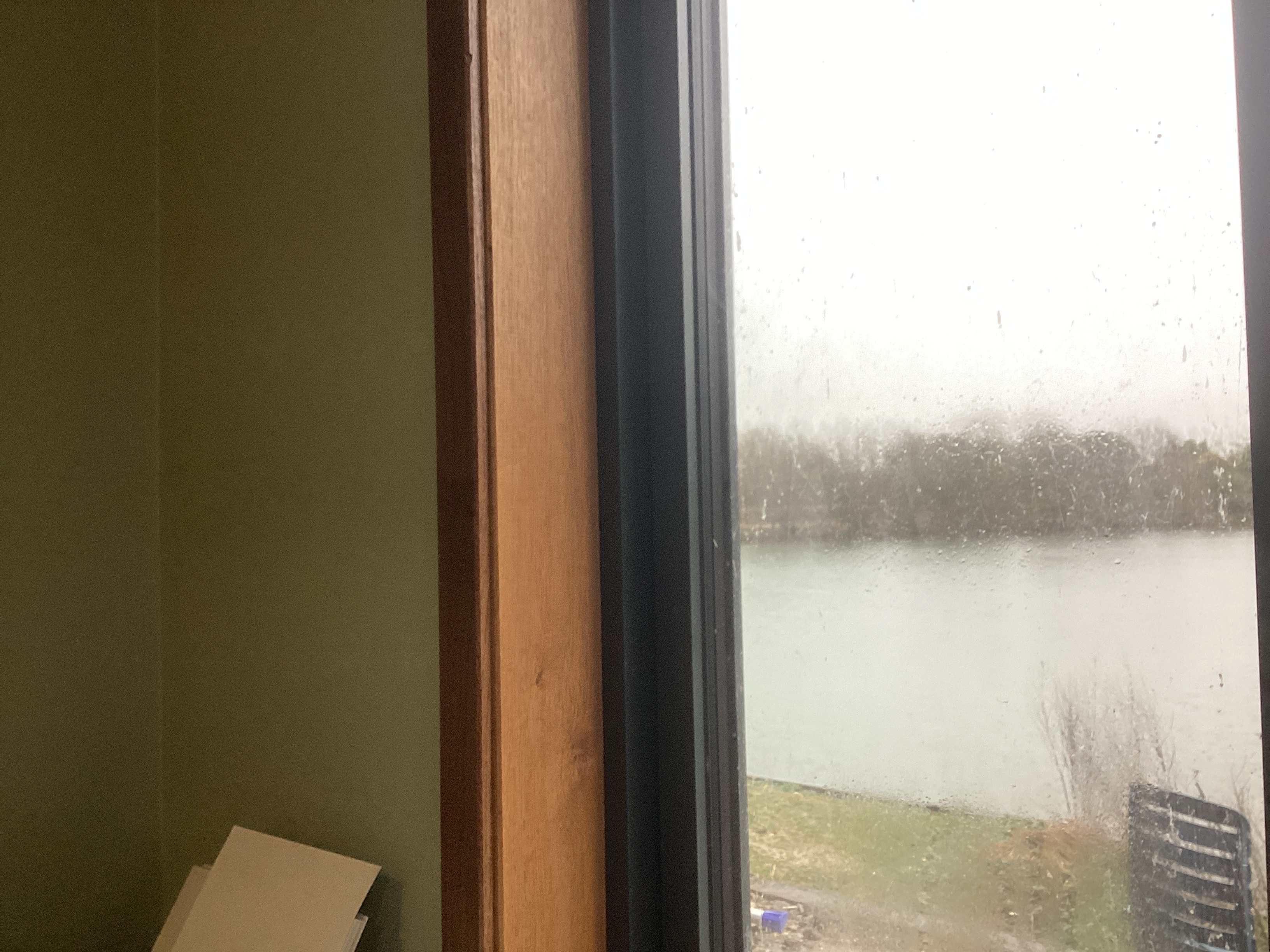

Super_Paulie Posted February 26, 2025 Posted February 26, 2025 35mm for me, consistency around all the new windows meant various depth reveal boards, 9mm, 12.5mm and 6mm Wedi-board to achieve it. 1 1

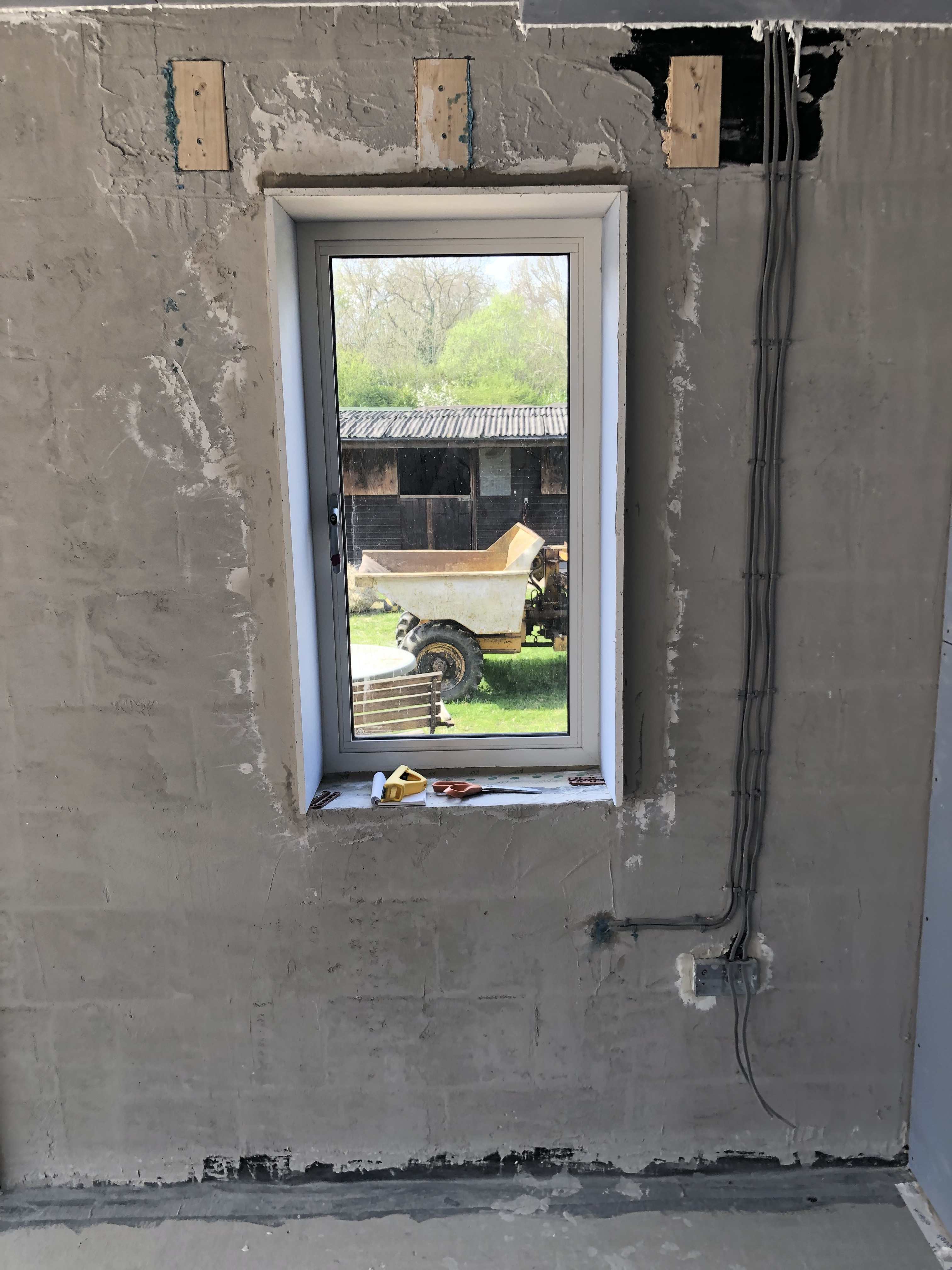

crispy_wafer Posted April 13, 2025 Author Posted April 13, 2025 Just a mild update, I’ve managed to get a couple of windows boarded. Not going to win any competitions for speed, but checking levels/plumb/square and trying to do the best job you can when having a ‘go’ for the first time…. I’m relatively pleased with my first effort 35/36mm is what I ended up settling for, more by a result of the amount of adhesive I slapped on the soffit, rather than calculation. Good excuse to start eating into all those pb offcuts I had stashed away. 4
