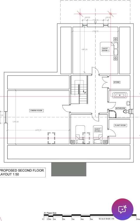

lizzieuk1 Posted 23 hours ago Author Posted 23 hours ago On 01/03/2025 at 19:33, Iceverge said: Something like. Tiles Tile battens Counter battens Breather membrane 11mm OSB 350 mm I joists with Cellulose. Membrane 20*70mm battened service cavity Plasterboard Skim. U value about 0.11. Would it be an option to use rockwool slabs between the I joists if we couldn't do the blown cellulose. Looking at thermal values they look very similar. No idea on cost comparison though so, any info on that would be helpful.
Iceverge Posted 20 hours ago Posted 20 hours ago Cellulose is dearer than Rockwool but that includes fitting. About €150/m3 plus VAT near me. Not sure of UK prices. There's a notable difference between the cheap mineral wool "loft roll" and higher density batts like Rockwool so ensure you're comparing like for like. Cellulose has the advantage that it really helps the airtighess too when it's properly installed..
lizzieuk1 Posted 20 hours ago Author Posted 20 hours ago 8 minutes ago, Iceverge said: Cellulose is dearer than Rockwool but that includes fitting. About €150/m3 plus VAT near me. Not sure of UK prices. There's a notable difference between the cheap mineral wool "loft roll" and higher density batts like Rockwool so ensure you're comparing like for like. Cellulose has the advantage that it really helps the airtighess too when it's properly installed.. Thanks Iceverge, food for thought then.
Russell griffiths Posted 20 hours ago Posted 20 hours ago (edited) 3 hours ago, lizzieuk1 said: Would it be an option to use rockwool slabs between the I joists if we couldn't do the blown cellulose. Looking at thermal values they look very similar. No idea on cost comparison though so, any info on that would be helpful. I used a product called knauf omni fit. far nicer to handle than rockwool if installed from underneath. Edited 20 hours ago by Russell griffiths 1
