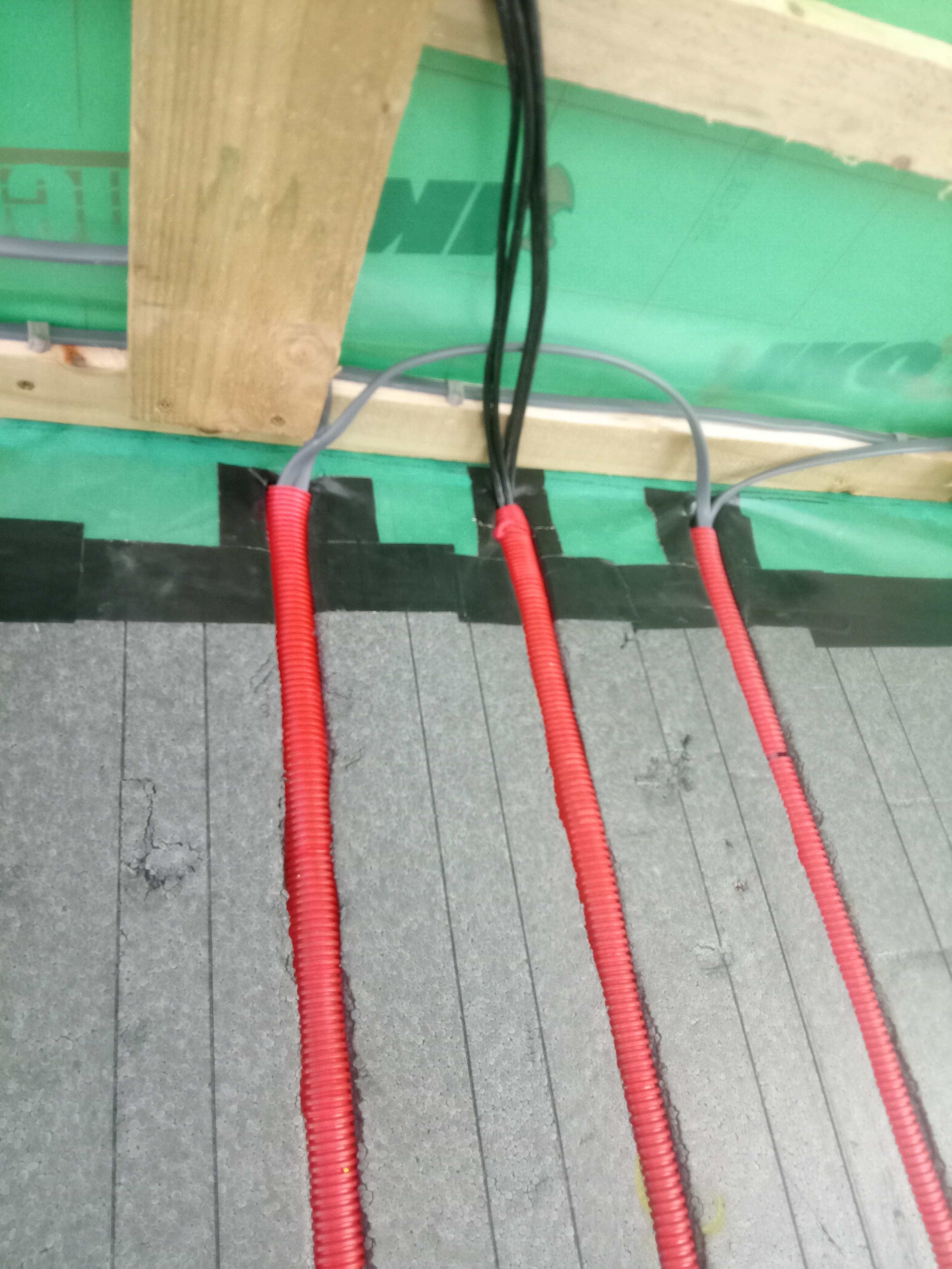

Jenki Posted March 2, 2025 Posted March 2, 2025 On 28/02/2025 at 18:58, Iceverge said: I assume with EPS ICF it's just a hot knife for services and then plasterboard straight to the EPS? How do you stick the plasterboard? Is it screw to the ICF webs or glue it on? How do you fix to it? Is it a matter of drilling through to the concrete core? @Jenki @Nickfromwales @FM2015 or any other ICF aficionados. Yes please do. Live experiments are always appreciated. The polysteel Blocks I used have a 30mm steel web every 150mm, so yes got knife to gouge the blocks for conduit. I added. Layer of 25mm PIR so surface mounted 25mm electrical boxes and these were screwed to the steel webs with lightweight steel wafer head screws. Plasterboard was secured with longer drywall screws for metal studs. 1
Iceverge Posted March 2, 2025 Posted March 2, 2025 3 hours ago, Jenki said: The polysteel Blocks I used have a 30mm steel web every 150mm, so yes got knife to gouge the blocks for conduit. I added. Layer of 25mm PIR so surface mounted 25mm electrical boxes and these were screwed to the steel webs with lightweight steel wafer head screws. Plasterboard was secured with longer drywall screws for metal studs. Sounds like a good system. I'm assuming the walls now feel "solid" to tap with your hand? How do you fix stuff to the wall? Did you add ply/Osb for the kitchen? How about hanging pictures etc? I've not considered it but I suppose insulated plasterboard (as much as I normally hate the stuff) could be a reasonable option for ICF for easily boosting the U value .
