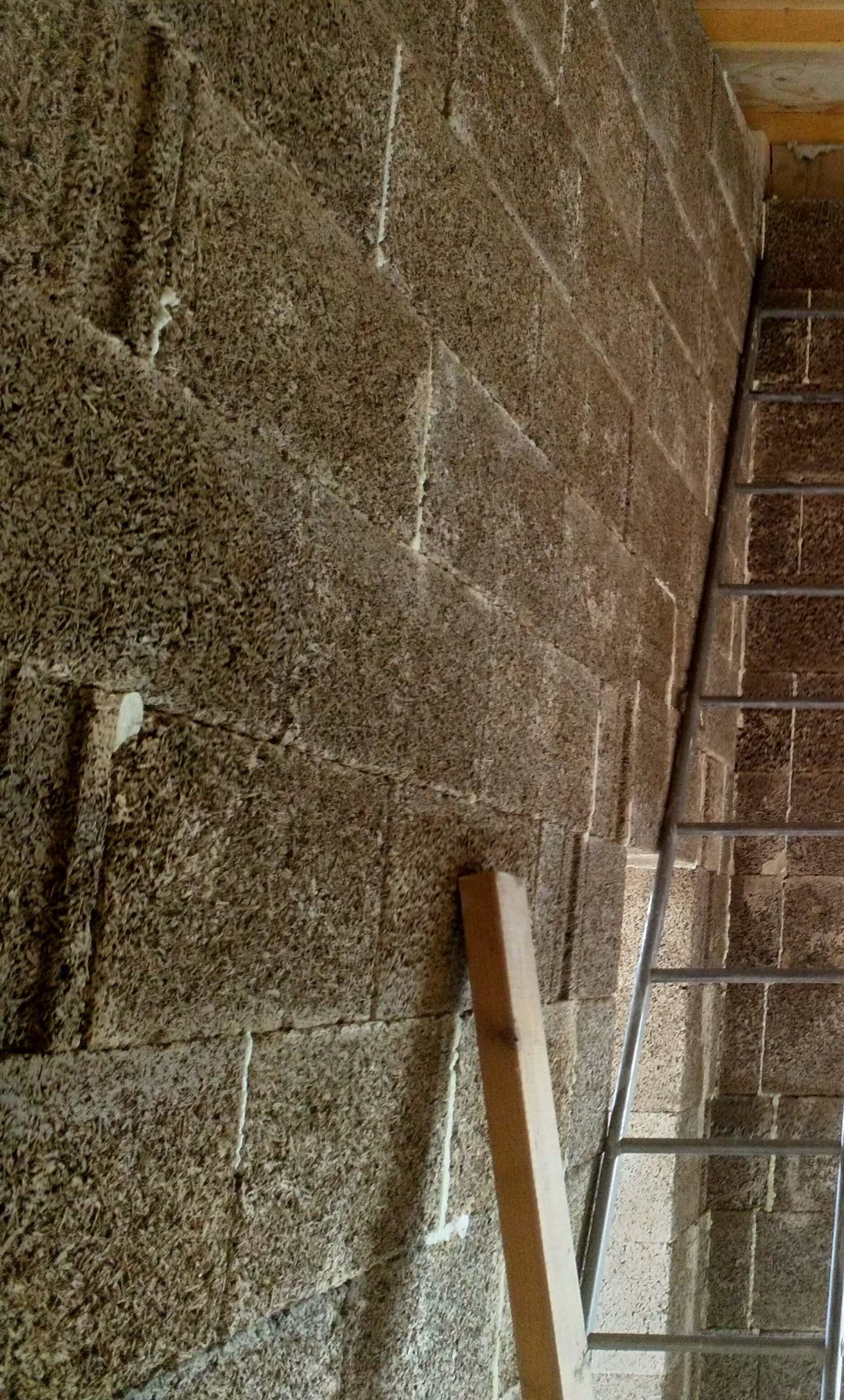

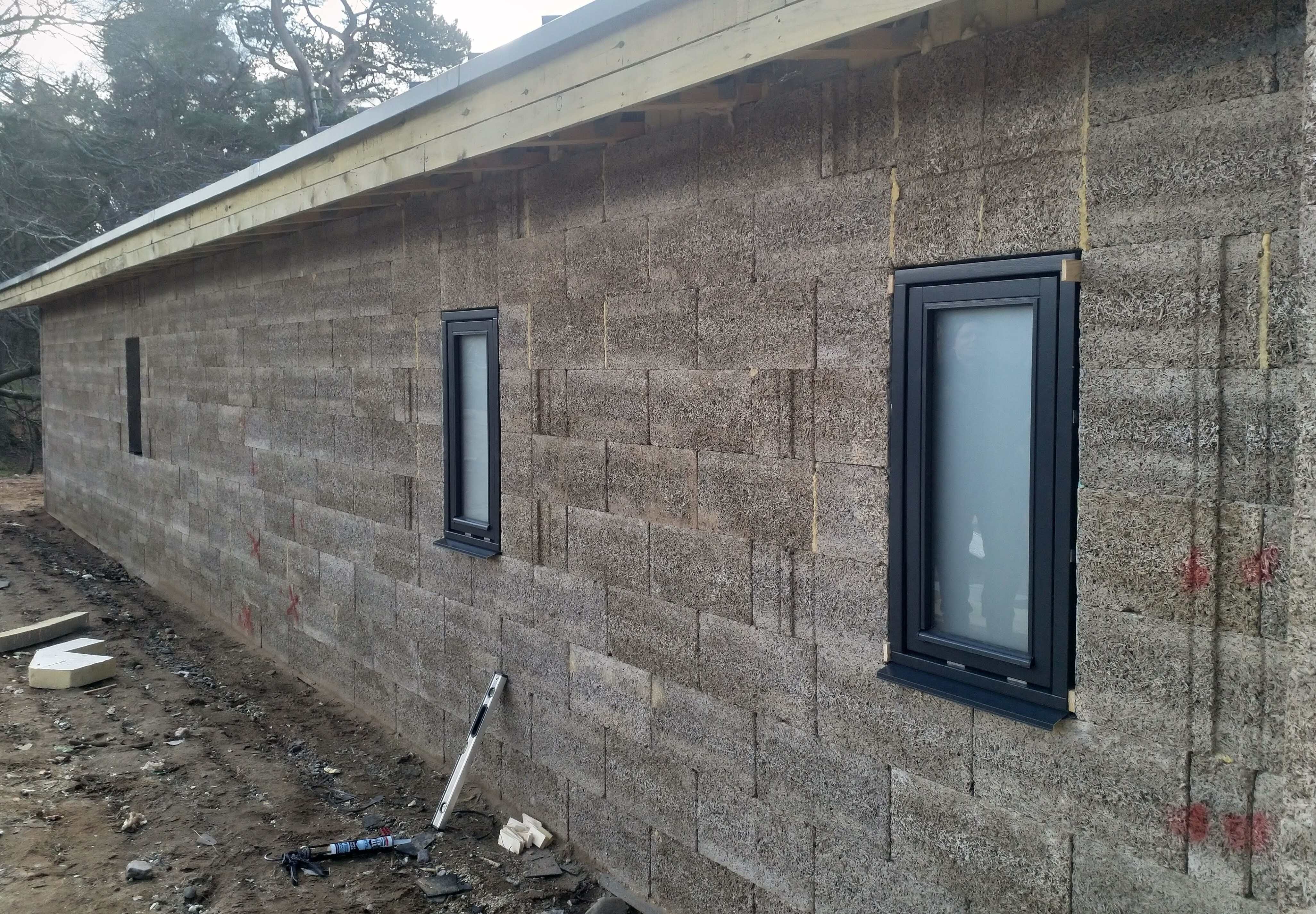

JohnMo Posted March 1, 2025 Posted March 1, 2025 (edited) Sorry you are all over thinking this. Durisol blocks have a slight taper to allow them to be removed from moulds. But it is slight. The wall when complete will be vertical and straight. Apply flexible external tile adhesive and just apply slips. We did stone slips with zero issues direct to block. By the time you have completed it the wall will be mostly airtight. The issue is the DPC area, but this acts as a drain should any moisture het behind the slips. Forgot to mention the securing tabs on the slips, I use copper nail but can also be screwed directly to blocks Edited March 1, 2025 by JohnMo

Nickfromwales Posted March 1, 2025 Posted March 1, 2025 4 minutes ago, JohnMo said: Sorry you are all over thinking this. Durisol blocks have a slight taper to allow them to be removed from moulds. But it is slight. The wall when complete will be vertical and straight. Apply flexible external tile adhesive and just apply slips. We did stone slips with zero issues direct to block. By the time you have completed it the wall will be mostly airtight. The issue is the DPC area, but this acts as a drain should any moisture het behind the slips. Good to hear yours was that level to just ‘tile’ straight to it with the slips. The Isotex and Velox builds defo didn’t allow for this, nowhere near. I guess this is a warning to remain vigilant at the time it matters most, as some may just steam through the construction and not realise how impactful even a 10mm undulation will be downstream.
JohnMo Posted March 1, 2025 Posted March 1, 2025 @lizzieuk1 I would do the maths on additional external insulation is it worth the expense and head ache? Moving from 0.14 to 0.12? 1
JohnMo Posted March 1, 2025 Posted March 1, 2025 Photo for clarity on what an unfinished wall looks like. This internal but exterior the same 1
JohnMo Posted March 1, 2025 Posted March 1, 2025 Just found the long external wall - about 15m long and 2.5m tall. 1 1
