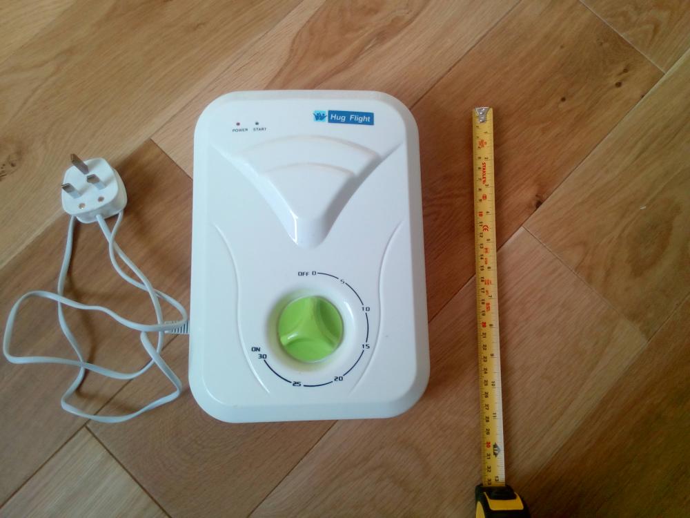

Stones Posted December 7, 2017 Share Posted December 7, 2017 I've decided to buy a small ozone generator as a means of eliminating odours resulting from cooking. These wouldn't be permanently on, only used as and when required for the minimum length of time required (which I'm sure will be a matter of trial and error to determine). Looking at two options. Not much money in the grand scheme of things, but wondered if anyone had any thoughts / views: https://www.ebay.co.uk/itm/Ozone-Generator-Ozonator-Sterilizer-Hygiene-Discharge-Air-Purifier-Home/232568538266?hash=item36262a449a:g:eiUAAOSwzppZ-C9q https://www.ebay.co.uk/itm/2x-PLUG-IN-OZONE-GENERATOR-Eliminate-Odor-Kill-Smells-Air-Purifier-PLUG-/232544595432 Link to comment Share on other sites More sharing options...

Stones Posted December 7, 2017 Author Share Posted December 7, 2017 Looking at the output of fridge units, the larger 400mg/h unit would seem to be the way to go, plus it has a timer, presumably to prevent over use. A 50mg/h plug would no doubt keep things fresh, but perhaps struggle to quickly eliminate odours from a 'shock' event like cooking. Link to comment Share on other sites More sharing options...
Jeremy Harris Posted December 7, 2017 Share Posted December 7, 2017 The output from these things is largely mythical, in terms of true ozone generation, sadly. They are tested with dry oxygen normally, which gives an output that is at least five times greater than the same unit operated in room air, plus any humidity reduces the ozone output even further. As an example, the unit I've built that really blasts the room, uses plates that are rated (with dry oxygen) at 10g/h (10,000mg/h). In reality, I doubt that it puts out much more than about 1g/h when operated in a room with air at around 40 to 50% RH. That's still a great deal of ozone though, too much to stay in the room. I'd suggest that the 400mg/h unit realistically generates around 40 to 50 mg/h under normal room conditions, and that is probably enough. The 50mg/h units will probably only deliver around 5mg/h under room conditions, I suspect, and you may not even notice any effect at all at that low a level. There are some other effects of ozone worth noting. It is an extremely powerful disinfecting agent, around 10,000 times quicker than chlorine bleach at killing bacteria, viruses, cysts etc, as well as pretty much anything living. The units needs to be located away from house plants, pets etc, and also not too close to people. You can smell ozone at extremely low concentrations, well below the concentration that will really kill bugs etc, but if the concentration is too high it does irritate your eyes, nose and throat. The good news is that it is very unstable and breaks down to normal oxygen very quickly, within about 30 minutes at the very most, and most of it will break down within a minute or so of having been produced. This means that even if you do end up with a unit that is a bit too powerful (and I doubt that the 400mg/h will be) within ten minutes or so of turning it off most of the ozone will have gone, either reacted with the volatiles that create odours, or naturally decayed back to O2. I inject our well water with ozone at around 1g/h, and that oxidises the iron in the water in much less than 1 second and kills all the bugs within a few tens of seconds. The iron oxidation is so fat that you can see the orange stain from the oxidised ferric chloride within a few mm of the point in the pipe where the ozone is injected. Link to comment Share on other sites More sharing options...

Stones Posted January 24, 2018 Author Share Posted January 24, 2018 A quick update. I ended up buying one of these: https://www.ebay.co.uk/itm/Ozone-Generator-Ozonator-Sterilizer-Hygiene-Discharge-Air-Purifier-Home/232568538266?hash=item36262a449a:g:eiUAAOSwzppZ-C9q It certainly does eliminate odours and leaves that fresh post thunderstorm smell, but used for any more than five minutes, you do notice the irritation effects of the ozone. I suspect that the most effective use would be to set it running whilst out of the house, such that the ozone has time to do its job and subsequently break down prior to you returning. Link to comment Share on other sites More sharing options...
