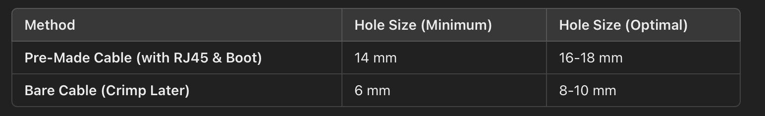

Adsibob Posted February 24, 2025 Posted February 24, 2025 As you may have picked up from a couple of other posts, I'm dealing with some scumbag burglars. Have decided to max out the credit card on a properly fitted burglar alarm that will hopefully get us a discount on next year's insurance (given the large claim I'm about to make on this year's) and some extra physical security measures, but that is proving expensive, so I need to scrimp on installation costs of the extra 3 or so cameras I want to install and see if I could do that myself. I realise there are two ways of doing this: I could drill larger holes and use pre-crimped Ethernet cables (with connectors attached) or drill smaller holes and use bare Ethernet cable that I'll then need to crimp after threading. According to chatGPT, this turns out to be quite a big difference in hole diameter: I will be drilling mostly through solid brick that then has EWI and render applied on the outside. I don't own a crimping tool or have any wire strippers, so I would need to buy that if I went down that route. The alternative of drilling larger holes is looking appealing, particularly since the ready made outdoor rated cables don't appear to be that much more expensive for the small amount I'll be using, see this one here: which for cables in the 7.5m to 10m range, work out at just over a £1 a metre: https://www.amazon.co.uk/Mygatti-Ethernet-Outdoor-Gigabit-Waterproof/dp/B0CYZRH36D?th=1, so about twice as much as buying bare cable, an additional cost which would be offset by the saving of not having to buy a crimping tool. So a few questions: Are there significant downsides of larger holes? Presumably it creates more of a space to plug, but if it's plugged properly, is there any other issue? To protect the cable from being cut by the scumbags, what sort of trunking do people use? I have to run a cable along a fence for a couple of metres, and then turn 90 degrees a couple of times, so whatever trunking I use needs to either be flexible or have 90 degree elbows that I can utilise. Is using a Hep 20 pipe a good idea? Alternative would be to use armoured CAT6 cable, but presumably this renders it too inflexible to achieve a 90 degree bend? How much for a decent crimping tool and is it really as easy as suggested below to do this:

Alan Ambrose Posted February 24, 2025 Posted February 24, 2025 Preciva do ok crimp tools cheap (can’t remember whether they have a cat5 tool) and a cat5 tool doesn’t have to very precise … unlike some kinds of crimp tools. You might well buy a simple cat5 cable tester as well, otherwise you’ll be unsure whether your cables are good. I find that as I only crimp a few of these every coupla years that I often need 2 or 3 attempts to get the hang of it again. Either ready crimped or bare cable can be used with some kind of mastic to make the through hole air and water tight. Bare cable has the advantage that it can be cut to length. I think I might put the cameras up high where they can’t be reached and/or used armoured or metal conduit. Also I think pir driven lights have the surprise factor and therefore a deterrent effect - dodgy people know that if they wear a hoodie they won’t be recognised at night on camera.
markc Posted February 24, 2025 Posted February 24, 2025 As above, cat5/6 RJ45 crimper for around £13 on Amazon, use pass through ends as these are significantly easier to fit. Bit fiddly for first few but you soon get the hang of it. Cheapie tester is worth its weight in gold at around £11 as this proves connection and correct wire orientation
