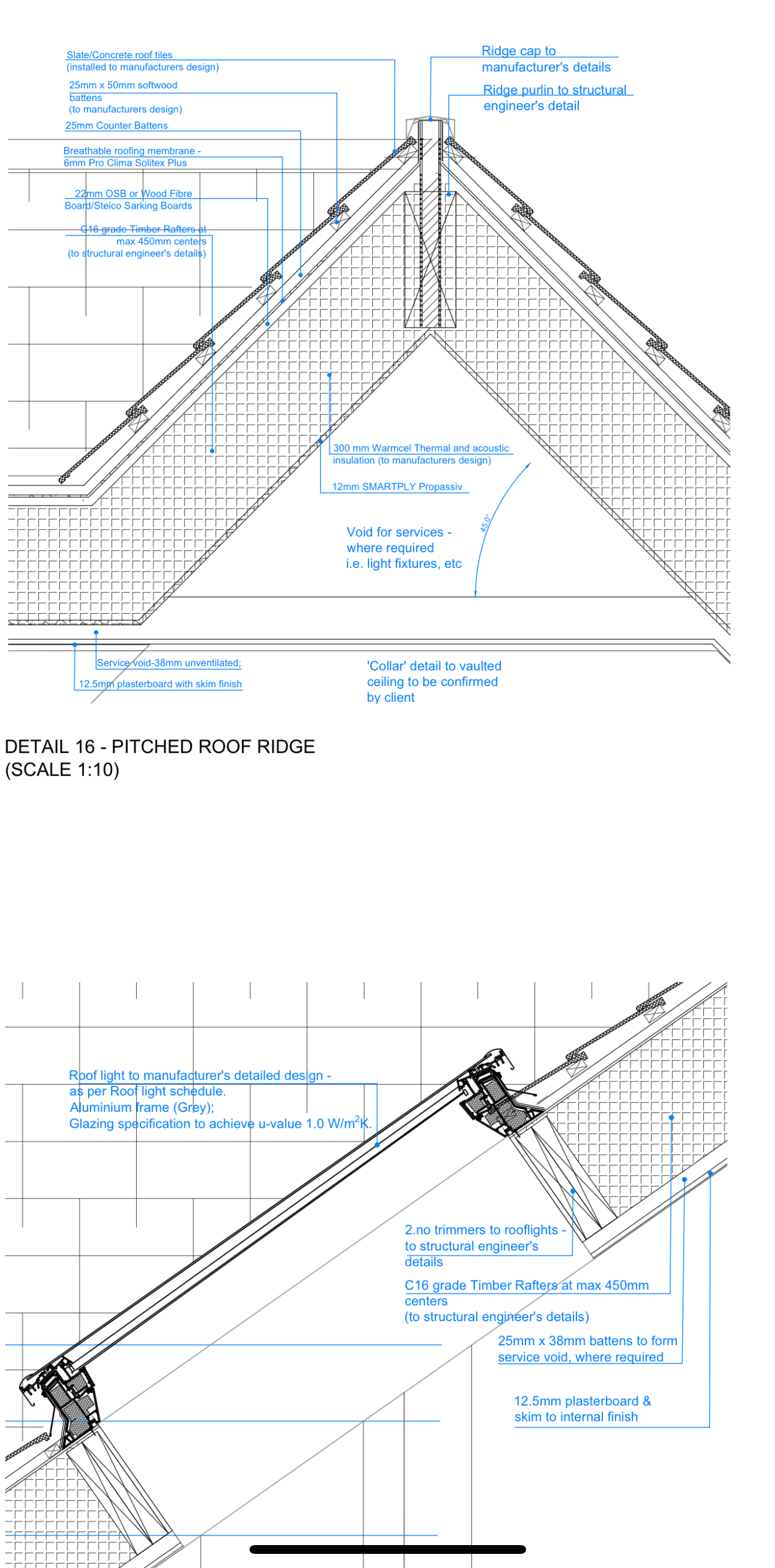

I was the OP and the first post on this thread is my makeup 👍
Ah yes of course. Are you having a service void? I had a calculation done similar to your build up with a 45mm mineral wool filled service void and using a 40mm woodfibre externally and got to 0.10W/m2K
Yes 38mm service void probably. 22mm steico woodfibre board. Haven’t thought of stuffing mineral wool in the service void… that will probably get me to 0.11 actually 👍

This is my makeup if it helps
The plan is vague stating slate or concrete tiles. But they both have a different roof build up. Concrete Tiles need the battens and counter battens on sarking boards, natural slate on the other hand, just needs the breather membrane on sarking boards and then the slates directly attached to sarking boards.
You can’t hang slates off a 22mm woodfibre sarking board. Depending where this is, Scotland slate roofs differently to the uk. Uk on to tile batons which is what this plan refers to I believe.
We are using slates and counter battening. Warmcel (cellulose provider) recommended counter battens.
No you can't. But as I said the roof build up is vague at best, at the wood fibre layer, there seems to be 3 options (OSB, wood fibre or sarking boards), which is pretty poor, there should be no options, it should state what is expected.
I love a vague plan. Thanks for the geography lesson, must have needed more sleep.
I asked the architects To pop the options on for contractor quoting because we hadn’t settled on a roof makeup 😉We have now.
We are using steico wood fibre sarking boards which do not recommend direct tile
fixing and recommend battens fixed through to rafters to pin the board on. So that’s what we are doing.
