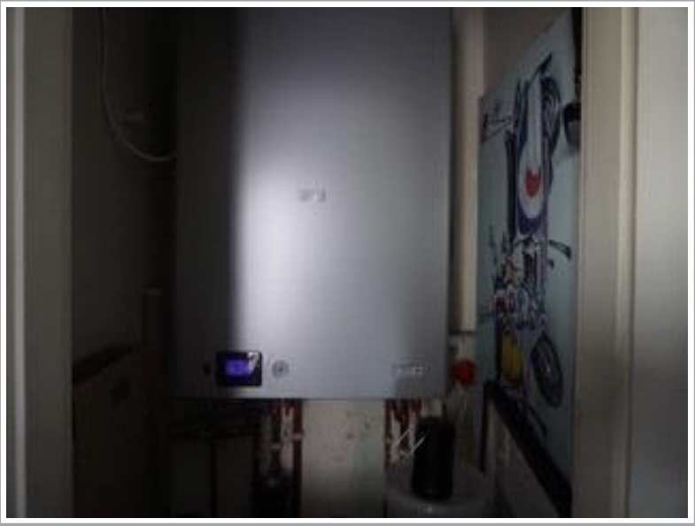

DevilDamo Posted February 15, 2025 Posted February 15, 2025 A house I am looking at buying has had the following mentioned within the Level 3 Survey… ”The property is heated by wall mounted radiators that receive their hot water from the electric boiler to be found in the cupboard in the main bedroom. I am told that this was installed 2 years ago by the current owners. This type of installation is unusual, it is possible that the electricians understanding of such systems may be limited because of this. It may well be the case that hot water supply may be a little limited because of the size of the reservoir. It is suggested that a plumber is consulted for a more definitive commentary.” Does this ring any alarm bells? In my current place, I have electric storage heaters so this is different in that water is now running into the rads?

Alan Ambrose Posted February 16, 2025 Posted February 16, 2025 I don’t think it’s much of a practical problem - except for running cost depending on the insulation. Plenty here have ‘willis heaters’ with wet UFH and good insulation - so same principle. Worth visiting while the weather’s cold and seeing whether there’s enough ooomf to get to comfortable temperature. Also maybe the size of their dec/jan elec bill. We have UFH with an elec boiler, one of the smaller things on this page: https://www.heatraesadia.com/products/heating-and-ventilation/electric-flow-boilers Works fine, but a bit expensive to run considering the insulation is not PH standard. Also a bit slow to heat the place from cold.

ProDave Posted February 16, 2025 Posted February 16, 2025 Electric boilers have always struck me as the most stupid idea. Why heat water with direct electricity in a big box and then pipe it to rooms via pipes into radiators? If you are going to heat with direct electric, just fit panel heaters. WHY the complication of an electric boiler? And most installs of an electric boiler just use a direct heated HW tank with an immersion heater, the boiler play no part. It would be just as absurd to use the boiler to pipe heat via an indirect coil to a hot water tank. The only electric boilers that make any sense are electric storage boilers and only if combined with something like an E10 tariff so you can heat the water at cheap rate and draw it at any time to heat the house. I suppose the only good point is having the pipes and radiators there, then there is a chance of relatively easily converting to an air source Heat Pump? 3
SteamyTea Posted February 17, 2025 Posted February 17, 2025 9 hours ago, ProDave said: Why heat water with direct electricity in a big box and then pipe it to rooms via pipes into radiators It is so you can charge and discharge at different times and powers. Just a more controlled storage heater.
ProDave Posted February 17, 2025 Posted February 17, 2025 1 hour ago, SteamyTea said: It is so you can charge and discharge at different times and powers. Just a more controlled storage heater. If it is a storage heater then yes, the central storage boiler is likely to retain heat better than a normal storage heater until you pump the hot water round to the radiators. But as i understand it this one is not storage. It is just a collection of electric heaters in a tank, i think they go up to about 12kW, that heats the water as it goes round. So it draws electricity when heating the radiators and not when it doesn't. Pretty useless on a TOU tariff unless your house is really well insulated. Most I see are on a normal single rate. My point is, if you don't have the advantage of storage and a TOU tariff, I fail to see what an electric boiler gives you that individual electric panel heaters does not.
