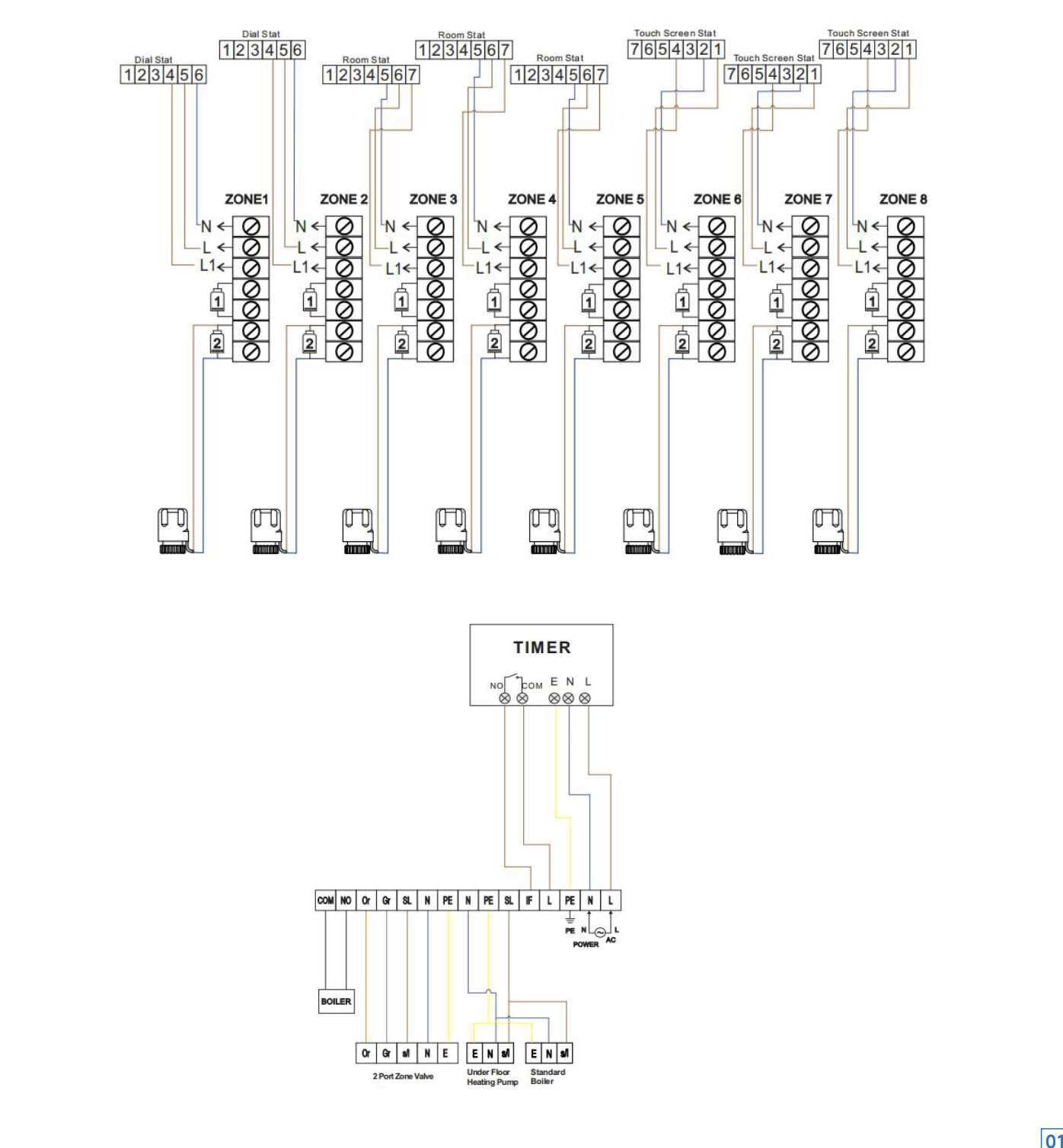

Need a workaround for this situation. Having retrofit UFH installed. Plumber installed the s-plan pipework for 2 zone (UFH + CH). Everything went to plan until we tried to connect the wiring centre to the boiler and hit a big snag.  There is no connection on the boiler for the COM/NO from the wiring centre. It's a Navien LCB700 oil and when we spoke to their tech support, they confirmed there is no connection.
Setup is:
ZONE 1 (CH/DHW) = Drayton 2 port zone valve to be wired to boiler via Honeywell wiring centre/terminal.
ZONE2 (UFH) = Drayton 2 port zone valve, 5 port manifold + 5 actuators, 5 wired room stats. Waterline wiring centre (diagram attached).
Everything hooks up to the UFH wiring centre correctly, but we can't connect the wiring centre to the boiler and we're both stumped.

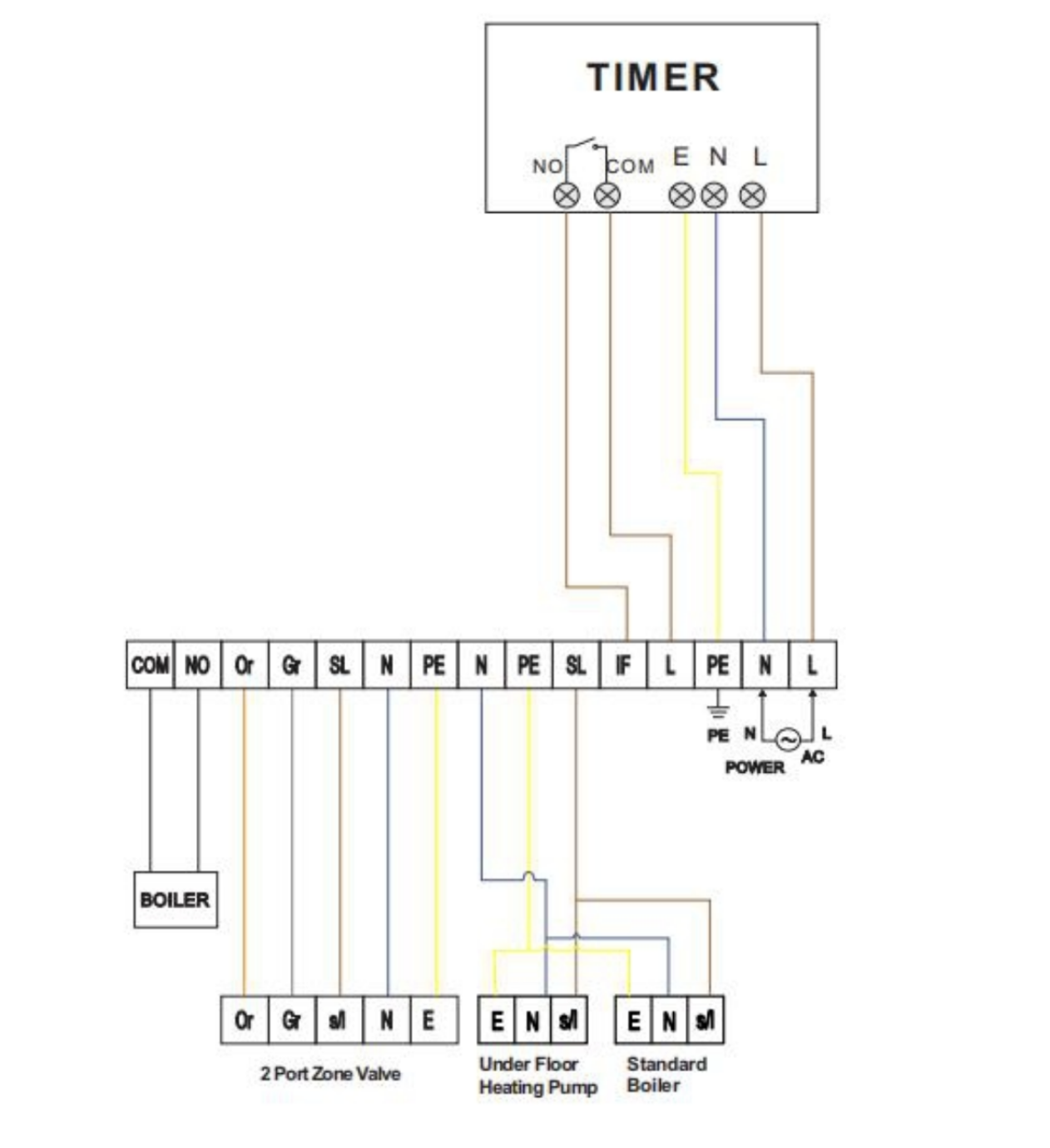

Would this work for the UFH zone?  Connect a timer to the wiring centre, and use the COM/NO connection on the timer instead. (Thinking of a Danfoss TS710). This way, leaving the timer on full time, the room stats will control the UFH.
The timer would connect to the boiler via the CONM4 terminal live/switched live. (See Navien diagram)

Can you post a higher resolution copy of the pictures. Even if I zoom in they are too blurred to read.
Or more simply, a boiler won't have a "com / no" connection, it will normally expect a switched L to fire it so connect L to Com and then the NO will be a switched L to fire the boiler.

The COM/NO connection here is a volt free/relay connection. It sends a signal from the wiring centre to the boiler to call for heat. Most boilers will have a 230v terminal side and a low/no volt terminal side on the main circuit board for connecting external controllers. This particular boiler doesn't and Navien confirmed it doesn't.  The plumber knows his stuff and has never came across this scenario before.

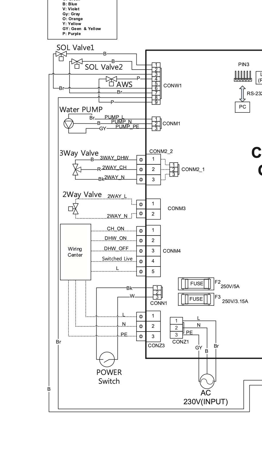

So what DOES the boiler have instead?  I have never seen a boiler that does not have some form of call for heat.
That is that terminal block in your diagram above?  Is that the boiler?  Wiring centre?  UFH controller?
What ate the terminals F and L?
Perhaps post a link to the instructions for your particular boiler?
None of the information so far is making sense (to me)

If you have a 230v signal that you want to connect to a zero volt arrangement you just isolate with a rely. £20 or so in TLC etc and job done.
Can you not energise the C of the timer from 230v L terminal, does the MI's not state this? Most are zero volt out of the box vs 230v out, so you can link L to C and energise the relay of the timer so it then gives 230v switched out.

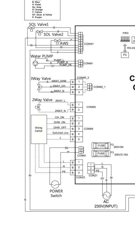

My reading of the drgs is that connecting the L or SL to the CH term of CONM4 is the call for heat from the Navien wiring centre. So wire your new UFH 8-way box to that either direct or with a £10 relay after checking what is going on with a neon screwdriver. E&OE.
Posted
Yes this.
I'm really confused. The installation manual clearly shows switched live from wiring centre to boiler terminal 4 on CONM4. This is connected to the two orange switched lives that come from dhw and ch 2-ports, which is standard in the wiring centre. So to add ufh, there will be a switched live from the ufh 8 zone wiring Centre, which is sometimes volt free and just needs a bridge to com on the wiring Centre itself, and Bob's your uncle.
Given the thread, this seems too simple. Or am I missing something?
That's my reading of it too. The problem is the drawings don't match the mainboard on the boiler. When we spoke with Navien tech about it, they walked us through and asked us to remove a jumper on the mainboard but when I said there was no jumper, they went "oh!".  I suspect the mainboard is a newer model and the manual refers to an earlier model. Waiting on Navien to come back to us meantime. As for the UFH 8 wiring centre, it's a nightmare. It has no branding, manufacturing batch number to go by. All I know is that it's a "Waterline" circuit board and there are different revisions of this particular circuit board and different manuals. As soon as Navien come back, I'll probably end up ditching the current UFH-8 wiring centre and buy a branded one.

I install naviens a lot, nice boiler. You just need a 240v signal to the switched live..use a relay if it's volt free from your wiring centre. It is a simple one. The jumper to remove will be between 4 and 5 on conm4

Nothing wrong with the UH-8 it does what it says and it provides a relay contact call for heat which can be wired as a volt free contact or a switched live, or anything else you care to imagine.  I would be very surprised if you went to the trouble of changing the UH-8 for something else if it would be any different.
