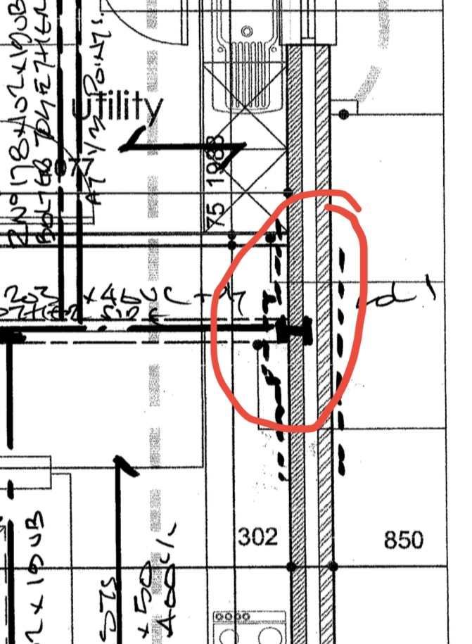

Simonharry Posted February 13 Posted February 13 (edited) Hi All, I’m new here and was hoping you could help. We are adding a wraparound extension to our 1930’s semi and the structural engineer has spec’d “goalpost” steels across the back of the original rear wall, supported at 3 points by UC steels on concrete pads. Two of the pads will be under the existing suspended timber floor and will require “pits” to be dug however one of them will be effectively on top of / in line with the new foundations. The pad required is 700Lx700Wx300Deep and the foundation is 600wide x 450deep. My question is how do I create the required pad? Do I simply widen the foundation at that point to the 700x700 dimension and utilise the additional depth of the foundation? The steel will be below ground level if I do the above once backfilled and concrete goes down for floors so my next question is……How do I protect the steelwork that’s below ground level from rust, degradation over time? Hope the above is clear but happy to elaborate further if needed. Thanks Simon Edited February 13 by Simonharry

Simonharry Posted February 13 Author Posted February 13 Is it feasible to sit the column in line with the inner block work of the cavity wall to avoid it creating a large pillar in what will be the kitchen cabinet wall? how will the dpc/cavity tray work if so as there will be a gap in that inner skin where the steel sits. Thanks for the responses so far.
Mr Punter Posted February 13 Posted February 13 Yes you can have it in the cavity but it will be a cold bridge. Best to have a bit of insulation around it. You will paint the bottom metre or so with bitumen paint. No issue with DPC. If you have a cavity tray running around the wall you will need to stop it either side of the steel. 1
Russell griffiths Posted February 13 Posted February 13 What is going on the inner wall, insulated plasterboard, or just dot n dab boards. if you are having a lot of wall units you might want to fit something to the wall to fix the units to. whatever you do I’m sure you can pad the surface out enough to fly over the face of the steel to hide it. or talk to the engineer and see what you can do to change the size of the post.
