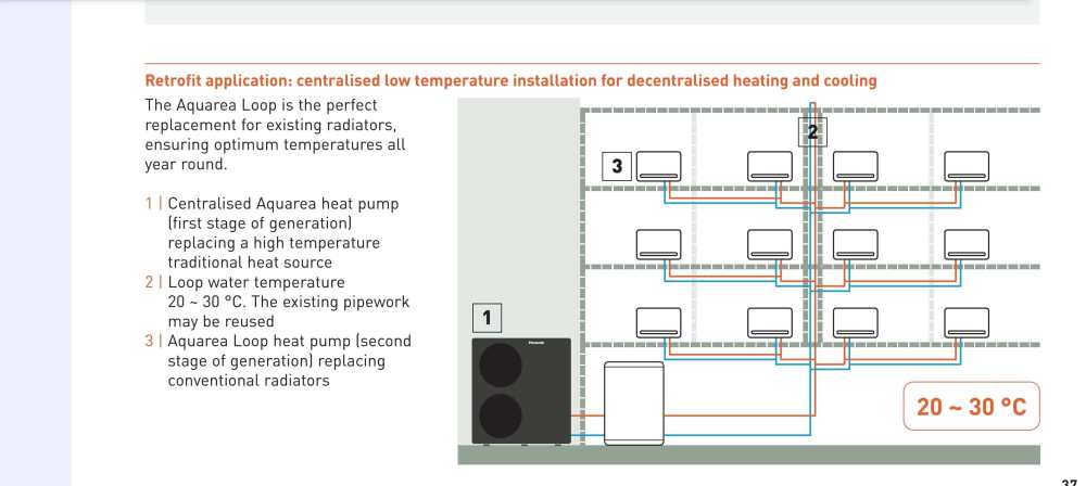

joth Posted February 12, 2025 Posted February 12, 2025 https://www.aircon.panasonic.eu/GB_en/news/new/panasonics-aquarea-loop-transforms-retrofit-heating-and-cooling-with-decentralised-water-to-air-heat-pump-technology/ Not strictly about ASHP as it's a (decentralised ) water sourced heat pump. Essentially a wall mounted fan coil with a mini heat pump built in. So long as the building has a circuit of water maintained at 20-30°C this can either draw heat out of it, or dump heat into it, in order to service the needs of the room it is installed in. And genius addition is an accessory to allow any condensation to be injected into the circulation pipe to be removed. So in a quirky property you may have heating in some places and cooling in others at the same time, and the temperatures would balance out n More typically some external heat source/sink would be need to balance it, so far I've not found recommendations on that but 20-30° is a wide enough operating window it could be done pretty efficiently and opens innovative possibilities. Likewise imagine hooking the DHW reheat into the circuit should be simple step too. Probably good in apartment blocks too. Will follow how this works out with interest. 1

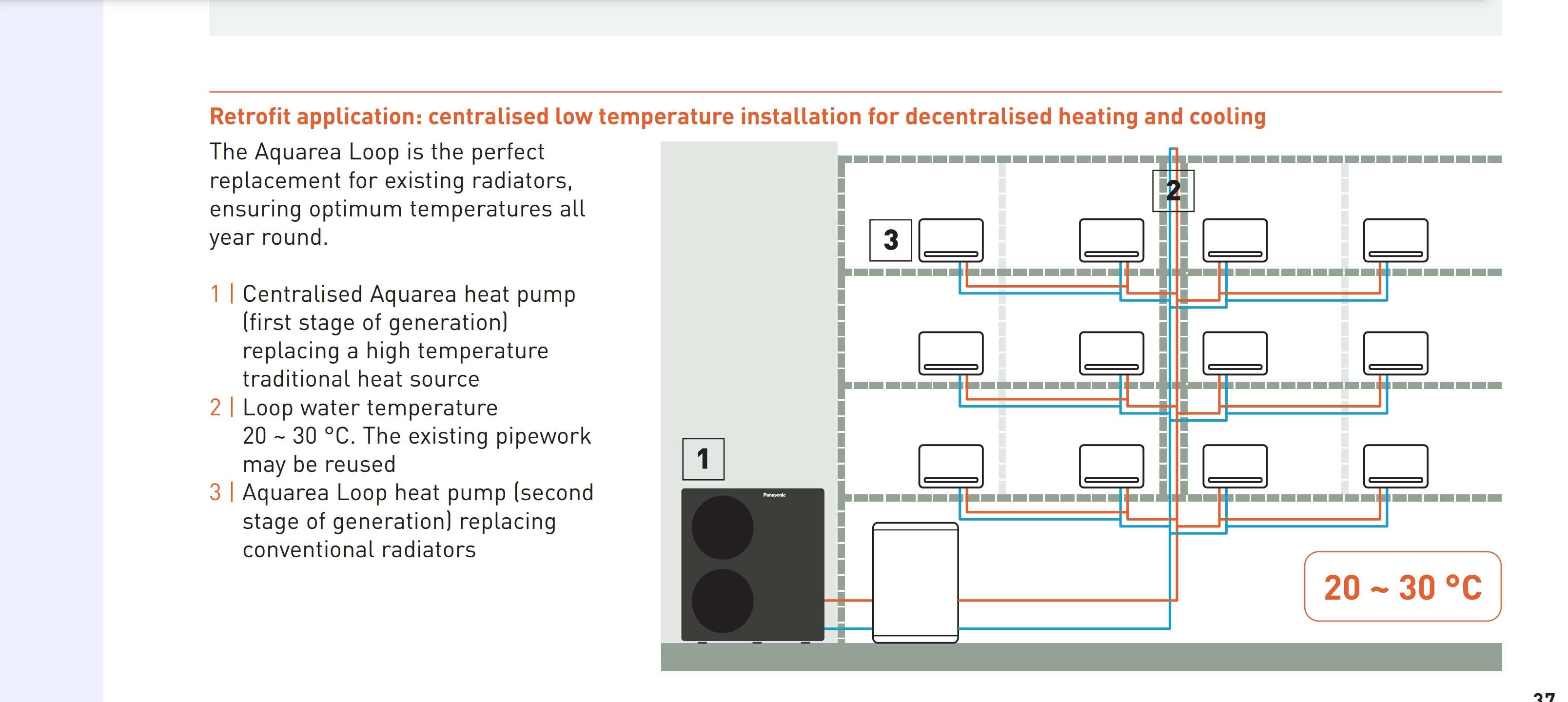

JohnMo Posted February 12, 2025 Posted February 12, 2025 It's not quite what it seems. You have an external ASHP this is the first point of heat or cool, the other units add to this heat e

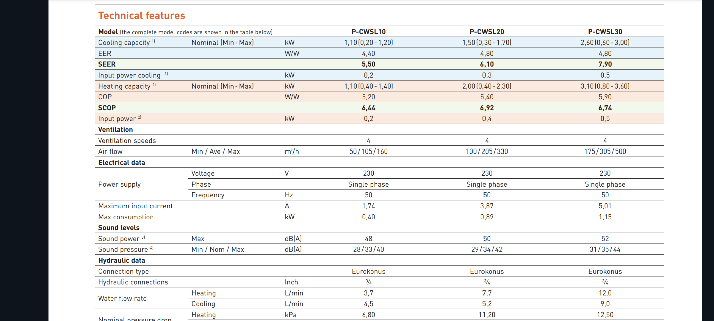

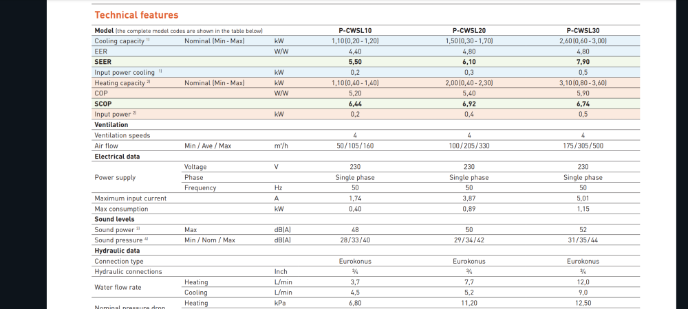

joth Posted February 12, 2025 Author Posted February 12, 2025 (edited) 1 hour ago, -rick- said: Not sure I'd want the noise of the heatpump in my bedroom. Would expect it to be much noisier than a normal FCU. Yes exactly what I was thinking too, what with it not having a ducted version (yet) either. I found this ("Tentative") data sheet for it https://cdn.aircon.panasonic.eu/uploads/DE/Catalogues/2024/Tentative Flyer Aquarea Loop.pdf 28 dB(A) minimum noise, doesn't sound much.. but one number never captures the whole story Edited February 12, 2025 by joth
joth Posted February 12, 2025 Author Posted February 12, 2025 4 minutes ago, JohnMo said: It's not quite what it seems. You have an external ASHP this is the first point of heat or cool, the other units add to this heat e Yes I found that pdf now too, pretty much what I was imagining and alluding to. Be interesting how the whole system performs with the stacked SCOPs. Certainly the 6-7 SCOP of the indoor unit on its own is only part of the picture. It's convenient in a big apartment block it naturally distributes much of the running cost across the properties though, especially if there is a mix of heating and cooling needs occuring. (Sunny vs shaded side etc)
JohnMo Posted February 13, 2025 Posted February 13, 2025 So basically sometime one of these, but with a feed loop being reheated by the heat pump. Instead of water going down drain https://www.powrmatic.co.uk/products/air-conditioning/powrmatic-vision-h20/
