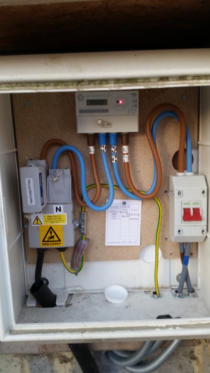

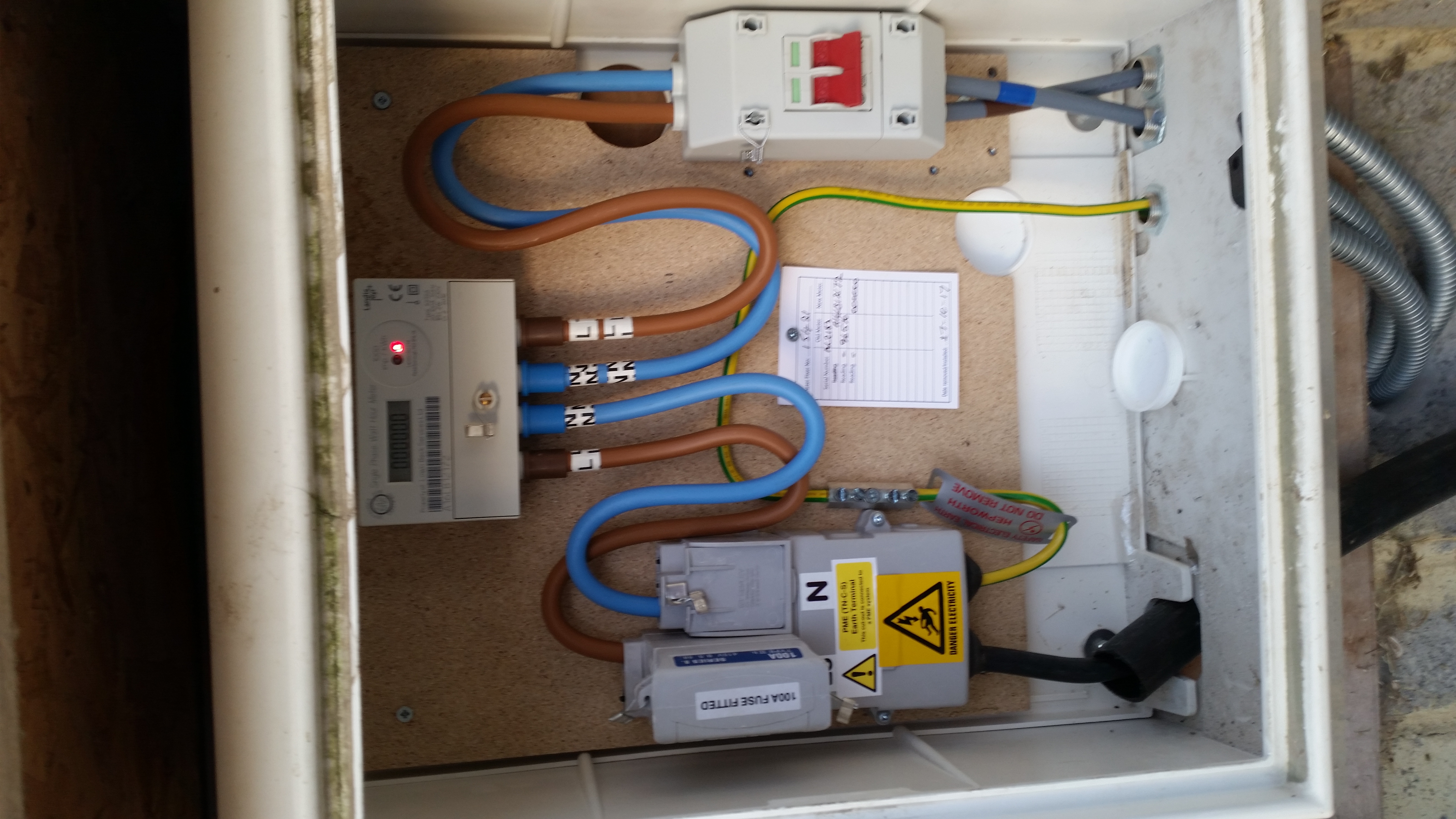

My vote would be a switch fuse in the meter box to feed the house, and a CU inside the piggery for it's own stuff. Keep the piggery CU within 3 metres of the meter box to prevent that too needing it's own switch fuse (i.e just put it on the inside of the wall backing on to the meter box)
So out of isolator into a pair of henley blocks, from those to the switch fuse with one pair of tails and through the wall into the piggery with the other.

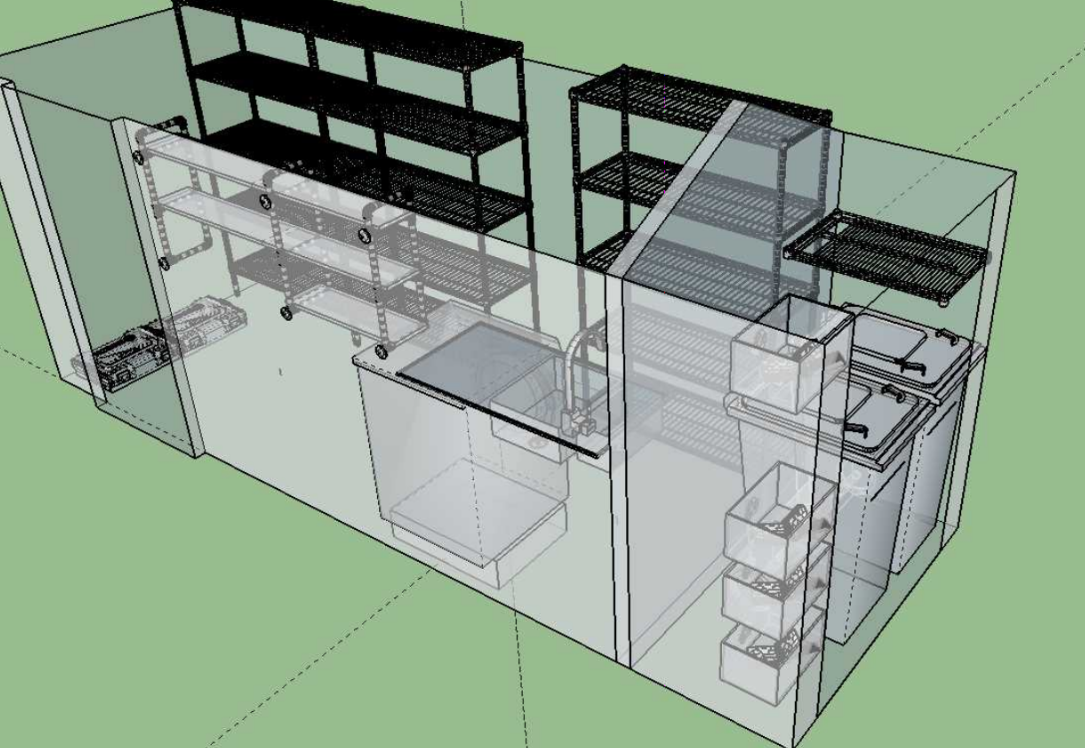

One gable end has been partly removed and so is open to the elements: that's where the bins and meter box are,  still covered by the roof .  Its a bit like a large sentry box. The meter is in an external meter box on the inside of the 'sentry box' wall.
 Like this..... (meter box not illustrated because its hidden by the bins)

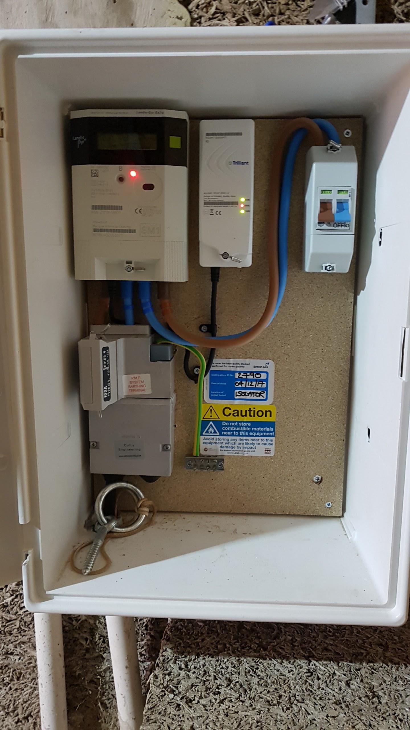

1 hour ago, ProDave said:
By the way, is that one of those smart meter thingies? Did you choose that or was it forced upon you?
Yes, it is the back end of a smart meter; and I have been given the gubbins for use inside the house.  I remember reading (you perhaps?) outlining why they aren't all that good an idea.
But the whole job was free, so maybe I cannot moan too much.......
Just for my own education...
Can you put the Henley block before a pair of isolators (one per CU) or must it go after an isolator?
You could fit Henleys before (with seals of course), it is done. They are fit for purpose.
Now though, it's after the event so to speak, you would have to cut THEIR, the DNO/supplier's seal on the REC2. Some use numbered seals & record, some don't.
You'll have isolation anyway at each cu via the DP switch in each.
One REC2 is fine. Another is just more terminals to go loose!

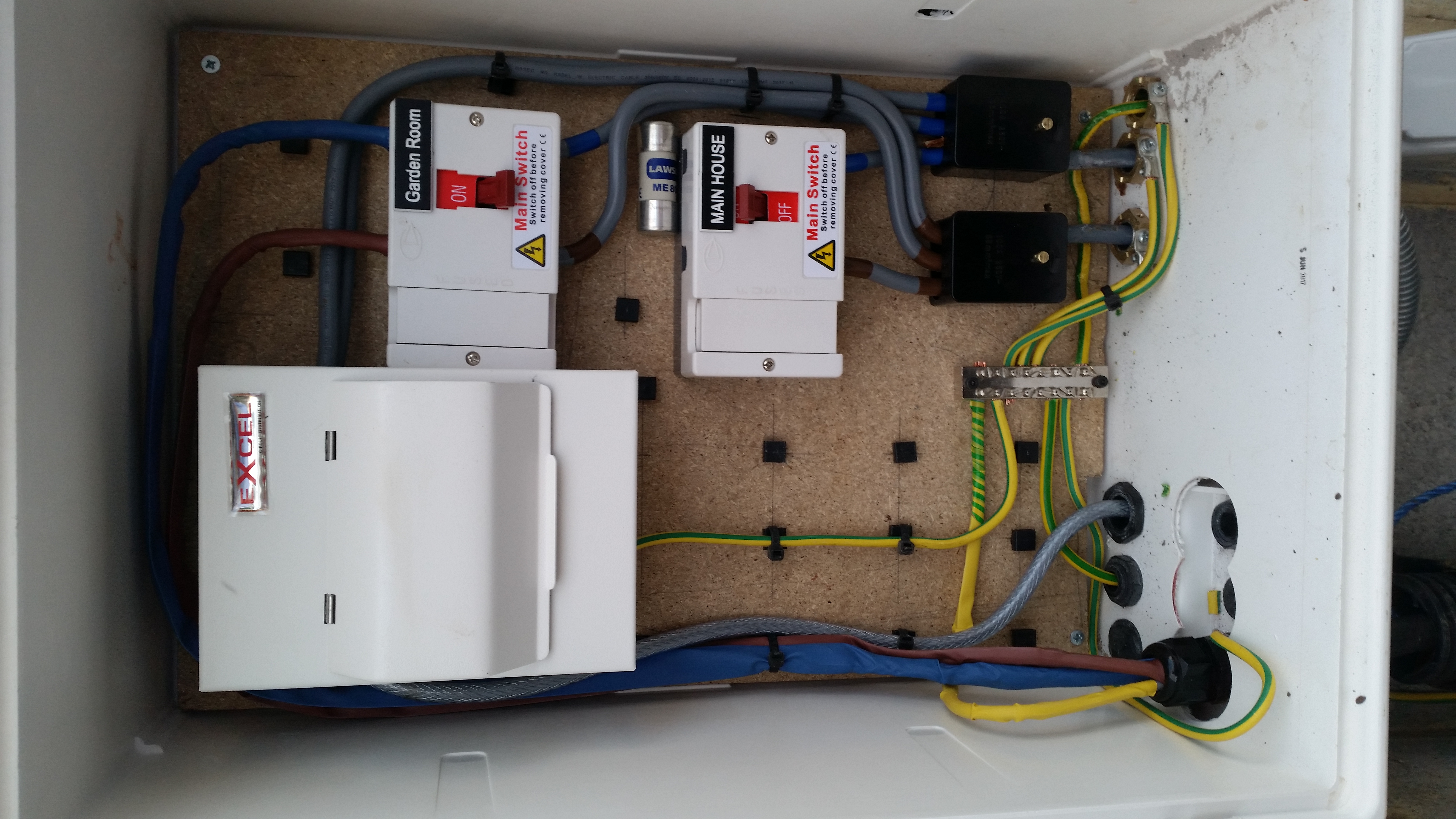

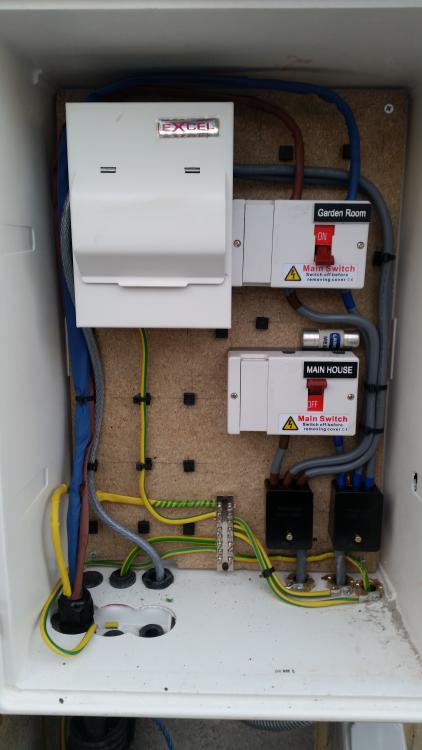

We decided to have a second panel that split the power between the two buildings as there was not room in the meter panel for the distribution switches (IMO) it could have been squeezed in but the switch fuse idea that @ProDave suggests might not make it into your box either. So our meter panel looks a bit likes yours but without the very smart meter and the second panel distributes the power to the main house CU and the garden room CU in your case you could substitute the piggery CU for the garden room.
PS the excel panel (will eventually) provides a few additional outputs including the garden lighting, a car charger point and a local commando socket for outdoor power.
