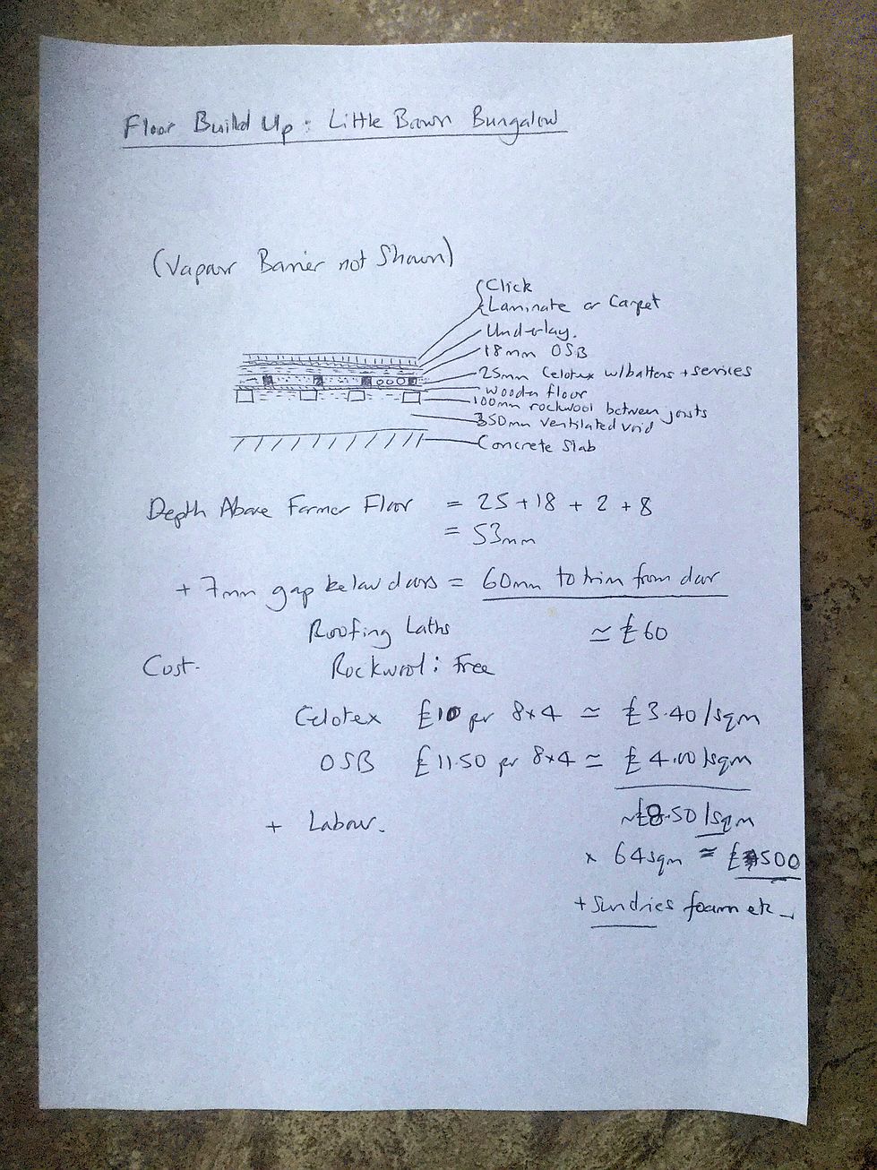

Ferdinand Posted December 6, 2017 Author Posted December 6, 2017 (edited) Floor Buildup for Little Brown Bungalow. U-value = 0.23 (ignoring joists). Thickness above old floor = 53mm. Service cavities run alongside some internal walls. Calculations look slightly off but it is under £10 per sqm. Edited December 6, 2017 by Ferdinand
pdf27 Posted December 7, 2017 Posted December 7, 2017 I'm not sure how much going the extra mile on floor insulation would really help you. Shifting from 0.23 to 0.12 saves: (0.23-0.12) x (64m2) x (30+3 C) = 230W. at roughly the design low temperature condition (-3C for me) and assuming underfloor heating running at 30C for a heat pump. It adds up over a year if you're going for a particular standard like Passivhaus, but if you aren't then the value of additional insulation is really pretty small. I would also be wary of what is available with a ventilated underfloor cavity - the advice we got from our architects was that the ventilation itself makes improving the U-value up to around the 0.1 level almost impossible, but replacing the whole thing with an insulated concrete slab is horribly expensive, so I think you've done about all that is feasible on a retrofit. You've already discussed external wall insulation and airtightness - realistically EWI should help with airtightness a bit , but I think if you're trying to reduce heat demand then this is the place to go. One thing that might be worthwhile considering if you're chasing SAP points is a shower heat exchanger. That's harder but not impossible in a bungalow (you have to use the drain type rather than the vertical pipe type, which is more expensive and less effective), with something like 50% recovery being feasible. For my current bungalow (3 bed), SAP would probably interpret that as saving 1,000 kWh/year. Fitting it to the only bathroom which would presumably be being ripped out and replaced anyway is probably not too painfully expensive, particularly if it's an alternative to other means of compliance.

Ferdinand Posted December 7, 2017 Author Posted December 7, 2017 (edited) @pdf27 Thanks - useful comments. If I take an engineering approximation and say that your 230W peak saving saves an equivalent of 100w over the entire year for ufh (assuming I find a way of doing ufh :-), that would be say £0.1 per unit for 9000 hours = £90 per year. If we call it £30-50 per year as a buffer for my approximations, then that suggests that it might be worth spending £100-£200 for a marginal improvement to a u-value of 0.18 and £300-400 for an improvement to 0.12 (-ish), if extra material can be installed without consequences and extra labour when the floor is up. That would probably leave as realistic options: 1 - a little more insulation in the over-floor for 0.18. 2 - or complete removal of the ventilatd cavity via pumped insulation / sealing air bricks, which could also be costed against the labour of lifting the floor, and a chap with a staple gun and rolls of rockwool for a couple of days, and the insulation in the over-floor. Both might be viable options, depending on the circs. I'm not competely heartless, so I am usually willing to do a bit extra if it is the right thing for the sake of a few ££. Unfortunately, EWI will not be viable for me here without at least a 50-70% grant. I had quotes and they were coming in at £8.5-£11k, even with us doing some things. And a small bungalow is the easiest type of building to EWI. In the event I have settled for installing all my 2G with extended windowsills should the EWI be realistic in the future. It is still a payback of many decades, as it would be 130sqm of wall with a u-value reduction of 0.55 to 0.22 (ish). I make the calculation to be money saved per annum by transmission if the heating was on 24*365 approx = 130 sqm * 0.33 u-value reduction * 12 C ave. temperature difference * 0.001 to give kWh * 0.05 £/Kw * 8760 hours / yr = £225, without the air leakage, and ignoring all kinds of subsidiary effects. EPC says the heating bill may be £300 a year, and removing the whole thing would be a 20-30 year payback. Ergo not viable. But I need to improve my heat modelling skills. Ferdinand Edited December 7, 2017 by Ferdinand
A_L Posted December 7, 2017 Posted December 7, 2017 On 06/12/2017 at 07:56, Ferdinand said: c - I am not sure that I agree entirely with your "c" reply. Expand On 07/12/2017 at 07:29, Ferdinand said: 1 - a little more insulation in the over-floor for 0.18. Expand - a reduction of floor U-value from 0.23 to 0.18 will save about 4kWh/yr/m2 , a reduction to 0.1 will save about 9kWh/yr/m2 (Full SAP model) On 06/12/2017 at 07:56, Ferdinand said: I estimate that 300-350mm of EPS beads would give me a u-value of 0.10-0.12, which may be worth it if it put me in a position to use an ASHP not a Gas Boiler. Expand - I know from the winter of 2010 I could heat my house, on a continuous basis, with 6kW heat input. - A quick estimate using your existing U-values suggests a 7KW boiler size (including hot water), so I think a 10kW ASHP with appropriate heat emitters would do already.

pdf27 Posted December 7, 2017 Posted December 7, 2017 On 07/12/2017 at 07:29, Ferdinand said: @pdf27 Thanks - useful comments. If I take an engineering approximation and say that your 230W peak saving saves an equivalent of 100w over the entire year for ufh (assuming I find a way of doing ufh :-), that would be say £0.1 per unit for 9000 hours = £90 per year. If we call it £30-50 per year as a buffer for my approximations, then that suggests that it might be worth spending £100-£200 for a marginal improvement to a u-value of 0.18 and £300-400 for an improvement to 0.12 (-ish), if extra material can be installed without consequences and extra labour when the floor is up. That would probably leave as realistic options: 1 - a little more insulation in the over-floor for 0.18. 2 - or complete removal of the ventilatd cavity via pumped insulation / sealing air bricks, which could also be costed against the labour of lifting the floor, and a chap with a staple gun and rolls of rockwool for a couple of days, and the insulation in the over-floor. Both might be viable options, depending on the circs. I'm not competely heartless, so I am usually willing to do a bit extra if it is the right thing for the sake of a few ££. Unfortunately, EWI will not be viable for me here without at least a 50-70% grant. I had quotes and they were coming in at £8.5-£11k, even with us doing some things. And a small bungalow is the easiest type of building to EWI. In the event I have settled for installing all my 2G with extended windowsills should the EWI be realistic in the future. It is still a payback of many decades, as it would be 130sqm of wall with a u-value reduction of 0.55 to 0.22 (ish). I make the calculation to be money saved per annum by transmission if the heating was on 24*365 approx = 130 sqm * 0.33 u-value reduction * 12 C ave. temperature difference * 0.001 to give kWh * 0.05 £/Kw * 8760 hours / yr = £225, without the air leakage, and ignoring all kinds of subsidiary effects. EPC says the heating bill may be £300 a year, and removing the whole thing would be a 20-30 year payback. Ergo not viable. But I need to improve my heat modelling skills. Ferdinand Expand Umm... one thing to be aware of if you stick with radiators is that the temperature difference between the floor and the outside world will drop a lot - with underfloor I've assumed 30C because the floor will be heated to keep the rest of the house warm. If you're using radiators then 18C is more realistic since the floor will be the surface the radiators find hardest to heat. That moves the peak heat loss down to about 150W or so, and more importantly for most of the heating season it's about 50W or so since the difference between floor and outside temperature is so much lower without the floor being used as a heat emitter. In other words, the £2-300 you've calculated is only valid for underfloor heating - shift to radiators and the value drops to something in the region of £100 - £1-2 per m2. That's why I don't think anything extra is worthwhile unless you're chasing certificates - the cash benefit of doing so is pretty small already. That's why I was looking at other things - chasing the last few Watts is always a painful and expensive job.
