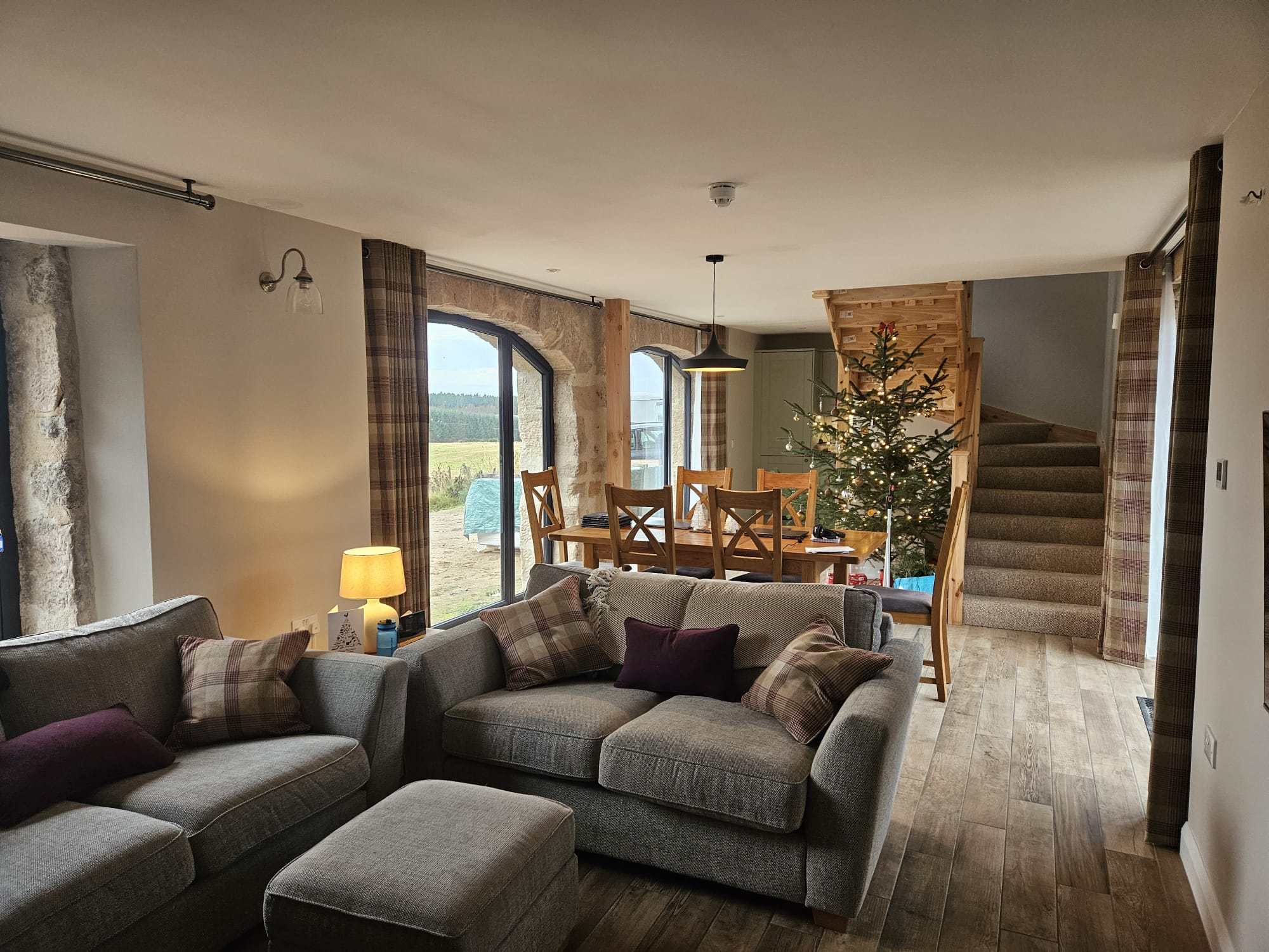

For completeness, We had, and have, 4 sides and a central courtyard, with 3 retained sides, as described, but the 4th side had to be removed and rebuilt as if a new house.  That was stick built.
You can see here at the window reveal, the stone as was and the amount of inner lining. there is clear air and dpm between the two elements.  That loss of room width bothered us at first but there was no option really, and it's fine.
There is heat loss through the stone of course but it is art and heritage in place of ultimate insulation and the BCO agreed it was a good thing.  The rest of the house is fully insulated.
The Scottish reg's allow pragmatism in conversions.
