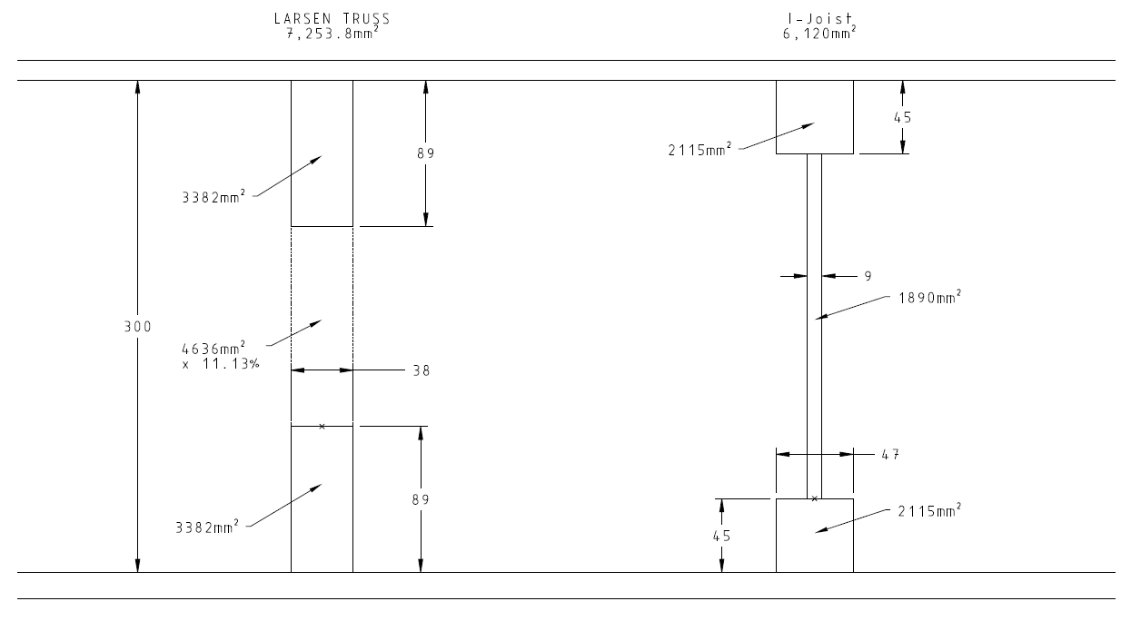

I don't know that the advantage of a Larsen Truss frame is thermal bridging within the wall structure. When you compare the two systems,  I-Joist may have a lower timber fraction than Twin-Stud.
The below is making assumptions on the timber sizes within a Larsen Truss based on images I have found, if someone can come up with better timber sizes I'm happy to update. For the centre nogging I've assumed 3 noggings within a 2.4m panel.
***Updated after JSHarris reply below
I'm surprised MBC appear to use 4x2 for the noggings, I would have thought they could get away with thin ply, but that's not what the pictures show that I could find. I've also always wondered why, if the outer stud is non-structural, why it's not a smaller section than the inner stud.

There's only three noggins per storey, though, with a twin stud.  and the timber is standard stud work timber, so 89 x 38, inside and out.  The noggins are also 89 x 38, as are the top and bottom plates.
The fill point is really more about speed, as every bay has an individual fill hole at the top with a twin stud wall, just as with an I beam.  The difference is that the cellulose partially fills the adjacent bays through the big gaps, so once the first bay has been filled the rest along a run are a bit quicker.  The high pressure ensures the fill is even, either way.
Thanks for the timber sizing, the original drawing has been updated and that brings the timber fraction more similar. The difference is now not decisive on whether to use one option or another.
I still see an opportunity to improve the twin-stud over what I have drawn, reducing the thermal bridge further.
I'm sure it's a combination of simplifying the machinery/jigs they use for cutting and assembly, and minimising the number of material types they need to keep in stock.
Also, the outer stud does have panels attached to it, plus may need to hold potentially heavy cladding. I think it would be a challenge to greatly reduce the cross section of the outer stud while still providing a good fixing for, eg, battens.
The I-Joists outer flange at 47x45 does the same functions (+structural support), so the section could reduce to this. And the web could likely be ply as other manufacturers of Larsen Truss use.
But we're into the arena of small gains so it is likely, as you say, that the choice is one of simplified stock rather than achieving ever gain possible.
