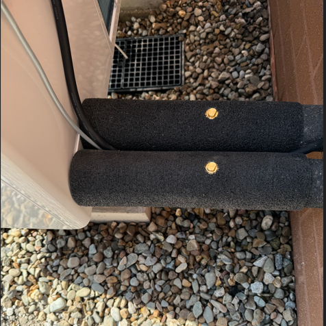

As you can see from the photo (workmanship aside for now), there appears to be flexible pipes going through the inner leaf without insulation. When it passes through the outer brick it looks to have been treated with foam and cement.
Report MCS, that is rubbish. Looks like a monkey did it.
The grey cables are exposed to UV, so unless they are specifically designed for that, the insulation will fail.
Let me just say, that was one of the better points of the installation. The point of this thread is to establish if the plumbing and electrical work was done to a standard that would raise concerns with MCS and Napit.
I need to tread carefully until I can gather further information on the contractors, and investigate all the other electrical and pipework. So far, the overall installation is not looking good, the only positive is the HP appears to function.

The flexible pipes form the ASHP unit are designed to absorb any vibration from the ASHP unit and should connect to rigid pipes before entering the building as far as I understand and is what I have done.
Bare electrical cable outside? no no no. (not even cables used for controls)

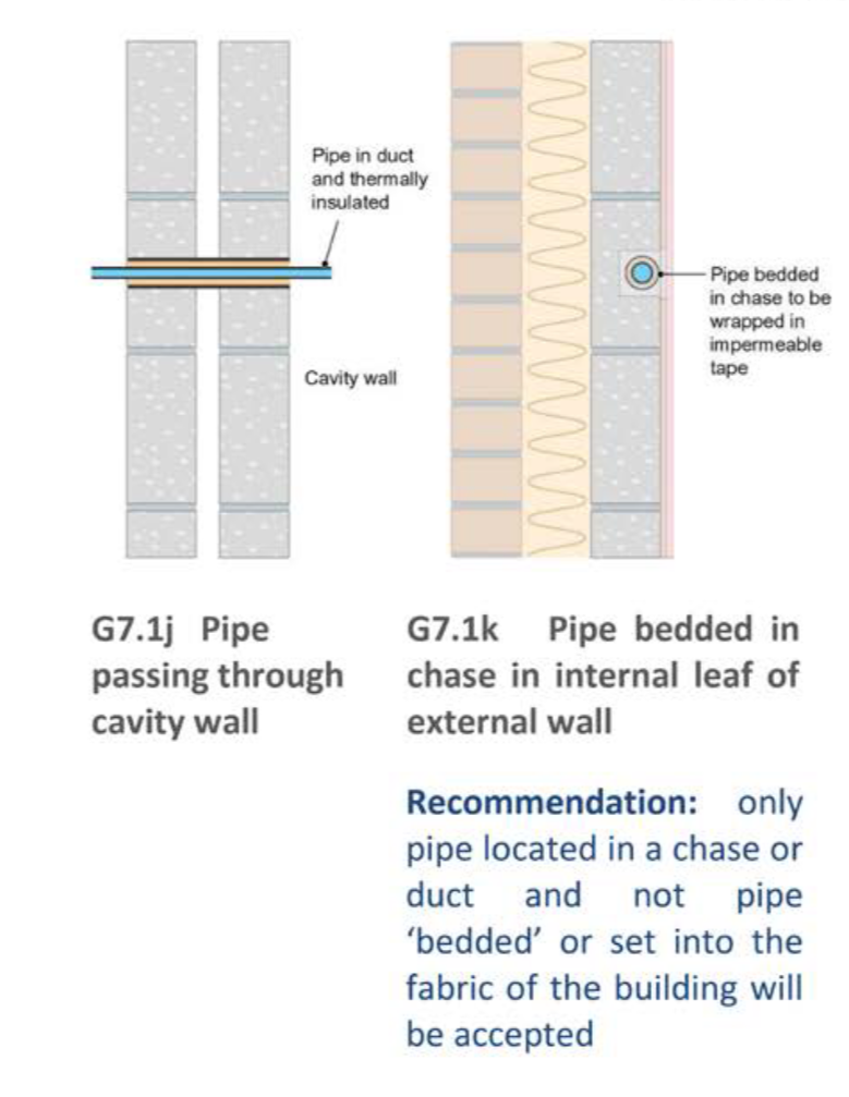

@Egnaro, I have spent a little time researching this.
I am pretty confident that BR, NHBC, Water Regs, CIPHE all say that a pipe passing through a wall must be sleeved.
I found this reference in the Plumbing level 2 NVQ course book I have.
“All pipes that pass through wall structures must be sleeved.”
Here is an attached image from WRAS
I don’t know if that helps.

WRS regs can be misinterpreted, but ultimately they do say any pipework through a wall has to be sleeved as noted above by @Nick Laslett
However, much of this is now a moot point as the installation criteria laid out by the Heat Pump manufacturer specifies pipes do indeed have to be sleeved and insulated when going through walls :)
