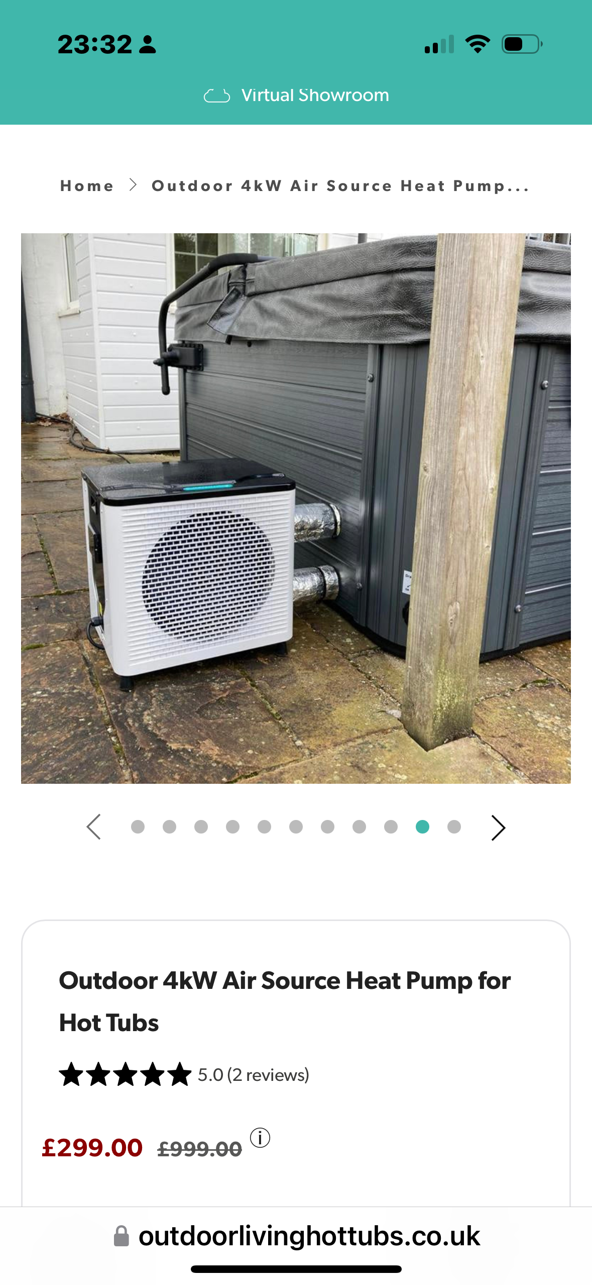

mike2016 Posted February 5, 2025 Author Posted February 5, 2025 Seen those! I've A2A for space heating & cooling and a separate heat pump hot water tank so a third heat pump is an option but more holes in the wall!!!

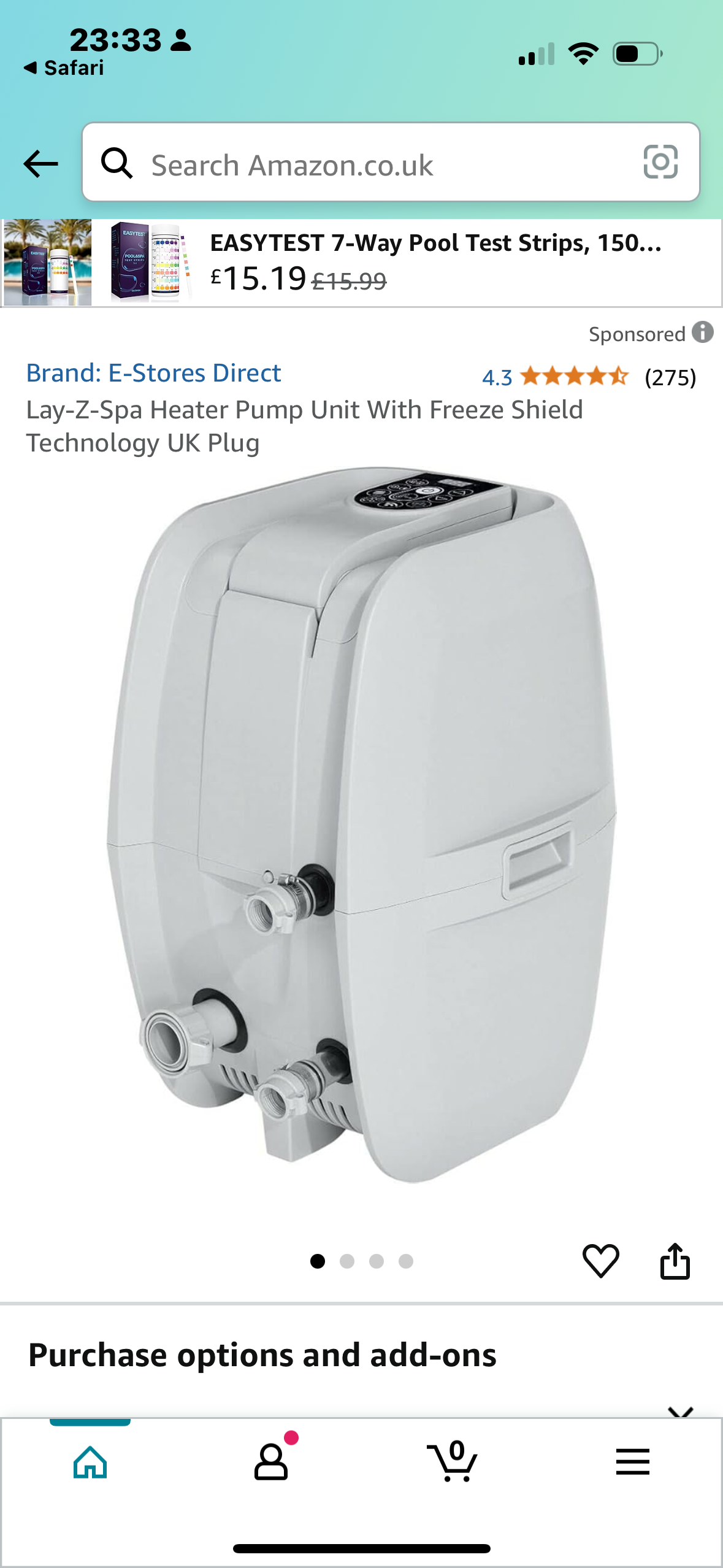

Nickfromwales Posted February 5, 2025 Posted February 5, 2025 Heat direct with a small pool ASHP is a no brainer here, get a little portable outdoor unit and plug n play? or simpler again is: for change of £200, but direct electricity.

mike2016 Posted February 6, 2025 Author Posted February 6, 2025 I'll have MVHR and hope keeping the tub covered will handle the humidity, don't want the MVHR in boost all the time!! I've no underfloor heating only A2A. Will probably just run an inline water heater as you say looping it into the hot tank would add pressure to the heat pump there. I can always loop it in later by keeping all the pipework etc in the utility room. Don't really want an additional outdoor unit & heat pump at this stage but could add later if required.
