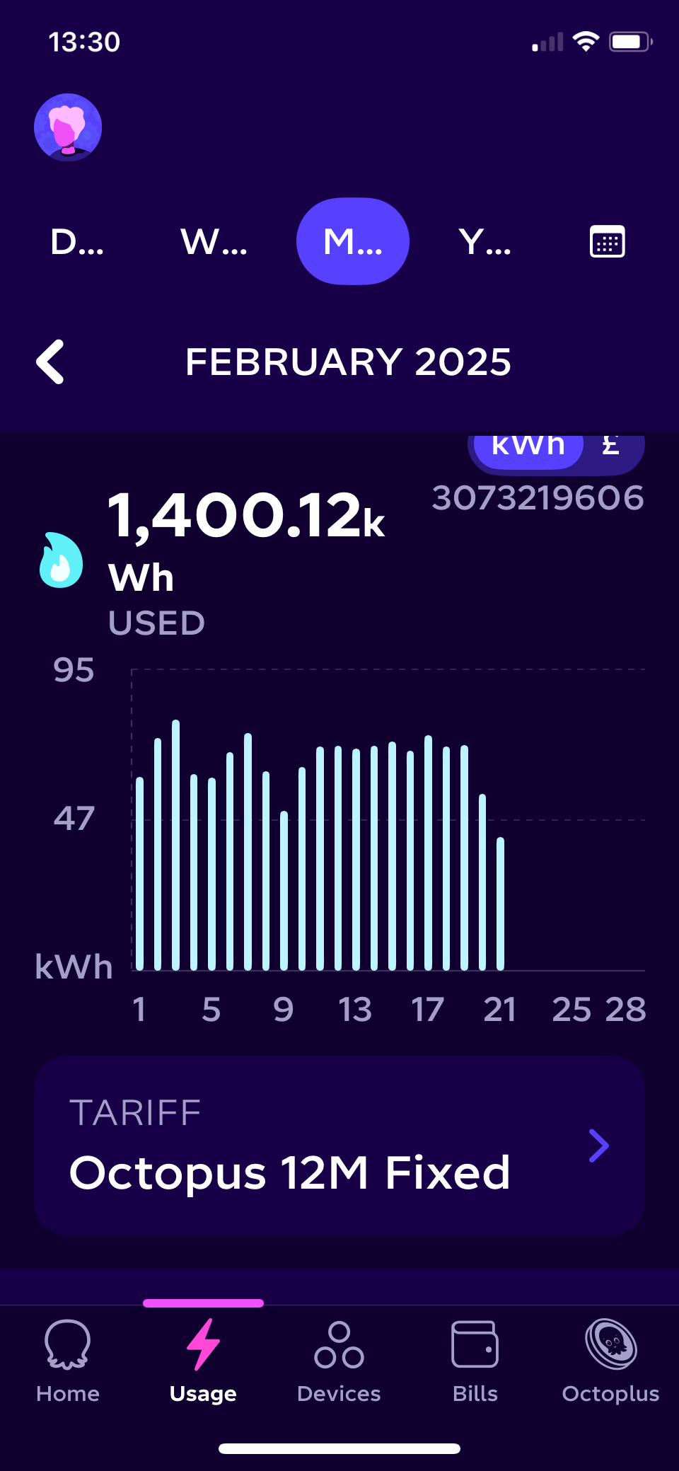

I'm going to give that a try for a few days and see what the gas consumption looks like - at the moment, it works quite hard from 4-5:30 every morning to lift the temperature, and whilst it's been around 5 degrees outside, we've been using 85kWh a day, which feels like a lot to me.

if it feels like a lot it probably is but is house specific
my daily for feb so far (4 bed detached heating 24/7 with room temps from 18 to 22)
the minus overnight temps are the peak days (70 kWh ish)IMG_5490.thumb.png.73b3b16f94e521e0484a4821fdff0a20.png
