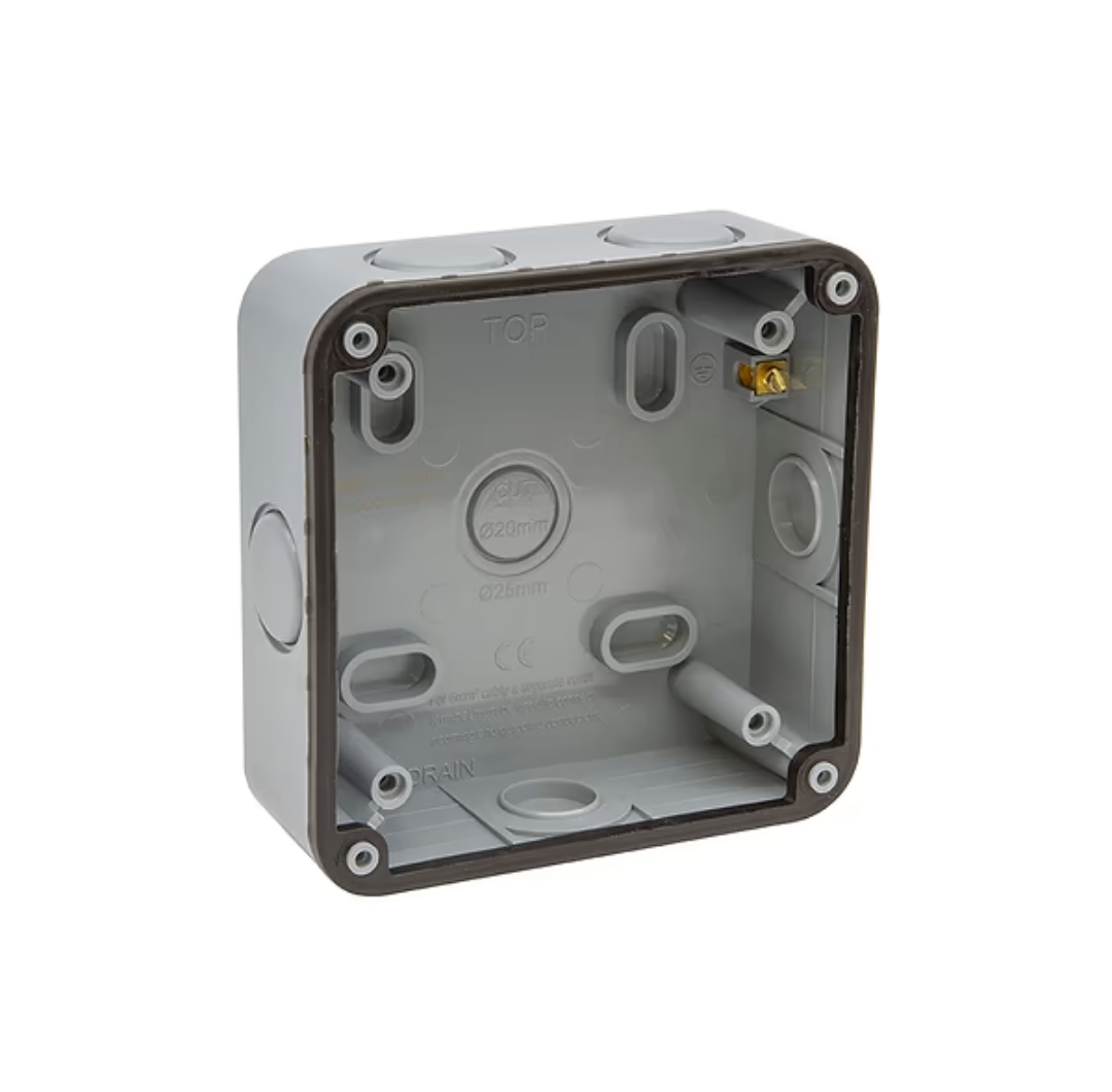

I've got some 2.5mm t+e coming out of the side of the house (near the top of the wall) through some fibre cement cladding.  the wires will go eventually to a junction box  and then via conduit into a sewage pump.
I've seen that there are metal junction boxes that are rear entry but I don't see the same in the plastics range.  Are they available?  or are there other solutions for making things nice and weatherproof from the wall to a junction box?

You can get plain plastic boxes or ones with preset hole positions in the back and sides. Usually for 20 or 25mm dia holes.
You'll usually find the appropriate hole saw (with the pilot removed) will engage/line up with the presets so as not to slip:

On 31/01/2025 at 17:31, ProDave said:
Plastic boxes you just drill your own entry hole where required.
Thanks @ProDave I had considered that but was passingly concerned at whether that would reduce the IP rating of the box and it's structural integrity.
Is the IP rating maintained by siliconing the top of the box to the cladding?

You might be better siliconing a U shape on the rear of the box as in top and sides or if all sides a little gap at the bottom.
Thanks.  Have done that!
