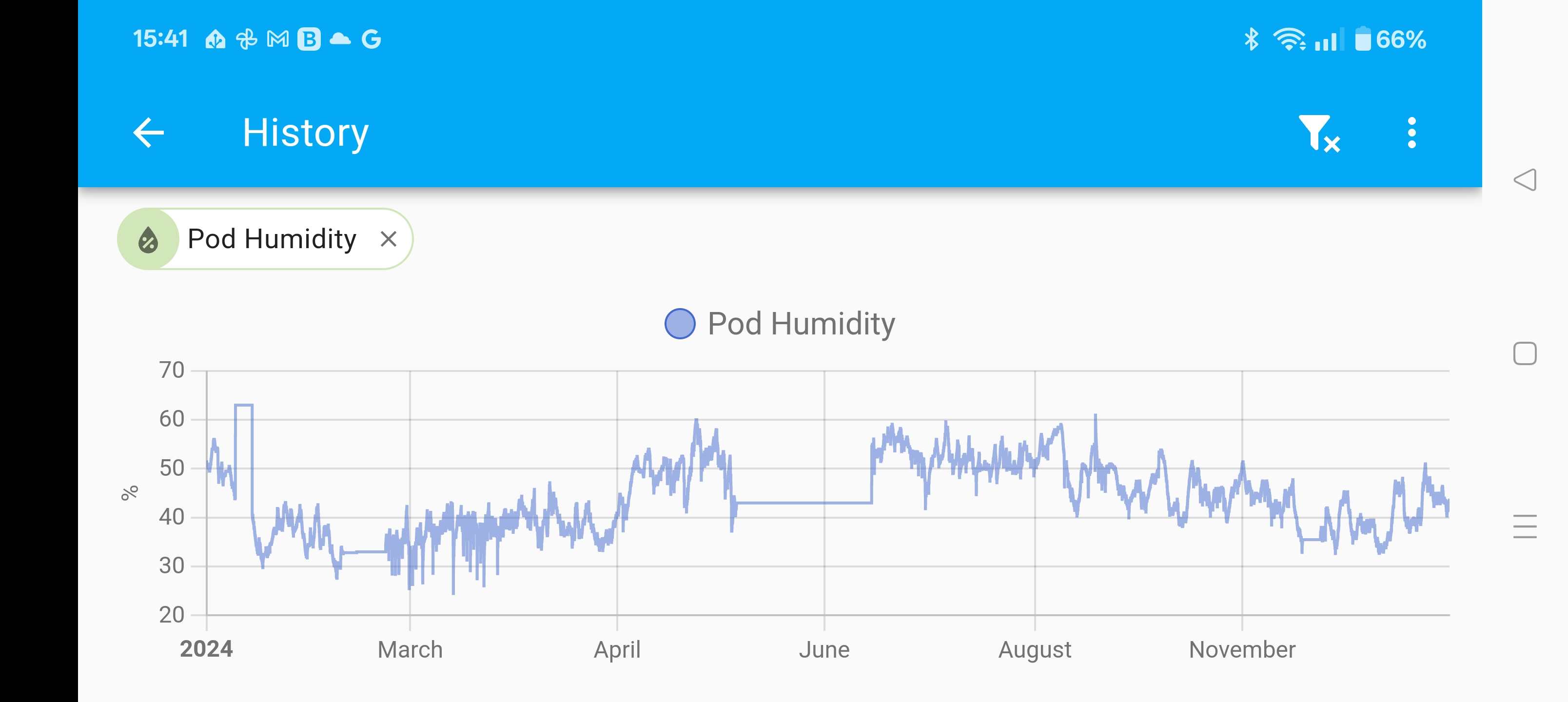

dMEV fan install now and then forever more let it run 24/7. Cost about £1 a year to run. Set to min speed, buy a Greenwood CV2 from eBay pretty cheap.
This last year's humidity of our garden room
Screenshot_2025-01-29-15-41-40-26_c3a231c25ed346e59462e84656a70e50.thumb.jpg.a959aa62240b6d5cff9bfcd4e2ac7294.jpg

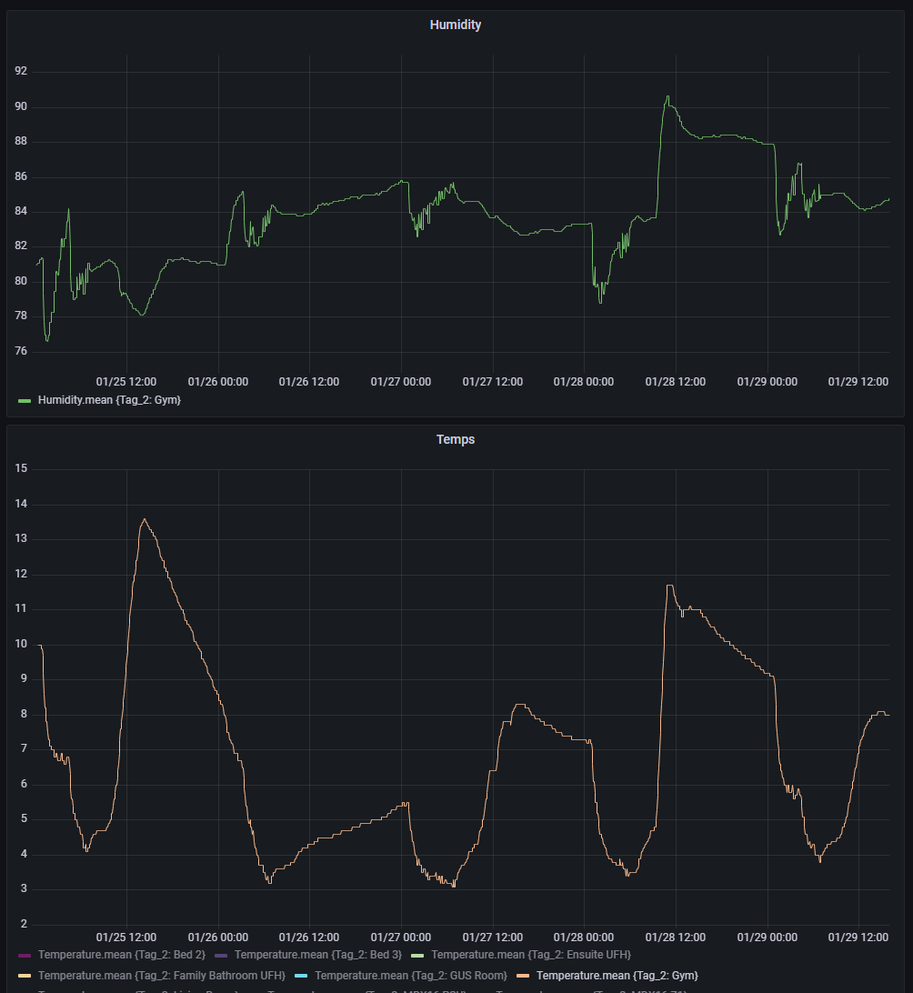

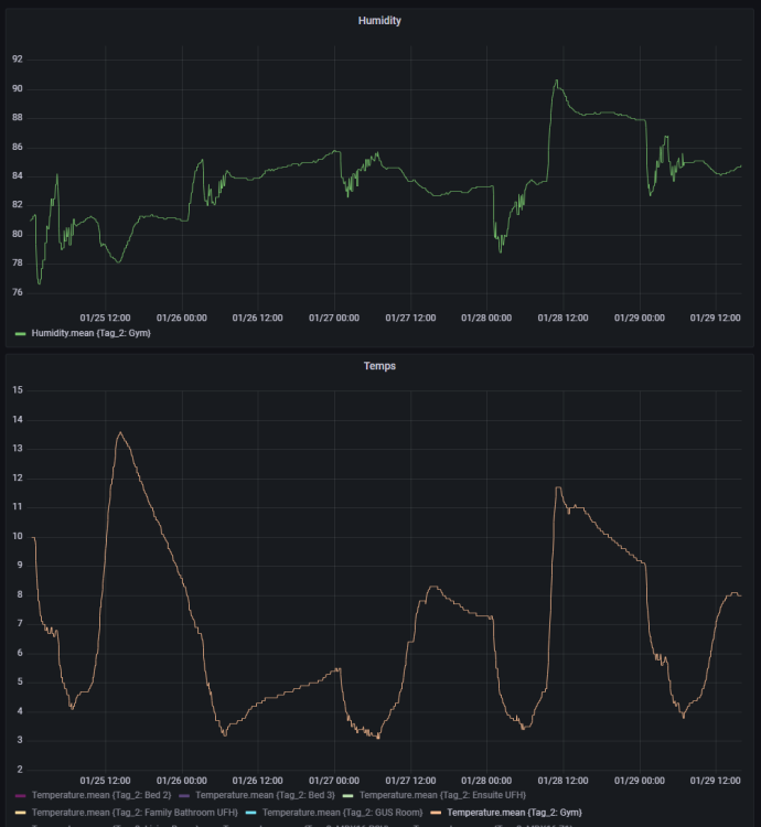

Very timeline thread. What sort of temperature is that room maintained at?
My garden room is a gym, so naturally gets a lot of humidity, and we positively don't want to heat it at all which means it's always sat at/below dew point and creating lots of pools of water esp around the door handles and window frames (cheap 2G). The trickle vents can't keep up.
I've set the A2A to do a dry cycle during overnight cheap rate, but it's already so cold that I don't think it can shift much by cooling the air to condense water out of it. For the little money it costs I'm very interested to give this dMEV a go.
Current situation
Edited by joth
Posted
We heat with a fan coil, but it only really gets secondary heat from the house UFH, ASHP circulation pump runs 24/7. So we generally have a min of 16, but it can get as high as 20 (currently) due to solar gain.
