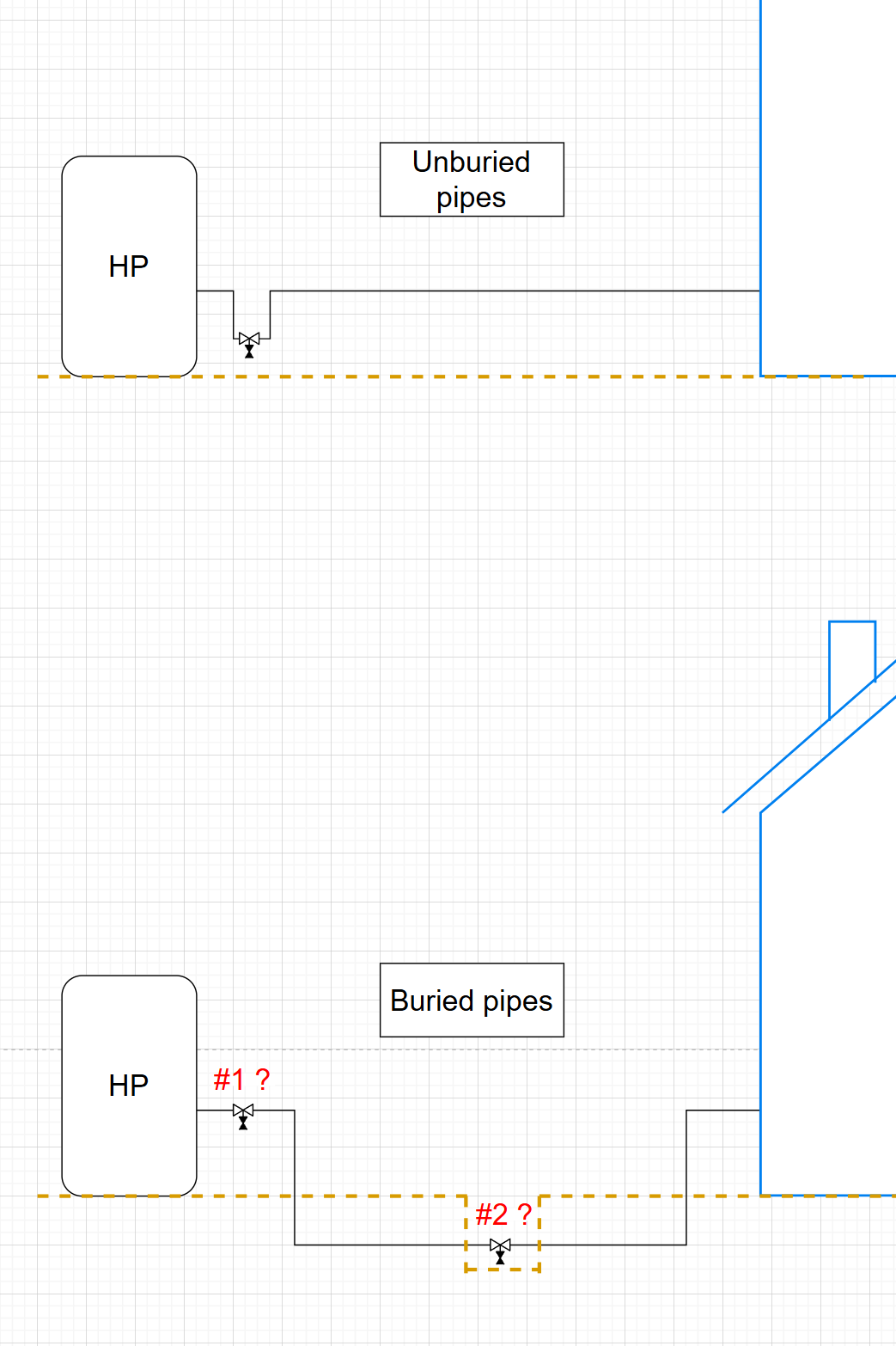

Frost protection methods for when supply / return pipes to a monoblock outdoor unit are buried?
I can't find any guidelines / best practices regarding frost protection when the supply/return pipes to a monoblock are buried. Quite a few people with units placed close to a building seem to have the scenario I've sketched out in the upper section, where a frost protection valve gets put on the low point of the supply and return (only sketched one line for clarity). However, in my case, the unit can't go against the building, and actually has to go on the other side of a small walkway, so there's pretty much no choice but to bury the supply and return pipes.
In theory, putting a frost protection valve at the #1 position I've sketched seems to be just be a waste of money, as in the best case it would simply drain some water out of the unit (provided it's placed lower than the unit's internal pipework). Putting a protection valve at the #2 position seems like it would be the 'safest' option, but would seem to require leaving some sort of culvert / access shaft in the middle of the pipe trench run (sketched the 'ground line' with the dotted brown line, showing the shaft that the #2 valve would have to go in), which seems like a lot of additional complexity.
If the pipes are buried below the frost line, could the internal water then be always assumed to be above freezing, and keeping the above-ground outside water in the unit above freezing through natural convection, so that no frost protection valves at all are actually needed? Or at least if the buried pipe water is 'safe', maybe the frost protection valve at #1 would be 'good enough' since it drains out the only above-ground parts of the system (perhaps a mirror would be needed at the house entry)?
Curious how you all have seen actual examples of frost protection in systems with buried pipes.

This is basically my configuration.  The pipes leave the ASHP and go straight down under the foundation, then 8 metres later come straight up into the plant room.
I also interpreted the install guidelines for the anti-freeze valves that they were not suitable for my install and would not work.
I was also not prepared to go with a glycol solution.
Although there is a risk that a powercut and heavy frost will coincide, I was prepared to take that risk.
There was an earlier discussion somewhere on the forum about these issues, upon reading a few different opinions I felt happier to take this approach. The Graham Hendra article @JohnMo linked to also helped. But I live in Suffolk, so the weather is not particularly cold.
Possible mitigations and other ideas. If there is the powercut and frost situation, you can still drain down the ASHP so that it won’t be affected. You can install a home battery so that you have power during the powercut.
You can also up rate the insulation on the ASHP pipes, which is what I did. Armaflex do exterior grade up to 32mm thick. I went with 25mm. MCS specifies 19mm.

Thanks for the info on your setup - my proposed setup is pretty much the exact same as what you have (pipes well below frost line, extra insulation on everything that's above). Realistically the only scenario where it seems like I could run into danger with a setup like yours is where there's an apocalyptic combination of:
1. Multi day power outage
2. Multi day cold snap
3. I'm not around to manually drain the system myself
And I think setting up a generator + battery backup to run the pump would take care of point 3.
If you go with an AF valve below the HP but out of the ground - ideally just as the pipe emerges then it should protect your HP should there be an extended power cut and cold spell.
Ultimately if your bit of pipe sticking up from the ground to you AF valve freezes it's not that big a deal.
The goal is to stop freeze damage to the heat exchanger in the HP. If that freezes you HP is scrap. Even if the pump inside freezes it's not the end of the world, so all you need is thr freeze valves to be such that the HP drains down.
I would argue a single one on the lowest outlet (doesn't matter if flow or return) is enough. The goal is to get a flow of water through the HP so it can't freeze solid. If the valve opens and some water flows out that achives  the goal.  If enough water flows out to empty the HP, that also achieves the goal.

Personally I'd go with the @Beelbeebub approach of put in antifreeze valve at lowest point you can below the ASHP

You are just scared mongering now. So now you are worried about a lots of steel plates that are insulated inside an insulated box freezing. If that is the only concern, remove insulation, wrap with 12v heat trace, re insulate, and use simple relay to switch the heat trace on in event of power outage when heat exchanger drops to 3 degs.
Not scare mongering.
*if* the heat exchanger freezes, it's buggered.
As you correctly point out, it won't freeze that easily.
The only real possibility is a long power cut during a persistent cold snap eg beast from the east (the conditions when the electrical hearing trace won't help)
However, in the unlikely event that happens you are onky concerned with draining down the HP. The buried portion prob won't freeze and even if it did it's not that big a disaster.
So an AF valve will still provide protection as long as it is positioned to drain out the HP. The rest doesn't matter
