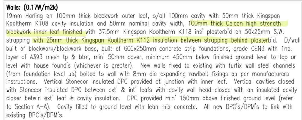

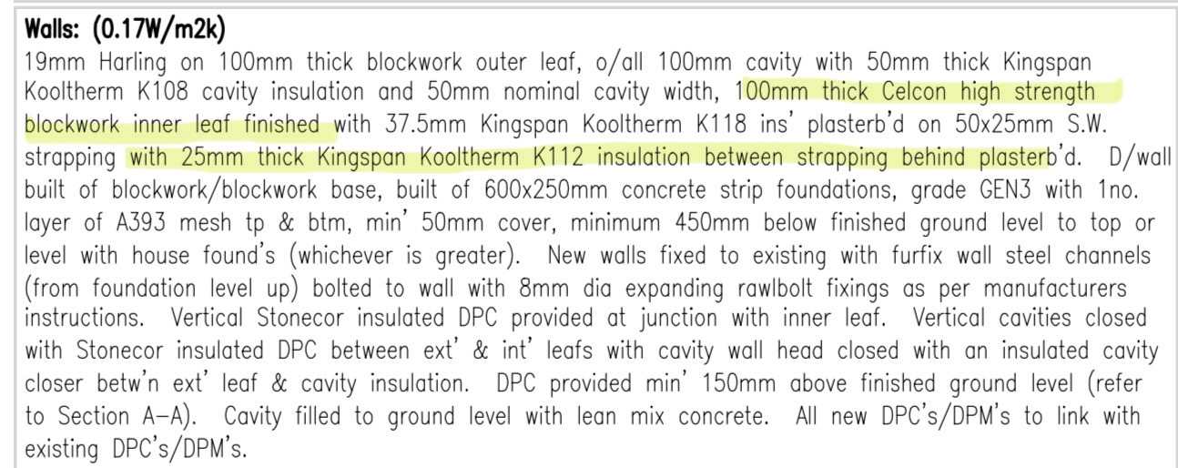

S_P Posted January 28, 2025 Posted January 28, 2025 Hi, I'm looking for some advice, recently had an extension built & as the topic says i have draughts coming through the sockets, for the most part i kept my eye on the company i chose to do the build but with now having this issue it has made me want to try & understand where the issue has arisen from. I have 2 suspicions ; 1) The 25mm Kingspan Kooltherm insulation between the strapping behind the plasterboard has been left out? The builder states they have pictures to prove it had been installed but i'm still waiting on these. 2) The inner leaf was to be as stated in the planning application 100mm Celcon high strength blockwork, when i look at these online the brick appears much smoother on the surface compared to what i have, i have attached a picture of the build showing the blocks used, i found a delivery note stating "heavy weight blocks 7N", could it be the wrong blocks have been used therefor allowing air to flow more easily through the inner leaf? Everything else from what i can see was carried out correctly. Any advice is much appreciated.

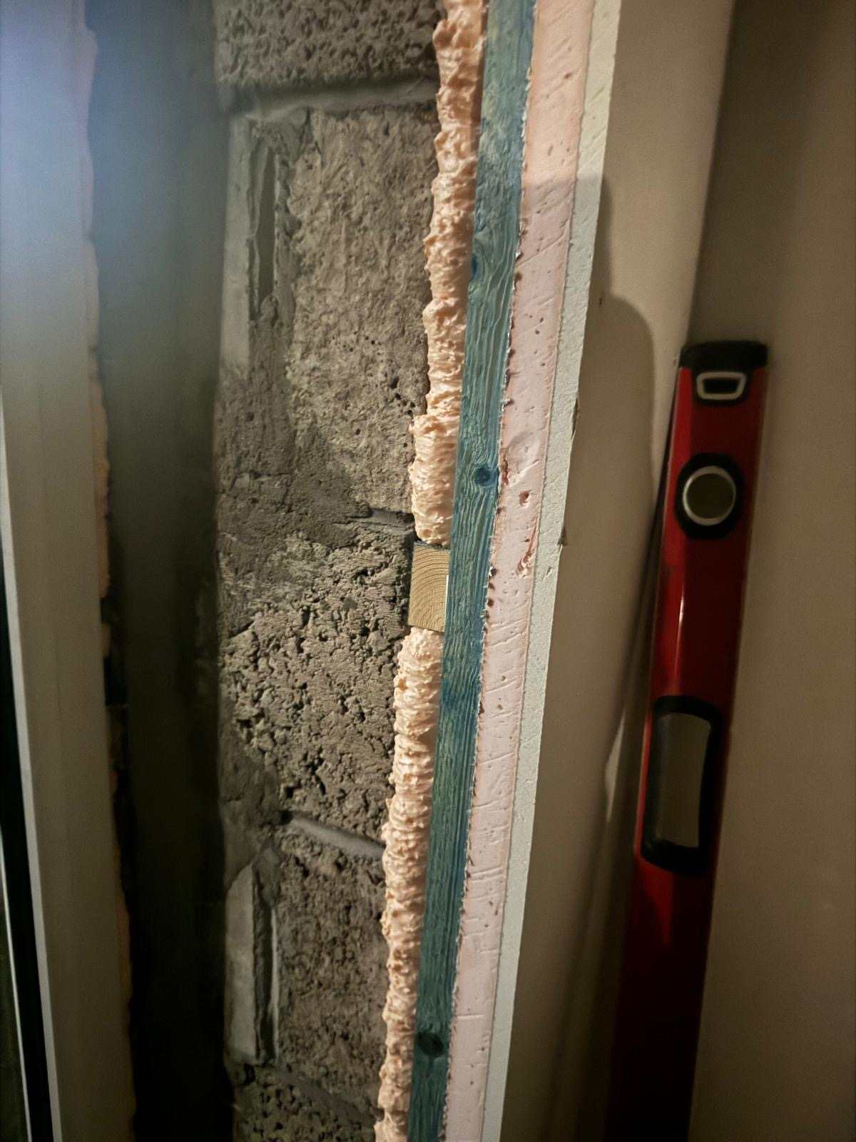

S_P Posted January 28, 2025 Author Posted January 28, 2025 (edited) So as you can see this is a brand new build, I certainly didn’t expect the finished result to have this issue, in my opinion something has been missed out somewhere or done incorrectly even if there is a small hole from a hole drilled for wires that hadn’t been plugged afterwards, is that fair to assume? I have been advised by the company that built the extension that gaskets could be put around the electrical outlets, is this the correct way going forward to resolve the issue? Should I be satisfied with that or would it be considered a quick fix & not dealing with the issue at its root cause? Should I worry about long term issues from something like this if it’s left as it is & gaskets installed as in damp/mould? Thanks again for your input 🙏 Edited January 28, 2025 by S_P Additional detail
ProDave Posted January 28, 2025 Posted January 28, 2025 I assume that is a window or door reveal before being boarded up? On the face of it, it looks good with gaps sealed up with expanding foam. One can only speculate but somewhere that didn't happen or not happen properly. A thermal imaging camera is about the only thing that may help you track down where.
Nickfromwales Posted January 28, 2025 Posted January 28, 2025 13 hours ago, S_P said: 1) The 25mm Kingspan Kooltherm insulation between the strapping behind the plasterboard has been left out? The builder states they have pictures to prove it had been installed but i'm still waiting on these. Take the socket out and have a look? Do you know if they’re metal boxes or fast fix (plastic into plasterboard) boxes? Beware stripping the threads when removing / reinserting the plate screws that hold the socket on.
Nickfromwales Posted January 28, 2025 Posted January 28, 2025 Having that 25mm insulation in there won’t stop draughts getting in when there’s a hoolie blowing outside. Air finds its way through tiny gaps, benefitting from when there are lots and lots of them, but it certainly loves any bigger ones! The boxes should (could) have foam around them, and the boards foam sealed at the head / foot / sides / returns etc. The issue here is that if it wasn’t specified as an airtight build then the builder hasn’t charged you for one, hence you haven’t got one. What did you ACTUALLY have in the specification and agreement, in terms of these considerations? 1

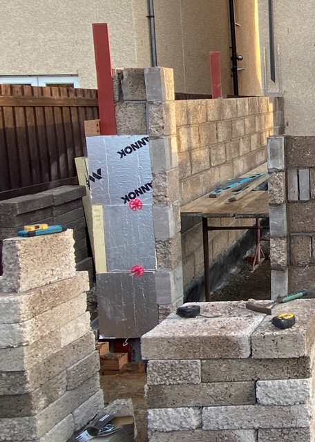

kandgmitchell Posted January 29, 2025 Posted January 29, 2025 Well one thing is those aren't celcon high strength blocks. If they were then they'd be smoother and have a black coloured band painted on the ends to identify them. It would be interesting to know what the blocks were as their insulation value could be a lot less than the celcon's, leading to the wall having an overall lower U value. Wouldn't affect the draught problem though, has to be air running down the back of the plasterboard somehow.
