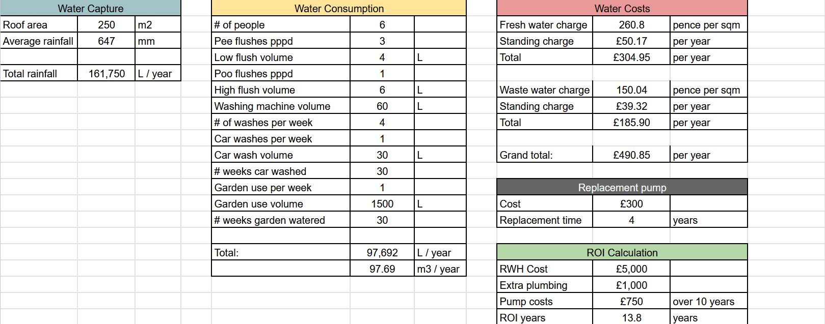

mads Posted March 21, 2025 Posted March 21, 2025 (edited) I decided to create my own calculator on how much I could save on water by RWH. Here is the calc (I included a waste water section though not applicable for me). Happy to upload the file for others to use for themselves, if helpful. I have only done it from a water consumption and waste water perspective. I have not factored in electricity costs (as I personally feel this is negligible and most of us will have PV) but have included replacement pump costs. Edited March 21, 2025 by mads 1

saveasteading Posted March 21, 2025 Posted March 21, 2025 Nice to see your calls. From a quick skim. The garden usage looks high. A) perhaps showing a falsely high cost/ potential cost.. b) you would empty the tank in 3 weeks of no rain. Water cost sqm should be cm ? Does waste cost belong here as a cost? You could show the saving due to lower purchase volume perhaps.
mads Posted March 21, 2025 Posted March 21, 2025 (edited) 22 minutes ago, saveasteading said: Nice to see your calls. From a quick skim. The garden usage looks high. A) perhaps showing a falsely high cost/ potential cost.. b) you would empty the tank in 3 weeks of no rain. Water cost sqm should be cm ? Does waste cost belong here as a cost? You could show the saving due to lower purchase volume perhaps. Garden is 1 acre which will be 0.4 acre lawn, 6-8 sqm vegetable patch, medium to large greenhouse and 6m diameter pond to keep topped up, plus plants and hedging so expect fairly high use - in-laws are avid gardeners too. When I sent my request to suppliers, they came back saying I need a 5,000L tank but to be on safe side for droughts then consider a 7,500L one. I was going to get a 10,000L as I also have outbuilding roofs which I haven't factored into the water capture calc. Water cost is actually m3 - had the wrong units described and have corrected in my file. Doesn't change the calcs. Waste cost doesn't apply to me so I would zero it out. I included it in case I share this with anyone and they may need to use it due to connection to mains sewerage. For me, the ROI is around 30-40 years so one to think about in terms of capital cost outlay. Was useful to do the exercise and hope it helps others. I had to do a few iterations to get to a point where the ROI time frame balanced out. The replacement pump cost drove it up and I would look to see if 3 years is too frequent. Edited March 21, 2025 by mads 1

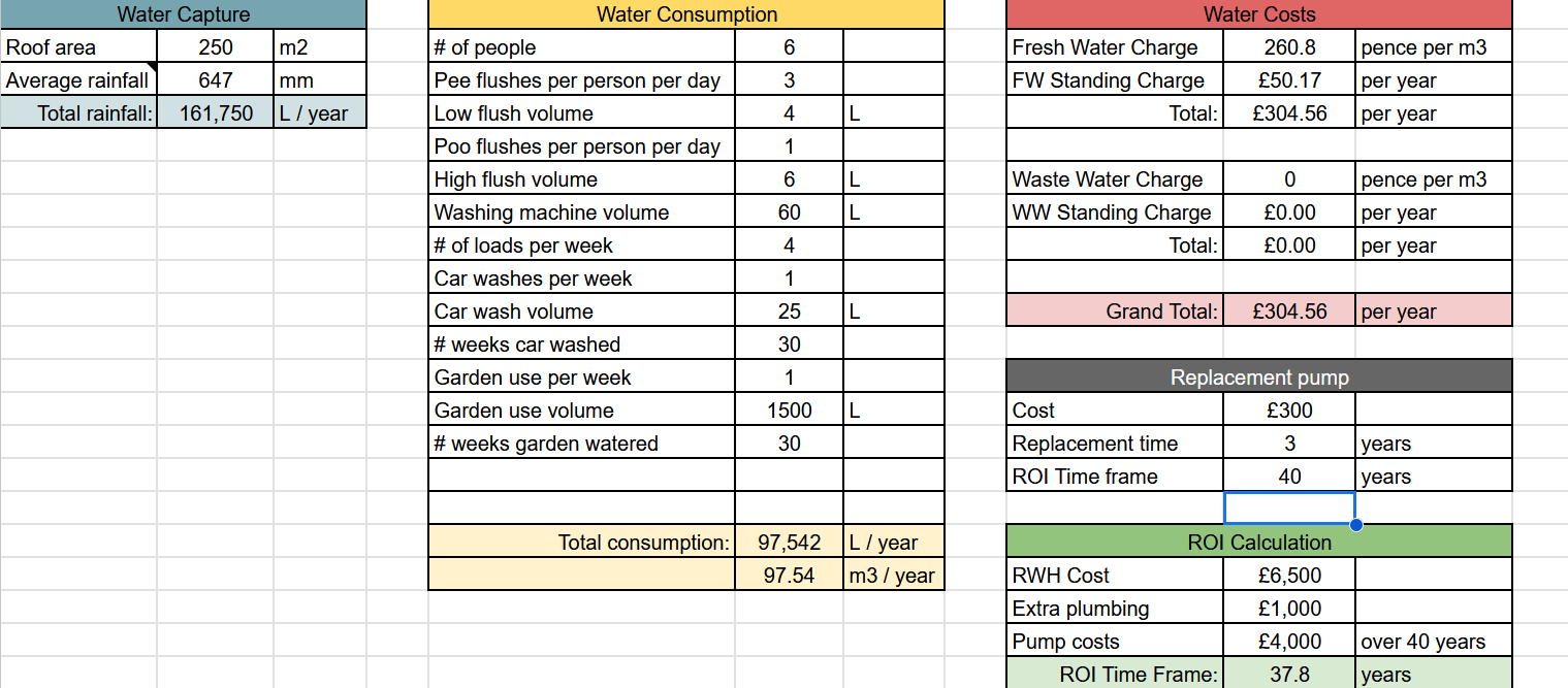

mads Posted March 21, 2025 Posted March 21, 2025 2 hours ago, saveasteading said: In my office example above the calculations said use 5m3. I went for 10 which I think was right as it never ran dry. Negligible garden use. I think the ROI on the extra 5m3 would have been very short as it was only the extra tank cost...about £1k? Well done on the exercise. Thanks. Though I have to say that my exercise presumes the costs stay the same for the entirety. We know that the cost of water supply is going up, with numbers of around 36% over the next 5 years. If I assumed a 3% YOY increase to the fresh water price, that goes up to 360 pence per m3 in 10 years. At that cost, it could shave off around 8-9 years from a ROI timeline. I need to do some financial modelling to see what this might look like over a 10-15 year horizon as I suspect it will be different to the static view I have started with.

mads Posted March 21, 2025 Posted March 21, 2025 So some modelling shows... Over 10 years, based on a 5% YOY price increase (I think this is too low imo), the fresh water supply cost for my scenario would be: 2025/26: £304.56 per annum 2034/35: £472.47 per annum The total over the 10 years would be £3,830.72 vs £3,045.60 if the costs were to remain static. Looking at just today with the current costs, the ROI timeframe is 26.6 years Looking over a 10 year horizon with the above increases, the ROI timeframe reduces to 21.1 years Over a 20 year horizon with still a 5% YOY increase, the ROI timeframe reduces to 17.3 years
