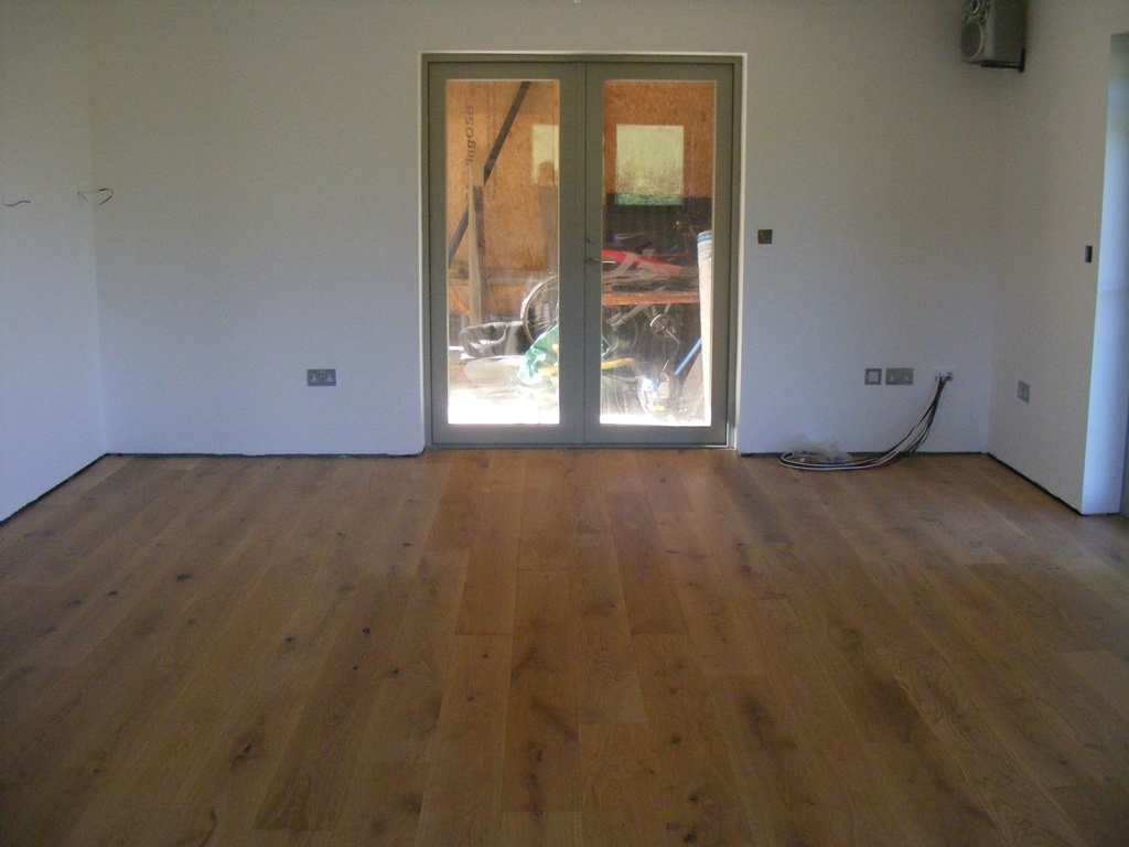

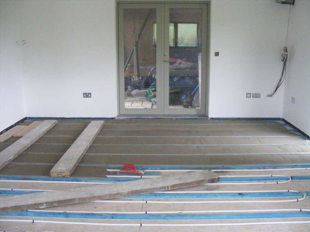

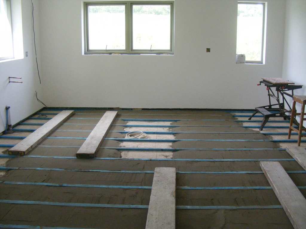

ProDave Posted January 19, 2025 Posted January 19, 2025 Download the heat loss spreadsheet from this post, it proved very accurate for my build.   I would be looking to improve floor insulation in your build. We have suspended wooden floors with UFH but wood or slate flooring throughout and that achieved a U value of I think it was 0.13 and works well with the UFH. Carpets will slow down heat delivery   Â
saveasteading Posted January 19, 2025 Posted January 19, 2025 3 minutes ago, HighlandHopeful said: I really want wooden floors and lots of rugs and carpet in a couple of rooms... wooden floors is not a problem, unless very thick. Rugs likewise, as the heat will move on and emerge elsewhere. Carpets no.  On our latest family project for the rooms where ufh isn't appropriate I am pushing for aluminium skirtings with the ufh pipes in them. No clutter. But you could still put rads in these rooms.  Just now, HighlandHopeful said: it stuck in my head that you design for average lowest, not actual likely lowest. 'They' want you to buy bigger kit so push us in that direction.
HighlandHopeful Posted January 19, 2025 Author Posted January 19, 2025 1 minute ago, saveasteading said: wooden floors is not a problem, unless very thick. Rugs likewise, as the heat will move on and emerge elsewhere. Carpets no.  On our latest family project for the rooms where ufh isn't appropriate I am pushing for aluminium skirtings with the ufh pipes in them. No clutter. But you could still put rads in these rooms Interesting, love the sound of the aluminium skirtings with UFH (although BFs dad very allergic to aluminium and will be helping with the build - does any other metal work?). Another reason against UFH for us, which I should have said, was that I thought you need a concrete slab for UFH, but we can't get a concrete tanker to our plot. We are having strip foundations so that we don't need a tanker.Â

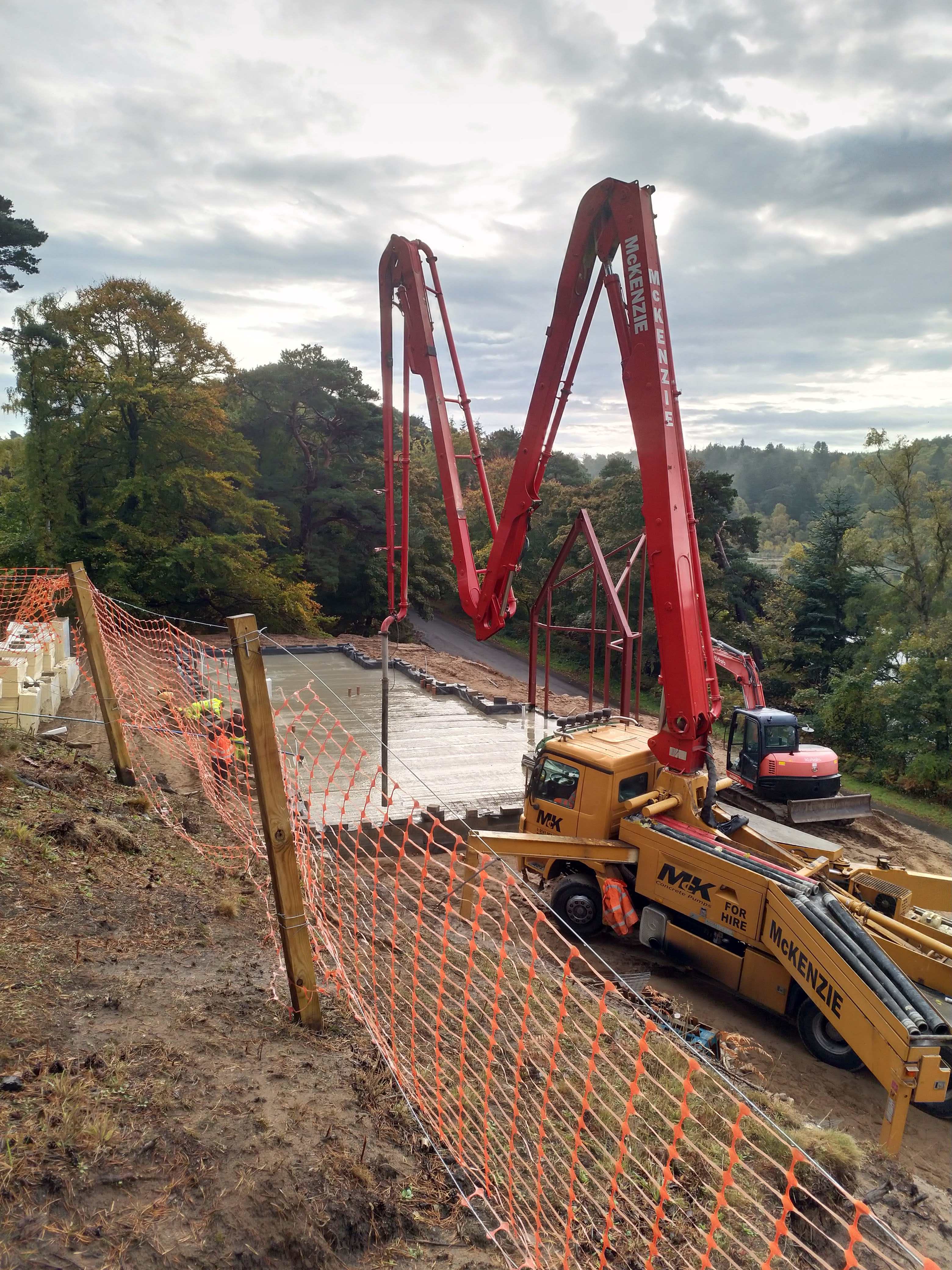

saveasteading Posted January 19, 2025 Posted January 19, 2025 1 minute ago, HighlandHopeful said: we can't get a concrete tanker to our plot. We are having strip foundations so that we don't need a tanker Tell us more please. The foundations and floor will be made of???? other lorries can't get there either?  A bracken on earth floor, driftwood walls infilled with heather and mud. Thatched roof harvested adjacent?    OR small loads of concrete. pumps. dumpers. Â

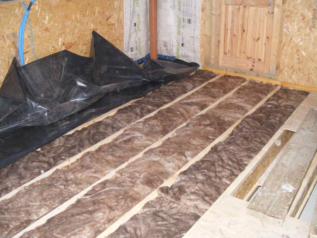

ProDave Posted January 20, 2025 Posted January 20, 2025 On 19/01/2025 at 16:41, HighlandHopeful said: Another reason against UFH for us, which I should have said, was that I thought you need a concrete slab for UFH, but we can't get a concrete tanker to our plot. We are having strip foundations so that we don't need a tanker. Timber frame build, strip foundations, I beam joist floors, insulated and covered in OSB.  Lay battens (following joists) Lay UFH pipes. Fill gap with dry pug mix sand / cement as a heat spreader. Lay Engineered Oak floor as structural floor spanning battens.   Â

Beelbeebub Posted January 21, 2025 Posted January 21, 2025 How far from the road is your plot? A mini concrete pump can sit on the road and push you concrete quite some distance.  One visit for the foundations, then another for the floor slab.Â

JohnMo Posted January 21, 2025 Posted January 21, 2025 2 hours ago, Beelbeebub said: A mini concrete pump can sit on the road Or a big one
saveasteading Posted January 21, 2025 Posted January 21, 2025 21 minutes ago, JohnMo said: mini concrete pump can sit on the road You could even have one on the road feeding another half way. Or a couple of dump trucks.
ProDave Posted January 21, 2025 Posted January 21, 2025 1 hour ago, saveasteading said: An aside perhaps. In my experience of these floors, the concrete beams are ultra hard, and drilling requires that you don't hit a steel tendon. Did you use short screws? Sorry I did not describe it well.  JJI 300mm deep engineered timber I beams for the floor, as light as a feather to carry.  Here they are being insulated before being covered.    1
