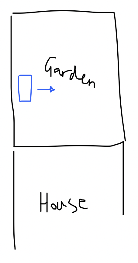

low_and_there Posted 16 hours ago Share Posted 16 hours ago We've finally had our ASHP installed. Total nightmare, turned out the installers really did not know what they were doing with the heat loss calcs, nor tbh, much about heat pumps, despite being an 'MCS' outfit. But anyway, here we are. Due to the various sagas since install I've not actually noticed before that the ASHP unit outside pushes air out towards the garden, rather than against the wall, which is what I expected... I've drawn a diagram, attached, showing what I mean. I'm curious if this is to be expected and how other people have their heat pumps installed? Thanks in advance Link to comment Share on other sites More sharing options...
Conor Posted 16 hours ago Share Posted 16 hours ago Thats correct. Draws air from behind, expels to the front. Link to comment Share on other sites More sharing options...
S2D2 Posted 16 hours ago Share Posted 16 hours ago Yes, this is correct. Link to comment Share on other sites More sharing options...
low_and_there Posted 16 hours ago Author Share Posted 16 hours ago thanks both, at least they did that bit right Link to comment Share on other sites More sharing options...

sharpener Posted 16 hours ago Share Posted 16 hours ago 12kW Vaillant is almost imperceptible from the side and not very noticeable from the front unless putting out 10kW or more which is rare. Sucks from back (only 200mm rear clearance, 250 if for cooling) and blows v cold air out from the front. Visitors (who have to walk past it) have remarked on the cold rather than the noise. Link to comment Share on other sites More sharing options...
JohnMo Posted 15 hours ago Share Posted 15 hours ago 2 minutes ago, G and J said: Hmmm, we’re planning a similar installation. Is there much difference in the noise level between standing to the side of the unit and in front of the unit (i.e. with the airflow coming towards you)? Yes - most the noise is pushed forward by the fan. You don't want to install with air pushing towards a wall. You get air recycling of cold air coming back round and that reduces CoP and changes the defrost onset temperature for the worse Link to comment Share on other sites More sharing options...
