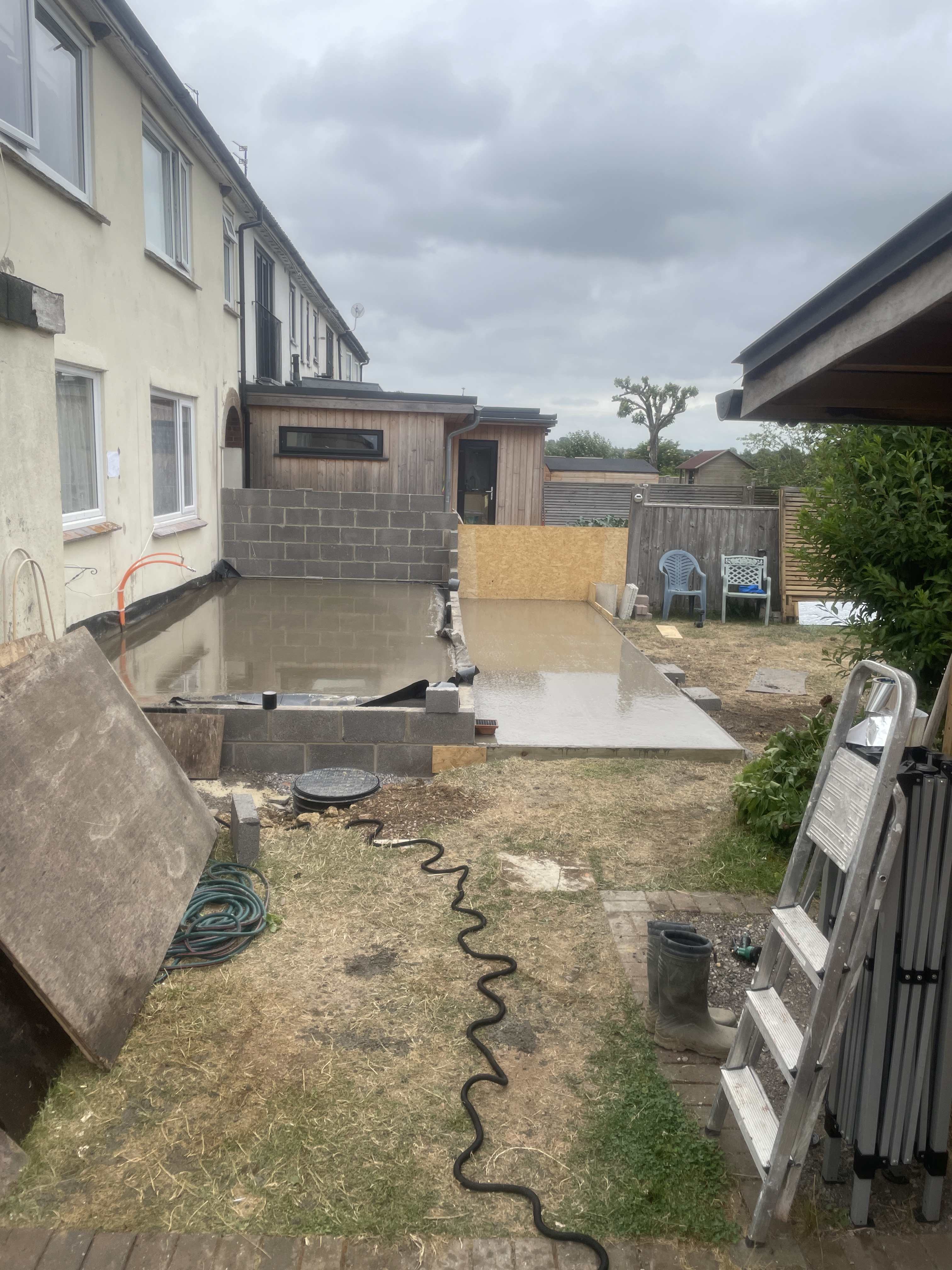

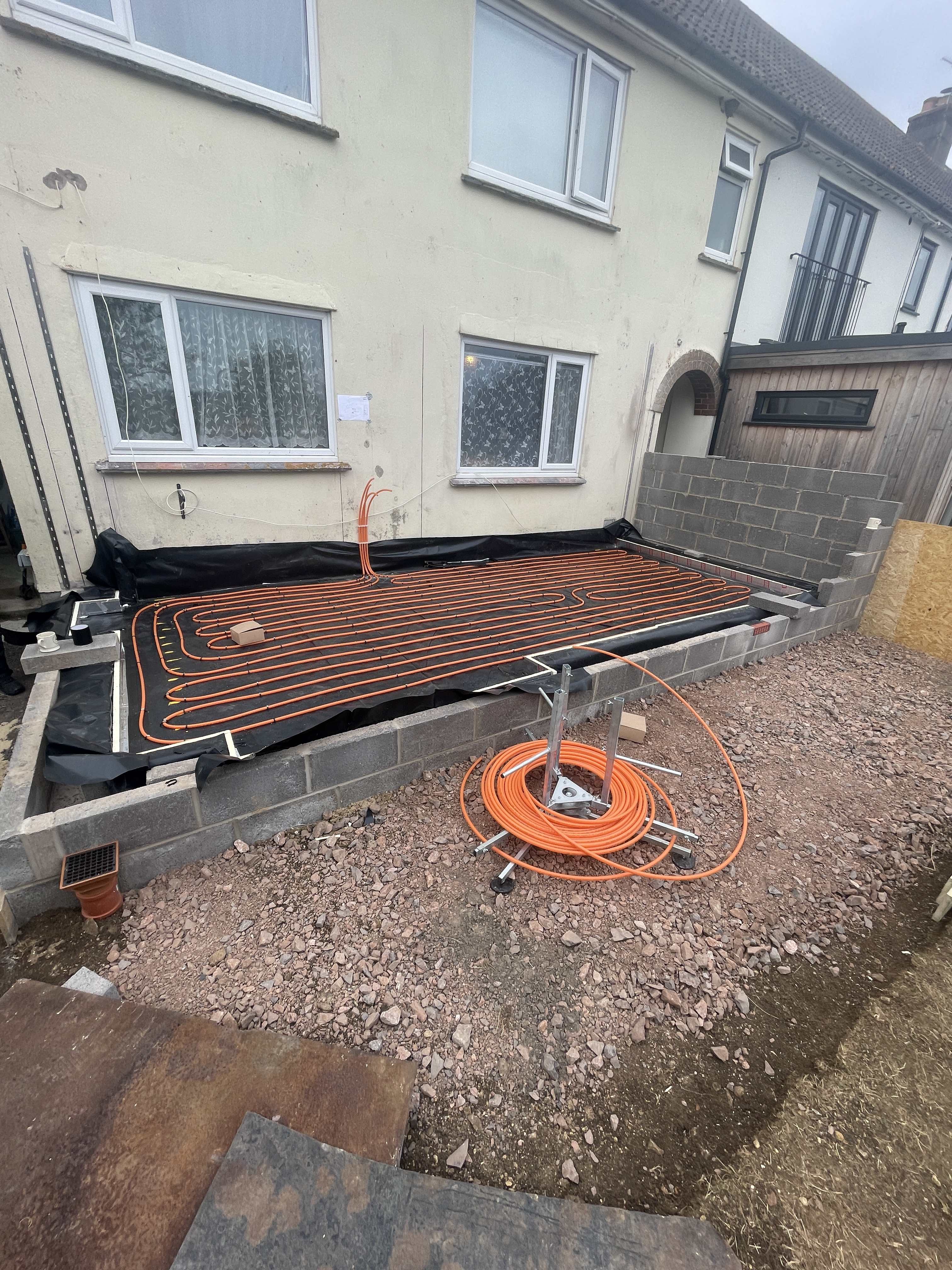

HughF Posted January 23 Posted January 23 This is exactly my floor build up in the extension. Except we’re on 200pir and about 120mm conc. works perfect, crack on.
Nickfromwales Posted January 23 Posted January 23 24 minutes ago, HughF said: works perfect, crack on. Yup, +1. I've done plenty of these types of installs and with exactly the methodology described by the OP, never an issue. IMO the underlaying concrete (that most builders knee-jerk to without any thought) is a waste of money. This is absolutely reliant on the preparation works and that having been done meticulously without divots or voids in the sub ground / earth. Last one I did was 200mm of PIR then 85mm or so of dry screed with 16mm UFH pipes stapled to the insulation. I don't really bother with the top 'membrane' and I've never had any issues. I once had to do an insurance job where I had to take an Everest conservatory floor up (tiles were cracking and floor screed caving in) and they had done this methodology, just very poorly prepped and loads of undulation in the ground prep. The screed was laid directly onto the PIR and all that happened was the foil had tarnished a little, over 5 years or so. I'd only go with the upper membrane if going for a true liquid screed.

HughF Posted January 23 Posted January 23 What's this mythical screed you talk of, we used readymix straight off the truck 😀 Tiny bit of self leveller at a transition where we knocked through and LVT straight over the top. 1
saveasteading Posted January 23 Posted January 23 12 minutes ago, HughF said: readymix straight off the truck Absolutely fine, and about a third of the cost per m3. Also a cost advantage in labour when the area is quite small. such as an extension. The downside is that it isn't so easy to lay to a very thin layer of say 60mm, and won't find its way tight to every surface of the UFH pipes. It's also very bold to do that so early, in the open, as the weather and oncoming trades will do their best to damage the surface. @HughF what thickness is that? What mix of concrete and did it have plasticiser? If you have stuck vinyl straight onto that, then you've done remarkably well with the finishing.... and controlled the weather and workers well.

HughF Posted January 23 Posted January 23 (edited) 1 hour ago, saveasteading said: Absolutely fine, and about a third of the cost per m3. Also a cost advantage in labour when the area is quite small. such as an extension. The downside is that it isn't so easy to lay to a very thin layer of say 60mm, and won't find its way tight to every surface of the UFH pipes. It's also very bold to do that so early, in the open, as the weather and oncoming trades will do their best to damage the surface. @HughF what thickness is that? What mix of concrete and did it have plasticiser? If you have stuck vinyl straight onto that, then you've done remarkably well with the finishing.... and controlled the weather and workers well. It’s was just ‘concrete’ off the truck, laid by my builders (father and son team) with me on hand labouring. 120mm if memory serves. Pipes at 150 centers. click down lvt with the integrated foam backing - not glued. Edited January 23 by HughF 1
