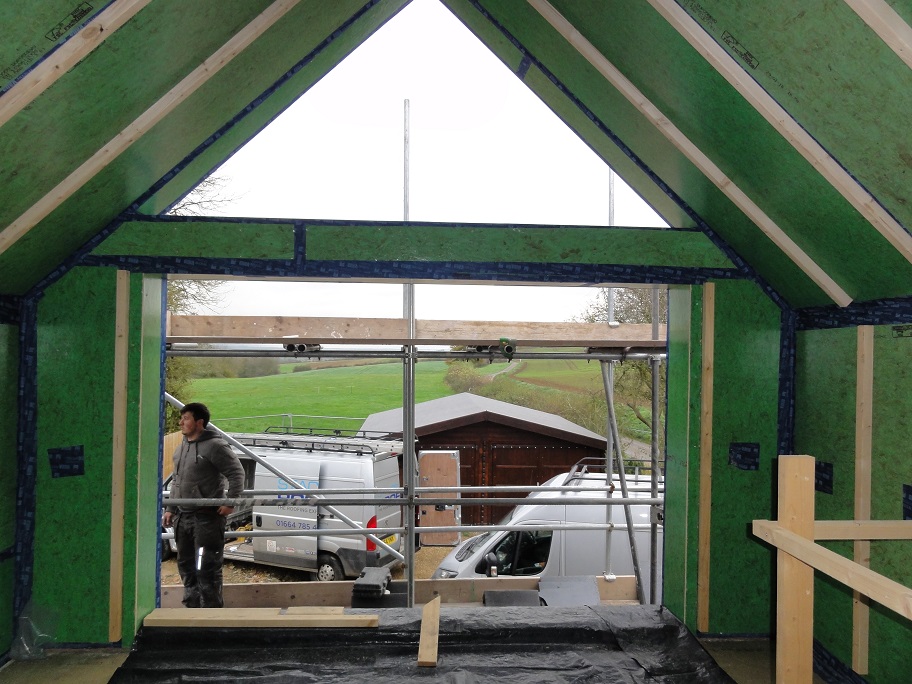

Moira Niedzwiecka Posted November 28, 2017 Share Posted November 28, 2017 We have a closed panel timber frame system that includes the roof structure, specification as below: 300mm Ibeams external sheathing 9mm OSB external membrane Proclima Solitex plus lapped & taped with Tescon Vana 25x 50mm treated battens 300mm warmcell internal sheathing & racking 12.5mm smartply taped at joints with Tescon vana internal service zone 45x47mm battens to internal face. Gives approx 0.15w/m2k The roof covering is a sarking membrane with 25x50mm counter battens & a natural slate covering. Question is should we add further internal insulation between the battens of the service zone before the plasterboard? The roof is part vaulted & part with ceilings. I was thinking 50mm of rockwool or similar. Any thoughts/suggestions welcome Link to comment Share on other sites More sharing options...

Moira Niedzwiecka Posted November 29, 2017 Author Share Posted November 29, 2017 Thank you for your replies. Sorry I made a mistake our roof & walls are both 0.13. The smartply is the airtightness layer. The photo is the large dormer that sticks out the front of the house & will remain vaulted. This is where I was thinking of putting the additional insulation between the battens before the plasterboard or birch ply (not decided which one yet) Link to comment Share on other sites More sharing options...
