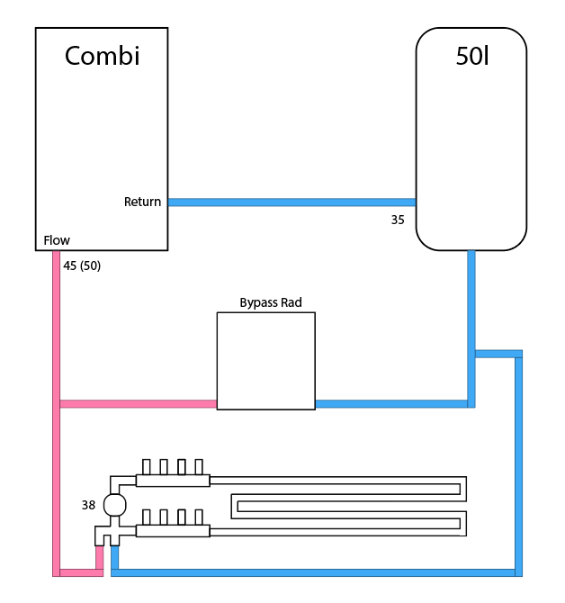

Super_Paulie Posted 23 hours ago Share Posted 23 hours ago (edited) hello friends. Yet another "short cycling" thread sadly that id love some advice on. Not sure if its a) my plumbing b) my electrics or c) my lack of knowledge on it. System My system is a gas combi boiler Baxi 830 (or 800, cant recall) (30kw (or 24kw, id need to check the model), modulation 5:1, way oversized by plumber when i didnt know better), UFH downstairs and rads upstairs, on separate circuits via 2-ports etc. 4 loops, roughly 400m of 16mm, 2 zones (running as 1 zone currently)100/120mm centers in biscuit mix, 170mm PIR, flow rate via Salus auto-balance 2.5l-ish. On the advice of you wonderful gents i also fitted a buffer tank (50l) at the time of install with help from @Nickfromwales and @JohnMo, at the time i didnt have a clue about having to do this, i was uneducated on it (still am to be fair) Buffer tank saga I run the tank plumbed into the return as a 2-port and its only in play when the UFH valve is open. When the rad valve opens the tank is bypassed via a 3-port valve wired into the rad valve, everything's golden. I also run a small nearby bathroom rad as a bypass which runs independently as it is plumbed in before the 2x2-port valves. Ok, so i can run my system at the lowest setting on the mixer of 38 and have it run 24/7 keeping the house a constant 20/21. Or i can run it as a timed system with a mixer at 40/45 to make the house 21 in the morning and then 22 for the evening with a setback of 18. I have tried both ways and the consumption is basically the same, when its very cold outside it costs about a fiver to do this, other times 3 or 4 quid, great (i guess). Short Cycling So, i assumed this was all working correctly, the boiler is in the loft so out of sight, out of mind. I went up there on a whim to time my cycle and found out it was short cycling. What it does is the boiler gets up to its target temp, flames off (pump still running/over-run?) for exactly 3 minutes while the temp drops, then flames on and repeat. It seems to do this no matter what i set the boiler flow to. When it fires up with a cold buffer it takes a good half an hour for the return temp to come up before the above happens, but when warm it cycles as below: UFH mixer Boiler flow Return Flame on Flame off /buffer temp 38 40 (45) 34 0.47 3.00 38 45 (50) 35 1.40 3.00 38 60 (65) 49 4.20 3.00 after i ran it at 60 for a while i then turned the boiler flow down to 40 and it took a good half an hour for the buffer to empty while being pumped around the system by the boiler, satisfying the UFH demand. This i what i thought i was building (what id like to have?), the boiler fills up the buffer over 10 minutes then it takes 30 minutes to empty, and repeat. Obviously it doesnt, the boiler is always trying to satisfy the heat it is set at, duh, its a volume buffer not a storage tank. So my question is, is this running as its meant to? i thought the addition of the buffer was meant to alleviate the short cycling, which it does but only if running from cold so its short lived. Im not sure what i was expecting but as the 3 minute flame off is always exactly 3 minutes thats obviously an anti-short cycling function of the boiler kicking in. I mean its only costing a few quid each day but it cant be good and is obviously a failing somewhere on my behalf. I have attached a simplified diagram below to maybe help explain my system. What have i done wrong guys, do i just need more volume? run the mixer hotter to bring my return down? Unfortunately i am going through a redundancy process (sob story) so my build is on hold so id really like to see what i can about this if anything. Thank you people. Edited 23 hours ago by Super_Paulie Link to comment Share on other sites More sharing options...
Marvin Posted 23 hours ago Share Posted 23 hours ago Where in the building is the buffer tank? In the loft? Link to comment Share on other sites More sharing options...
Marvin Posted 23 hours ago Share Posted 23 hours ago (edited) What causes the water to go through the Bypass radiator? temperature or pressure or ? Where is the bypass radiator? in the bathroom or ? Edited 23 hours ago by Marvin clarification Link to comment Share on other sites More sharing options...

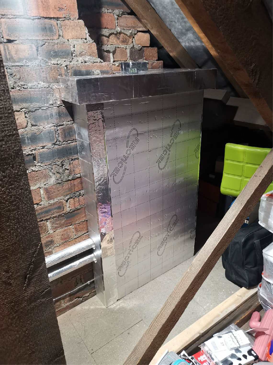

Super_Paulie Posted 23 hours ago Author Share Posted 23 hours ago (edited) 17 minutes ago, Marvin said: What causes the water to go through the Bypass radiator? temperature or pressure or ? Where is the bypass radiator? in the bathroom or ? the boiler and the tank are in the loft. The tank is jacketed, plus i have it basically encased in a 75mm PIR tomb. The bypass rad is in the bathroom, its tiny but will be replaced on bathroom refurb time. Its operated from the flow and return before the 2 ports so its running through whenever the boiler is running. Buffer Edited 23 hours ago by Super_Paulie Link to comment Share on other sites More sharing options...

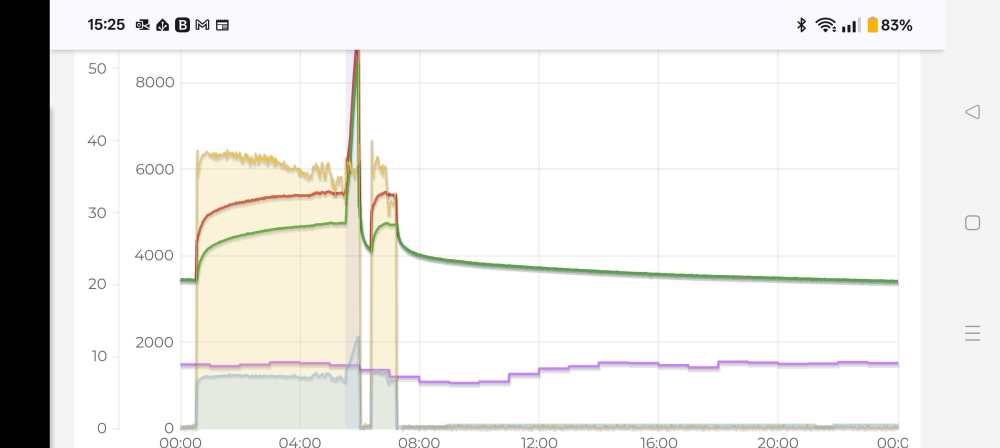

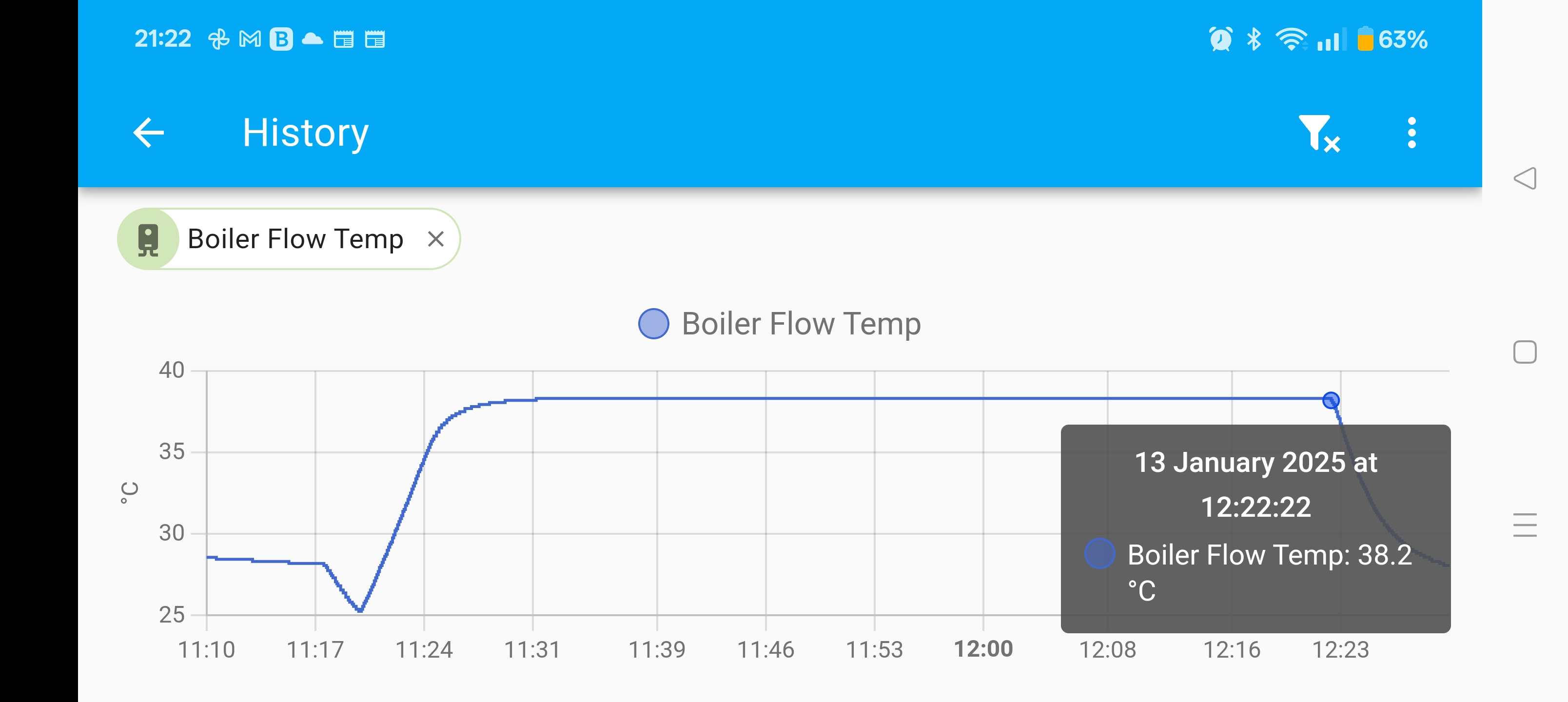

JohnMo Posted 16 hours ago Share Posted 16 hours ago (edited) My boiler currently thinks it's running WC (fixed resistor) gives a solid flow temp. My thermostat just tells the boiler normal flow or setback. This a run the other day, after reducing flow temp a little. It was manually started and stopped when I got fed up. The boiler is putting out about (min modulation) 6-7kW against a demand of about 1-2kW, but floor is buffering the energy. Running the same mode at 32 flow runs 6 mins on 6 mins off. Will be moving to WC via Opentherm in a few days (driven by a new UFH wiring centre), if it doesn't do as good a job I will move back to simulated WC via on/off control. Edited 16 hours ago by JohnMo Link to comment Share on other sites More sharing options...

John Carroll Posted 14 hours ago Share Posted 14 hours ago 1 hour ago, JohnMo said: My boiler currently thinks it's running WC (fixed resistor) gives a solid flow temp. My thermostat just tells the boiler normal flow or setback. This a run the other day, after reducing flow temp a little. It was manually started and stopped when I got fed up. The boiler is putting out about (min modulation) 6-7kW against a demand of about 1-2kW, but floor is buffering the energy. Running the same mode at 32 flow runs 6 mins on 6 mins off. Will be moving to WC via Opentherm in a few days (driven by a new UFH wiring centre), if it doesn't do as good a job I will move back to simulated WC via on/off control. What make/ output Boiler do you have?, its quite a achievment IMO to get any gas boiler to fire up and stay lighting in one go with such a low target temperature, some boilers, like Vaillant maintain (or used to) ignition conditions for 60 secs for some reason or other making it even more difficult to get the boiler away and required a very long anti cycle time or/and a high target temperature. Link to comment Share on other sites More sharing options...
