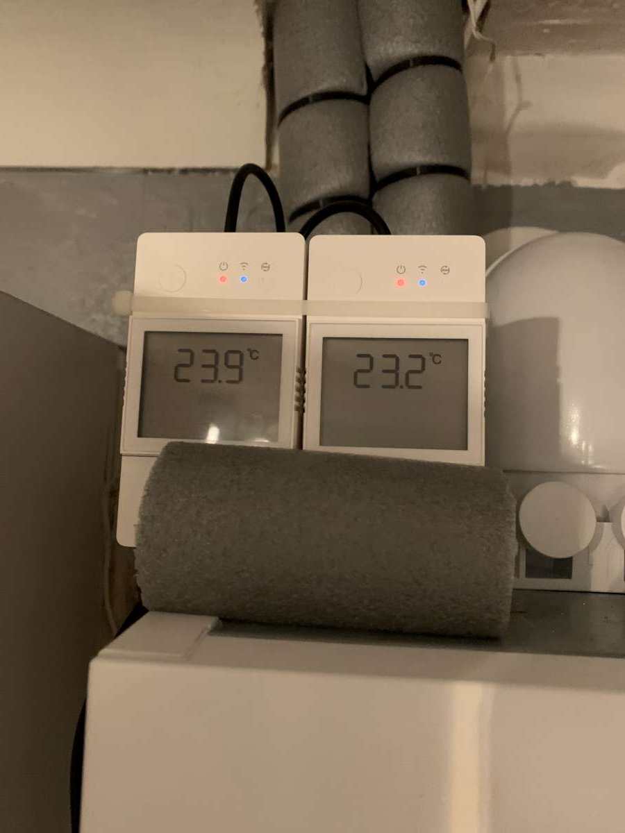

My flow temp last night at 6 deg C was 30 deg C
The boiler over the course of 15 mins gradually went over target temp at min modulation 10.6% (3.2 kWh) by 4 deg in order to extend the run time so finally shut down at 34 Deg C
I wasn't busy so watched my temp sensors for the 20 mins it coasted (pump running boiler not firing) and it re-fired shortly after this picture was taken.
Left side display is flow temp
Right hand side is return temp
I'm pretty sure my boiler doesn't follow the flow temp - 5 deg rule
My previous glow worm boiler didn't either
Yes, theoretically, the boiler should be able to refire once the flow temp falls to its target setting, the burner cut out has to be higher than the target temp otherwise the burner would cut out every time the target temp is reached, it is usually set at 5C to allow a little overshoot without tripping the burner on fire up and sudden target temp changes, a decrease in target temp > 5C below the flow temp will usually trip the burner as well.
