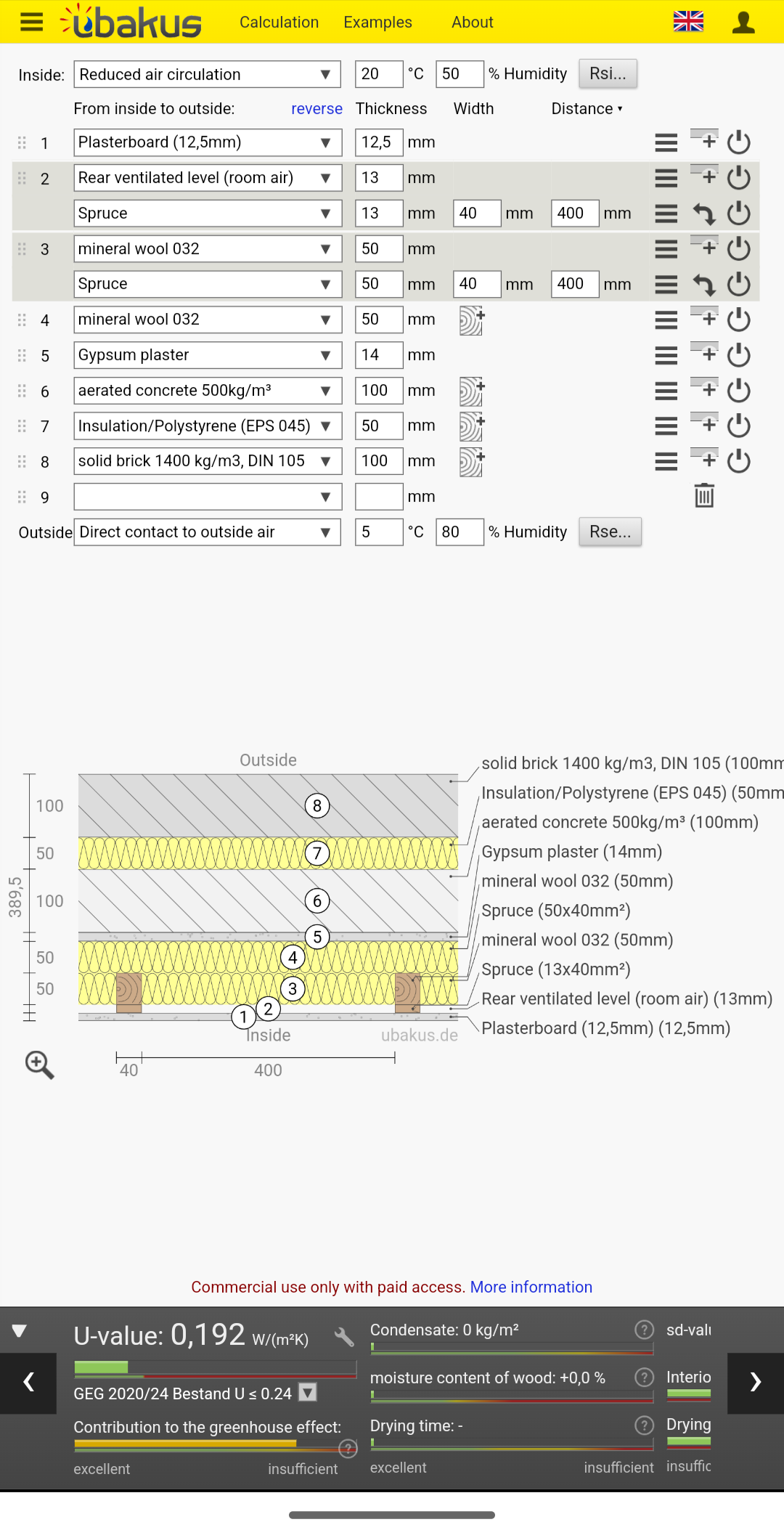

Circling back to this. One final thing I am confused / not sure about:
My current plan after advice is to keep the existing plaster for airtightness, adding airtight paint at top and bottom where it is missing / between floors, and tape round windows. Then add mineral wool with no vapour barrier. Material profile below (not airgap size / service cavity size TBC).
However, from reading others posts this may have air convection losses with air travelling up in front of the mineral wool as I am not planning to install a vapour barrier / membrane in front of the insulation. Are the losses going to be significant? Or is this not really an issue.
This resource suggests I should avoid doing what I am doing: https://www.eurima.org/uploads/files/modules/articles/1607345579_DEF_2020_eurima_howtoinstall.pdf
My easy alternative is just to remove the air gap as shown below. But that means electricians have more of a pain running cables / boxes etc, and likely require thicker cables.
Thoughts appreciated!
Put a service void in front of the plasterboard.
Not an issue. It's airtightness to the outside that is important to avoid.
That timber frame is going to be rather spindly. You'd do better to use metal studs. See my comments in this interesting (but meandering) thread:
Agreed - actual plan is either 63mm CLS or metal c / I stud. Just drew it badly as 2 bits on the air gap drawing, and didn't correct the non air gap one.

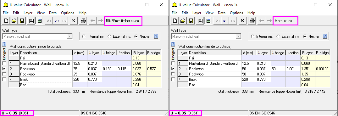

For awareness: Done some quick u-value calcs. Using metal studs looks to be worse than wood studs due to thermal bridging.
0.2 vs 0.19
True, but only by a very small amount
For example, with a room 2.4m high, vertical studs at an average of 400mm centres, plus sole and head plates and (for the timber only) one central noggin, then
- for timber we have 5.5 linear metres of timber / 2.4m high x 50mm thick = 0.115m² timber / m² wall (a 11.5% timber thermal bridge)
- for steel we have 4.5 linear metres of steel / 2.4m high x 0.5mm thick = 0.001m² steel / m2 wall (a 0.1% steel thermal bridge)
Sticking those figures into my u-Value calculator for IWI on a solid wall, assuming 100mm Rockwool and that those timbers are 50x75mm, we get (timber on the left with λ 0.130 W/mK, steel on the right with λ 50 W/mK )
i.e. the difference in U-values is in favour of timber, but only in the 3rd decimal place. You could improve on that by using 38 x 75 timber studs, but the difference is still small (U-value 0.338).
BTW, I wouldn't advise putting metal studs anywhere close to the face of the wall due to the higher condensation risk, whereas with timber you could, if you're short of space.
The much bigger thermal bridge will be any internal walls that join the external wall. Ideally you'd insulate them for the first metre to reduce that, though that isn't always practicable or visually attractive.

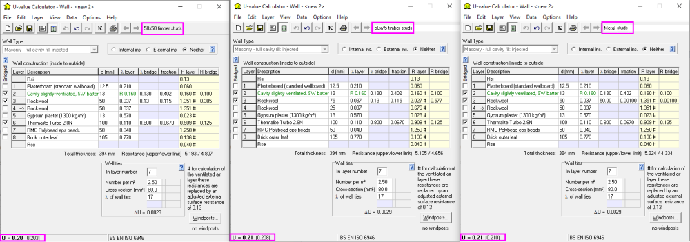

Here's my Ubaqus calcs, including a batten (wrongly sized) for metal.
Metal first
Then wood. Sizes based around 40*63 CLS.
Also annoyingly discovered my existing cavity is 50mm, not 100mm, and the existing insulation in there isn't in great shape.
I guess they're making some different assumptions - or maybe not taking into room height, sole plates and the like - difficult to know.
Anyway here's the same (excepting some small difference in material densities and the like) based on my assumptions above and using the BRE U-value calculator. As you can see, there's very little difference between them:
