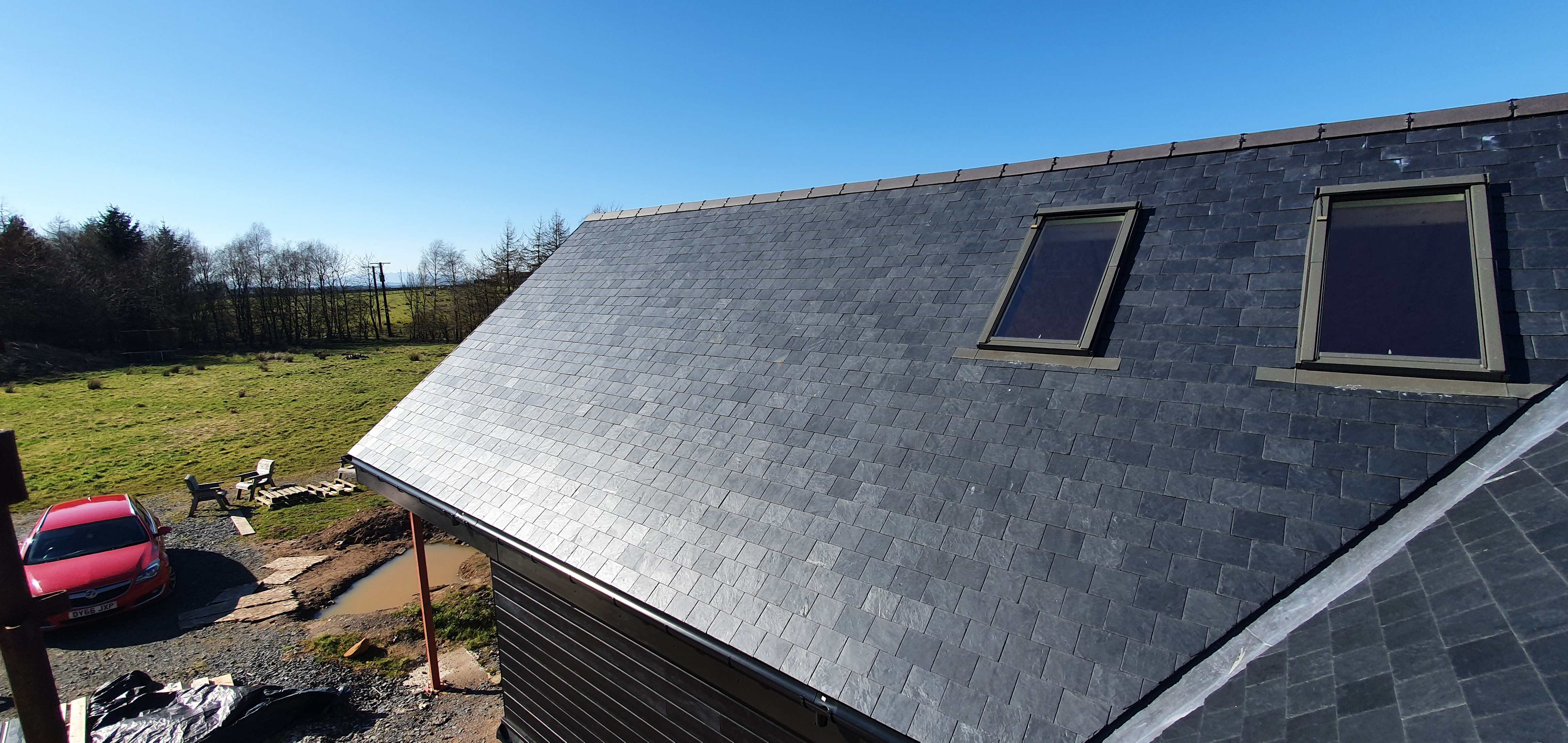

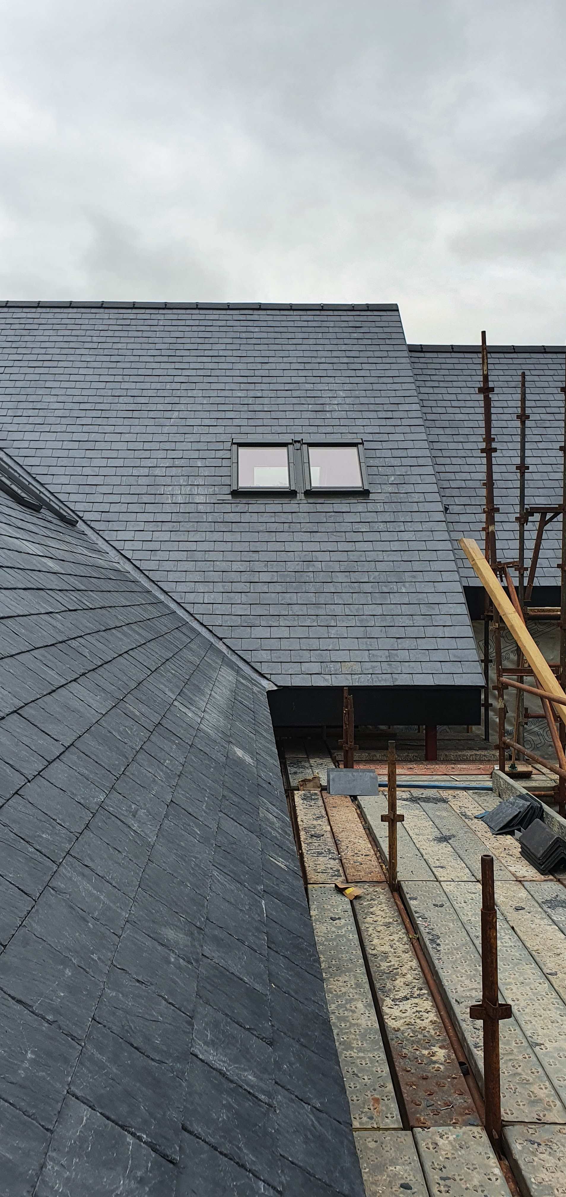

JohnMo Posted January 2, 2025 Posted January 2, 2025 2 hours ago, AdamD said: either concrete edgemere tiles or composite slate tiles Do real, you won't regret it, concrete and composite looks good for a short period, slate looks good for decades.
SuperJohnG Posted January 2, 2025 Posted January 2, 2025 What do you currently have? For longevity and Aestethics...go slate but natural. If you're not bothered and its in the houses adjacent go tile My slates Cupa RH2
