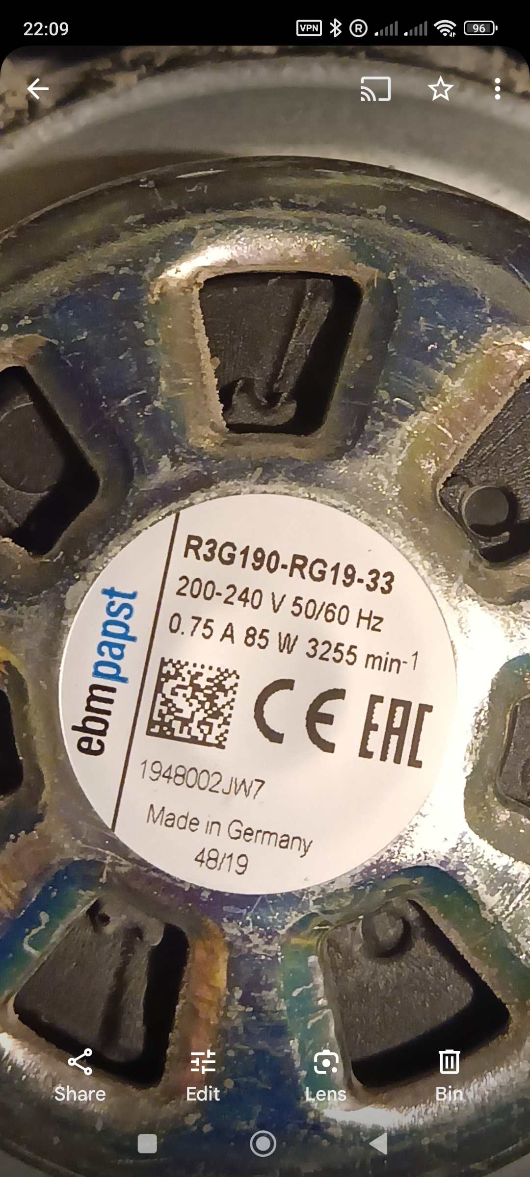

I've figured out the motor (EBM Pabst R3G190-RG19-22 (previously R3G190-RC05-09)), but can't find out anything about the bearings. It seems Brink would prefer you buy a new motor for several hundred quid rather than replace the bearings.

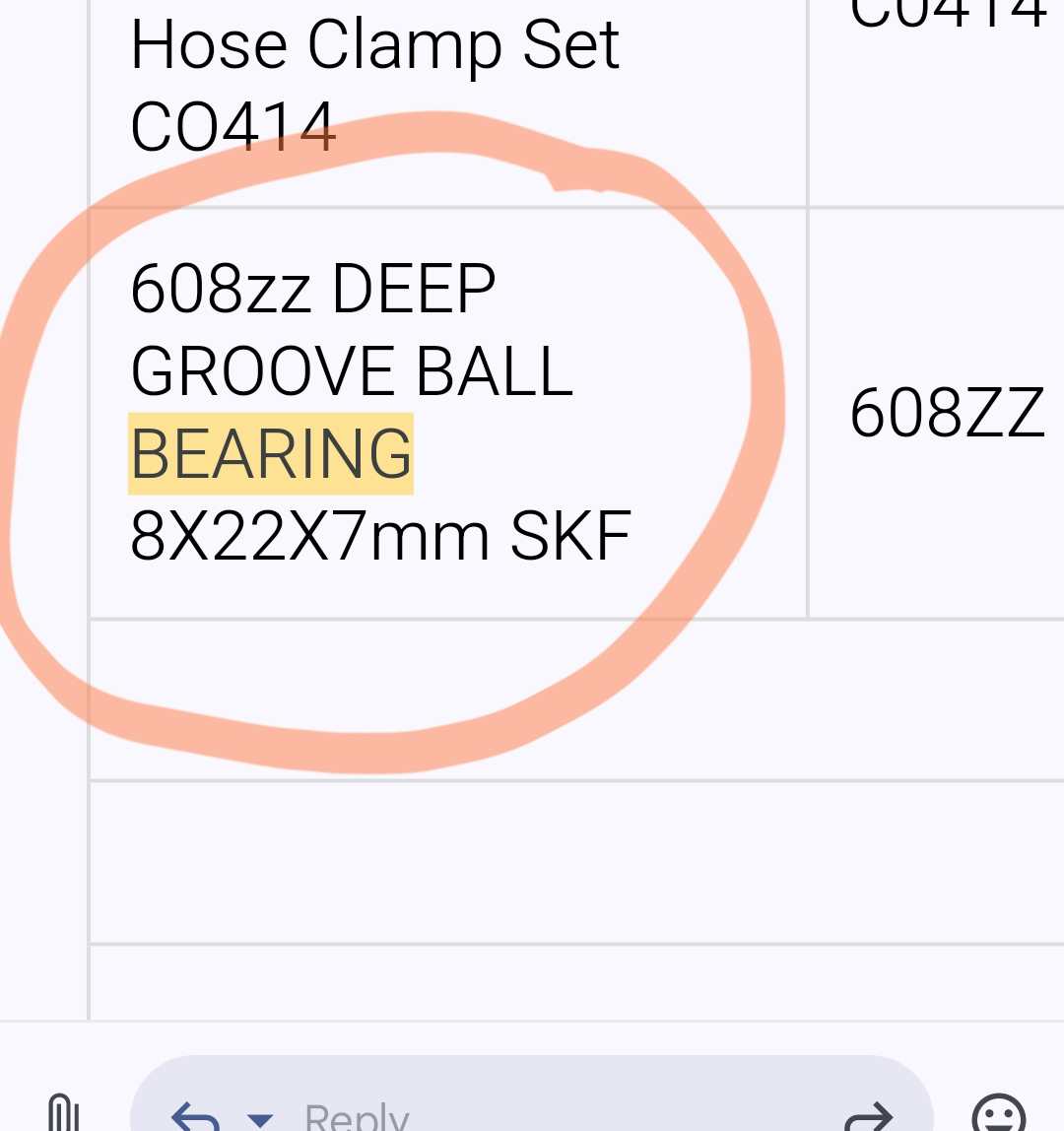

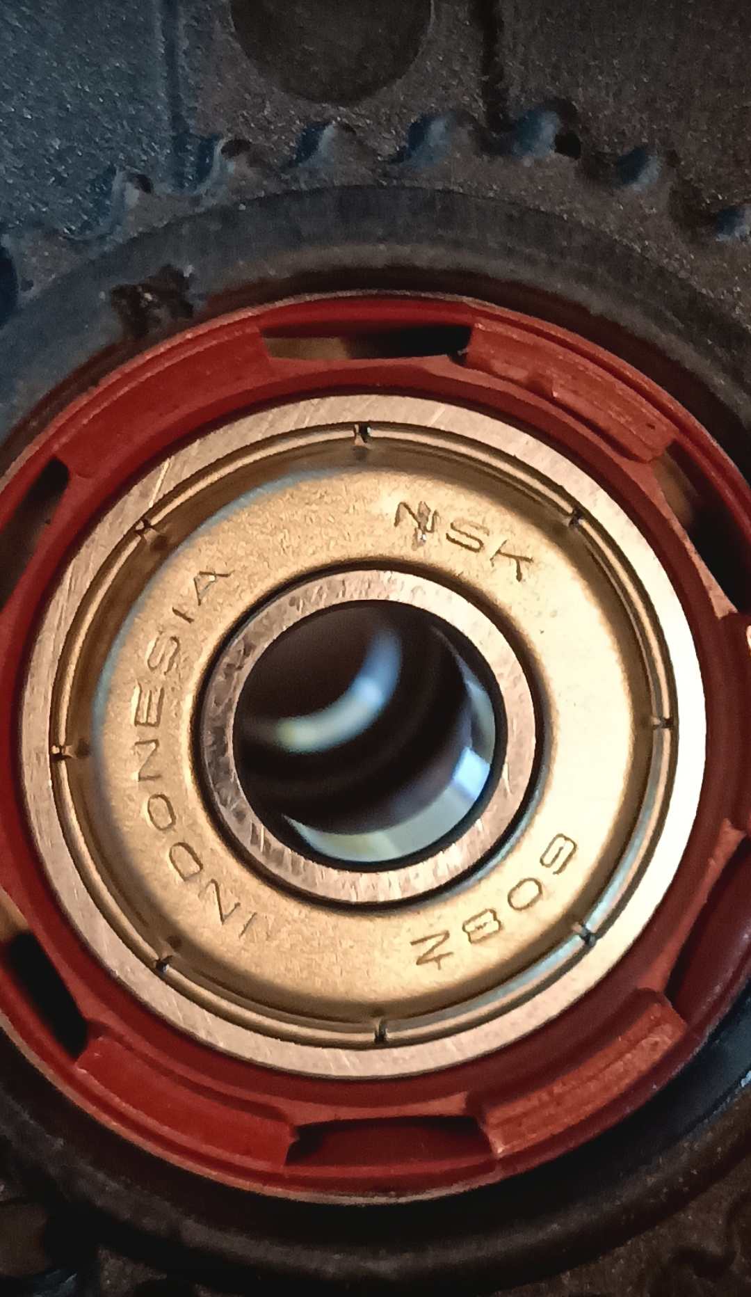

Here's the fans and the bearings I used.
Screenshot_2024-12-30-22-09-52-681_com.google.android_apps.photos.thumb.jpg.5ec052fd2ff695796e695e3582f914f5.jpgScreenshot_2024-12-30-22-10-52-438_com.google.android.gm-edit.thumb.jpg.399ed30261ea756d7fe6f61b3650358e.jpg
Screenshot_2024-12-30-22-16-34-695_com.google.android_apps.photos-edit.thumb.jpg.9f56def09e9dcff00c6ee7b924896219.jpg
That's the original bearing. It was a 608Z but I couldn't find any easily online from a reputable supplier so I opted for 608zz instead. I think it's the same thing other than sealed on both sides. It fitted and is working fine anyways.
