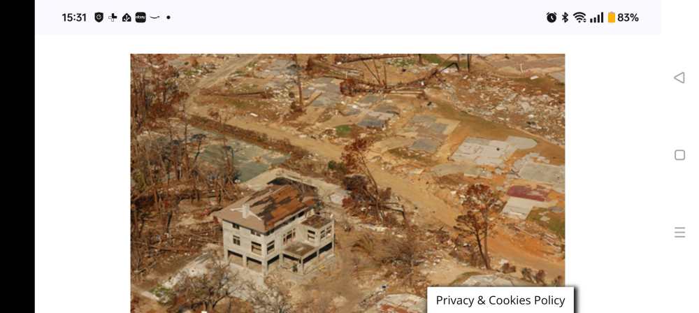

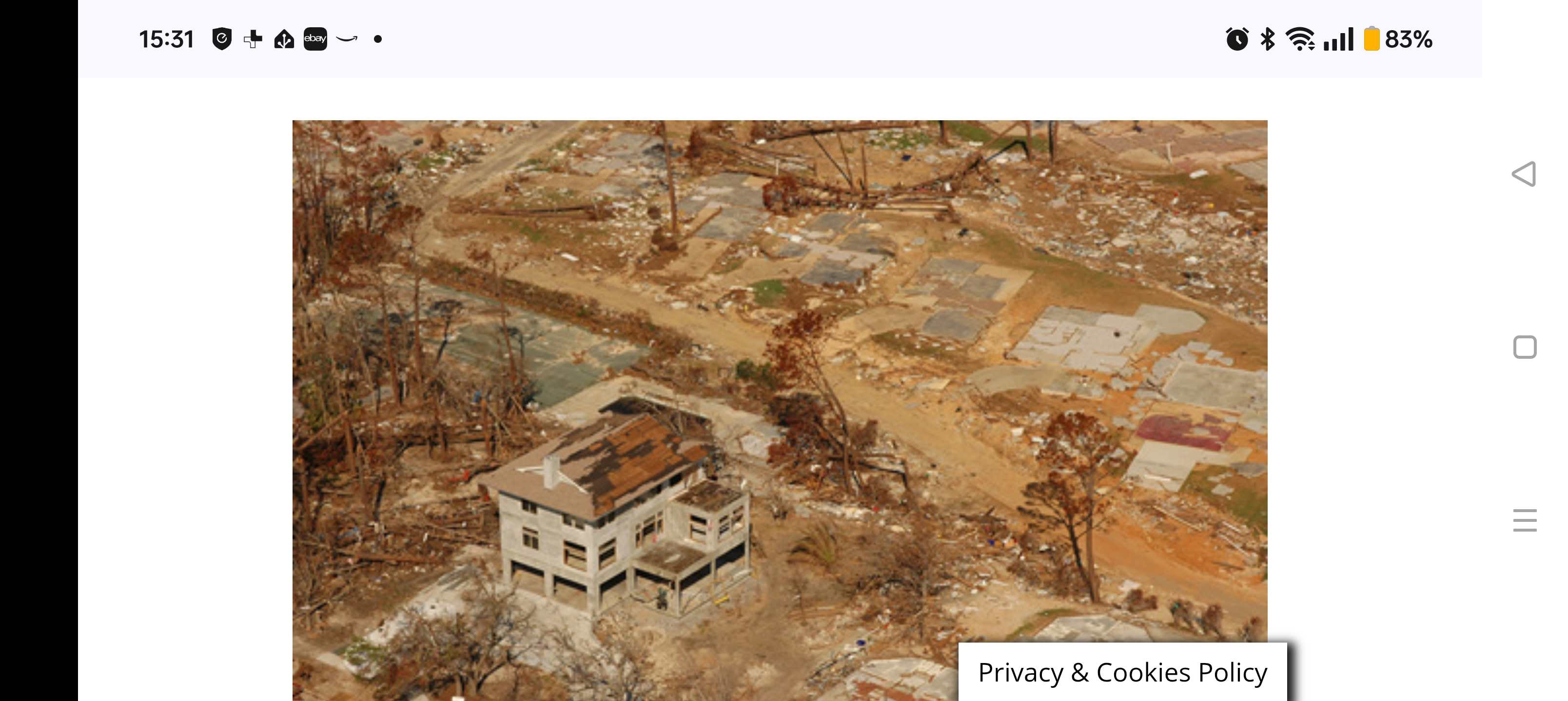

marshian Posted yesterday at 15:09 Share Posted yesterday at 15:09 9 minutes ago, SteamyTea said: An American friend of mine, who worked for a large Architect practice had never heard the saying 'put all your money into bricks and mortar'. Took her a while to work out what it meant, and confirmed her suspicions that the British are backward looking and parochial. When you live in an area impacted by Huricanes and Tornados in the USA - you build cheap as it's cheaper to rebuild - Bricks and mortar don't fare any better when faced with a powerful force of nature Link to comment Share on other sites More sharing options...
JohnMo Posted yesterday at 15:32 Share Posted yesterday at 15:32 22 minutes ago, marshian said: When you live in an area impacted by Huricanes and Tornados in the USA - you build cheap as it's cheaper to rebuild - Bricks and mortar don't fare any better when faced with a powerful force of nature Or you build with Durisol ICF Link to comment Share on other sites More sharing options...
Nickfromwales Posted yesterday at 15:53 Share Posted yesterday at 15:53 21 minutes ago, JohnMo said: Or you build with Durisol ICF Nah....Durisol did nothing there to protect the glass in the windows Link to comment Share on other sites More sharing options...
