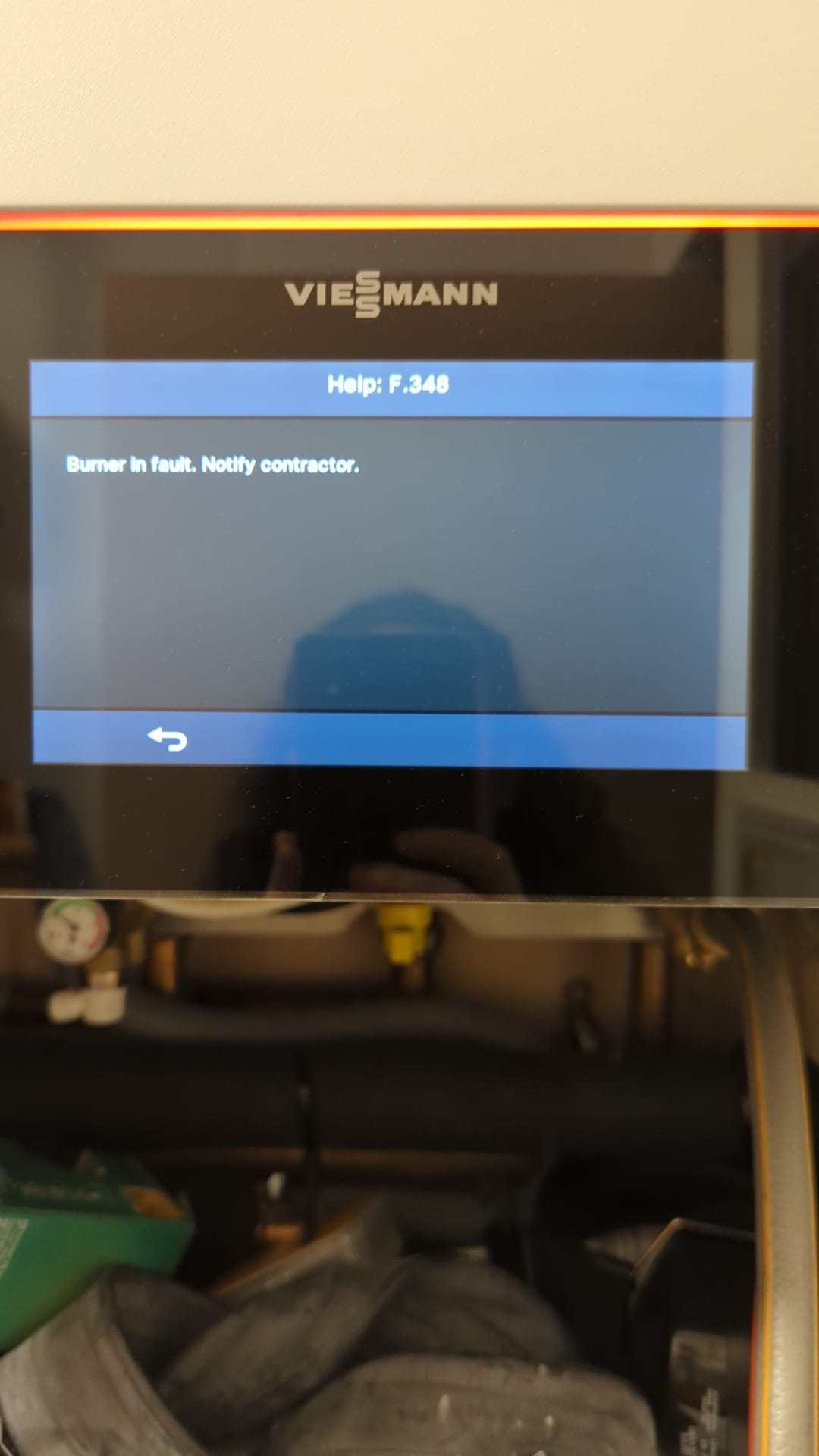

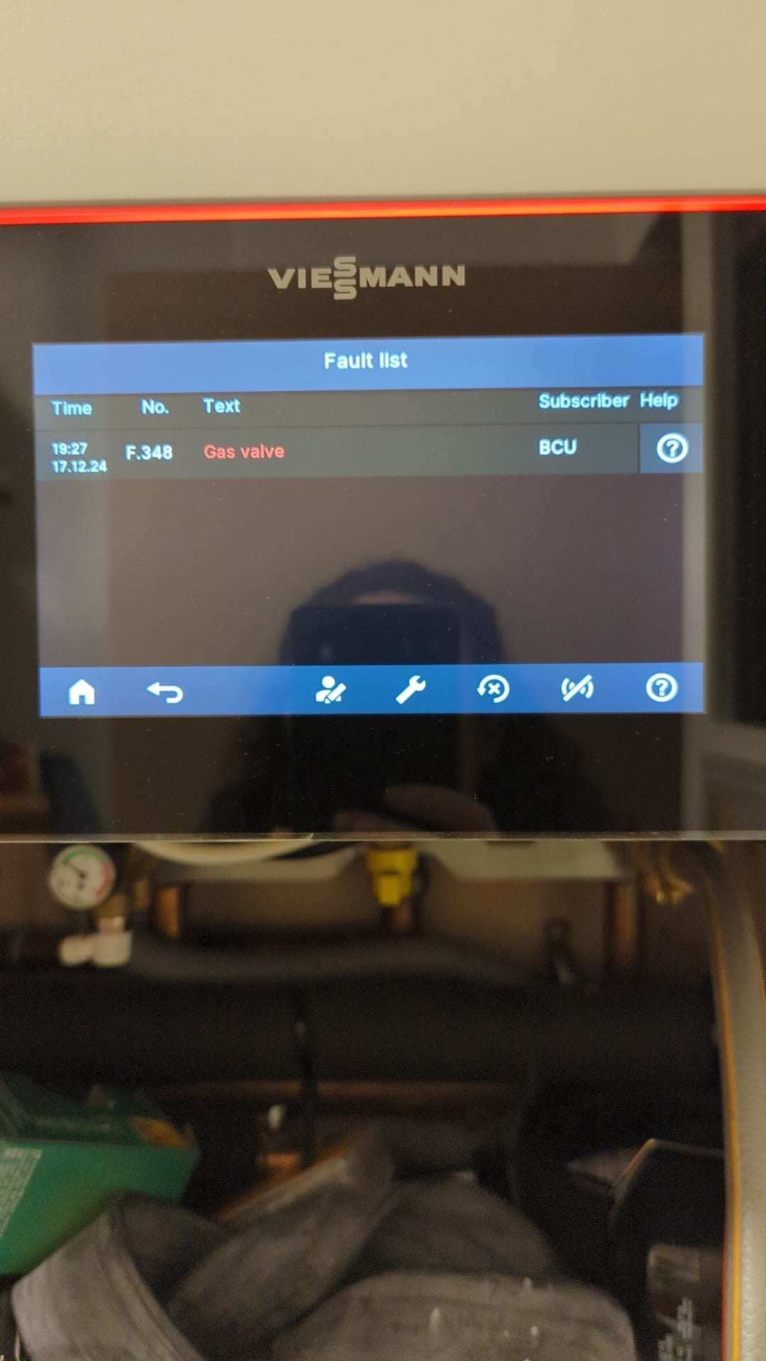

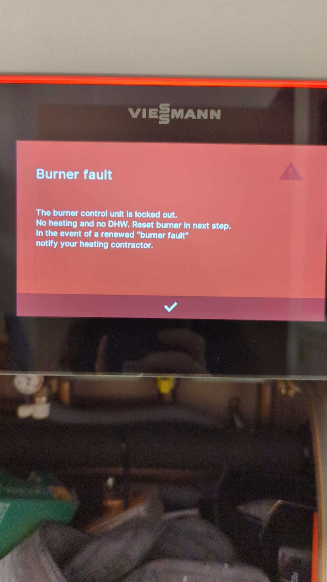

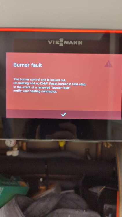

Adsibob Posted Thursday at 20:05 Share Posted Thursday at 20:05 (edited) We have a Veissman Vitodens 200-W system boiler. Installed new 3 years ago, only used for 2.5 years. At 35kw massively oversized, so rarely modulates above 40% (this was not intentional, I mistakenly followed my heating engineer’s advice and went much bigger than the 19kw my heat loss calcs showed). It has been serviced each year and still under warranty. But not much use the week before Christmas. Do I get it repaired by whoever I can find and then sue Veissman?!? Ffs! Here are the error messages: Edited Thursday at 20:30 by Adsibob Link to comment Share on other sites More sharing options...

Adsibob Posted Thursday at 21:15 Author Share Posted Thursday at 21:15 43 minutes ago, MikeGrahamT21 said: Turned it all off and back on again? sorry I work in IT 😂 Funnily enough, this has solved the issue. But I’m still concerned given the fault is something to do with a gas valve. If the gas valve is faulty I rather not run the boiler! Hmmm… what now? Link to comment Share on other sites More sharing options...
Huckleberrys Posted Thursday at 22:18 Share Posted Thursday at 22:18 Have you spoken to viessman and got an engineer appointment booked in? They are usually pretty good Link to comment Share on other sites More sharing options...
joe90 Posted Thursday at 22:21 Share Posted Thursday at 22:21 (edited) 1 hour ago, Adsibob said: Funnily enough, this has solved the issue. But I’m still concerned given the fault is something to do with a gas valve. If the gas valve is faulty I rather not run the boiler! Hmmm… what now? If turning off and on has cleared the fault then the fault was electrical giving a faulty diagnosis, if the gas valve was faulty then the fault would still be there on screen. Edited Thursday at 22:22 by joe90 Link to comment Share on other sites More sharing options...
Adsibob Posted Thursday at 23:51 Author Share Posted Thursday at 23:51 1 hour ago, joe90 said: If turning off and on has cleared the fault then the fault was electrical giving a faulty diagnosis, if the gas valve was faulty then the fault would still be there on screen. I hope you are right. I will call Veissman in the morning Link to comment Share on other sites More sharing options...

MikeGrahamT21 Posted yesterday at 10:15 Share Posted yesterday at 10:15 12 hours ago, Adsibob said: Funnily enough, this has solved the issue. But I’m still concerned given the fault is something to do with a gas valve. If the gas valve is faulty I rather not run the boiler! Hmmm… what now? As you'd expect for gas, they are quite sensitive, i've seen it happen before where it locks out and it doesn't mean anything, but of course worth getting it checked. Could be something as daft as a slight drop in local gas pressure. Link to comment Share on other sites More sharing options...
Adsibob Posted yesterday at 14:26 Author Share Posted yesterday at 14:26 4 hours ago, MikeGrahamT21 said: As you'd expect for gas, they are quite sensitive, i've seen it happen before where it locks out and it doesn't mean anything, but of course worth getting it checked. Could be something as daft as a slight drop in local gas pressure. I called Veissman and they think it might be a manufacturing fault so are going to send out an engineer on Monday under the 12 year warranty I paid for. Of course if it’s not a fault, I get charged £144! You may be right about local gas supply. If there is a sudden drop in temperature as we had, everyone will suddenly use more gas. Link to comment Share on other sites More sharing options...

FarmerN Posted yesterday at 16:02 Share Posted yesterday at 16:02 14 minutes ago, marshian said: I don’t think I’d be calling an engineer out if no repetative fault - £144 is a lot of money - will be an interesting conversation OP “here I saved screen shots of the fault” GE “no fault in system now - £144 please - cash or card” Good luck Screen clearly says- " Notify Contractor. " Link to comment Share on other sites More sharing options...
Adsibob Posted yesterday at 16:31 Author Share Posted yesterday at 16:31 26 minutes ago, FarmerN said: Screen clearly says- " Notify Contractor. " Indeed! And on calling them this morning they did speak to a technical guy who said it sounded like a manufacturing problem. My installer is abroad till 10th Jan, and I really don’t want to take any chances (with gas leaks or loss of heating/HW over the next couple of weeks. Link to comment Share on other sites More sharing options...
