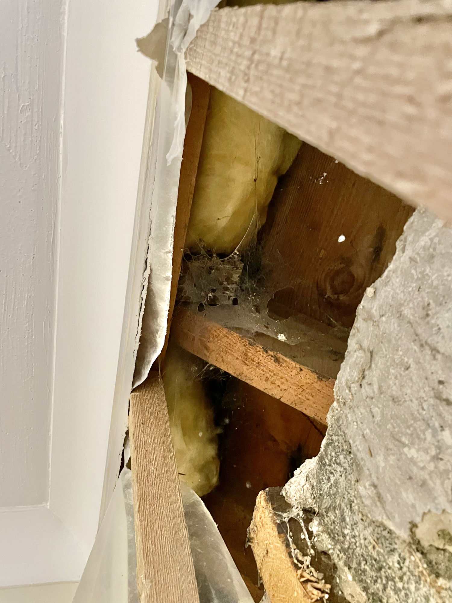

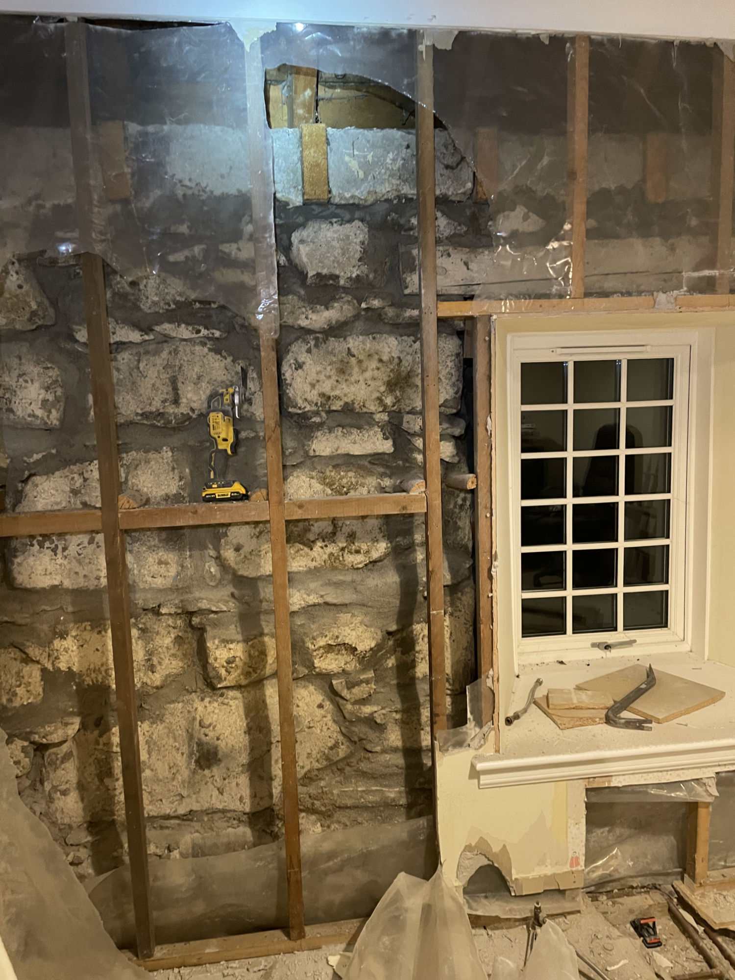

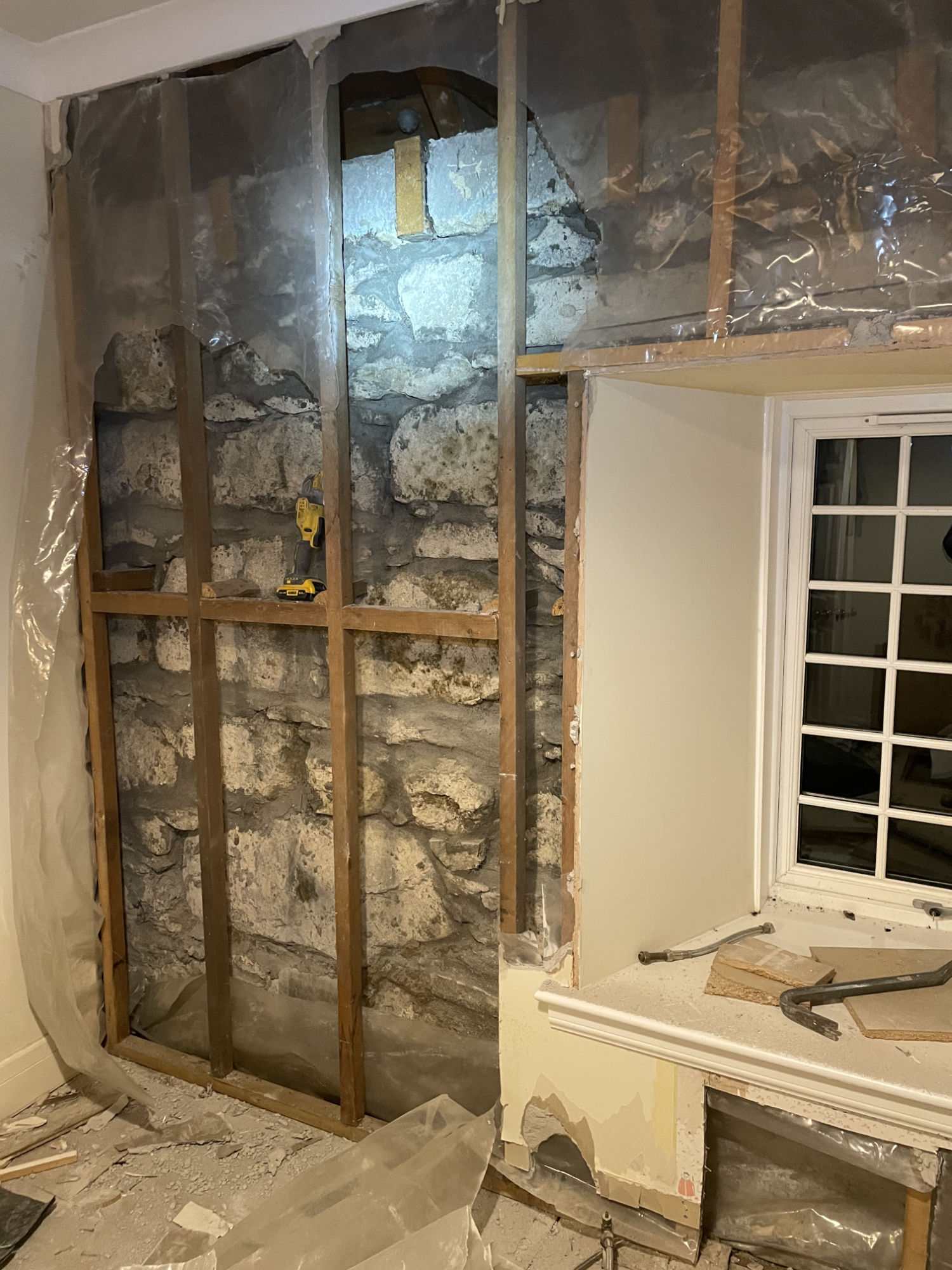

sb1202 Posted December 12, 2024 Posted December 12, 2024 Thanks for adding me. Looking for advice on how to best insulate the internal walls of a stone built cottage. It's single storey with some modernisation from the 1980s. Walls are 600mm (not 400mm). Internal walls are drywall with vapour barrier on 50mm batten frame and at 150mm gap from the walls. Roof is insulated with about 300mm knauf type wool. Floor is concrete/dpm and chipboard on 50mm and not insulated. I upgraded the anel rads to columns a couple of years ago and this made a difference but it's still difficult to retain heat. There's no damp and I've taken the drywall out in one room, and again, everything bone dry. The humidity sits around 50% in winter. I'm installing UFH in the next month and looking to finish it off with internal insulation. I've read as much as I can but I need advice as I've read so many different ways. This will be DIY (I'm an electrical engineer and pretty competent when it comes to carpentry and most general building works) Photos attached give an idea of the rooms. This is aberdeenshire. Thanks for any help.

saveasteading Posted December 12, 2024 Posted December 12, 2024 You might be able to staple a membrane behind the stud if you are a contortionist. Then fill between studs. Then a service gap and a finish. That adds up to a half decent insulation. The wall itself is contributing if the outside is well pointed. 1
sb1202 Posted December 12, 2024 Author Posted December 12, 2024 42 minutes ago, saveasteading said: You might be able to staple a membrane behind the stud if you are a contortionist. Then fill between studs. Then a service gap and a finish. That adds up to a half decent insulation. The wall itself is contributing if the outside is well pointed. This is the part that's confusing me - why is a membrane required for the cold side? What do you mean by a service gap? yeah, outside it well pointed. I can take out the studs easily enough and start afresh.

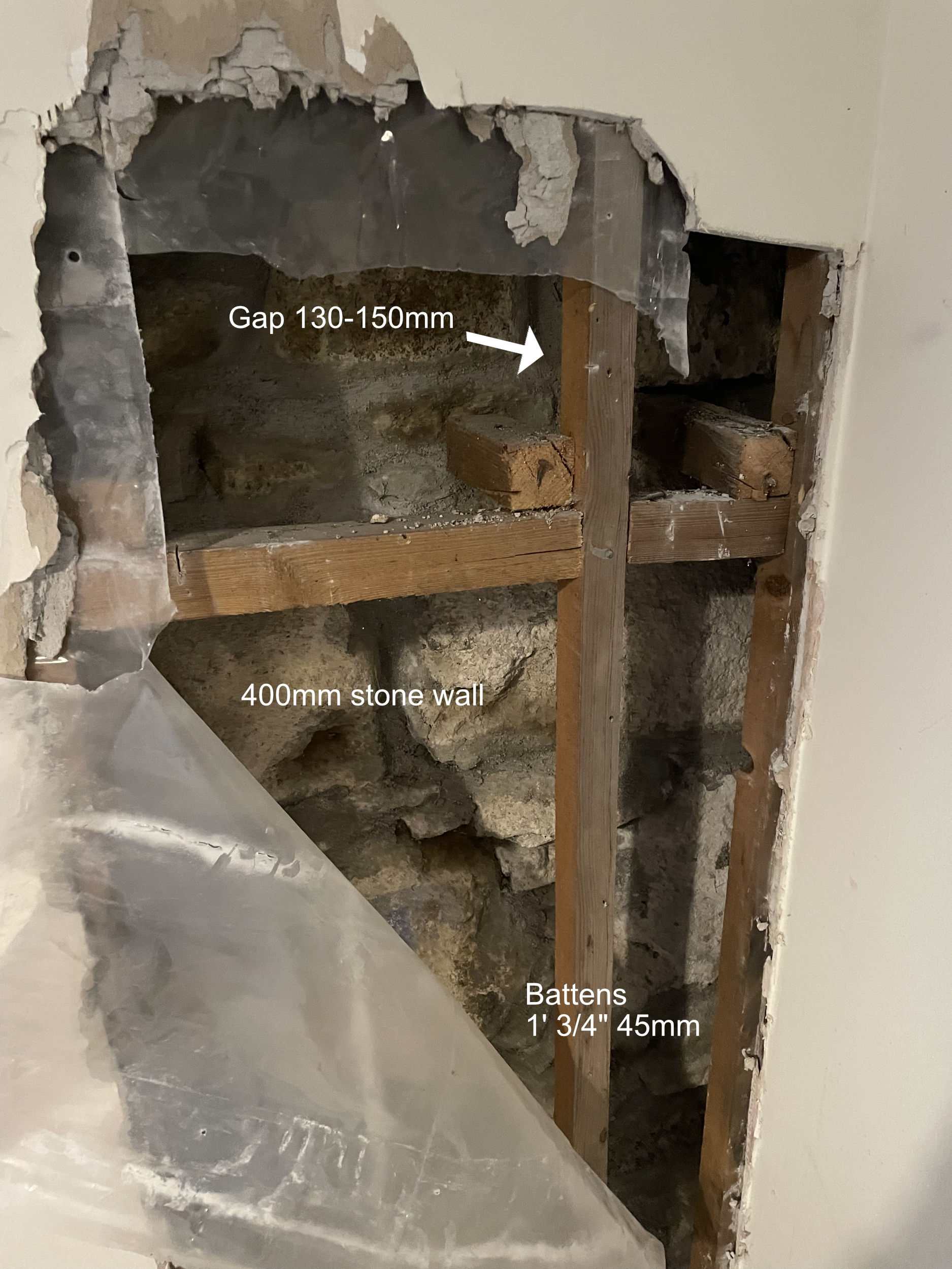

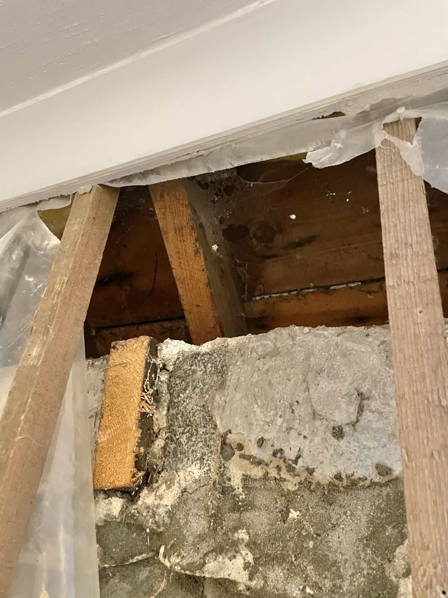

saveasteading Posted December 12, 2024 Posted December 12, 2024 I notice that your stud is only 45mm deep. that isn't strong enough for normal stiffness (it will bend if shouldered, and cracks could appear or pictures fall off. So either add to it or replace. 100mm stud will do but more will allow more insulation but lose floor space. I have no issue with having 100mm or more insulation. if you leave a gap from stud to stone it will look after itself. There is only so much you can do with an old stone wall. Also, the roof has planked sarking boards. These have gaps between them so there is loads of ventilation. 3 skin stone walls have decent inbuilt properties for losing the dampness. Yours is presumably granite which is waterproof, but needs good pointing. So I suggest you have the following 600mm stone wall gap, 25mm minimum, but it will be very variable. vapour barrier on stud 100mm stud, containing 50mm pir board and 50mm knauf mineral wool (100mm pi is difficult to fit accurately) polyethene layer 30mm battens plasterboard. This is likely to be how your stone walls are built, with the middle having lots of mortar. 1
ProDave Posted December 13, 2024 Posted December 13, 2024 10 hours ago, saveasteading said: I notice that your stud is only 45mm deep. that isn't strong enough for normal stiffness (it will bend if shouldered, and cracks could appear or pictures fall off. That is common for old stone houses here, and you will note from the pictures the studwork is pegged to the stone wall in several places. 1
scottishjohn Posted December 13, 2024 Posted December 13, 2024 (edited) I know some will say i,m making a bigger job than required youdo not need 150mm space behind studs 50mm +is fine and yes studs look very small you could replace them with larger ones and reduce space behind then fill with what ever your choice of insulation me i would go PIR jam them in the studs and fill any gaps with foam then your vapour barier on inside of insulation and if space and money allow insulated plaster board -- - foil backed pir will not absorb any moisture and will reflect cold back to the outer wall the most of the moisture will come from you living in there so thats why i say put it on inside of insulation and if done right there should be no cold spots to cause condensation attention around window reaveals is important - behind the uprights and under the lower internal widow ledge sealing it all this stage is the key so no cold spots to cause condensation you only spend once on insulation --and it pays back forever Edited December 13, 2024 by scottishjohn 2
sb1202 Posted December 13, 2024 Author Posted December 13, 2024 11 hours ago, saveasteading said: 30mm battens What are these for? 11 hours ago, saveasteading said: I notice that your stud is only 45mm deep. that isn't strong enough for normal stiffness (it will bend if shouldered, and cracks could appear or pictures fall off. So either add to it or replace This is really common in these type of renovations. The studs are tied to the walls with pegs so its pretty rigid. The cottage throughout has heavy wall cabinets, bathroom is fully tiled etc and the studs are bang on plumb after 40 years. Agree that some more depth will help for thicker insulation. 12 hours ago, saveasteading said: 100mm stud will do but more will allow more insulation but lose floor space. There's enough wiggle room to sister the studs towards the wall and keep the floor space intact - will be a pain in the proverbial though Thanks for the reply - it helps a lot.

Ferdinand Posted December 13, 2024 Posted December 13, 2024 3 minutes ago, sb1202 said: I've seen videos using a foil edging tape. Apparently this works better than foam. Yeah, the problem is the high and low spots in the wall. I took measurements and the gap from stud to wall varies from 60mm-160mm on this one room. I'm presuming there will be similar deviations in the other rooms. You arguably need both - foil edging tape does not insulate, so if you get convection currents within the gap that can bleed hear away. If your foam bulges like Lord Bufton-Tufton's eyebrows, you can just trim it back. 1
sb1202 Posted December 13, 2024 Author Posted December 13, 2024 2 hours ago, ProDave said: That is common for old stone houses here, and you will note from the pictures the studwork is pegged to the stone wall in several places. Yeah - very common. I've seen this in lots of other houses I've worked on. I found the old plans and it was spec'd by the architect for 50x45mm studs and 60mm "pillow" insulation. I've since learned that the previous owner who did the renovation was as tight as the proverbial duck's bahookie.
