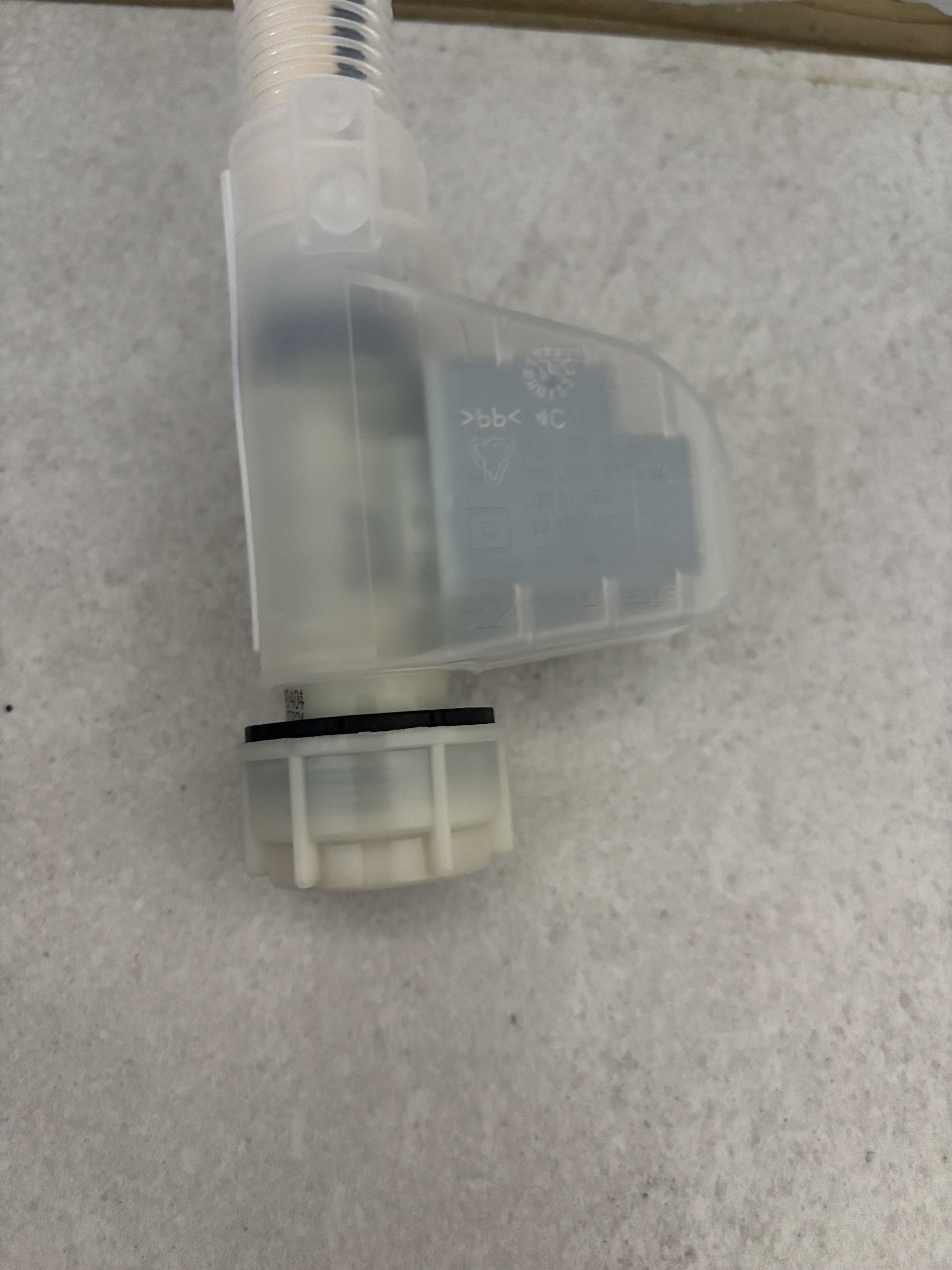

80's Owl Posted December 9 Share Posted December 9 I've just bought a Bosch dishwasher and the water connection is of a type I've never seen before, the Beko one I have replaced it with had a standard 3/4" washing machine type connection whereas the Bosch has the thing below that doesn't fit onto the mains 3/4" isolator, there was nothing else supplied to make this connection, what do I need to do? Link to comment Share on other sites More sharing options...
SteamyTea Posted December 9 Share Posted December 9 I usually use the feed that came with the last washer. Must be 20 years old now. Is it some sort of filter? Link to comment Share on other sites More sharing options...
80's Owl Posted December 9 Author Share Posted December 9 6 minutes ago, SteamyTea said: I usually use the feed that came with the last washer. Must be 20 years old now. Is it some sort of filter? This ones built in at the appliance end so I can't just swap the hose, it looks like a filter but not sure, I've not seen anything like it before. Link to comment Share on other sites More sharing options...
trialuser Posted December 9 Share Posted December 9 (edited) I believe its their safety device whereby if it detects an abnormal flow of water, eg a leak within the machine, it cuts off the supply. As far as I remember, mine just screwed into the existing house plumbing EDIT, Aquastop Edited December 9 by trialuser added name of thingy Link to comment Share on other sites More sharing options...
80's Owl Posted December 9 Author Share Posted December 9 30 minutes ago, trialuser said: I believe its their safety device whereby if it detects an abnormal flow of water, eg a leak within the machine, it cuts off the supply. As far as I remember, mine just screwed into the existing house plumbing EDIT, Aquastop That makes sense but it doesn't fit on the isolator I already have it seems like the appliance fitting is 1/2" and that's 3/4". Link to comment Share on other sites More sharing options...

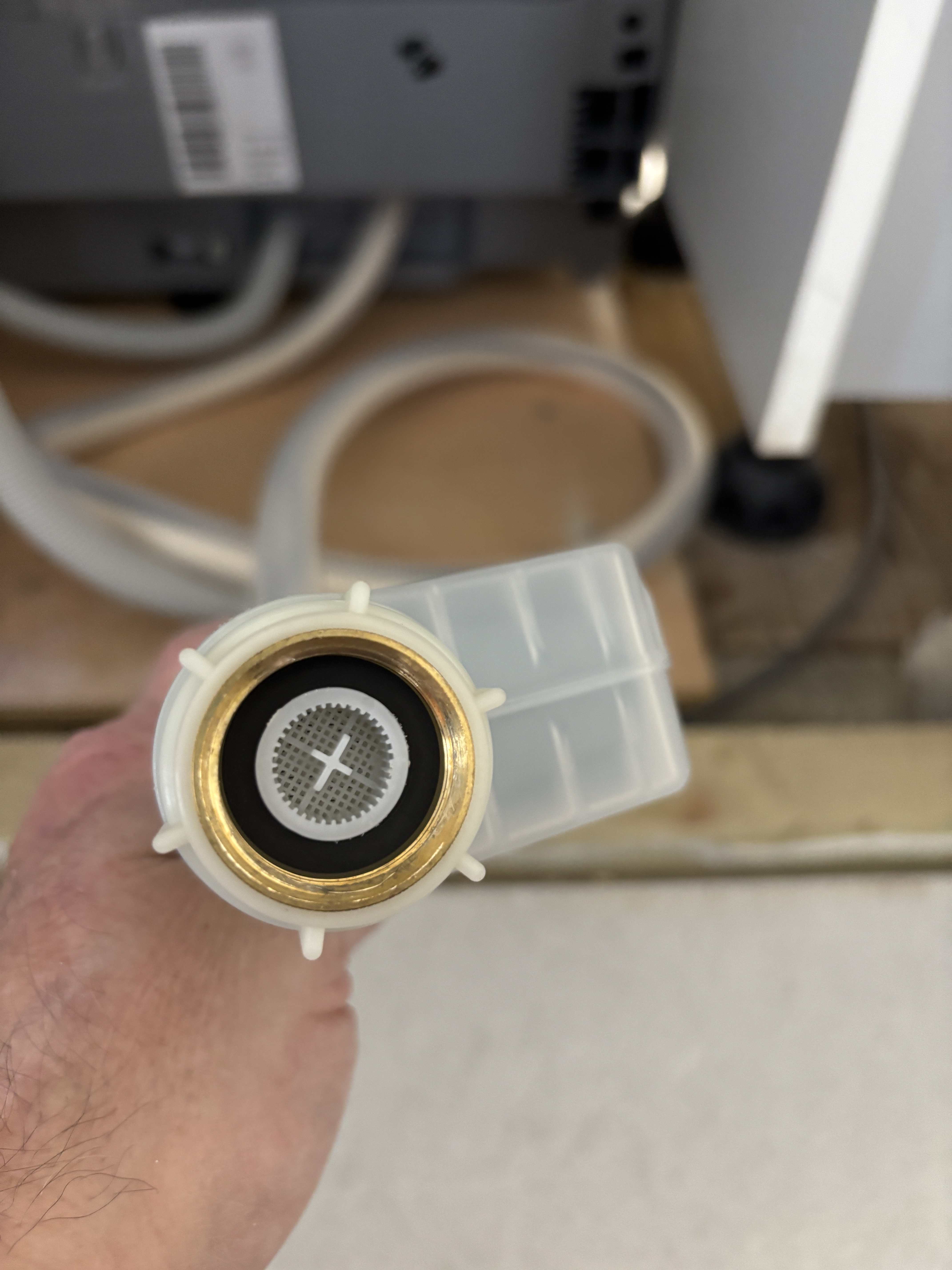

joe90 Posted December 9 Share Posted December 9 Ah, I misinterpreted your post. Can you check the paperwork to see if it’s mentioned, if not what model is it? Link to comment Share on other sites More sharing options...
Kelvin Posted December 9 Share Posted December 9 Yes it’s called Aquastop and is used across the Bosch family brand. It has a solenoid that closes if it detects a leak. It uses a 3/4” thread. Link to comment Share on other sites More sharing options...

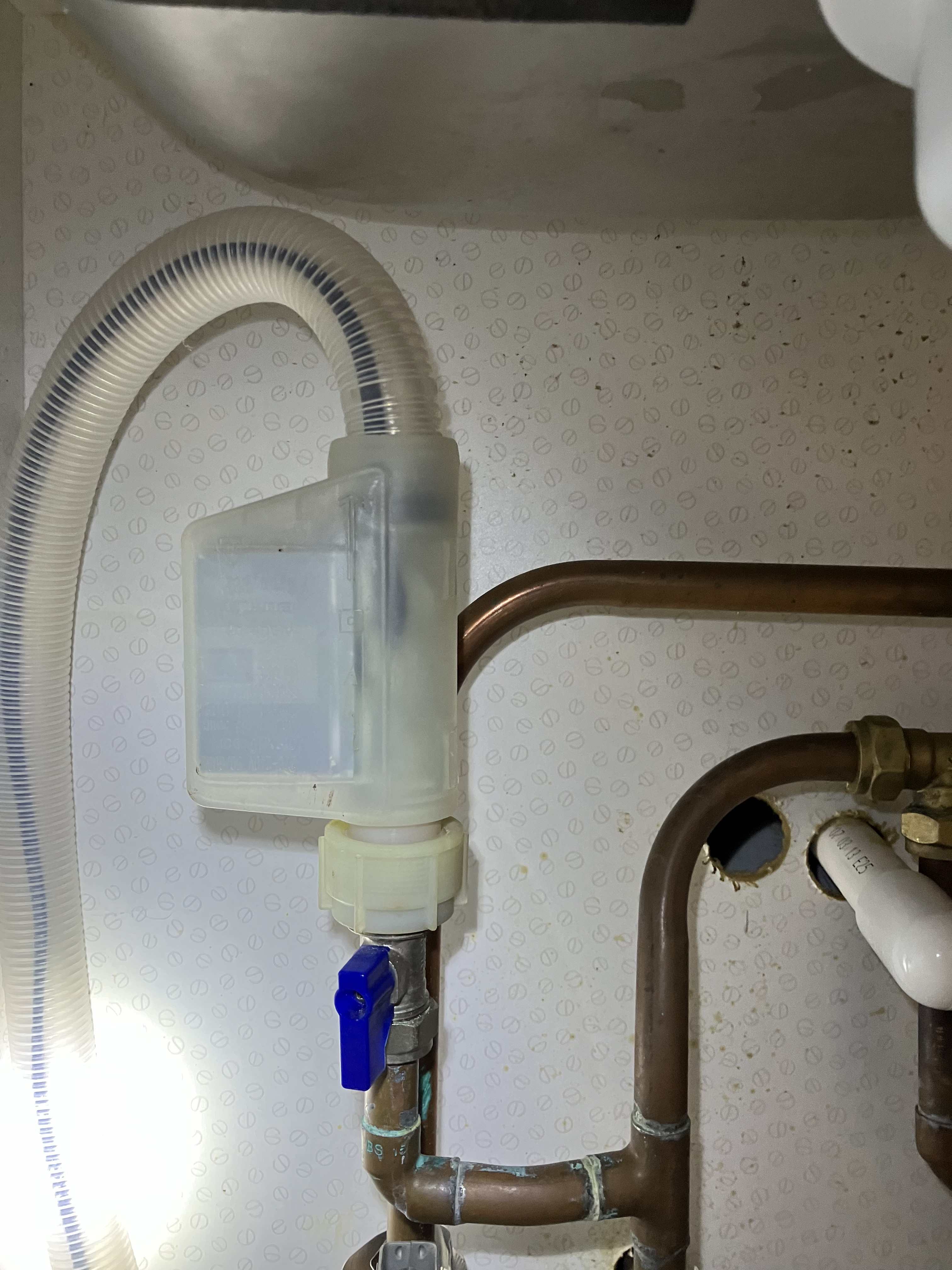

joe90 Posted December 9 Share Posted December 9 Here is mine on a standard 3/4? Fitting Link to comment Share on other sites More sharing options...

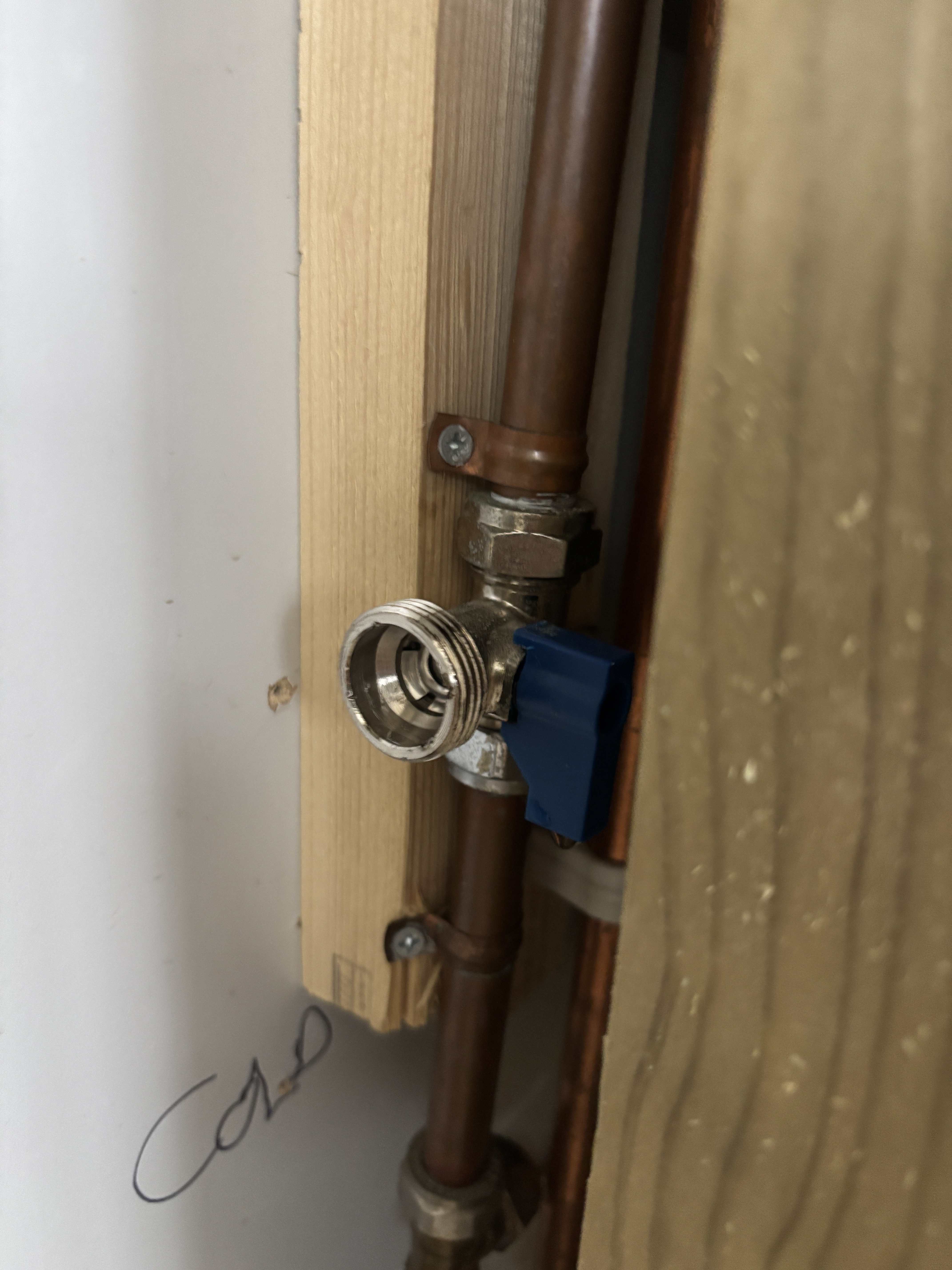

80's Owl Posted December 9 Author Share Posted December 9 36 minutes ago, joe90 said: Here is mine on a standard 3/4? Fitting This is what I was trying to attach mine to, not sure if it needs anything fitting to that first. Link to comment Share on other sites More sharing options...
joe90 Posted December 9 Share Posted December 9 No,, that’s an in line washing machine/dishwasher 3/4” connector. Are you sure your machine came with a 1/2” ? Measure it. Link to comment Share on other sites More sharing options...

80's Owl Posted December 9 Author Share Posted December 9 16 minutes ago, joe90 said: No,, that’s an in line washing machine/dishwasher 3/4” connector. Are you sure your machine came with a 1/2” ? Measure it. I only guessed it was half inch due to the fact I couldn't get it to fit. Link to comment Share on other sites More sharing options...
Gone West Posted December 9 Share Posted December 9 We've got a similar fitting on our Miele dishwasher and that screwed onto a 3/4" washing machine tap. Link to comment Share on other sites More sharing options...
80's Owl Posted December 10 Author Share Posted December 10 Managed to sort, I did when I was a bit calmer and it fitted easily, thanks for all the help and Merry Xmas to you all. 1 1 Link to comment Share on other sites More sharing options...
