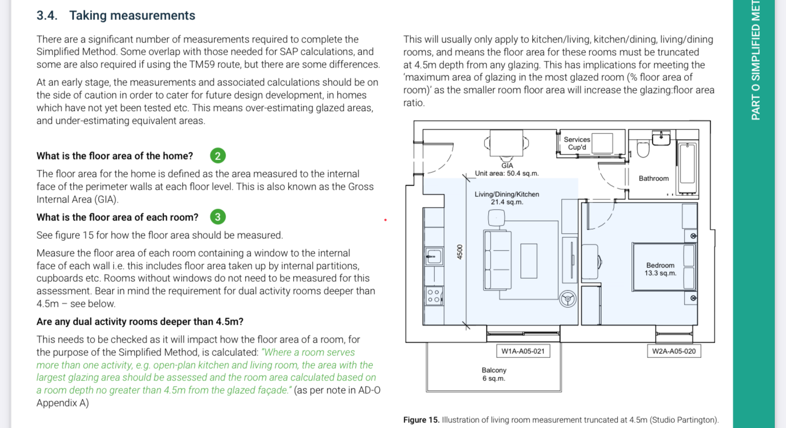

Nickfromwales Posted December 6 Share Posted December 6 22 hours ago, G and J said: We are aiming at nicely airtight as we will have MVHR, but our insulation levels are modest (for a number of reasons more or less building regs in fact). Our design has limited amounts of glazing, but it does have a 4m wide patio door at the back. We can’t use the simplified method, as we can’t claim blow through and the patio doors blow it for one room. The house doesn’t look overly complex at all. I would simply oversize the MVHR system slightly to allow for effective purge ventilation, and see if that takes any other mitigatory requirements out of the picture in one swoop. I recently chatted with Nicholas Vaisey (CVC Systems, Oxford) for this exact reason, and for options to navigate this. These guys do all of my self-build clients heating / heat pump / hot water and MVHR, design, supply (and install (when I am too busy)) and this methodology provided a simple, practical, cost-effective (and elegant) solution in one box. This was considered in a set of proposals I’ve just done for a mass home builder, where I was drafted in to provide pre-construction M&E / plumbing design specifications for 2 large sites; Part O raised its head and everyone on the project just became disorientated as they weren’t used to dealing with it, clearly, with technical staff seeming utterly clueless tbh and were obvs out of their depth there! Doesn’t bode well for anyone buying one of their sausage-factory ‘boxes’….. If the house is having MVHR anyways then economy of scale says this would be the easiest and cheapest route, eg to slightly over spec at the design level at minimal cost-uplift, adding in an assumption that slab cooling via UFH / ASHP is already possible / being considered? Combatting audibility (at higher airflow rates in the summer) with some extra thought going into the design for the distribution ductwork needs to be factored in, but at that point I would defo rule out a series run setup and go for radial. What is the target airtightness score that you are aiming for? I think AT is more important than insulation as you can have a foot of PIR, but with high infiltration rates, and still see a cold house each winter. 1 Link to comment Share on other sites More sharing options...
Susie Posted December 6 Share Posted December 6 9 hours ago, G and J said: After reading your stuff about it we did try doing the future homes spreadsheet. Now we are doing it very strictly and we could not get the results thing all ok. We do have some fixed windows, and from memory one of the issues is that the patio doors aren’t in a huge room, so proportionally it appears on the spreadsheet to be too much. However, I’m now scratching my stubble and thinking, ‘ok, maybe I’ll try this again’…. It seems ages since I used the spreadsheet now but aren’t the facade directions calculated rather than rooms. it looks like you have large (bedroom) windows upstairs do they open? Do they open enough at nighttime? if you upload the spreadsheet we can possibly help, a pdf would be ok as that still gives the overall values and how close you are to the figures you need to be within. Link to comment Share on other sites More sharing options...

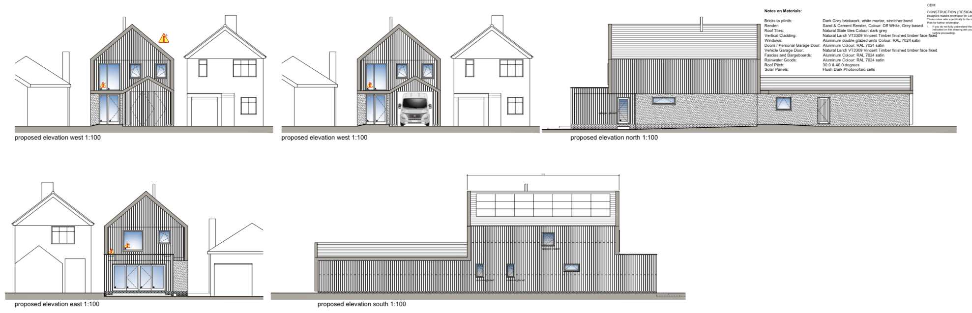

G and J Posted December 7 Author Share Posted December 7 15 hours ago, Susie said: aren’t the facade directions calculated rather than rooms The spreadsheet uses a clock face type designation for the direct each window is facing and then in a separate box you set which direction the clock face is orientated to. In our case that bit is easy, our drawing are draw with due north damn near directly upwards. 15 hours ago, Susie said: large (bedroom) windows upstairs do they open? Do they open enough at nighttime The big one has an oriel and is fixed to avoid needing a balustrade and the small one does fully open. 15 hours ago, Susie said: if you upload the spreadsheet we can possibly help, a pdf would be ok as that still gives the overall values and how close you are to the figures you need to be within. Will do, we’ve been messing with it to try and understand how it works and so I’m going to redo it from scratch first. I’d be chuffed to bits with some help here, so thank you. Link to comment Share on other sites More sharing options...
Alan Ambrose Posted December 7 Share Posted December 7 >>> We can’t use the simplified method, as we can’t claim blow through and the patio doors blow it for one room. I must have missed than sentence before. I started using PHPP only for Part O, ‘cos standard method doesn’t allow adjustment for low G glass or external blinds. I was able to show that those elements alone would solve any overheating problem easily. So, calculations aside, maybe one or both of those factors would solve any practical overheating problem? Or brise soleil or eaves overhang of course. Link to comment Share on other sites More sharing options...

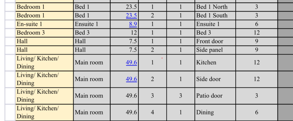

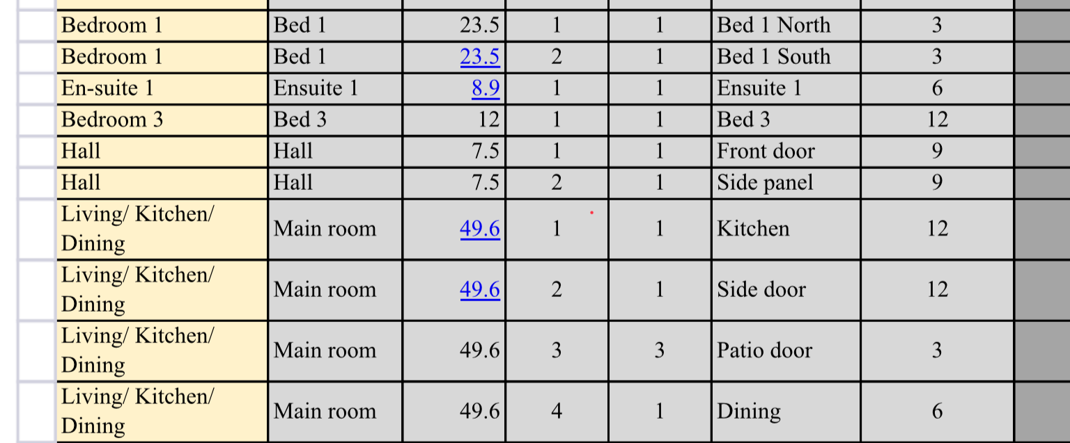

G and J Posted December 7 Author Share Posted December 7 So, here it is, my latest attempt (of several) to get this b$£**!!ing spreadsheet to reflect common sense. I'd be chuffed if anyone can identify where I'm going wrong and thus can avoid a dynamic modelling thingy. 20241207 Simplified Part 0 - munged.xlsx Link to comment Share on other sites More sharing options...
Susie Posted December 7 Share Posted December 7 only had a very quick look but a few q’s bed 1 does it have two windows your calling them north and south but both on clock face 3, so this impacts on the most glazed facade. You have marked south as being clock face 6 but said the windows are on 3 being east. A quick look at the plan makes me think the clock face is correct just the label misleading to me anyway. This room will be a problem can the window that opens open inwards and more degrees you need more air flow at night. The living/kitchen/dining area sounds like it’s open plan on 3 different clock faces so it should be calculated as if it’s three different rooms see guidance below can’t follow your window and pane numbering I did mine to match up with the clock face starting at window 1 until all the way round the building giving each one a number 1,2, 3 through to the last window before the first. BCO probably won’t pay the spreadsheet much more than check it says pass but keeping it so they see 12 windows on building matching up to 12 windows on spreadsheet keeps it simple. Then if one window is split into two panes eg if window 1 has 4 panes that’s shown as window 1 pane 1, window 1 pane 2 etc same for a sliding door or bi fold only a sliding door is one fixed one open .I had a sliding door one side fixed and one side fully open 100% Make any changes if necessary then upload again. Link to comment Share on other sites More sharing options...

G and J Posted December 7 Author Share Posted December 7 12 minutes ago, Susie said: bed 1 does it have two windows your calling them north and south but both on clock face 3, so this impacts on the most glazed facade. You have marked south as being clock face 6 but said the windows are on 3 being east. Both bed 1 windows face east. I called them north and south to differentiate them, i.e. the more northerly of the two and the more southerly. I can see (now) that being confusing. Sorry. I do appreciate you taking a look at this you know. 15 minutes ago, Susie said: This room will be a problem can the window that opens open inwards and more degrees you need more air flow at night. Yep, bed 1 is a furnace (according to part O anyway). I’ve played with the details of the opening window and that’s I think the greatest ventilation I can get with that window size. If there are other settings that are better I’d be chuffed to bits. The oriel window is fixed to avoid extra balcony glass/ironwork/whatever and to get the maximum glazed area to enjoy the view over the in bed morning coffee (it’s a wrinkly thing). To convert this and a couple of others to opening would probably cost a lot more than paying a consultant to do me dynamic part Oh! and still not pass the simplified method. 22 minutes ago, Susie said: The living/kitchen/dining area sounds like it’s open plan on 3 different clock faces so it should be calculated as if it’s three different rooms see guidance below I did that on my first pass. Makes things worse. Maybe I should try it again in case I mislead myself (one of my key skills, it appears!). 25 minutes ago, Susie said: can’t follow your window and pane numbering I could not fathom what these numbers were for. So I took it to mean sequential window numbers in each room. Might redo these. 27 minutes ago, Susie said: Make any changes if necessary then upload again. Thing is I have tried all sorts with this and I can’t get a pass on simplified method. That’s even with me claiming cross ventilation which is a bit of a stretch. That’s why I resigned myself to a choice of wholesale glazing design changes or a dynamic modelling method, and the glazing choice would not make me happy and will cost more. I wonder if our BCO has looked at our design and said to himself, ‘that’s ok from an overheating point of view’ and that adds to the argument that a PHPP report will be enough evidence. Link to comment Share on other sites More sharing options...
