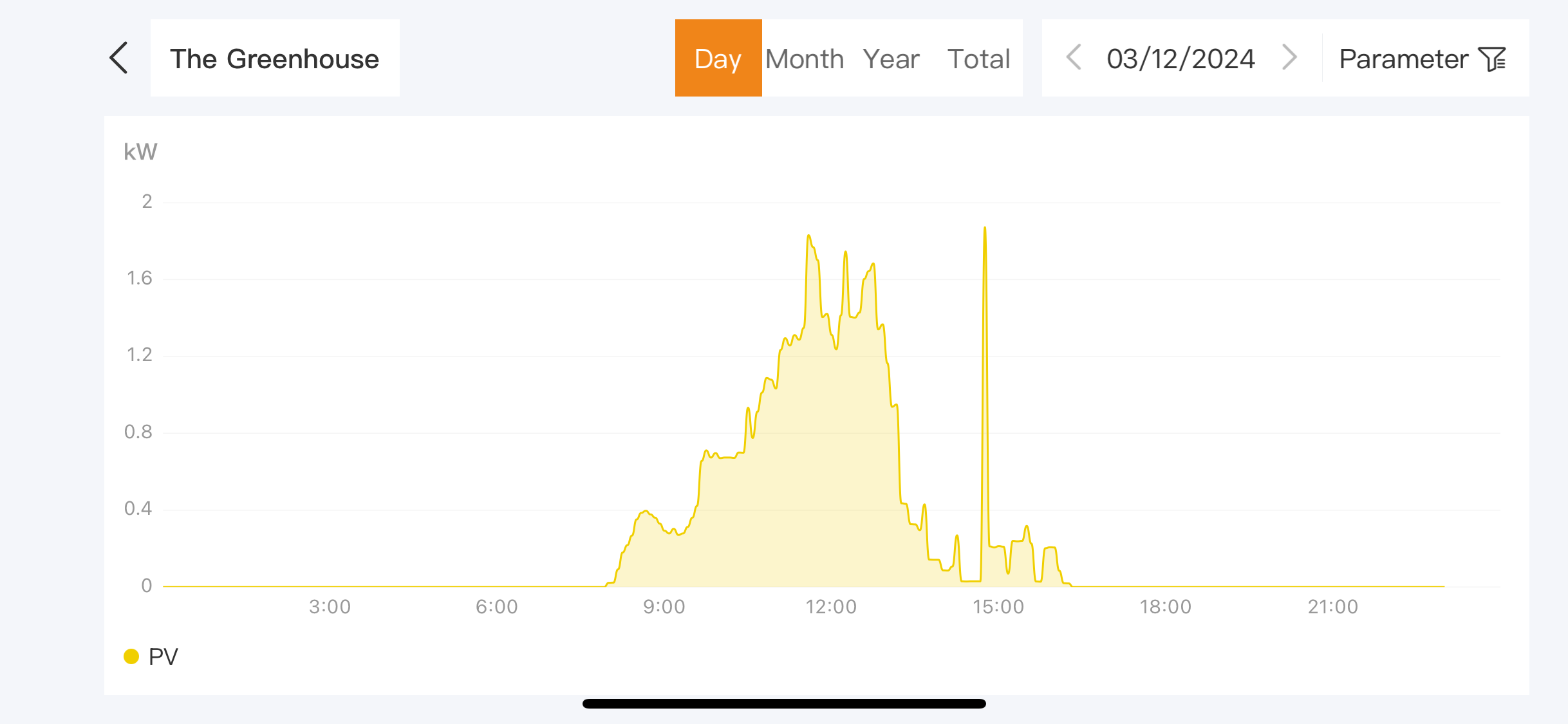

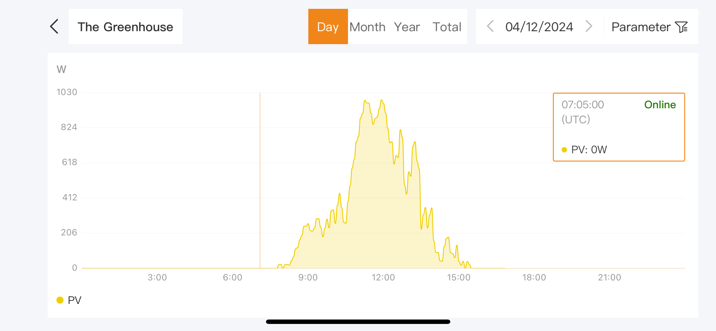

Omnibuswoman Posted December 4, 2024 Share Posted December 4, 2024 I’ve become very keen on monitoring the inverter function on our pv array and battery system (and monitoring our use/ToU shifting). Yesterday was a gloriously sunny day - not a cloud to be seen, so I was interested to see how the panels perform in the optimal conditions in the shortest month. We are on latitude 50°30’N and 4°W. The East facing array (3kw) performed well, but as the sun moved round to the West where we have a 5kw array, output plummeted to 200w. At 14:30 I went to the other side of the village have a look at the array from behind, and there was nothing shading it. It appeared to be in full sun and yet not performing. The only thing I could think of was that the angle of the low sun was insufficient to generate power, but that would also have been true of the East panels in the morning. There was a single spike of generation at 14:45, just after I got home from looking at the panels from a distance. Then production fell again. The house is oriented roughly 64°E / 262°W. Below is an image of the generation graph. Any ideas as to what might be impeding their function? Link to comment Share on other sites More sharing options...
SteamyTea Posted December 4, 2024 Share Posted December 4, 2024 Compound angles. This is what happened yesterday at your location time azimuth altitude 0:00 357.180818755071 -61.6108354278184 0:05 359.61668661041 -61.6330550884409 0:10 2.05329956310104 -61.6214672324821 0:15 4.48592702567635 -61.5761152767721 0:20 6.90989644479006 -61.4971684757178 0:25 9.32066014151002 -61.3849189414315 0:30 11.7138577589677 -61.2397765763194 0:35 14.0853722793371 -61.0622621226386 0:40 16.4313779756364 -60.8529986006766 0:45 18.7483791465371 -60.6127014557525 0:50 21.0332389994977 -60.342167762126 0:55 23.2831985552697 -60.0422648390694 1:00 25.495885907197 -59.7139186225241 1:05 27.6693165532395 -59.3581021080349 1:10 29.8018858100251 -58.9758241409685 1:15 31.8923545103306 -58.5681187826839 1:20 33.9398292818487 -58.1360354304566 1:25 35.94373871688 -57.6806298182058 1:30 37.9038066853825 -57.2029559773628 1:35 39.8200239353545 -56.7040591946078 1:40 41.6926189824423 -56.1849699670021 1:45 43.5220291309378 -55.6466989257839 1:50 45.308872304231 -55.0902326777719 1:55 47.0539202045494 -54.5165304974741 2:00 48.7580731766053 -53.9265217928929 2:05 50.4223370219787 -53.3211042627723 2:10 52.0478019027894 -52.7011426617282 2:15 53.635623384774 -52.0674680914223 2:20 55.187005600363 -51.4208777398832 2:25 56.7031864599669 -50.7621349965298 2:30 58.1854248022622 -50.0919698768166 2:35 59.6349893494405 -49.4110796972383 2:40 61.0531493188216 -48.7201299483318 2:45 62.4411665357812 -48.0197553200375 2:50 63.8002888926875 -47.3105608401486 2:55 65.1317450028177 -46.5931230924628 3:00 66.4367399056911 -45.867991486597 3:05 67.7164516897788 -45.1356895562076 3:10 68.9720289092751 -44.3967162665704 3:15 70.2045886828754 -43.6515473161487 3:20 71.4152153737944 -42.9006364199446 3:25 72.6049597612462 -42.1444165651302 3:30 73.7748386240254 -41.3833012317406 3:35 74.9258346665566 -40.6176855731229 3:40 76.058896726707 -39.8479475524235 3:45 77.1749402127651 -39.0744490327035 3:50 78.2748477242762 -38.2975368193275 3:55 79.3594698179197 -37.517543654131 4:00 80.4296258853489 -36.7347891615463 4:05 81.4861051149685 -35.9495807473951 4:10 82.5296675140235 -35.1622144514643 4:15 83.561044971205 -34.3729757552841 4:20 84.5809423432908 -33.5821403467458 4:25 85.5900385521842 -32.7899748433474 4:30 86.588987681156 -31.9967374759495 4:35 87.5784200611808 -31.2026787349724 4:40 88.5589433400231 -30.4080419809783 4:45 89.5311435282283 -29.6130640215702 4:50 90.4955860174333 -28.817975656499 4:55 91.4528165674682 -28.0230021928189 5:00 92.4033622595968 -27.2283639318669 5:05 93.3477324139805 -26.434276629764 5:10 94.286419470044 -25.6409519330578 5:15 95.2198998289151 -24.8485977910411 5:20 96.1486346575084 -24.0574188461914 5:25 97.0730706541406 -23.2676168040917 5:30 97.993640775814 -22.4793907841026 5:35 98.9107649275034 -21.6929376519706 5:40 99.8248506139273 -20.9084523354696 5:45 100.73629355439 -20.1261281240922 5:50 101.64547826136 -19.3461569537244 5:55 102.552778583499 -18.5687296771578 6:00 103.458558213871 -17.7940363212191 6:05 104.363171164086 -17.0222663312207 6:10 105.266962205109 -16.2536088033655 6:15 106.170267275454 -15.4882527056705 6:20 107.073413857459 -14.726387087905 6:25 107.976721322289 -13.9682012809766 6:30 108.880501244293 -13.2138850861334 6:35 109.785057685285 -12.4636289542916 6:40 110.690687449274 -11.717624155737 6:45 111.597680308149 -10.9760629403927 6:50 112.506319198727 -10.2391386887883 6:55 113.416880391601 -9.50704605381167 7:00 114.329633632126 -8.77998109327118 7:05 115.244842253868 -8.05814139324533 7:10 116.162763264834 -7.34172618214314 7:15 117.08364740672 -6.63093643535398 7:20 118.007739187461 -5.92597497031293 7:25 118.935276887295 -5.22704653176432 7:30 119.866492538595 -4.53435786695991 7:35 120.801611879688 -3.84811779048492 7:40 121.740854282937 -3.16853723836259 7:45 122.684432657335 -2.49582931105095 7:50 123.632553325938 -1.83020930490486 7:55 124.585415878486 -1.17189473164429 8:00 125.543212999612 -0.521105325337236 8:05 126.506130273135 0.121936963622813 8:10 127.474345962988 0.757007988089898 8:15 128.448030771445 1.38388143785222 8:20 129.427347575416 2.0023288880143 8:25 130.412451141695 2.61211986266417 8:30 131.403487822206 3.21302191441938 8:35 132.400595230419 3.80480072044451 8:40 133.403901900292 4.3872201955223 8:45 134.413526929265 4.96004262274187 8:50 135.429579607035 5.52302880234328 8:55 136.45215903203 6.07593821922117 9:00 137.481353717724 6.61852922954444 9:05 138.517241191161 7.1505592668941 9:10 139.559887586263 7.67178506825513 9:15 140.609347234763 8.18196292011805 9:20 141.665662257801 8.6808489248586 9:25 142.728862161468 9.16819928746058 9:30 143.798963439826 9.6437706225328 9:35 144.875969189087 10.1073202814459 9:40 145.959868736916 10.5586066992771 9:45 147.050637290908 10.9973897611005 9:50 148.148235610528 11.4234311870029 9:55 149.252609706869 11.8364949350354 10:00 150.363690574692 12.2363476211318 10:05 151.48139396126 12.6227589548436 10:10 152.605620176481 12.9955021895487 10:15 153.736253948821 13.3543545856013 10:20 154.873164331334 13.6990978846947 10:25 156.016204662027 14.0295187935194 10:30 157.165212582506 14.3454094746115 10:35 158.3200101186 14.6465680421073 10:40 159.48040382628 14.9327990599528 10:45 160.646185005772 15.2039140399614 10:50 161.817129986299 15.4597319369776 10:55 162.9930004833 15.7000796382885 11:00 164.173544029419 15.9247924443308 11:05 165.35849447986 16.1337145376769 11:10 166.547572592032 16.3266994372463 11:15 167.74048667866 16.5036104346818 11:20 168.936933332786 16.6643210098614 11:25 170.136598222309 16.8087152225757 11:30 171.339156950934 16.9366880775006 11:35 172.544275981637 17.0481458597302 11:40 173.751613618028 17.1430064383 11:45 174.960821038258 17.2211995353358 11:50 176.171543375508 17.2826669586986 11:55 177.383420838476 17.3273627962568 12:00 178.596089864787 17.3552535702109 12:05 179.809184299805 17.3663183502066 12:10 181.022336593025 17.3605488243033 12:15 182.235179003945 17.3379493272116 12:20 183.447344809243 17.2985368255629 12:25 184.658469503024 17.242340860337 12:30 185.868191982024 17.1694034469211 12:35 187.076155707835 17.0797789336286 12:40 188.282009838538 16.9735338198371 12:45 189.485410322504 16.8507465352269 12:50 190.686020947632 16.711507181897 12:55 191.883514339844 16.5559172414102 13:00 193.0775729053 16.3840892490622 13:05 194.267889711467 16.1961464378816 13:10 195.454169302918 15.992222355049 13:15 196.636128448504 15.7724604535667 13:20 197.813496817284 15.5370136621217 13:25 198.986017581401 15.2860439361548 13:30 200.153447944855 15.0197217931925 13:35 201.315559597847 14.7382258354993 13:40 202.472139097098 14.4417422630827 13:45 203.622988173217 14.1304643800256 13:50 204.767923966792 13.8045920970376 13:55 205.906779195477 13.4643314330052 14:00 207.039402254806 13.1098940181934 14:05 208.165657255962 12.7414966015993 14:10 209.285424004054 12.359360564797 14:15 210.398597920803 11.9637114444344 14:20 211.505089915749 11.5547784653613 14:25 212.604826210322 11.1327940861749 14:30 213.69774811918 10.6979935587788 14:35 214.783811793337 10.2506145033552 14:40 215.862987929596 9.7908964999641 14:45 216.935261450756 9.31908069779135 14:50 218.000631161012 8.83540944289358 14:55 219.059109380835 8.34012592511047 15:00 220.110721565481 7.83347384465685 15:05 221.155505911106 7.31569709875142 15:10 222.193512952276 6.78703948849885 15:15 223.224805154444 6.24774444611304 15:20 224.249456504743 5.69805478244993 15:25 225.267552104237 5.13821245471335 15:30 226.279187764515 4.56845835410464 15:35 227.284469611286 3.98903211310341 15:40 228.283513697419 3.40017193199738 15:45 229.276445627632 2.80211442422084 15:50 230.263400196813 2.19509448001129 15:55 231.244521043779 1.57934514785623 16:00 232.219960322033 0.955097533173538 16:05 233.18987838896 0.322580713647316 16:10 234.154443514658 -0.317978329370379 16:15 235.113831611513 -0.966354763985493 16:20 236.068225985438 -1.62232594600854 16:25 237.017817109583 -2.28567144290572 16:30 237.962802421216 -2.95617304402396 16:35 238.903386142349 -3.63361475764192 16:40 239.839779124638 -4.31778279537509 16:45 240.772198718963 -5.00846554443504 16:50 241.700868670081 -5.70545352821386 16:55 242.62601903665 -6.40853935563017 17:00 243.547886136931 -7.11751765963603 17:05 244.466712520407 -7.83218502524653 17:10 245.382746965574 -8.55233990741225 17:15 246.296244504128 -9.27778253901111 17:20 247.207466471795 -10.0083148291931 17:25 248.116680586039 -10.7437402522644 17:30 249.02416105092 -11.4838637272495 17:35 249.93018868939 -12.2284914882218 17:40 250.83505110333 -12.9774309454437 17:45 251.739042861692 -13.7304905373021 17:50 252.642465717129 -14.4874795729787 17:55 253.545628851536 -15.2482080657336 18:00 254.448849150982 -16.01248655663 18:05 255.352451510545 -16.7801259284686 18:10 256.256769169615 -17.5509372096422 18:15 257.162144078253 -18.3247313675601 18:20 258.06892729528 -19.1013190912311 18:25 258.977479418747 -19.8805105625276 18:30 259.888171049512 -20.6621152155894 18:35 260.801383288658 -21.4459414837547 18:40 261.717508269482 -22.2317965333385 18:45 262.636949724818 -23.0194859835016 18:50 263.560123590393 -23.8088136113793 18:55 264.487458644919 -24.5995810415637 19:00 265.419397187513 -25.3915874189464 19:05 266.356395752994 -26.1846290638528 19:10 267.298925865407 -26.9784991083091 19:15 268.247474830009 -27.7729871121994 19:20 269.202546563671 -28.5678786579815 19:25 270.164662463384 -29.362954922543 19:30 271.13436231217 -30.15799222469 19:35 272.112205221242 -30.9527615466762 19:40 273.098770606705 -31.7470280280995 19:45 274.094659198382 -32.5405504304111 19:50 275.100494077543 -33.3330805702202 19:55 276.116921739286 -34.1243627195136 20:00 277.14461317417 -34.9141329708717 20:05 278.184264962228 -35.7021185657367 20:10 279.236600370858 -36.4880371837955 20:15 280.302370446084 -37.2715961915743 20:20 281.382355084353 -38.0524918484224 20:25 282.477364069342 -38.8304084681935 20:30 283.588238055056 -39.6050175351272 20:35 284.715849472879 -40.3759767727113 20:40 285.861103335981 -41.1429291646741 20:45 287.024937909684 -41.9055019277451 20:50 288.208325210831 -42.6633054364524 20:55 289.412271293005 -43.415932101017 21:00 290.637816267351 -44.1629552003983 21:05 291.886034000961 -44.9039276737705 21:10 293.158031426066 -45.6383808752006 21:15 294.454947383828 -46.3658232981086 21:20 295.777950916296 -47.0857392782499 21:25 297.128238909255 -47.7975876865295 21:30 298.507032977494 -48.5008006259673 21:35 299.915575472678 -49.1947821506516 21:40 301.355124483066 -49.8789070285494 21:45 302.826947684334 -50.55251957465 21:50 304.332314892532 -51.2149325860842 21:55 305.872489164803 -51.8654264165842 22:00 307.448716292133 -52.5032482338729 22:05 309.062212532751 -53.1276115102012 22:10 310.714150446538 -53.7376958031208 22:15 312.405642712189 -54.3326468904551 22:20 314.137723842068 -54.9115773299878 22:25 315.911329757114 -55.4735675201825 22:30 317.72727524808 -56.0176673427334 22:35 319.586229431727 -56.5428984702558 22:40 321.488689412581 -57.048257422158 22:45 323.43495248267 -57.5327194478353 22:50 325.425087331716 -57.9952433078469 22:55 327.45890489506 -58.4347770097858 23:00 329.535929629771 -58.8502645353253 23:05 331.655372171812 -59.2406535678817 23:10 333.816104476371 -59.6049041962791 23:15 336.016638664339 -59.9419985291124 23:20 338.255110873199 -60.2509511082073 23:25 340.529271422352 -60.5308199595081 23:30 342.836482534519 -60.7807180685312 23:35 345.173724693684 -60.9998250186445 23:40 347.537612459687 -61.1873984878775 23:45 349.924420203078 -61.3427852680218 23:50 352.330117784761 -61.4654314525662 23:55 354.75041570843 -61.5548914409391 Link to comment Share on other sites More sharing options...
Bramco Posted December 4, 2024 Share Posted December 4, 2024 (edited) At a guess, the spike is maybe what it should be generating and there's a fault somewhere in the wiring which means it only comes through sometimes? I'm assuming the 2 arrays are on separate strings into the inverter? If so, you could try switching the arrays on the inverter - be careful to isolate the DC before you do. This would tell you if there is a fault in the inverter (which would seem unlikely) or in the wiring to the array. Did you do the wiring yourself? If so, it's worth checking each connector to make sure that the connectors are properly clicked into the outside housing. If they aren't, then making a joint can push the connector bit out of the housing causing a fault. EDIT - of course, the spike will be when you came back and slammed the front door in frustration - causing a tremor to run through the house and make the faulty connection work for a bit. Edited December 4, 2024 by Bramco Link to comment Share on other sites More sharing options...

Russdl Posted December 4, 2024 Share Posted December 4, 2024 (edited) @Omnibuswoman you’re orientation isn’t quite right unless your roof is a funny shape? Either way I guess your east facing array is slightly north of east and your west facing array is slightly south of west. That string of figures that Steamy posted show that at 10:00 the sun was circa 70-80 degrees off the east panels and 12.2 degrees above the horizon. At 14:00 the sun was circa 50-60 degrees off the west panels and 12.7 degrees above the horizon. Some 2 hours either side of midday the sun was close to the west panels and slightly higher so if the arrays are equal the west should have produced more at those times. As your west facing array is larger they should definitely have produced slightly more. Houston - I think you have a problem. Edited December 4, 2024 by Russdl A bit of clarification. 1 Link to comment Share on other sites More sharing options...
mike2016 Posted December 4, 2024 Share Posted December 4, 2024 Is it a single inverter with two strings? Inverters need a minimum voltage to generate power. Are they the same make and model of PV Panels? It feels like the West facing didn't hit the required voltage to generate much. If you can see the raw voltage data for each string it would tell you when they each start producing electricity. At what time of the year does this get really noticeable? Link to comment Share on other sites More sharing options...
Omnibuswoman Posted December 4, 2024 Author Share Posted December 4, 2024 2 hours ago, mike2016 said: If you can see the raw voltage data for each string it would tell you when they each start producing electricity. At what time of the year does this get really noticeable? yes it is one inverter and two strings. It’s a simple pitched roof of around 30° pitch - broadly E/W. The East has around 3kw and the West around 5kw array. I’ve only just had the software to monitor the inverter installed so am not sure what the performance was exactly previously, however according to our feed in graph on our electricity provider app the PM has always produced more. @Russdl is correct about the orientation being slightly to the north of East and to the south of West. Based on the above I will look back at the data I’ve got for the last few weeks since the Solis app started working and will compare this to the previous feed in data that I have. Link to comment Share on other sites More sharing options...

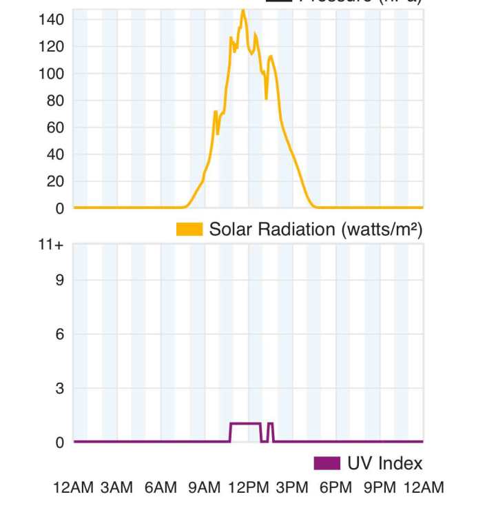

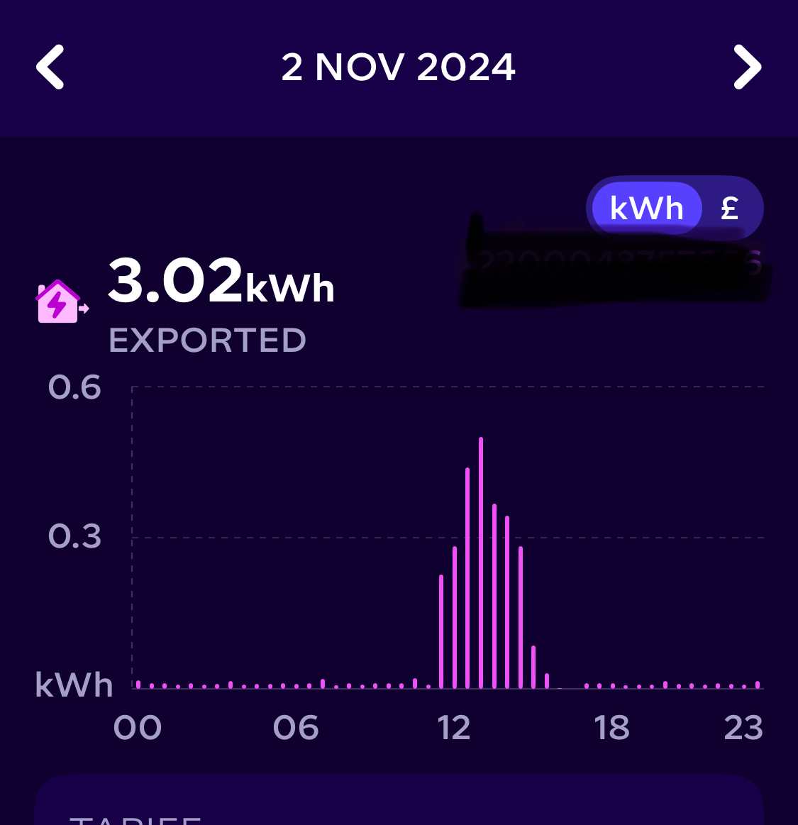

Omnibuswoman Posted December 4, 2024 Author Share Posted December 4, 2024 this is a fairly typical graph from the export tab in the energy provider app - I wasn’t here on this day so I’ve not been drawing on the pv power at all. Not sure what the weather was that day, but looks like it was at least sunny from late morning onwards. Link to comment Share on other sites More sharing options...
SteamyTea Posted December 4, 2024 Share Posted December 4, 2024 1 hour ago, Omnibuswoman said: Not sure what the weather was that day Last 3 days in Tavistock, which I think is near you. December 1, 2024 Time Temperature Dew Point Humidity Wind Speed Gust Pressure Precip. Rate. Precip. Accum. UV Solar 12:04 AM 12.7 °C 12.6 °C 99 % SW 4.5 km/h 9.1 km/h 998.82 hPa 0.00 mm 0.00 mm 0 0 w/m² 12:09 AM 12.8 °C 12.7 °C 99 % SSW 7.9 km/h 14.6 km/h 998.71 hPa 0.00 mm 0.00 mm 0 0 w/m² 12:14 AM 12.8 °C 12.7 °C 99 % SSW 8.2 km/h 18.7 km/h 998.71 hPa 0.00 mm 0.00 mm 0 0 w/m² 12:19 AM 12.8 °C 12.7 °C 99 % SSW 5.3 km/h 12.1 km/h 998.61 hPa 0.00 mm 0.00 mm 0 0 w/m² 12:24 AM 12.8 °C 12.7 °C 99 % SSW 6.4 km/h 14.2 km/h 998.61 hPa 0.00 mm 0.00 mm 0 0 w/m² 12:29 AM 12.8 °C 12.7 °C 99 % SSW 6.5 km/h 13.4 km/h 998.41 hPa 0.00 mm 0.00 mm 0 0 w/m² 12:34 AM 12.8 °C 12.7 °C 99 % SSW 8.1 km/h 15.8 km/h 998.41 hPa 0.00 mm 0.00 mm 0 0 w/m² 12:39 AM 12.8 °C 12.7 °C 99 % South 6.7 km/h 15.2 km/h 998.10 hPa 0.61 mm 0.10 mm 0 0 w/m² 12:44 AM 12.8 °C 12.7 °C 99 % SSW 5.5 km/h 12.1 km/h 998.10 hPa 0.61 mm 0.10 mm 0 0 w/m² 12:49 AM 12.8 °C 12.7 °C 99 % SW 7.3 km/h 15.4 km/h 998.10 hPa 0.61 mm 0.10 mm 0 0 w/m² 12:54 AM 12.9 °C 12.8 °C 99 % South 8.5 km/h 19.3 km/h 997.90 hPa 0.00 mm 0.10 mm 0 0 w/m² 12:59 AM 13.0 °C 12.9 °C 99 % SSW 8.5 km/h 16.1 km/h 997.90 hPa 0.00 mm 0.10 mm 0 0 w/m² 1:04 AM 13.0 °C 12.9 °C 99 % SSW 7.6 km/h 15.4 km/h 997.90 hPa 0.00 mm 0.10 mm 0 0 w/m² 1:09 AM 13.0 °C 12.9 °C 99 % SSW 9.6 km/h 16.2 km/h 997.90 hPa 0.00 mm 0.10 mm 0 0 w/m² 1:14 AM 12.9 °C 12.8 °C 99 % SSW 7.7 km/h 20.8 km/h 997.90 hPa 0.00 mm 0.10 mm 0 0 w/m² 1:19 AM 12.9 °C 12.8 °C 99 % SSW 8.5 km/h 21.2 km/h 997.80 hPa 0.00 mm 0.10 mm 0 0 w/m² 1:24 AM 12.9 °C 12.8 °C 99 % SSW 6.8 km/h 19.2 km/h 997.90 hPa 0.00 mm 0.10 mm 0 0 w/m² 1:29 AM 12.8 °C 12.7 °C 99 % South 6.1 km/h 15.9 km/h 997.70 hPa 0.00 mm 0.10 mm 0 0 w/m² 1:34 AM 12.9 °C 12.8 °C 99 % SSW 6.0 km/h 15.8 km/h 997.60 hPa 0.00 mm 0.10 mm 0 0 w/m² 1:39 AM 12.8 °C 12.7 °C 99 % South 4.7 km/h 14.9 km/h 997.39 hPa 0.00 mm 0.10 mm 0 0 w/m² 1:44 AM 12.8 °C 12.7 °C 99 % SW 7.9 km/h 13.0 km/h 997.49 hPa 0.00 mm 0.10 mm 0 0 w/m² 1:49 AM 12.8 °C 12.7 °C 99 % SSW 7.7 km/h 16.2 km/h 997.49 hPa 0.00 mm 0.10 mm 0 0 w/m² 1:54 AM 12.9 °C 12.8 °C 99 % SSW 8.5 km/h 18.5 km/h 997.09 hPa 0.00 mm 0.10 mm 0 0 w/m² 1:59 AM 12.9 °C 12.8 °C 99 % SSW 5.3 km/h 12.0 km/h 997.19 hPa 0.00 mm 0.10 mm 0 0 w/m² 2:04 AM 12.8 °C 12.7 °C 99 % SW 7.1 km/h 14.8 km/h 997.09 hPa 0.00 mm 0.10 mm 0 0 w/m² 2:09 AM 12.8 °C 12.7 °C 99 % SW 6.2 km/h 14.7 km/h 997.19 hPa 0.00 mm 0.10 mm 0 0 w/m² 2:14 AM 12.8 °C 12.7 °C 99 % South 5.2 km/h 11.6 km/h 996.99 hPa 0.00 mm 0.10 mm 0 0 w/m² 2:19 AM 12.9 °C 12.8 °C 99 % SSW 7.2 km/h 15.2 km/h 996.99 hPa 0.00 mm 0.10 mm 0 0 w/m² 2:24 AM 12.9 °C 12.8 °C 99 % South 6.2 km/h 13.8 km/h 997.19 hPa 0.00 mm 0.10 mm 0 0 w/m² 2:29 AM 12.9 °C 12.8 °C 99 % SSW 6.4 km/h 14.9 km/h 996.99 hPa 0.00 mm 0.10 mm 0 0 w/m² 2:34 AM 12.8 °C 12.7 °C 99 % South 7.1 km/h 15.5 km/h 997.19 hPa 0.00 mm 0.10 mm 0 0 w/m² 2:39 AM 12.8 °C 12.7 °C 99 % ESE 5.7 km/h 14.5 km/h 996.82 hPa 0.00 mm 0.10 mm 0 0 w/m² 2:44 AM 12.8 °C 12.7 °C 99 % South 7.7 km/h 14.7 km/h 996.72 hPa 1.19 mm 0.30 mm 0 0 w/m² 2:49 AM 12.8 °C 12.7 °C 99 % SE 7.8 km/h 20.3 km/h 996.61 hPa 1.19 mm 0.30 mm 0 0 w/m² 2:54 AM 12.8 °C 12.7 °C 99 % SSW 8.4 km/h 16.5 km/h 996.72 hPa 1.19 mm 0.30 mm 0 0 w/m² 2:59 AM 12.8 °C 12.7 °C 99 % South 4.9 km/h 15.5 km/h 996.51 hPa 0.00 mm 0.30 mm 0 0 w/m² 3:04 AM 12.8 °C 12.7 °C 99 % South 6.8 km/h 13.4 km/h 996.51 hPa 0.61 mm 0.41 mm 0 0 w/m² 3:09 AM 12.8 °C 12.7 °C 99 % SSW 6.5 km/h 15.2 km/h 996.31 hPa 0.61 mm 0.41 mm 0 0 w/m² 3:14 AM 12.8 °C 12.7 °C 99 % South 6.9 km/h 13.4 km/h 996.41 hPa 0.61 mm 0.41 mm 0 0 w/m² 3:19 AM 12.8 °C 12.7 °C 99 % SSW 5.1 km/h 13.3 km/h 996.11 hPa 0.00 mm 0.41 mm 0 0 w/m² 3:24 AM 12.9 °C 12.8 °C 99 % SSW 7.5 km/h 15.5 km/h 996.00 hPa 0.00 mm 0.41 mm 0 0 w/m² 3:29 AM 12.9 °C 12.8 °C 99 % SSW 7.4 km/h 15.2 km/h 996.11 hPa 0.00 mm 0.41 mm 0 0 w/m² 3:34 AM 13.0 °C 12.9 °C 99 % SSW 8.3 km/h 20.5 km/h 996.00 hPa 0.00 mm 0.41 mm 0 0 w/m² 3:39 AM 13.0 °C 12.9 °C 99 % South 6.6 km/h 16.4 km/h 995.90 hPa 0.00 mm 0.41 mm 0 0 w/m² 3:44 AM 12.9 °C 12.8 °C 99 % SSW 6.7 km/h 12.7 km/h 995.70 hPa 0.00 mm 0.41 mm 0 0 w/m² 3:49 AM 13.0 °C 12.9 °C 99 % South 7.3 km/h 13.8 km/h 995.80 hPa 0.00 mm 0.41 mm 0 0 w/m² 3:54 AM 13.0 °C 12.9 °C 99 % SSW 8.0 km/h 22.0 km/h 995.70 hPa 0.00 mm 0.41 mm 0 0 w/m² 3:59 AM 13.0 °C 12.9 °C 99 % SSW 6.8 km/h 12.2 km/h 995.60 hPa 0.00 mm 0.41 mm 0 0 w/m² 4:04 AM 13.1 °C 13.0 °C 99 % South 5.8 km/h 13.0 km/h 995.60 hPa 0.00 mm 0.41 mm 0 0 w/m² 4:09 AM 13.1 °C 13.0 °C 99 % SW 8.1 km/h 12.8 km/h 995.60 hPa 0.00 mm 0.41 mm 0 0 w/m² 4:14 AM 13.2 °C 13.1 °C 99 % South 7.6 km/h 14.9 km/h 995.50 hPa 0.00 mm 0.41 mm 0 0 w/m² 4:19 AM 13.2 °C 13.1 °C 99 % South 6.6 km/h 13.9 km/h 995.40 hPa 0.00 mm 0.41 mm 0 0 w/m² 4:24 AM 13.2 °C 13.1 °C 99 % South 5.5 km/h 12.2 km/h 995.40 hPa 0.61 mm 0.51 mm 0 0 w/m² 4:29 AM 13.2 °C 13.1 °C 99 % SSW 4.9 km/h 11.1 km/h 995.19 hPa 1.19 mm 0.61 mm 0 0 w/m² 4:34 AM 13.2 °C 13.1 °C 99 % South 7.6 km/h 15.7 km/h 995.09 hPa 1.19 mm 0.61 mm 0 0 w/m² 4:39 AM 13.3 °C 13.2 °C 99 % SSW 6.8 km/h 12.9 km/h 995.09 hPa 0.00 mm 0.61 mm 0 0 w/m² 4:44 AM 13.3 °C 13.2 °C 99 % SSW 7.1 km/h 14.0 km/h 995.09 hPa 0.00 mm 0.61 mm 0 0 w/m² 4:49 AM 13.3 °C 13.2 °C 99 % SSW 7.8 km/h 15.2 km/h 994.99 hPa 0.00 mm 0.61 mm 0 0 w/m² 4:54 AM 13.4 °C 13.3 °C 99 % SSW 9.1 km/h 21.8 km/h 995.09 hPa 0.00 mm 0.61 mm 0 0 w/m² 4:59 AM 13.4 °C 13.3 °C 99 % SSW 6.4 km/h 15.6 km/h 994.99 hPa 0.61 mm 0.71 mm 0 0 w/m² 5:04 AM 13.4 °C 13.3 °C 99 % SSW 8.4 km/h 18.9 km/h 994.99 hPa 1.19 mm 0.79 mm 0 0 w/m² 5:09 AM 13.4 °C 13.3 °C 99 % SSW 7.9 km/h 15.0 km/h 994.99 hPa 1.19 mm 0.79 mm 0 0 w/m² 5:14 AM 13.4 °C 13.3 °C 99 % SSW 7.6 km/h 14.8 km/h 994.79 hPa 0.61 mm 0.89 mm 0 0 w/m² 5:19 AM 13.4 °C 13.3 °C 99 % SSW 6.4 km/h 13.0 km/h 994.68 hPa 0.61 mm 0.89 mm 0 0 w/m² 5:24 AM 13.4 °C 13.3 °C 99 % SW 6.7 km/h 12.4 km/h 994.68 hPa 0.61 mm 0.89 mm 0 0 w/m² 5:29 AM 13.4 °C 13.3 °C 99 % SW 7.3 km/h 16.0 km/h 994.79 hPa 0.00 mm 0.89 mm 0 0 w/m² 5:34 AM 13.4 °C 13.3 °C 99 % SSW 7.9 km/h 13.9 km/h 994.79 hPa 0.00 mm 0.89 mm 0 0 w/m² 5:39 AM 13.4 °C 13.3 °C 99 % SW 6.7 km/h 14.1 km/h 994.68 hPa 0.00 mm 0.89 mm 0 0 w/m² 5:44 AM 13.5 °C 13.4 °C 99 % SSW 9.5 km/h 18.3 km/h 994.68 hPa 0.00 mm 0.89 mm 0 0 w/m² 5:49 AM 13.5 °C 13.4 °C 99 % SW 9.0 km/h 18.2 km/h 994.79 hPa 0.00 mm 0.89 mm 0 0 w/m² 5:54 AM 13.5 °C 13.4 °C 99 % SW 12.2 km/h 21.4 km/h 994.79 hPa 0.00 mm 0.89 mm 0 0 w/m² 5:59 AM 13.5 °C 13.4 °C 99 % SW 10.1 km/h 18.8 km/h 994.79 hPa 0.00 mm 0.89 mm 0 0 w/m² 6:04 AM 13.5 °C 13.4 °C 99 % SW 9.5 km/h 18.9 km/h 995.09 hPa 0.00 mm 0.89 mm 0 0 w/m² 6:09 AM 13.5 °C 13.4 °C 99 % SW 8.1 km/h 16.9 km/h 994.99 hPa 0.61 mm 0.99 mm 0 0 w/m² 6:14 AM 13.4 °C 13.3 °C 99 % SW 10.1 km/h 20.0 km/h 995.09 hPa 0.61 mm 0.99 mm 0 0 w/m² 6:19 AM 13.4 °C 13.3 °C 99 % SW 7.3 km/h 12.6 km/h 994.99 hPa 0.61 mm 0.99 mm 0 0 w/m² 6:24 AM 13.4 °C 13.3 °C 99 % SW 7.4 km/h 14.4 km/h 995.09 hPa 0.00 mm 0.99 mm 0 0 w/m² 6:29 AM 13.4 °C 13.3 °C 99 % SW 6.8 km/h 13.5 km/h 995.19 hPa 0.00 mm 0.99 mm 0 0 w/m² 6:34 AM 13.3 °C 13.2 °C 99 % SW 6.3 km/h 12.2 km/h 995.29 hPa 0.00 mm 0.99 mm 0 0 w/m² 6:39 AM 13.3 °C 13.2 °C 99 % SSW 5.2 km/h 10.0 km/h 995.19 hPa 0.00 mm 0.99 mm 0 0 w/m² 6:44 AM 13.3 °C 13.2 °C 99 % SW 5.5 km/h 9.6 km/h 995.29 hPa 0.00 mm 0.99 mm 0 0 w/m² 6:49 AM 13.3 °C 13.2 °C 99 % SW 5.5 km/h 9.9 km/h 995.19 hPa 0.00 mm 0.99 mm 0 0 w/m² 6:54 AM 13.2 °C 13.1 °C 99 % SSW 6.4 km/h 11.6 km/h 995.29 hPa 0.00 mm 0.99 mm 0 0 w/m² 6:59 AM 13.2 °C 13.1 °C 99 % SW 5.1 km/h 10.5 km/h 995.29 hPa 0.61 mm 1.09 mm 0 0 w/m² 7:04 AM 13.2 °C 13.1 °C 99 % SSW 6.7 km/h 10.5 km/h 995.29 hPa 0.61 mm 1.09 mm 0 0 w/m² 7:09 AM 13.1 °C 13.0 °C 99 % SW 5.4 km/h 10.9 km/h 995.40 hPa 0.61 mm 1.09 mm 0 0 w/m² 7:14 AM 13.1 °C 13.0 °C 99 % SW 4.2 km/h 8.6 km/h 995.29 hPa 0.00 mm 1.09 mm 0 0 w/m² 7:19 AM 13.1 °C 13.0 °C 99 % SW 5.2 km/h 10.4 km/h 995.40 hPa 0.00 mm 1.09 mm 0 0 w/m² 7:24 AM 13.1 °C 13.0 °C 99 % SW 5.9 km/h 10.6 km/h 995.19 hPa 0.00 mm 1.09 mm 0 0 w/m² 7:29 AM 13.1 °C 13.0 °C 99 % SW 6.5 km/h 11.9 km/h 995.40 hPa 0.00 mm 1.09 mm 0 0 w/m² 7:34 AM 13.0 °C 12.9 °C 99 % SW 5.6 km/h 11.4 km/h 995.19 hPa 0.00 mm 1.09 mm 0 0.1 w/m² 7:39 AM 13.0 °C 12.9 °C 99 % SW 6.1 km/h 10.3 km/h 995.40 hPa 0.00 mm 1.09 mm 0 0.2 w/m² 7:44 AM 13.0 °C 12.9 °C 99 % SSW 3.8 km/h 7.7 km/h 995.40 hPa 0.00 mm 1.09 mm 0 0.4 w/m² 7:49 AM 13.0 °C 12.9 °C 99 % SW 2.8 km/h 6.3 km/h 995.40 hPa 0.00 mm 1.09 mm 0 0.7 w/m² 7:54 AM 12.9 °C 12.8 °C 99 % SW 3.8 km/h 7.4 km/h 995.50 hPa 0.00 mm 1.09 mm 0 1.2 w/m² 7:59 AM 12.9 °C 12.8 °C 99 % SW 2.6 km/h 5.5 km/h 995.40 hPa 0.00 mm 1.09 mm 0 2.5 w/m² 8:04 AM 12.9 °C 12.8 °C 99 % SSW 3.6 km/h 6.5 km/h 995.40 hPa 0.00 mm 1.09 mm 0 3.5 w/m² 8:09 AM 12.8 °C 12.7 °C 99 % SW 3.1 km/h 5.6 km/h 995.40 hPa 0.00 mm 1.09 mm 0 4 w/m² 8:14 AM 12.8 °C 12.7 °C 99 % SSW 2.6 km/h 6.2 km/h 995.50 hPa 0.00 mm 1.09 mm 0 7.4 w/m² 8:19 AM 12.8 °C 12.7 °C 99 % SW 3.0 km/h 5.9 km/h 995.50 hPa 0.00 mm 1.09 mm 0 7.5 w/m² 8:24 AM 12.8 °C 12.7 °C 99 % SW 3.6 km/h 7.3 km/h 995.70 hPa 0.00 mm 1.09 mm 0 7.8 w/m² 8:29 AM 12.7 °C 12.6 °C 99 % SW 2.6 km/h 5.6 km/h 995.50 hPa 0.00 mm 1.09 mm 0 10 w/m² 8:34 AM 12.7 °C 12.6 °C 99 % SSW 3.2 km/h 5.4 km/h 995.70 hPa 0.00 mm 1.09 mm 0 10.7 w/m² 8:39 AM 12.7 °C 12.6 °C 99 % SW 3.3 km/h 6.5 km/h 995.80 hPa 0.00 mm 1.09 mm 0 17.2 w/m² 8:44 AM 12.6 °C 12.5 °C 99 % SSW 4.7 km/h 9.9 km/h 995.70 hPa 0.00 mm 1.09 mm 0 18.9 w/m² 8:49 AM 12.6 °C 12.5 °C 99 % SW 3.7 km/h 6.3 km/h 995.70 hPa 0.00 mm 1.09 mm 0 22.7 w/m² 8:54 AM 12.6 °C 12.5 °C 99 % SSW 3.2 km/h 6.3 km/h 995.90 hPa 0.00 mm 1.09 mm 0 25.3 w/m² 8:59 AM 12.6 °C 12.4 °C 99 % SSW 3.9 km/h 7.2 km/h 995.90 hPa 0.00 mm 1.09 mm 0 27.5 w/m² 9:04 AM 12.6 °C 12.3 °C 98 % SSW 2.2 km/h 5.4 km/h 995.90 hPa 0.00 mm 1.09 mm 0 26.4 w/m² 9:09 AM 12.6 °C 12.5 °C 99 % SSW 2.6 km/h 5.3 km/h 995.90 hPa 0.00 mm 1.09 mm 0 30.9 w/m² 9:14 AM 12.6 °C 12.4 °C 98 % SSW 4.1 km/h 7.4 km/h 996.00 hPa 0.00 mm 1.09 mm 0 31.2 w/m² 9:19 AM 12.6 °C 12.3 °C 98 % SSW 4.3 km/h 7.7 km/h 996.00 hPa 0.00 mm 1.09 mm 0 34 w/m² 9:24 AM 12.6 °C 12.3 °C 98 % SSW 3.3 km/h 6.7 km/h 996.00 hPa 0.00 mm 1.09 mm 0 32.1 w/m² 9:29 AM 12.7 °C 12.4 °C 98 % SSW 3.9 km/h 7.8 km/h 996.00 hPa 0.00 mm 1.09 mm 0 22.9 w/m² 9:34 AM 12.6 °C 12.3 °C 98 % SSW 3.5 km/h 6.8 km/h 996.21 hPa 0.00 mm 1.09 mm 0 38.5 w/m² 9:39 AM 12.6 °C 12.3 °C 98 % South 3.2 km/h 6.8 km/h 996.00 hPa 0.00 mm 1.09 mm 0 56.4 w/m² 9:44 AM 12.6 °C 12.3 °C 97 % SW 4.1 km/h 7.0 km/h 996.21 hPa 0.00 mm 1.09 mm 0 55.5 w/m² 9:49 AM 12.6 °C 12.2 °C 97 % SSW 3.5 km/h 8.6 km/h 996.11 hPa 0.00 mm 1.09 mm 0 51.6 w/m² 9:54 AM 12.6 °C 12.0 °C 96 % SW 5.6 km/h 9.9 km/h 996.11 hPa 0.00 mm 1.09 mm 0 56.1 w/m² 9:59 AM 12.6 °C 11.8 °C 95 % SSW 6.0 km/h 10.6 km/h 996.31 hPa 0.00 mm 1.09 mm 0 57.6 w/m² 10:04 AM 12.7 °C 11.9 °C 95 % SW 1.9 km/h 6.5 km/h 996.21 hPa 0.00 mm 1.09 mm 0 68.8 w/m² 10:09 AM 12.6 °C 11.8 °C 95 % SW 3.6 km/h 5.8 km/h 996.11 hPa 0.00 mm 1.09 mm 0 82.8 w/m² 10:14 AM 12.7 °C 11.8 °C 94 % SSW 4.2 km/h 7.9 km/h 996.31 hPa 0.00 mm 1.09 mm 0 73 w/m² 10:19 AM 12.7 °C 11.9 °C 95 % SSW 3.8 km/h 6.8 km/h 996.21 hPa 0.00 mm 1.09 mm 1 120.9 w/m² 10:24 AM 12.8 °C 12.0 °C 95 % SW 5.1 km/h 8.7 km/h 996.31 hPa 0.00 mm 1.09 mm 0 103 w/m² 10:29 AM 12.8 °C 11.8 °C 94 % SW 5.4 km/h 11.7 km/h 996.31 hPa 0.00 mm 1.09 mm 0 80 w/m² 10:34 AM 12.8 °C 11.7 °C 93 % SSW 6.3 km/h 11.4 km/h 996.51 hPa 0.00 mm 1.09 mm 0 81.6 w/m² 10:39 AM 12.9 °C 11.7 °C 93 % SSW 4.4 km/h 9.5 km/h 996.41 hPa 0.00 mm 1.09 mm 0 82.6 w/m² 10:44 AM 12.9 °C 11.9 °C 93 % SW 3.8 km/h 7.3 km/h 996.41 hPa 0.00 mm 1.09 mm 0 62.9 w/m² 10:49 AM 12.8 °C 11.8 °C 93 % SSW 4.5 km/h 8.0 km/h 996.21 hPa 0.00 mm 1.09 mm 0 97.6 w/m² 10:54 AM 12.8 °C 11.9 °C 94 % SSW 1.7 km/h 6.2 km/h 996.21 hPa 0.00 mm 1.09 mm 1 113.7 w/m² 10:59 AM 12.9 °C 12.0 °C 94 % South 2.9 km/h 5.6 km/h 996.11 hPa 0.00 mm 1.09 mm 0 104.7 w/m² 11:04 AM 13.1 °C 12.2 °C 94 % South 4.9 km/h 8.2 km/h 996.21 hPa 0.00 mm 1.09 mm 0 59.5 w/m² 11:09 AM 12.9 °C 12.2 °C 95 % SSW 4.1 km/h 8.2 km/h 996.21 hPa 0.00 mm 1.09 mm 1 160.5 w/m² 11:14 AM 13.0 °C 12.4 °C 96 % SW 4.8 km/h 7.4 km/h 996.21 hPa 0.00 mm 1.09 mm 0 89.9 w/m² 11:19 AM 12.9 °C 12.3 °C 96 % SSW 5.9 km/h 10.6 km/h 996.21 hPa 0.00 mm 1.09 mm 0 44.4 w/m² 11:24 AM 12.9 °C 12.3 °C 96 % SW 4.9 km/h 8.1 km/h 996.11 hPa 0.00 mm 1.09 mm 0 61.6 w/m² 11:29 AM 12.9 °C 12.3 °C 96 % SW 5.7 km/h 12.0 km/h 996.00 hPa 0.00 mm 1.09 mm 0 106.6 w/m² 11:34 AM 12.9 °C 12.5 °C 97 % SSW 5.3 km/h 9.6 km/h 996.00 hPa 0.00 mm 1.09 mm 1 144.1 w/m² 11:39 AM 12.9 °C 12.5 °C 97 % SW 5.7 km/h 9.4 km/h 995.90 hPa 0.00 mm 1.09 mm 1 143 w/m² 11:44 AM 12.9 °C 12.5 °C 97 % SW 5.4 km/h 10.9 km/h 996.00 hPa 0.00 mm 1.09 mm 0 57.6 w/m² 11:49 AM 12.9 °C 12.5 °C 97 % SW 5.0 km/h 9.3 km/h 996.11 hPa 1.19 mm 1.30 mm 0 55.7 w/m² 11:54 AM 12.8 °C 12.4 °C 98 % SSW 5.2 km/h 10.4 km/h 996.00 hPa 1.19 mm 1.30 mm 2 238.3 w/m² 11:59 AM 12.9 °C 12.6 °C 98 % SSW 8.2 km/h 14.2 km/h 995.90 hPa 1.19 mm 1.30 mm 2 282.3 w/m² 12:04 PM 13.2 °C 12.9 °C 98 % SSW 8.0 km/h 15.2 km/h 996.00 hPa 0.00 mm 1.30 mm 1 136.3 w/m² 12:09 PM 13.1 °C 12.7 °C 97 % SW 9.4 km/h 18.1 km/h 995.90 hPa 0.00 mm 1.30 mm 0 101.6 w/m² 12:14 PM 13.0 °C 12.6 °C 97 % SW 7.6 km/h 13.7 km/h 995.80 hPa 0.00 mm 1.30 mm 0 83.7 w/m² 12:19 PM 13.0 °C 12.6 °C 97 % SSW 8.1 km/h 15.5 km/h 995.90 hPa 0.00 mm 1.30 mm 0 69.1 w/m² 12:24 PM 12.9 °C 12.5 °C 97 % SW 7.3 km/h 15.3 km/h 995.90 hPa 0.00 mm 1.30 mm 0 49 w/m² 12:29 PM 12.9 °C 12.5 °C 97 % SSW 6.7 km/h 13.4 km/h 995.90 hPa 0.00 mm 1.30 mm 0 45.4 w/m² 12:34 PM 12.9 °C 12.5 °C 97 % SSW 6.1 km/h 10.9 km/h 995.70 hPa 0.00 mm 1.30 mm 0 36.7 w/m² 12:39 PM 12.8 °C 12.4 °C 97 % SSW 6.2 km/h 11.1 km/h 995.70 hPa 0.00 mm 1.30 mm 0 39.5 w/m² 12:44 PM 12.8 °C 12.5 °C 98 % SW 7.5 km/h 14.1 km/h 995.70 hPa 3.00 mm 1.80 mm 0 33.2 w/m² 12:49 PM 12.6 °C 12.3 °C 98 % SW 8.9 km/h 14.7 km/h 995.50 hPa 3.00 mm 1.80 mm 0 78.9 w/m² 12:54 PM 12.7 °C 12.5 °C 99 % SW 8.2 km/h 16.8 km/h 995.60 hPa 0.61 mm 1.80 mm 0 84.4 w/m² 12:59 PM 12.7 °C 12.6 °C 99 % SW 11.4 km/h 21.7 km/h 995.50 hPa 0.00 mm 1.80 mm 0 28.5 w/m² 1:04 PM 12.8 °C 12.7 °C 99 % SW 9.3 km/h 18.5 km/h 995.50 hPa 1.19 mm 2.01 mm 0 34.1 w/m² 1:09 PM 12.7 °C 12.6 °C 99 % SW 7.1 km/h 16.6 km/h 995.50 hPa 1.19 mm 2.01 mm 0 47 w/m² 1:14 PM 12.8 °C 12.7 °C 99 % SW 8.4 km/h 16.5 km/h 995.40 hPa 1.19 mm 2.01 mm 0 41.7 w/m² 1:19 PM 12.7 °C 12.6 °C 99 % SSW 6.5 km/h 13.2 km/h 995.50 hPa 0.00 mm 2.01 mm 0 78.8 w/m² 1:24 PM 12.7 °C 12.6 °C 99 % SSW 7.3 km/h 12.8 km/h 995.40 hPa 0.61 mm 2.11 mm 0 81.9 w/m² 1:29 PM 12.6 °C 12.5 °C 99 % SW 7.7 km/h 15.9 km/h 995.29 hPa 0.61 mm 2.11 mm 1 115.4 w/m² 1:34 PM 12.6 °C 12.5 °C 99 % SW 8.2 km/h 17.1 km/h 995.40 hPa 0.61 mm 2.11 mm 0 54.9 w/m² 1:39 PM 12.6 °C 12.5 °C 99 % SW 8.6 km/h 18.2 km/h 995.29 hPa 0.61 mm 2.21 mm 0 45.1 w/m² 1:44 PM 12.5 °C 12.4 °C 99 % SW 9.6 km/h 15.8 km/h 995.29 hPa 0.61 mm 2.21 mm 0 84.4 w/m² 1:49 PM 12.6 °C 12.5 °C 99 % SW 8.7 km/h 17.1 km/h 995.19 hPa 0.61 mm 2.21 mm 0 47.1 w/m² 1:54 PM 12.5 °C 12.4 °C 99 % SW 8.2 km/h 15.0 km/h 995.19 hPa 0.00 mm 2.21 mm 0 89.3 w/m² 1:59 PM 12.5 °C 12.4 °C 99 % SW 7.6 km/h 15.9 km/h 995.09 hPa 0.00 mm 2.21 mm 0 68.6 w/m² 2:04 PM 12.5 °C 12.4 °C 99 % SSW 9.9 km/h 18.2 km/h 994.99 hPa 0.00 mm 2.21 mm 0 60.7 w/m² 2:09 PM 12.5 °C 12.4 °C 99 % SW 10.4 km/h 18.5 km/h 995.09 hPa 0.00 mm 2.21 mm 0 73.2 w/m² 2:14 PM 12.5 °C 12.3 °C 99 % SW 8.6 km/h 16.5 km/h 994.99 hPa 0.00 mm 2.21 mm 0 75 w/m² 2:19 PM 12.4 °C 12.1 °C 98 % SW 7.7 km/h 15.7 km/h 995.09 hPa 0.00 mm 2.21 mm 0 57.5 w/m² 2:24 PM 12.5 °C 12.2 °C 98 % SSW 7.6 km/h 14.4 km/h 994.99 hPa 0.00 mm 2.21 mm 0 64.8 w/m² 2:29 PM 12.5 °C 12.2 °C 98 % SW 7.1 km/h 12.5 km/h 995.19 hPa 0.00 mm 2.21 mm 0 52.3 w/m² 2:34 PM 12.5 °C 12.3 °C 99 % SW 6.9 km/h 12.5 km/h 994.99 hPa 0.00 mm 2.21 mm 0 36.2 w/m² 2:39 PM 12.5 °C 12.4 °C 99 % SW 7.4 km/h 13.5 km/h 995.09 hPa 0.00 mm 2.21 mm 0 42.7 w/m² 2:44 PM 12.5 °C 12.4 °C 99 % SW 6.6 km/h 12.9 km/h 995.19 hPa 0.00 mm 2.21 mm 0 40.3 w/m² 2:49 PM 12.4 °C 12.3 °C 99 % SW 6.1 km/h 10.6 km/h 995.09 hPa 0.00 mm 2.21 mm 0 42.5 w/m² 2:54 PM 12.4 °C 12.3 °C 99 % SSW 6.1 km/h 9.3 km/h 994.99 hPa 0.61 mm 2.31 mm 0 44.7 w/m² 2:59 PM 12.4 °C 12.3 °C 99 % SW 6.4 km/h 10.0 km/h 995.09 hPa 0.61 mm 2.31 mm 0 35.4 w/m² 3:04 PM 12.4 °C 12.3 °C 99 % SSW 5.7 km/h 10.5 km/h 994.99 hPa 0.61 mm 2.31 mm 0 52.3 w/m² 3:09 PM 12.4 °C 12.3 °C 99 % SSW 6.2 km/h 13.5 km/h 995.09 hPa 0.00 mm 2.31 mm 0 27.4 w/m² 3:14 PM 12.4 °C 12.3 °C 99 % SW 5.0 km/h 9.6 km/h 995.19 hPa 0.00 mm 2.31 mm 0 40.3 w/m² 3:19 PM 12.4 °C 12.3 °C 99 % SW 6.3 km/h 11.3 km/h 995.29 hPa 0.00 mm 2.31 mm 0 28.3 w/m² 3:24 PM 12.4 °C 12.3 °C 99 % SW 6.3 km/h 12.6 km/h 995.50 hPa 0.00 mm 2.31 mm 0 23.6 w/m² 3:29 PM 12.3 °C 12.2 °C 99 % SW 5.2 km/h 10.7 km/h 995.29 hPa 0.00 mm 2.31 mm 0 19.2 w/m² 3:34 PM 12.3 °C 12.2 °C 99 % SSW 3.8 km/h 9.0 km/h 995.40 hPa 0.00 mm 2.31 mm 0 14.1 w/m² 3:39 PM 12.3 °C 12.2 °C 99 % SW 5.1 km/h 9.2 km/h 995.50 hPa 0.00 mm 2.31 mm 0 17.5 w/m² 3:44 PM 12.3 °C 12.2 °C 99 % SW 3.8 km/h 8.2 km/h 995.50 hPa 0.00 mm 2.31 mm 0 17.9 w/m² 3:49 PM 12.2 °C 11.9 °C 98 % SW 7.6 km/h 12.7 km/h 995.50 hPa 0.00 mm 2.31 mm 0 17.6 w/m² 3:54 PM 12.0 °C 11.6 °C 97 % SW 5.7 km/h 12.9 km/h 995.50 hPa 0.00 mm 2.31 mm 0 12.9 w/m² 3:59 PM 12.0 °C 11.6 °C 97 % SW 6.8 km/h 12.4 km/h 995.50 hPa 0.00 mm 2.31 mm 0 8.8 w/m² 4:04 PM 12.0 °C 11.4 °C 96 % SW 6.3 km/h 12.4 km/h 995.60 hPa 0.00 mm 2.31 mm 0 5.8 w/m² 4:09 PM 12.0 °C 11.4 °C 96 % WSW 4.6 km/h 9.5 km/h 995.60 hPa 0.00 mm 2.31 mm 0 5.5 w/m² 4:14 PM 11.9 °C 11.3 °C 96 % SW 4.3 km/h 9.3 km/h 995.60 hPa 0.00 mm 2.31 mm 0 4.4 w/m² 4:19 PM 11.9 °C 11.3 °C 96 % SW 4.3 km/h 9.3 km/h 995.50 hPa 0.00 mm 2.31 mm 0 2.1 w/m² 4:24 PM 11.9 °C 11.5 °C 97 % WSW 4.6 km/h 9.3 km/h 995.70 hPa 0.00 mm 2.31 mm 0 1.7 w/m² 4:29 PM 11.8 °C 11.4 °C 97 % SW 4.4 km/h 8.8 km/h 995.40 hPa 0.00 mm 2.31 mm 0 0.8 w/m² 4:34 PM 11.8 °C 11.5 °C 98 % SSW 5.3 km/h 9.4 km/h 995.70 hPa 0.00 mm 2.31 mm 0 0.2 w/m² 4:39 PM 11.7 °C 11.4 °C 98 % SW 3.8 km/h 8.0 km/h 995.60 hPa 0.00 mm 2.31 mm 0 0.2 w/m² 4:44 PM 11.7 °C 11.4 °C 98 % SSW 2.9 km/h 6.4 km/h 995.40 hPa 0.00 mm 2.31 mm 0 0.1 w/m² 4:49 PM 11.7 °C 11.4 °C 98 % SSW 3.7 km/h 6.7 km/h 995.70 hPa 0.00 mm 2.31 mm 0 0 w/m² 4:54 PM 11.7 °C 11.6 °C 99 % SSW 3.1 km/h 7.3 km/h 995.60 hPa 0.61 mm 2.39 mm 0 0 w/m² 4:59 PM 11.7 °C 11.6 °C 99 % SSW 3.9 km/h 8.0 km/h 995.70 hPa 1.19 mm 2.49 mm 0 0 w/m² 5:04 PM 11.7 °C 11.6 °C 99 % SW 3.7 km/h 7.4 km/h 995.70 hPa 1.19 mm 2.49 mm 0 0 w/m² 5:09 PM 11.7 °C 11.6 °C 99 % SW 3.2 km/h 7.6 km/h 995.70 hPa 0.00 mm 2.49 mm 0 0 w/m² 5:14 PM 11.7 °C 11.6 °C 99 % SW 3.6 km/h 7.6 km/h 995.70 hPa 0.00 mm 2.49 mm 0 0 w/m² 5:19 PM 11.7 °C 11.6 °C 99 % SW 5.9 km/h 8.4 km/h 995.60 hPa 0.00 mm 2.49 mm 0 0 w/m² 5:24 PM 11.6 °C 11.5 °C 99 % SW 6.2 km/h 11.7 km/h 995.90 hPa 0.00 mm 2.49 mm 0 0 w/m² 5:29 PM 11.5 °C 11.2 °C 98 % SW 6.4 km/h 13.0 km/h 995.80 hPa 0.00 mm 2.49 mm 0 0 w/m² 5:34 PM 11.5 °C 11.2 °C 98 % SW 6.4 km/h 9.7 km/h 995.70 hPa 0.00 mm 2.49 mm 0 0 w/m² 5:39 PM 11.5 °C 11.1 °C 97 % SW 3.9 km/h 9.1 km/h 995.80 hPa 0.00 mm 2.49 mm 0 0 w/m² 5:44 PM 11.4 °C 11.0 °C 97 % SW 2.9 km/h 5.7 km/h 995.80 hPa 0.00 mm 2.49 mm 0 0 w/m² 5:49 PM 11.3 °C 11.0 °C 98 % SSW 2.2 km/h 5.7 km/h 995.80 hPa 0.00 mm 2.49 mm 0 0 w/m² 5:54 PM 11.3 °C 11.0 °C 98 % WSW 2.7 km/h 5.7 km/h 995.90 hPa 0.00 mm 2.49 mm 0 0 w/m² 5:59 PM 11.3 °C 11.0 °C 98 % South 2.4 km/h 5.2 km/h 996.00 hPa 0.00 mm 2.49 mm 0 0 w/m² 6:04 PM 11.2 °C 10.9 °C 98 % SSW 2.6 km/h 5.5 km/h 996.11 hPa 0.00 mm 2.49 mm 0 0 w/m² 6:09 PM 11.3 °C 11.0 °C 98 % West 2.6 km/h 6.0 km/h 996.11 hPa 0.00 mm 2.49 mm 0 0 w/m² 6:14 PM 11.3 °C 11.2 °C 99 % SW 2.7 km/h 5.5 km/h 996.11 hPa 0.00 mm 2.49 mm 0 0 w/m² 6:19 PM 11.3 °C 11.2 °C 99 % SSW 3.6 km/h 6.9 km/h 996.31 hPa 0.00 mm 2.49 mm 0 0 w/m² 6:24 PM 11.2 °C 11.1 °C 99 % SW 2.7 km/h 5.8 km/h 996.00 hPa 0.00 mm 2.49 mm 0 0 w/m² 6:29 PM 11.0 °C 10.9 °C 99 % SSE 2.2 km/h 4.0 km/h 996.00 hPa 0.00 mm 2.49 mm 0 0 w/m² 6:34 PM 10.9 °C 10.8 °C 99 % SW 2.1 km/h 4.0 km/h 996.21 hPa 0.00 mm 2.49 mm 0 0 w/m² 6:39 PM 11.0 °C 10.9 °C 99 % SSW 2.9 km/h 6.1 km/h 996.31 hPa 0.00 mm 2.49 mm 0 0 w/m² 6:44 PM 11.0 °C 10.9 °C 99 % SSW 2.5 km/h 5.6 km/h 996.11 hPa 0.00 mm 2.49 mm 0 0 w/m² 6:49 PM 11.0 °C 10.9 °C 99 % WSW 2.1 km/h 4.1 km/h 996.21 hPa 0.00 mm 2.49 mm 0 0 w/m² 6:54 PM 11.0 °C 10.9 °C 99 % SW 2.5 km/h 4.4 km/h 996.31 hPa 0.00 mm 2.49 mm 0 0 w/m² 6:59 PM 11.0 °C 10.9 °C 99 % SSW 1.8 km/h 4.2 km/h 996.21 hPa 0.00 mm 2.49 mm 0 0 w/m² 7:04 PM 11.0 °C 10.9 °C 99 % SE 1.9 km/h 4.3 km/h 996.11 hPa 0.00 mm 2.49 mm 0 0 w/m² 7:09 PM 11.0 °C 10.9 °C 99 % South 2.5 km/h 5.1 km/h 996.31 hPa 0.00 mm 2.49 mm 0 0 w/m² 7:14 PM 11.0 °C 10.9 °C 99 % SSW 5.7 km/h 9.4 km/h 996.31 hPa 0.00 mm 2.49 mm 0 0 w/m² 7:19 PM 11.0 °C 10.9 °C 99 % SW 4.4 km/h 9.1 km/h 996.21 hPa 0.00 mm 2.49 mm 0 0 w/m² 7:24 PM 11.0 °C 10.9 °C 99 % SSW 3.5 km/h 7.6 km/h 996.21 hPa 0.00 mm 2.49 mm 0 0 w/m² 7:29 PM 11.0 °C 10.9 °C 99 % SW 5.1 km/h 9.1 km/h 996.21 hPa 0.00 mm 2.49 mm 0 0 w/m² 7:34 PM 11.0 °C 10.9 °C 99 % SSW 5.3 km/h 9.1 km/h 996.41 hPa 0.00 mm 2.49 mm 0 0 w/m² 7:39 PM 11.1 °C 11.0 °C 99 % SW 4.1 km/h 8.6 km/h 996.31 hPa 0.00 mm 2.49 mm 0 0 w/m² 7:44 PM 11.0 °C 10.9 °C 99 % WNW 2.2 km/h 5.6 km/h 996.21 hPa 0.00 mm 2.49 mm 0 0 w/m² 7:49 PM 11.0 °C 10.9 °C 99 % SW 2.8 km/h 5.6 km/h 996.41 hPa 0.00 mm 2.49 mm 0 0 w/m² 7:54 PM 11.0 °C 10.9 °C 99 % SW 3.1 km/h 5.8 km/h 996.41 hPa 0.00 mm 2.49 mm 0 0 w/m² 7:59 PM 11.0 °C 10.9 °C 99 % WSW 3.6 km/h 7.0 km/h 996.41 hPa 0.61 mm 2.59 mm 0 0 w/m² 8:04 PM 11.0 °C 10.9 °C 99 % SW 3.4 km/h 6.0 km/h 996.31 hPa 0.61 mm 2.59 mm 0 0 w/m² 8:09 PM 11.0 °C 10.9 °C 99 % SSW 3.0 km/h 6.2 km/h 996.21 hPa 0.00 mm 2.59 mm 0 0 w/m² 8:14 PM 11.0 °C 10.9 °C 99 % SSW 3.8 km/h 6.7 km/h 996.31 hPa 0.00 mm 2.59 mm 0 0 w/m² 8:19 PM 11.0 °C 10.9 °C 99 % SW 4.7 km/h 8.3 km/h 996.21 hPa 0.00 mm 2.59 mm 0 0 w/m² 8:24 PM 11.0 °C 10.9 °C 99 % SSW 3.5 km/h 7.1 km/h 996.31 hPa 0.00 mm 2.59 mm 0 0 w/m² 8:29 PM 11.0 °C 10.9 °C 99 % SSW 3.0 km/h 6.1 km/h 996.31 hPa 0.00 mm 2.59 mm 0 0 w/m² 8:34 PM 11.0 °C 10.9 °C 99 % SSW 3.6 km/h 6.6 km/h 996.31 hPa 0.00 mm 2.59 mm 0 0 w/m² 8:39 PM 11.0 °C 10.9 °C 99 % SSW 3.1 km/h 6.6 km/h 996.41 hPa 0.00 mm 2.59 mm 0 0 w/m² 8:44 PM 11.0 °C 10.9 °C 99 % SSW 3.1 km/h 6.0 km/h 996.51 hPa 0.00 mm 2.59 mm 0 0 w/m² 8:49 PM 11.0 °C 10.9 °C 99 % SSW 2.7 km/h 5.5 km/h 996.41 hPa 0.00 mm 2.59 mm 0 0 w/m² 8:54 PM 11.0 °C 10.9 °C 99 % SSW 3.3 km/h 6.1 km/h 996.41 hPa 0.00 mm 2.59 mm 0 0 w/m² 8:59 PM 11.0 °C 10.9 °C 99 % SSW 3.3 km/h 6.1 km/h 996.41 hPa 0.00 mm 2.59 mm 0 0 w/m² 9:04 PM 10.9 °C 10.8 °C 99 % SSW 3.7 km/h 7.3 km/h 996.41 hPa 0.00 mm 2.59 mm 0 0 w/m² 9:09 PM 10.9 °C 10.8 °C 99 % SSW 3.7 km/h 7.4 km/h 996.61 hPa 0.00 mm 2.59 mm 0 0 w/m² 9:14 PM 10.8 °C 10.7 °C 99 % SW 3.6 km/h 7.3 km/h 996.41 hPa 0.00 mm 2.59 mm 0 0 w/m² 9:19 PM 10.8 °C 10.7 °C 99 % SW 4.3 km/h 8.6 km/h 996.31 hPa 0.00 mm 2.59 mm 0 0 w/m² 9:24 PM 10.8 °C 10.7 °C 99 % SSW 4.3 km/h 8.6 km/h 996.41 hPa 0.00 mm 2.59 mm 0 0 w/m² 9:29 PM 10.7 °C 10.6 °C 99 % SW 3.6 km/h 6.4 km/h 996.61 hPa 0.00 mm 2.59 mm 0 0 w/m² 9:34 PM 10.7 °C 10.6 °C 99 % SW 2.4 km/h 6.8 km/h 996.51 hPa 0.00 mm 2.59 mm 0 0 w/m² 9:39 PM 10.7 °C 10.6 °C 99 % SSW 3.1 km/h 6.3 km/h 996.51 hPa 0.00 mm 2.59 mm 0 0 w/m² 9:44 PM 10.7 °C 10.6 °C 99 % SSW 3.2 km/h 6.6 km/h 996.61 hPa 0.00 mm 2.59 mm 0 0 w/m² 9:49 PM 10.7 °C 10.6 °C 99 % SSW 2.2 km/h 5.3 km/h 996.61 hPa 0.00 mm 2.59 mm 0 0 w/m² 9:54 PM 10.6 °C 10.5 °C 99 % SW 2.6 km/h 5.8 km/h 996.51 hPa 0.00 mm 2.59 mm 0 0 w/m² 9:59 PM 10.6 °C 10.5 °C 99 % SSW 2.5 km/h 5.3 km/h 996.61 hPa 0.00 mm 2.59 mm 0 0 w/m² 10:04 PM 10.6 °C 10.5 °C 99 % SW 3.4 km/h 6.7 km/h 996.51 hPa 0.00 mm 2.59 mm 0 0 w/m² 10:09 PM 10.6 °C 10.5 °C 99 % SW 3.0 km/h 6.2 km/h 996.51 hPa 0.00 mm 2.59 mm 0 0 w/m² 10:14 PM 10.6 °C 10.5 °C 99 % SW 3.5 km/h 6.5 km/h 996.51 hPa 0.00 mm 2.59 mm 0 0 w/m² 10:19 PM 10.6 °C 10.5 °C 99 % SW 3.1 km/h 6.3 km/h 996.41 hPa 0.00 mm 2.59 mm 0 0 w/m² 10:24 PM 10.6 °C 10.5 °C 99 % SW 3.3 km/h 8.1 km/h 996.31 hPa 0.00 mm 2.59 mm 0 0 w/m² 10:29 PM 10.6 °C 10.5 °C 99 % SW 5.1 km/h 8.7 km/h 996.61 hPa 0.61 mm 2.69 mm 0 0 w/m² 10:34 PM 10.6 °C 10.5 °C 99 % SSW 4.5 km/h 10.5 km/h 996.61 hPa 0.61 mm 2.69 mm 0 0 w/m² 10:39 PM 10.7 °C 10.6 °C 99 % SW 4.4 km/h 7.7 km/h 996.61 hPa 1.19 mm 2.79 mm 0 0 w/m² 10:44 PM 10.6 °C 10.5 °C 99 % SW 5.6 km/h 9.0 km/h 996.61 hPa 0.61 mm 2.79 mm 0 0 w/m² 10:49 PM 10.6 °C 10.5 °C 99 % SSW 3.9 km/h 8.2 km/h 996.51 hPa 0.61 mm 2.90 mm 0 0 w/m² 10:54 PM 10.6 °C 10.5 °C 99 % SW 2.8 km/h 6.7 km/h 996.51 hPa 0.61 mm 2.90 mm 0 0 w/m² 10:59 PM 10.5 °C 10.4 °C 99 % SW 3.1 km/h 6.8 km/h 996.61 hPa 0.61 mm 2.90 mm 0 0 w/m² 11:04 PM 10.4 °C 10.3 °C 99 % SW 3.1 km/h 6.7 km/h 996.61 hPa 0.00 mm 2.90 mm 0 0 w/m² 11:09 PM 10.4 °C 10.3 °C 99 % SSW 3.8 km/h 8.3 km/h 996.82 hPa 0.00 mm 2.90 mm 0 0 w/m² 11:14 PM 10.4 °C 10.3 °C 99 % SSW 2.4 km/h 5.1 km/h 996.72 hPa 0.00 mm 2.90 mm 0 0 w/m² 11:19 PM 10.3 °C 10.2 °C 99 % SW 1.9 km/h 4.7 km/h 996.82 hPa 0.00 mm 2.90 mm 0 0 w/m² 11:24 PM 10.1 °C 10.0 °C 99 % SSE 1.8 km/h 4.4 km/h 996.82 hPa 0.00 mm 2.90 mm 0 0 w/m² 11:29 PM 10.0 °C 9.9 °C 99 % SSW 2.3 km/h 5.0 km/h 996.82 hPa 0.00 mm 2.90 mm 0 0 w/m² 11:34 PM 9.9 °C 9.8 °C 99 % SSW 3.0 km/h 7.3 km/h 996.89 hPa 0.00 mm 2.90 mm 0 0 w/m² 11:39 PM 9.8 °C 9.7 °C 99 % SSW 2.5 km/h 5.1 km/h 996.82 hPa 0.00 mm 2.90 mm 0 0 w/m² 11:44 PM 9.7 °C 9.6 °C 99 % South 2.5 km/h 4.6 km/h 996.82 hPa 0.00 mm 2.90 mm 0 0 w/m² 11:49 PM 9.5 °C 9.4 °C 99 % SSW 1.6 km/h 4.6 km/h 996.99 hPa 0.00 mm 2.90 mm 0 0 w/m² 11:54 PM 9.4 °C 9.3 °C 99 % SSE 2.4 km/h 5.1 km/h 996.99 hPa 0.00 mm 2.90 mm 0 0 w/m² 11:59 PM 9.5 °C 9.4 °C 99 % SSW 5.1 km/h 7.8 km/h 997.09 hPa 0.00 mm 2.90 mm 0 0 w/m² December 2, 2024 Time Temperature Dew Point Humidity Wind Speed Gust Pressure Precip. Rate. Precip. Accum. UV Solar 12:04 AM 9.6 °C 9.3 °C 98 % SSW 5.4 km/h 9.1 km/h 997.29 hPa 0.00 mm 0.00 mm 0 0 w/m² 12:09 AM 9.6 °C 9.3 °C 98 % SSW 2.8 km/h 6.9 km/h 997.39 hPa 0.61 mm 0.10 mm 0 0 w/m² 12:14 AM 9.7 °C 9.4 °C 98 % SSW 3.2 km/h 6.6 km/h 997.19 hPa 0.61 mm 0.10 mm 0 0 w/m² 12:19 AM 9.7 °C 9.4 °C 98 % SSW 2.6 km/h 5.5 km/h 997.09 hPa 0.00 mm 0.10 mm 0 0 w/m² 12:24 AM 9.6 °C 9.3 °C 98 % South 2.6 km/h 5.0 km/h 997.19 hPa 0.00 mm 0.10 mm 0 0 w/m² 12:29 AM 9.7 °C 9.5 °C 99 % SSW 2.9 km/h 5.9 km/h 997.19 hPa 1.19 mm 0.30 mm 0 0 w/m² 12:34 AM 9.6 °C 9.3 °C 98 % SSW 5.8 km/h 11.8 km/h 997.29 hPa 1.19 mm 0.30 mm 0 0 w/m² 12:39 AM 9.5 °C 9.2 °C 98 % SSW 4.5 km/h 8.6 km/h 997.29 hPa 1.19 mm 0.30 mm 0 0 w/m² 12:44 AM 9.5 °C 9.1 °C 97 % SSW 3.1 km/h 6.8 km/h 997.29 hPa 0.00 mm 0.30 mm 0 0 w/m² 12:49 AM 9.5 °C 9.1 °C 97 % SSW 3.4 km/h 7.2 km/h 997.19 hPa 0.00 mm 0.30 mm 0 0 w/m² 12:54 AM 9.4 °C 9.0 °C 97 % SW 2.8 km/h 6.1 km/h 997.39 hPa 0.00 mm 0.30 mm 0 0 w/m² 12:59 AM 9.2 °C 8.8 °C 97 % South 2.5 km/h 5.7 km/h 997.29 hPa 0.00 mm 0.30 mm 0 0 w/m² 1:04 AM 9.0 °C 8.6 °C 97 % SSE 2.2 km/h 5.2 km/h 997.19 hPa 0.00 mm 0.30 mm 0 0 w/m² 1:09 AM 8.9 °C 8.4 °C 97 % SW 2.3 km/h 4.9 km/h 997.29 hPa 0.00 mm 0.30 mm 0 0 w/m² 1:14 AM 8.6 °C 8.2 °C 97 % West 2.0 km/h 3.7 km/h 997.19 hPa 0.00 mm 0.30 mm 0 0 w/m² 1:19 AM 8.6 °C 8.3 °C 98 % ESE 1.7 km/h 4.1 km/h 997.60 hPa 0.00 mm 0.30 mm 0 0 w/m² 1:24 AM 8.6 °C 8.3 °C 98 % North 1.8 km/h 4.2 km/h 997.39 hPa 0.00 mm 0.30 mm 0 0 w/m² 1:29 AM 8.6 °C 8.3 °C 98 % SE 1.3 km/h 3.6 km/h 997.29 hPa 0.61 mm 0.41 mm 0 0 w/m² 1:34 AM 8.6 °C 8.4 °C 99 % SE 1.5 km/h 4.3 km/h 997.39 hPa 0.61 mm 0.41 mm 0 0 w/m² 1:39 AM 8.5 °C 8.4 °C 99 % ESE 1.6 km/h 4.2 km/h 997.39 hPa 0.61 mm 0.41 mm 0 0 w/m² 1:44 AM 8.4 °C 8.3 °C 99 % ENE 1.6 km/h 4.1 km/h 997.39 hPa 0.00 mm 0.41 mm 0 0 w/m² 1:49 AM 8.2 °C 8.1 °C 99 % NNE 1.0 km/h 3.7 km/h 997.29 hPa 0.00 mm 0.41 mm 0 0 w/m² 1:54 AM 8.1 °C 8.0 °C 99 % ENE 1.4 km/h 3.7 km/h 997.49 hPa 0.00 mm 0.41 mm 0 0 w/m² 1:59 AM 8.1 °C 8.0 °C 99 % ESE 2.0 km/h 4.5 km/h 997.39 hPa 0.00 mm 0.41 mm 0 0 w/m² 2:04 AM 8.0 °C 7.9 °C 99 % East 1.9 km/h 3.9 km/h 997.49 hPa 0.00 mm 0.41 mm 0 0 w/m² 2:09 AM 7.9 °C 7.8 °C 99 % ENE 1.5 km/h 4.3 km/h 997.49 hPa 0.00 mm 0.41 mm 0 0 w/m² 2:14 AM 7.8 °C 7.7 °C 99 % ENE 2.3 km/h 4.0 km/h 997.49 hPa 0.00 mm 0.41 mm 0 0 w/m² 2:19 AM 7.8 °C 7.7 °C 99 % ENE 1.3 km/h 4.0 km/h 997.49 hPa 0.00 mm 0.41 mm 0 0 w/m² 2:24 AM 7.7 °C 7.6 °C 99 % ESE 1.3 km/h 4.1 km/h 997.70 hPa 0.00 mm 0.41 mm 0 0 w/m² 2:29 AM 7.5 °C 7.4 °C 99 % East 1.4 km/h 3.9 km/h 997.60 hPa 0.00 mm 0.41 mm 0 0 w/m² 2:34 AM 7.4 °C 7.3 °C 99 % East 2.1 km/h 4.2 km/h 997.60 hPa 0.00 mm 0.41 mm 0 0 w/m² 2:39 AM 7.2 °C 7.1 °C 99 % SE 1.1 km/h 4.2 km/h 997.60 hPa 0.00 mm 0.41 mm 0 0 w/m² 2:44 AM 7.1 °C 7.0 °C 99 % East 1.8 km/h 4.1 km/h 997.39 hPa 0.00 mm 0.41 mm 0 0 w/m² 2:49 AM 7.0 °C 6.9 °C 99 % ENE 2.3 km/h 4.1 km/h 997.39 hPa 0.00 mm 0.41 mm 0 0 w/m² 2:54 AM 6.9 °C 6.8 °C 99 % East 1.9 km/h 4.2 km/h 997.60 hPa 0.00 mm 0.41 mm 0 0 w/m² 2:59 AM 6.8 °C 6.7 °C 99 % East 1.9 km/h 4.5 km/h 997.60 hPa 0.00 mm 0.41 mm 0 0 w/m² 3:04 AM 7.0 °C 6.9 °C 99 % WNW 1.5 km/h 3.8 km/h 997.70 hPa 0.61 mm 0.51 mm 0 0 w/m² 3:09 AM 7.1 °C 7.0 °C 99 % ESE 1.9 km/h 4.2 km/h 997.49 hPa 1.19 mm 0.61 mm 0 0 w/m² 3:14 AM 7.2 °C 7.1 °C 99 % ESE 1.8 km/h 3.9 km/h 997.60 hPa 1.19 mm 0.61 mm 0 0 w/m² 3:19 AM 7.3 °C 7.2 °C 99 % East 2.3 km/h 4.6 km/h 997.49 hPa 0.00 mm 0.61 mm 0 0 w/m² 3:24 AM 7.4 °C 7.3 °C 99 % East 1.6 km/h 3.9 km/h 997.49 hPa 0.00 mm 0.61 mm 0 0 w/m² 3:29 AM 7.4 °C 7.3 °C 99 % ESE 1.9 km/h 3.9 km/h 997.49 hPa 0.00 mm 0.61 mm 0 0 w/m² 3:34 AM 7.4 °C 7.3 °C 99 % East 1.8 km/h 4.6 km/h 997.60 hPa 0.00 mm 0.61 mm 0 0 w/m² 3:39 AM 7.4 °C 7.3 °C 99 % SSE 2.1 km/h 3.9 km/h 997.39 hPa 0.00 mm 0.61 mm 0 0 w/m² 3:44 AM 7.4 °C 7.3 °C 99 % East 1.8 km/h 3.6 km/h 997.60 hPa 0.00 mm 0.61 mm 0 0 w/m² 3:49 AM 7.4 °C 7.3 °C 99 % WSW 1.4 km/h 3.7 km/h 997.49 hPa 0.00 mm 0.61 mm 0 0 w/m² 3:54 AM 7.4 °C 7.3 °C 99 % SE 1.5 km/h 3.9 km/h 997.70 hPa 0.00 mm 0.61 mm 0 0 w/m² 3:59 AM 7.5 °C 7.4 °C 99 % ESE 2.0 km/h 4.4 km/h 997.60 hPa 1.19 mm 0.79 mm 0 0 w/m² 4:04 AM 7.5 °C 7.4 °C 99 % SSW 2.5 km/h 5.7 km/h 997.70 hPa 1.19 mm 0.79 mm 0 0 w/m² 4:09 AM 7.6 °C 7.5 °C 99 % SSW 2.8 km/h 5.1 km/h 997.60 hPa 0.61 mm 0.79 mm 0 0 w/m² 4:14 AM 7.5 °C 7.4 °C 99 % SSW 2.0 km/h 5.1 km/h 997.70 hPa 0.00 mm 0.79 mm 0 0 w/m² 4:19 AM 7.5 °C 7.4 °C 99 % SSW 2.2 km/h 5.0 km/h 997.90 hPa 0.00 mm 0.79 mm 0 0 w/m² 4:24 AM 7.6 °C 7.5 °C 99 % SE 2.2 km/h 4.9 km/h 997.70 hPa 0.00 mm 0.79 mm 0 0 w/m² 4:29 AM 7.6 °C 7.5 °C 99 % NW 2.5 km/h 5.9 km/h 997.80 hPa 0.00 mm 0.79 mm 0 0 w/m² 4:34 AM 7.7 °C 7.6 °C 99 % South 2.3 km/h 5.0 km/h 997.70 hPa 0.61 mm 0.89 mm 0 0 w/m² 4:39 AM 7.7 °C 7.6 °C 99 % SSW 2.1 km/h 4.4 km/h 997.80 hPa 0.61 mm 0.89 mm 0 0 w/m² 4:44 AM 7.8 °C 7.7 °C 99 % SSW 2.6 km/h 5.0 km/h 997.80 hPa 0.00 mm 0.89 mm 0 0 w/m² 4:49 AM 7.9 °C 7.8 °C 99 % SSW 1.9 km/h 5.6 km/h 997.80 hPa 0.00 mm 0.89 mm 0 0 w/m² 4:54 AM 7.8 °C 7.7 °C 99 % SSW 1.5 km/h 3.9 km/h 997.90 hPa 0.00 mm 0.89 mm 0 0 w/m² 4:59 AM 7.7 °C 7.6 °C 99 % SW 2.4 km/h 4.7 km/h 998.00 hPa 0.00 mm 0.89 mm 0 0 w/m² 5:04 AM 7.8 °C 7.7 °C 99 % SSW 3.7 km/h 7.7 km/h 997.90 hPa 0.00 mm 0.89 mm 0 0 w/m² 5:09 AM 7.9 °C 7.7 °C 99 % SSW 3.6 km/h 8.5 km/h 998.10 hPa 0.00 mm 0.89 mm 0 0 w/m² 5:14 AM 8.0 °C 7.7 °C 98 % SW 3.3 km/h 6.4 km/h 998.31 hPa 0.00 mm 0.89 mm 0 0 w/m² 5:19 AM 8.0 °C 7.7 °C 98 % South 3.0 km/h 7.2 km/h 998.10 hPa 0.00 mm 0.89 mm 0 0 w/m² 5:24 AM 7.9 °C 7.6 °C 98 % SSW 4.0 km/h 6.7 km/h 998.21 hPa 0.00 mm 0.89 mm 0 0 w/m² 5:29 AM 7.9 °C 7.3 °C 96 % SSW 4.1 km/h 8.1 km/h 998.21 hPa 0.00 mm 0.89 mm 0 0 w/m² 5:34 AM 7.9 °C 7.3 °C 96 % SSW 6.0 km/h 10.0 km/h 998.10 hPa 0.00 mm 0.89 mm 0 0 w/m² 5:39 AM 7.8 °C 7.2 °C 95 % SSW 3.8 km/h 9.0 km/h 998.21 hPa 0.00 mm 0.89 mm 0 0 w/m² 5:44 AM 7.8 °C 7.2 °C 96 % SSW 5.2 km/h 12.3 km/h 998.41 hPa 0.61 mm 0.99 mm 0 0 w/m² 5:49 AM 7.9 °C 7.2 °C 95 % South 5.1 km/h 11.8 km/h 998.51 hPa 1.19 mm 1.09 mm 0 0 w/m² 5:54 AM 8.0 °C 7.3 °C 95 % South 4.4 km/h 8.6 km/h 998.51 hPa 1.19 mm 1.09 mm 0 0 w/m² 5:59 AM 8.0 °C 7.3 °C 95 % SSW 2.9 km/h 8.2 km/h 998.21 hPa 0.61 mm 1.09 mm 0 0 w/m² 6:04 AM 7.8 °C 7.1 °C 95 % South 3.0 km/h 4.9 km/h 998.41 hPa 0.00 mm 1.09 mm 0 0 w/m² 6:09 AM 7.8 °C 7.1 °C 95 % SSE 2.6 km/h 6.1 km/h 998.51 hPa 0.00 mm 1.09 mm 0 0 w/m² 6:14 AM 7.7 °C 7.1 °C 96 % South 2.6 km/h 6.6 km/h 998.31 hPa 0.00 mm 1.09 mm 0 0 w/m² 6:19 AM 7.7 °C 7.0 °C 95 % SE 3.3 km/h 7.3 km/h 998.51 hPa 0.00 mm 1.09 mm 0 0 w/m² 6:24 AM 7.6 °C 6.9 °C 95 % SE 1.8 km/h 5.3 km/h 998.51 hPa 0.00 mm 1.09 mm 0 0 w/m² 6:29 AM 7.5 °C 6.8 °C 95 % ESE 2.8 km/h 6.1 km/h 998.61 hPa 0.00 mm 1.09 mm 0 0 w/m² 6:34 AM 7.4 °C 6.8 °C 96 % East 1.8 km/h 4.8 km/h 998.71 hPa 0.00 mm 1.09 mm 0 0 w/m² 6:39 AM 7.3 °C 6.8 °C 96 % East 2.9 km/h 5.3 km/h 998.92 hPa 0.00 mm 1.09 mm 0 0 w/m² 6:44 AM 7.4 °C 7.0 °C 97 % SE 3.0 km/h 6.4 km/h 998.82 hPa 0.00 mm 1.09 mm 0 0 w/m² 6:49 AM 7.5 °C 7.1 °C 97 % East 2.5 km/h 6.6 km/h 998.82 hPa 0.00 mm 1.09 mm 0 0 w/m² 6:54 AM 7.6 °C 7.1 °C 97 % ESE 2.7 km/h 5.6 km/h 998.82 hPa 0.00 mm 1.09 mm 0 0 w/m² 6:59 AM 7.6 °C 7.2 °C 97 % SSE 2.3 km/h 4.9 km/h 998.92 hPa 0.61 mm 1.19 mm 0 0 w/m² 7:04 AM 7.6 °C 7.0 °C 96 % SSE 3.2 km/h 6.7 km/h 998.92 hPa 0.61 mm 1.19 mm 0 0 w/m² 7:09 AM 7.6 °C 7.0 °C 96 % South 3.9 km/h 8.1 km/h 998.98 hPa 0.61 mm 1.19 mm 0 0 w/m² 7:14 AM 7.7 °C 7.0 °C 95 % South 3.0 km/h 8.9 km/h 998.98 hPa 0.61 mm 1.30 mm 0 0 w/m² 7:19 AM 7.7 °C 6.8 °C 94 % SSE 3.3 km/h 7.8 km/h 998.92 hPa 1.19 mm 1.40 mm 0 0 w/m² 7:24 AM 7.6 °C 6.8 °C 95 % SE 1.9 km/h 5.2 km/h 999.09 hPa 1.19 mm 1.40 mm 0 0 w/m² 7:29 AM 7.5 °C 6.8 °C 95 % SE 2.0 km/h 4.7 km/h 999.19 hPa 0.61 mm 1.40 mm 0 0 w/m² 7:34 AM 7.6 °C 6.9 °C 96 % ESE 1.6 km/h 4.0 km/h 999.19 hPa 0.61 mm 1.50 mm 0 0.1 w/m² 7:39 AM 7.5 °C 6.9 °C 96 % SSE 2.0 km/h 4.6 km/h 999.19 hPa 0.61 mm 1.50 mm 0 0.3 w/m² 7:44 AM 7.5 °C 7.1 °C 97 % SE 1.9 km/h 3.6 km/h 999.29 hPa 0.61 mm 1.50 mm 0 0.9 w/m² 7:49 AM 7.4 °C 7.0 °C 97 % SE 1.8 km/h 4.4 km/h 999.29 hPa 0.00 mm 1.50 mm 0 1.6 w/m² 7:54 AM 7.3 °C 6.9 °C 97 % ESE 2.2 km/h 4.8 km/h 999.29 hPa 0.00 mm 1.50 mm 0 2.5 w/m² 7:59 AM 7.2 °C 6.8 °C 97 % ESE 2.1 km/h 4.5 km/h 999.49 hPa 0.00 mm 1.50 mm 0 4 w/m² 8:04 AM 7.1 °C 6.7 °C 97 % SSE 2.8 km/h 6.1 km/h 999.59 hPa 0.00 mm 1.50 mm 0 4.8 w/m² 8:09 AM 7.2 °C 6.7 °C 97 % SE 4.0 km/h 9.1 km/h 999.39 hPa 0.00 mm 1.50 mm 0 6.8 w/m² 8:14 AM 7.2 °C 6.6 °C 95 % SE 2.9 km/h 6.3 km/h 999.59 hPa 0.00 mm 1.50 mm 0 10.6 w/m² 8:19 AM 7.3 °C 6.6 °C 95 % SSE 2.2 km/h 5.1 km/h 999.59 hPa 0.00 mm 1.50 mm 0 14.1 w/m² 8:24 AM 7.4 °C 6.6 °C 95 % ESE 2.7 km/h 5.1 km/h 999.70 hPa 0.00 mm 1.50 mm 0 14.8 w/m² 8:29 AM 7.5 °C 6.6 °C 94 % ESE 2.9 km/h 6.1 km/h 999.80 hPa 0.00 mm 1.50 mm 0 14.1 w/m² 8:34 AM 7.4 °C 6.7 °C 95 % East 2.2 km/h 4.4 km/h 999.90 hPa 0.00 mm 1.50 mm 0 15.7 w/m² 8:39 AM 7.3 °C 6.4 °C 94 % ESE 2.6 km/h 5.8 km/h 1,000.00 hPa 0.00 mm 1.50 mm 0 20.8 w/m² 8:44 AM 7.2 °C 6.5 °C 95 % East 2.7 km/h 5.3 km/h 1,000.00 hPa 0.00 mm 1.50 mm 0 35.1 w/m² 8:49 AM 7.3 °C 6.4 °C 94 % ENE 1.9 km/h 5.7 km/h 1,000.20 hPa 0.00 mm 1.50 mm 0 33.9 w/m² 8:54 AM 7.5 °C 6.5 °C 93 % SE 2.6 km/h 6.9 km/h 1,000.10 hPa 0.00 mm 1.50 mm 0 23.7 w/m² 8:59 AM 7.4 °C 6.5 °C 94 % NE 1.3 km/h 4.4 km/h 1,000.41 hPa 0.00 mm 1.50 mm 0 38 w/m² 9:04 AM 7.8 °C 6.6 °C 92 % SSE 2.9 km/h 6.9 km/h 1,000.41 hPa 0.00 mm 1.50 mm 0 40.6 w/m² 9:09 AM 8.2 °C 6.7 °C 90 % SSE 3.5 km/h 7.1 km/h 1,000.41 hPa 0.00 mm 1.50 mm 0 41.5 w/m² 9:14 AM 8.3 °C 6.6 °C 89 % SE 2.0 km/h 5.6 km/h 1,000.51 hPa 0.00 mm 1.50 mm 0 52.3 w/m² 9:19 AM 8.3 °C 6.7 °C 90 % SE 1.7 km/h 5.4 km/h 1,000.71 hPa 0.00 mm 1.50 mm 0 64 w/m² 9:24 AM 8.4 °C 6.5 °C 87 % ESE 2.7 km/h 6.1 km/h 1,000.61 hPa 0.00 mm 1.50 mm 0 91 w/m² 9:29 AM 8.7 °C 6.8 °C 88 % ESE 2.6 km/h 6.6 km/h 1,000.91 hPa 0.00 mm 1.50 mm 1 114.1 w/m² 9:34 AM 8.8 °C 7.0 °C 89 % SE 5.8 km/h 9.8 km/h 1,000.61 hPa 0.00 mm 1.50 mm 0 51.4 w/m² 9:39 AM 8.5 °C 6.8 °C 89 % South 2.9 km/h 7.3 km/h 1,000.71 hPa 0.61 mm 1.60 mm 0 56.1 w/m² 9:44 AM 8.4 °C 6.7 °C 89 % East 2.7 km/h 5.1 km/h 1,000.81 hPa 0.61 mm 1.60 mm 0 49.3 w/m² 9:49 AM 8.6 °C 7.1 °C 90 % ESE 2.8 km/h 5.5 km/h 1,000.81 hPa 0.61 mm 1.60 mm 0 70.5 w/m² 9:54 AM 8.9 °C 7.1 °C 89 % East 3.4 km/h 6.6 km/h 1,000.91 hPa 0.00 mm 1.60 mm 0 74.9 w/m² 9:59 AM 9.0 °C 6.9 °C 86 % South 3.4 km/h 6.5 km/h 1,001.08 hPa 0.00 mm 1.60 mm 0 69.7 w/m² 10:04 AM 9.4 °C 6.7 °C 83 % SSE 4.3 km/h 9.4 km/h 1,001.08 hPa 0.00 mm 1.60 mm 0 94.2 w/m² 10:09 AM 9.6 °C 6.6 °C 82 % SE 4.6 km/h 10.3 km/h 1,001.19 hPa 0.00 mm 1.60 mm 1 115.8 w/m² 10:14 AM 10.0 °C 6.9 °C 81 % SE 3.0 km/h 7.6 km/h 1,001.08 hPa 0.00 mm 1.60 mm 1 112 w/m² 10:19 AM 10.2 °C 6.9 °C 80 % SSE 4.0 km/h 8.5 km/h 1,001.19 hPa 0.00 mm 1.60 mm 1 153 w/m² 10:24 AM 10.1 °C 6.9 °C 80 % SSW 4.4 km/h 7.7 km/h 1,001.19 hPa 0.00 mm 1.60 mm 0 73.9 w/m² 10:29 AM 9.7 °C 6.4 °C 80 % South 4.5 km/h 13.0 km/h 1,001.19 hPa 0.00 mm 1.60 mm 0 68.8 w/m² 10:34 AM 9.5 °C 6.6 °C 82 % ESE 4.6 km/h 9.5 km/h 1,001.39 hPa 0.00 mm 1.60 mm 0 65.7 w/m² 10:39 AM 9.1 °C 6.6 °C 84 % SE 3.6 km/h 8.7 km/h 1,001.59 hPa 0.00 mm 1.60 mm 0 102.7 w/m² 10:44 AM 9.2 °C 6.3 °C 82 % SE 3.7 km/h 9.1 km/h 1,001.59 hPa 0.00 mm 1.60 mm 1 149.3 w/m² 10:49 AM 9.6 °C 6.5 °C 81 % SE 2.6 km/h 6.1 km/h 1,001.69 hPa 0.00 mm 1.60 mm 1 133.2 w/m² 10:54 AM 9.4 °C 6.2 °C 80 % SE 3.9 km/h 9.1 km/h 1,001.59 hPa 0.00 mm 1.60 mm 1 152.6 w/m² 10:59 AM 9.5 °C 6.1 °C 80 % SSE 5.1 km/h 8.7 km/h 1,001.69 hPa 0.00 mm 1.60 mm 0 84.3 w/m² 11:04 AM 9.4 °C 6.1 °C 79 % SE 3.3 km/h 8.3 km/h 1,001.59 hPa 0.00 mm 1.60 mm 0 82.6 w/m² 11:09 AM 9.7 °C 6.3 °C 79 % SSE 2.6 km/h 7.0 km/h 1,001.59 hPa 0.00 mm 1.60 mm 0 103.2 w/m² 11:14 AM 10.0 °C 6.3 °C 77 % SE 4.4 km/h 8.0 km/h 1,001.69 hPa 0.00 mm 1.60 mm 1 203.3 w/m² 11:19 AM 10.4 °C 6.6 °C 77 % ESE 4.2 km/h 7.8 km/h 1,001.59 hPa 0.00 mm 1.60 mm 1 177.5 w/m² 11:24 AM 10.4 °C 6.6 °C 78 % SSE 4.7 km/h 8.9 km/h 1,001.80 hPa 0.00 mm 1.60 mm 0 82.3 w/m² 11:29 AM 9.7 °C 5.9 °C 77 % SE 5.0 km/h 10.9 km/h 1,001.80 hPa 0.00 mm 1.60 mm 1 143.7 w/m² 11:34 AM 9.6 °C 5.8 °C 77 % SSE 4.6 km/h 9.0 km/h 1,001.80 hPa 0.00 mm 1.60 mm 1 115.6 w/m² 11:39 AM 9.4 °C 6.0 °C 79 % ESE 4.5 km/h 8.7 km/h 1,001.59 hPa 0.00 mm 1.60 mm 1 117.4 w/m² 11:44 AM 9.3 °C 6.0 °C 80 % SE 5.8 km/h 11.4 km/h 1,001.59 hPa 0.00 mm 1.60 mm 0 88.6 w/m² 11:49 AM 9.1 °C 6.0 °C 81 % SSE 5.1 km/h 12.6 km/h 1,001.80 hPa 0.00 mm 1.60 mm 0 100.5 w/m² 11:54 AM 9.1 °C 6.3 °C 82 % South 5.5 km/h 9.8 km/h 1,001.90 hPa 0.61 mm 1.70 mm 0 64.9 w/m² 11:59 AM 8.5 °C 6.1 °C 85 % SSE 5.0 km/h 10.7 km/h 1,001.90 hPa 1.19 mm 1.80 mm 0 67.3 w/m² 12:04 PM 8.0 °C 5.8 °C 86 % ESE 5.1 km/h 10.4 km/h 1,001.90 hPa 1.19 mm 1.80 mm 0 66.5 w/m² 12:09 PM 7.9 °C 5.7 °C 86 % SSE 4.2 km/h 8.0 km/h 1,001.90 hPa 0.61 mm 1.80 mm 0 70.8 w/m² 12:14 PM 7.9 °C 5.6 °C 86 % SSE 4.0 km/h 7.9 km/h 1,001.80 hPa 0.00 mm 1.80 mm 0 59.3 w/m² 12:19 PM 7.8 °C 5.6 °C 86 % SE 3.0 km/h 6.3 km/h 1,001.69 hPa 0.00 mm 1.80 mm 0 83.6 w/m² 12:24 PM 7.8 °C 5.4 °C 85 % ENE 5.4 km/h 8.7 km/h 1,002.00 hPa 0.00 mm 1.80 mm 1 142.3 w/m² 12:29 PM 7.9 °C 5.5 °C 85 % South 4.5 km/h 8.7 km/h 1,002.00 hPa 0.00 mm 1.80 mm 0 102.3 w/m² 12:34 PM 7.9 °C 5.2 °C 83 % SSE 4.5 km/h 9.0 km/h 1,001.90 hPa 0.00 mm 1.80 mm 1 133.9 w/m² 12:39 PM 8.1 °C 5.5 °C 83 % SE 4.6 km/h 7.9 km/h 1,002.10 hPa 0.00 mm 1.80 mm 1 179.5 w/m² 12:44 PM 8.5 °C 5.8 °C 83 % SSE 3.9 km/h 7.9 km/h 1,002.40 hPa 0.00 mm 1.80 mm 0 95.4 w/m² 12:49 PM 8.3 °C 5.4 °C 82 % SSE 4.9 km/h 9.9 km/h 1,002.20 hPa 0.00 mm 1.80 mm 1 108.5 w/m² 12:54 PM 8.2 °C 5.4 °C 83 % ESE 4.6 km/h 10.3 km/h 1,002.00 hPa 0.00 mm 1.80 mm 1 169.1 w/m² 12:59 PM 8.7 °C 5.9 °C 83 % SE 4.9 km/h 8.4 km/h 1,002.00 hPa 0.00 mm 1.80 mm 1 189.6 w/m² 1:04 PM 9.4 °C 6.2 °C 80 % ENE 4.0 km/h 8.2 km/h 1,002.10 hPa 0.00 mm 1.80 mm 1 128.1 w/m² 1:09 PM 9.7 °C 6.1 °C 78 % SSE 4.9 km/h 10.7 km/h 1,001.90 hPa 0.00 mm 1.80 mm 1 112.9 w/m² 1:14 PM 9.9 °C 5.9 °C 76 % SSW 5.1 km/h 10.1 km/h 1,001.80 hPa 0.00 mm 1.80 mm 1 137.7 w/m² 1:19 PM 9.8 °C 5.7 °C 76 % SE 4.9 km/h 12.0 km/h 1,001.90 hPa 0.00 mm 1.80 mm 1 134.1 w/m² 1:24 PM 9.3 °C 5.7 °C 78 % South 4.7 km/h 9.4 km/h 1,002.00 hPa 0.00 mm 1.80 mm 0 81 w/m² 1:29 PM 9.1 °C 5.8 °C 80 % SE 4.0 km/h 7.9 km/h 1,002.20 hPa 0.00 mm 1.80 mm 1 137.6 w/m² 1:34 PM 9.2 °C 6.0 °C 81 % SSW 5.1 km/h 9.9 km/h 1,002.00 hPa 0.00 mm 1.80 mm 1 149.6 w/m² 1:39 PM 9.0 °C 6.1 °C 82 % SSE 4.2 km/h 8.3 km/h 1,002.10 hPa 0.00 mm 1.80 mm 0 70.4 w/m² 1:44 PM 8.8 °C 6.0 °C 82 % SE 4.1 km/h 8.6 km/h 1,002.10 hPa 0.00 mm 1.80 mm 0 63.2 w/m² 1:49 PM 8.9 °C 5.7 °C 81 % SSE 5.0 km/h 9.9 km/h 1,002.10 hPa 0.00 mm 1.80 mm 1 162.7 w/m² 1:54 PM 9.2 °C 5.4 °C 77 % SE 7.6 km/h 17.6 km/h 1,002.10 hPa 0.00 mm 1.80 mm 1 178.7 w/m² 1:59 PM 9.4 °C 5.7 °C 78 % East 3.4 km/h 11.1 km/h 1,002.20 hPa 0.00 mm 1.80 mm 1 167.3 w/m² 2:04 PM 9.6 °C 5.6 °C 76 % SE 4.7 km/h 8.6 km/h 1,002.30 hPa 0.00 mm 1.80 mm 1 127.6 w/m² 2:09 PM 9.7 °C 5.7 °C 76 % SSE 5.4 km/h 11.7 km/h 1,002.30 hPa 0.00 mm 1.80 mm 0 85 w/m² 2:14 PM 9.7 °C 6.0 °C 78 % East 4.7 km/h 10.6 km/h 1,002.40 hPa 0.00 mm 1.80 mm 0 66.1 w/m² 2:19 PM 9.6 °C 5.8 °C 77 % ESE 5.0 km/h 9.5 km/h 1,002.40 hPa 0.00 mm 1.80 mm 0 91.4 w/m² 2:24 PM 9.5 °C 5.3 °C 75 % SSE 6.6 km/h 12.7 km/h 1,002.51 hPa 0.00 mm 1.80 mm 0 97 w/m² 2:29 PM 9.1 °C 4.9 °C 75 % ESE 5.0 km/h 10.3 km/h 1,002.40 hPa 0.00 mm 1.80 mm 0 77.2 w/m² 2:34 PM 8.8 °C 5.2 °C 78 % NNE 4.4 km/h 8.5 km/h 1,002.51 hPa 0.00 mm 1.80 mm 0 39.3 w/m² 2:39 PM 8.7 °C 5.4 °C 80 % SE 5.2 km/h 8.4 km/h 1,002.51 hPa 0.00 mm 1.80 mm 0 49.6 w/m² 2:44 PM 8.5 °C 5.2 °C 80 % South 5.1 km/h 12.1 km/h 1,002.61 hPa 0.00 mm 1.80 mm 0 44.5 w/m² 2:49 PM 8.4 °C 5.2 °C 81 % SE 4.4 km/h 8.8 km/h 1,002.51 hPa 0.00 mm 1.80 mm 0 44.4 w/m² 2:54 PM 8.6 °C 5.2 °C 79 % ESE 3.7 km/h 7.8 km/h 1,002.61 hPa 0.00 mm 1.80 mm 0 43.5 w/m² 2:59 PM 8.8 °C 5.5 °C 80 % SE 3.1 km/h 6.9 km/h 1,002.71 hPa 0.00 mm 1.80 mm 0 41 w/m² 3:04 PM 8.9 °C 5.2 °C 77 % SE 3.8 km/h 8.4 km/h 1,002.61 hPa 0.00 mm 1.80 mm 0 39.3 w/m² 3:09 PM 8.7 °C 5.1 °C 78 % ESE 3.8 km/h 7.9 km/h 1,002.61 hPa 0.00 mm 1.80 mm 0 35.3 w/m² 3:14 PM 8.5 °C 4.9 °C 78 % NE 4.2 km/h 8.3 km/h 1,002.51 hPa 0.00 mm 1.80 mm 0 28.2 w/m² 3:19 PM 8.3 °C 4.7 °C 78 % East 3.9 km/h 8.2 km/h 1,002.61 hPa 0.00 mm 1.80 mm 0 25.1 w/m² 3:24 PM 8.3 °C 4.9 °C 79 % SE 3.5 km/h 7.6 km/h 1,002.51 hPa 0.00 mm 1.80 mm 0 23.2 w/m² 3:29 PM 8.2 °C 5.0 °C 80 % SE 4.2 km/h 7.9 km/h 1,002.51 hPa 0.00 mm 1.80 mm 0 23.4 w/m² 3:34 PM 8.2 °C 4.8 °C 79 % SE 4.2 km/h 8.4 km/h 1,002.71 hPa 0.00 mm 1.80 mm 0 23.4 w/m² 3:39 PM 8.1 °C 4.9 °C 81 % SE 3.8 km/h 7.5 km/h 1,002.61 hPa 0.00 mm 1.80 mm 0 25.1 w/m² 3:44 PM 8.1 °C 5.0 °C 81 % ESE 3.2 km/h 6.6 km/h 1,002.71 hPa 0.00 mm 1.80 mm 0 21 w/m² 3:49 PM 7.9 °C 4.9 °C 81 % SE 3.3 km/h 7.0 km/h 1,002.91 hPa 0.00 mm 1.80 mm 0 15.7 w/m² 3:54 PM 7.8 °C 4.8 °C 81 % SE 3.9 km/h 7.8 km/h 1,003.18 hPa 0.00 mm 1.80 mm 0 12.9 w/m² 3:59 PM 7.5 °C 4.6 °C 82 % SE 4.0 km/h 7.9 km/h 1,003.29 hPa 0.00 mm 1.80 mm 0 10.4 w/m² 4:04 PM 7.3 °C 4.4 °C 82 % ESE 4.2 km/h 8.8 km/h 1,003.18 hPa 0.00 mm 1.80 mm 0 8.1 w/m² 4:09 PM 7.0 °C 4.2 °C 82 % ENE 3.7 km/h 8.2 km/h 1,003.49 hPa 0.00 mm 1.80 mm 0 5.8 w/m² 4:14 PM 6.8 °C 4.1 °C 83 % ENE 3.1 km/h 7.2 km/h 1,003.39 hPa 0.00 mm 1.80 mm 0 4.3 w/m² 4:19 PM 6.5 °C 4.2 °C 85 % ENE 3.5 km/h 6.7 km/h 1,003.49 hPa 0.00 mm 1.80 mm 0 2.8 w/m² 4:24 PM 6.3 °C 4.2 °C 87 % NE 2.7 km/h 5.5 km/h 1,003.39 hPa 0.00 mm 1.80 mm 0 1.7 w/m² 4:29 PM 6.0 °C 4.0 °C 87 % East 3.4 km/h 6.6 km/h 1,003.49 hPa 0.00 mm 1.80 mm 0 1 w/m² 4:34 PM 5.8 °C 4.0 °C 88 % SE 2.8 km/h 6.5 km/h 1,003.49 hPa 0.00 mm 1.80 mm 0 0.5 w/m² 4:39 PM 5.8 °C 4.0 °C 89 % ESE 3.2 km/h 5.8 km/h 1,003.49 hPa 0.00 mm 1.80 mm 0 0.2 w/m² 4:44 PM 5.7 °C 4.0 °C 89 % East 2.6 km/h 6.9 km/h 1,003.69 hPa 0.00 mm 1.80 mm 0 0.1 w/m² 4:49 PM 5.6 °C 4.0 °C 89 % East 2.3 km/h 5.5 km/h 1,003.89 hPa 0.00 mm 1.80 mm 0 0 w/m² 4:54 PM 5.6 °C 3.9 °C 89 % East 2.5 km/h 5.9 km/h 1,003.89 hPa 0.00 mm 1.80 mm 0 0 w/m² 4:59 PM 5.5 °C 4.0 °C 90 % ESE 2.4 km/h 4.9 km/h 1,004.00 hPa 0.00 mm 1.80 mm 0 0 w/m² 5:04 PM 5.5 °C 4.0 °C 90 % East 3.0 km/h 6.0 km/h 1,003.79 hPa 0.00 mm 1.80 mm 0 0 w/m² 5:09 PM 5.6 °C 4.0 °C 90 % East 3.3 km/h 7.1 km/h 1,003.79 hPa 0.00 mm 1.80 mm 0 0 w/m² 5:14 PM 5.6 °C 4.0 °C 90 % East 2.8 km/h 6.4 km/h 1,003.89 hPa 0.00 mm 1.80 mm 0 0 w/m² 5:19 PM 5.6 °C 3.9 °C 89 % East 3.1 km/h 7.3 km/h 1,003.89 hPa 0.00 mm 1.80 mm 0 0 w/m² 5:24 PM 5.4 °C 4.0 °C 91 % ENE 2.6 km/h 5.5 km/h 1,003.89 hPa 0.00 mm 1.80 mm 0 0 w/m² 5:29 PM 5.3 °C 4.0 °C 91 % East 2.7 km/h 4.7 km/h 1,003.79 hPa 0.00 mm 1.80 mm 0 0 w/m² 5:34 PM 5.3 °C 4.0 °C 92 % ENE 2.8 km/h 5.2 km/h 1,003.89 hPa 0.00 mm 1.80 mm 0 0 w/m² 5:39 PM 5.3 °C 4.3 °C 93 % East 2.8 km/h 6.0 km/h 1,004.00 hPa 0.00 mm 1.80 mm 0 0 w/m² 5:44 PM 5.5 °C 4.4 °C 92 % ESE 4.1 km/h 6.7 km/h 1,004.10 hPa 0.00 mm 1.80 mm 0 0 w/m² 5:49 PM 5.7 °C 4.2 °C 90 % East 3.7 km/h 7.0 km/h 1,004.20 hPa 0.00 mm 1.80 mm 0 0 w/m² 5:54 PM 5.8 °C 4.2 °C 90 % East 3.6 km/h 7.0 km/h 1,004.20 hPa 0.00 mm 1.80 mm 0 0 w/m² 5:59 PM 6.0 °C 4.3 °C 89 % ESE 3.6 km/h 6.9 km/h 1,004.10 hPa 0.00 mm 1.80 mm 0 0 w/m² 6:04 PM 6.0 °C 3.8 °C 86 % East 4.9 km/h 9.0 km/h 1,004.10 hPa 0.00 mm 1.80 mm 0 0 w/m² 6:09 PM 6.1 °C 3.9 °C 86 % ENE 3.9 km/h 7.0 km/h 1,004.20 hPa 0.00 mm 1.80 mm 0 0 w/m² 6:14 PM 5.9 °C 3.7 °C 86 % East 4.1 km/h 7.9 km/h 1,004.20 hPa 0.00 mm 1.80 mm 0 0 w/m² 6:19 PM 5.8 °C 3.6 °C 86 % ENE 3.3 km/h 8.1 km/h 1,004.10 hPa 0.00 mm 1.80 mm 0 0 w/m² 6:24 PM 5.7 °C 3.4 °C 85 % ENE 4.6 km/h 8.9 km/h 1,004.20 hPa 0.00 mm 1.80 mm 0 0 w/m² 6:29 PM 5.7 °C 3.3 °C 84 % East 4.4 km/h 8.2 km/h 1,004.20 hPa 0.00 mm 1.80 mm 0 0 w/m² 6:34 PM 5.6 °C 3.0 °C 83 % East 4.5 km/h 8.3 km/h 1,004.50 hPa 0.00 mm 1.80 mm 0 0 w/m² 6:39 PM 5.6 °C 3.0 °C 83 % ESE 3.2 km/h 7.0 km/h 1,004.40 hPa 0.00 mm 1.80 mm 0 0 w/m² 6:44 PM 5.4 °C 3.1 °C 85 % East 3.7 km/h 7.5 km/h 1,004.30 hPa 0.00 mm 1.80 mm 0 0 w/m² 6:49 PM 5.3 °C 2.9 °C 85 % East 3.2 km/h 6.8 km/h 1,004.40 hPa 0.00 mm 1.80 mm 0 0 w/m² 6:54 PM 5.2 °C 2.7 °C 84 % East 3.6 km/h 7.0 km/h 1,004.30 hPa 0.00 mm 1.80 mm 0 0 w/m² 6:59 PM 5.2 °C 2.7 °C 84 % ESE 3.3 km/h 6.5 km/h 1,004.40 hPa 0.00 mm 1.80 mm 0 0 w/m² 7:04 PM 5.1 °C 2.9 °C 86 % ESE 3.0 km/h 5.4 km/h 1,004.40 hPa 0.00 mm 1.80 mm 0 0 w/m² 7:09 PM 5.0 °C 2.7 °C 85 % East 2.7 km/h 5.7 km/h 1,004.50 hPa 0.00 mm 1.80 mm 0 0 w/m² 7:14 PM 5.2 °C 2.7 °C 84 % East 3.1 km/h 5.5 km/h 1,004.50 hPa 0.00 mm 1.80 mm 0 0 w/m² 7:19 PM 5.2 °C 2.8 °C 84 % East 3.2 km/h 5.8 km/h 1,004.50 hPa 0.00 mm 1.80 mm 0 0 w/m² 7:24 PM 5.2 °C 2.8 °C 85 % East 2.7 km/h 5.8 km/h 1,004.40 hPa 0.00 mm 1.80 mm 0 0 w/m² 7:29 PM 5.0 °C 2.7 °C 85 % SE 1.7 km/h 5.6 km/h 1,004.40 hPa 0.00 mm 1.80 mm 0 0 w/m² 7:34 PM 5.0 °C 2.7 °C 85 % East 2.8 km/h 5.2 km/h 1,004.61 hPa 0.00 mm 1.80 mm 0 0 w/m² 7:39 PM 5.1 °C 2.8 °C 85 % East 2.3 km/h 5.5 km/h 1,004.71 hPa 0.00 mm 1.80 mm 0 0 w/m² 7:44 PM 5.0 °C 2.7 °C 85 % NE 2.2 km/h 5.1 km/h 1,004.61 hPa 0.00 mm 1.80 mm 0 0 w/m² 7:49 PM 5.1 °C 2.9 °C 86 % East 1.6 km/h 3.9 km/h 1,004.71 hPa 0.00 mm 1.80 mm 0 0 w/m² 7:54 PM 4.8 °C 2.8 °C 87 % East 2.1 km/h 4.0 km/h 1,004.81 hPa 0.00 mm 1.80 mm 0 0 w/m² 7:59 PM 4.9 °C 2.4 °C 84 % East 2.2 km/h 5.3 km/h 1,004.61 hPa 0.00 mm 1.80 mm 0 0 w/m² 8:04 PM 4.9 °C 2.6 °C 85 % ENE 1.2 km/h 3.3 km/h 1,004.91 hPa 0.00 mm 1.80 mm 0 0 w/m² 8:09 PM 4.6 °C 2.6 °C 87 % ENE 1.6 km/h 3.2 km/h 1,004.71 hPa 0.00 mm 1.80 mm 0 0 w/m² 8:14 PM 4.5 °C 2.4 °C 86 % ESE 1.8 km/h 5.4 km/h 1,004.71 hPa 0.00 mm 1.80 mm 0 0 w/m² 8:19 PM 4.4 °C 2.5 °C 87 % ENE 1.3 km/h 3.1 km/h 1,004.81 hPa 0.00 mm 1.80 mm 0 0 w/m² 8:24 PM 4.2 °C 2.4 °C 88 % ENE 1.0 km/h 3.6 km/h 1,004.71 hPa 0.00 mm 1.80 mm 0 0 w/m² 8:29 PM 4.1 °C 2.3 °C 88 % ESE 1.4 km/h 3.2 km/h 1,004.91 hPa 0.00 mm 1.80 mm 0 0 w/m² 8:34 PM 4.1 °C 2.2 °C 88 % ESE 1.4 km/h 4.4 km/h 1,005.11 hPa 0.00 mm 1.80 mm 0 0 w/m² 8:39 PM 4.0 °C 2.4 °C 89 % East 1.9 km/h 4.3 km/h 1,004.91 hPa 0.00 mm 1.80 mm 0 0 w/m² 8:44 PM 3.9 °C 2.3 °C 89 % East 2.2 km/h 4.0 km/h 1,005.11 hPa 0.00 mm 1.80 mm 0 0 w/m² 8:49 PM 3.8 °C 2.4 °C 90 % ESE 1.4 km/h 3.9 km/h 1,005.22 hPa 0.00 mm 1.80 mm 0 0 w/m² 8:54 PM 3.7 °C 2.3 °C 91 % ESE 2.7 km/h 5.5 km/h 1,005.22 hPa 0.00 mm 1.80 mm 0 0 w/m² 8:59 PM 3.9 °C 2.4 °C 90 % SE 1.8 km/h 5.1 km/h 1,005.22 hPa 0.00 mm 1.80 mm 0 0 w/m² 9:04 PM 3.9 °C 2.4 °C 90 % ESE 2.3 km/h 5.0 km/h 1,005.22 hPa 0.00 mm 1.80 mm 0 0 w/m² 9:09 PM 3.7 °C 2.3 °C 91 % East 2.8 km/h 5.1 km/h 1,005.32 hPa 0.00 mm 1.80 mm 0 0 w/m² 9:14 PM 3.6 °C 2.3 °C 91 % ENE 2.8 km/h 6.2 km/h 1,005.22 hPa 0.00 mm 1.80 mm 0 0 w/m² 9:19 PM 3.5 °C 2.3 °C 92 % East 2.1 km/h 4.7 km/h 1,005.38 hPa 0.00 mm 1.80 mm 0 0 w/m² 9:24 PM 3.5 °C 2.3 °C 92 % ENE 2.4 km/h 4.6 km/h 1,005.32 hPa 0.00 mm 1.80 mm 0 0 w/m² 9:29 PM 3.4 °C 2.4 °C 93 % ENE 2.6 km/h 5.0 km/h 1,005.38 hPa 0.00 mm 1.80 mm 0 0 w/m² 9:34 PM 3.3 °C 2.3 °C 93 % ENE 3.1 km/h 5.1 km/h 1,005.49 hPa 0.00 mm 1.80 mm 0 0 w/m² 9:39 PM 3.3 °C 2.3 °C 93 % East 2.2 km/h 5.1 km/h 1,005.59 hPa 0.00 mm 1.80 mm 0 0 w/m² 9:44 PM 3.2 °C 2.3 °C 94 % ENE 2.3 km/h 5.5 km/h 1,005.38 hPa 0.00 mm 1.80 mm 0 0 w/m² 9:49 PM 3.0 °C 2.0 °C 93 % ENE 3.0 km/h 5.6 km/h 1,005.59 hPa 0.00 mm 1.80 mm 0 0 w/m² 9:54 PM 3.0 °C 2.0 °C 93 % ENE 3.0 km/h 5.9 km/h 1,005.59 hPa 0.00 mm 1.80 mm 0 0 w/m² 9:59 PM 3.0 °C 2.0 °C 93 % ENE 2.7 km/h 5.3 km/h 1,005.59 hPa 0.00 mm 1.80 mm 0 0 w/m² 10:04 PM 3.0 °C 2.0 °C 93 % North 2.1 km/h 4.8 km/h 1,005.69 hPa 0.00 mm 1.80 mm 0 0 w/m² 10:09 PM 3.0 °C 2.0 °C 93 % ENE 2.1 km/h 4.3 km/h 1,005.59 hPa 0.00 mm 1.80 mm 0 0 w/m² 10:14 PM 2.9 °C 2.0 °C 94 % NE 1.9 km/h 4.1 km/h 1,005.69 hPa 0.00 mm 1.80 mm 0 0 w/m² 10:19 PM 2.9 °C 2.0 °C 94 % NE 2.0 km/h 4.8 km/h 1,005.59 hPa 0.00 mm 1.80 mm 0 0 w/m² 10:24 PM 2.8 °C 1.9 °C 94 % NE 2.5 km/h 5.0 km/h 1,005.59 hPa 0.00 mm 1.80 mm 0 0 w/m² 10:29 PM 2.6 °C 1.8 °C 94 % ENE 2.7 km/h 4.9 km/h 1,005.49 hPa 0.00 mm 1.80 mm 0 0 w/m² 10:34 PM 2.4 °C 1.7 °C 95 % ENE 2.1 km/h 5.3 km/h 1,005.59 hPa 0.00 mm 1.80 mm 0 0 w/m² 10:39 PM 2.3 °C 1.6 °C 95 % ENE 2.2 km/h 5.3 km/h 1,005.49 hPa 0.00 mm 1.80 mm 0 0 w/m² 10:44 PM 2.2 °C 1.5 °C 95 % East 2.9 km/h 5.5 km/h 1,005.49 hPa 0.00 mm 1.80 mm 0 0 w/m² 10:49 PM 2.1 °C 1.4 °C 95 % East 1.9 km/h 4.4 km/h 1,005.59 hPa 0.00 mm 1.80 mm 0 0 w/m² 10:54 PM 2.0 °C 1.4 °C 96 % East 2.4 km/h 5.1 km/h 1,005.49 hPa 0.00 mm 1.80 mm 0 0 w/m² 10:59 PM 1.9 °C 1.3 °C 96 % East 2.0 km/h 4.1 km/h 1,005.32 hPa 0.00 mm 1.80 mm 0 0 w/m² 11:04 PM 1.8 °C 1.2 °C 96 % ENE 2.7 km/h 4.8 km/h 1,005.38 hPa 0.00 mm 1.80 mm 0 0 w/m² 11:09 PM 1.6 °C 1.2 °C 97 % ENE 2.6 km/h 4.7 km/h 1,005.38 hPa 0.00 mm 1.80 mm 0 0 w/m² 11:14 PM 1.6 °C 1.2 °C 97 % ENE 2.2 km/h 4.7 km/h 1,005.38 hPa 0.00 mm 1.80 mm 0 0 w/m² 11:19 PM 1.5 °C 1.1 °C 97 % ENE 2.3 km/h 4.6 km/h 1,005.38 hPa 0.00 mm 1.80 mm 0 0 w/m² 11:24 PM 1.4 °C 1.0 °C 97 % East 2.3 km/h 5.4 km/h 1,005.32 hPa 0.00 mm 1.80 mm 0 0 w/m² 11:29 PM 1.3 °C 0.9 °C 97 % ENE 2.6 km/h 4.6 km/h 1,005.38 hPa 0.00 mm 1.80 mm 0 0 w/m² 11:34 PM 1.5 °C 1.1 °C 98 % ENE 2.4 km/h 5.0 km/h 1,005.49 hPa 0.00 mm 1.80 mm 0 0 w/m² 11:39 PM 1.4 °C 1.1 °C 98 % ENE 2.8 km/h 4.8 km/h 1,005.49 hPa 0.00 mm 1.80 mm 0 0 w/m² 11:44 PM 1.5 °C 1.2 °C 98 % ENE 2.6 km/h 5.5 km/h 1,005.59 hPa 0.00 mm 1.80 mm 0 0 w/m² 11:49 PM 1.5 °C 1.2 °C 98 % East 2.6 km/h 5.7 km/h 1,005.79 hPa 0.00 mm 1.80 mm 0 0 w/m² 11:54 PM 1.4 °C 1.1 °C 98 % East 1.7 km/h 4.9 km/h 1,005.69 hPa 0.00 mm 1.80 mm 0 0 w/m² 11:59 PM 1.4 °C 1.1 °C 98 % East 3.2 km/h 5.8 km/h 1,005.69 hPa 0.00 mm 1.80 mm 0 0 w/m² December 3, 2024 Time Temperature Dew Point Humidity Wind Speed Gust Pressure Precip. Rate. Precip. Accum. UV Solar 12:04 AM 1.4 °C 1.1 °C 98 % ENE 2.7 km/h 4.7 km/h 1,005.69 hPa 0.00 mm 0.00 mm 0 0 w/m² 12:09 AM 1.5 °C 1.2 °C 98 % ENE 2.2 km/h 5.0 km/h 1,005.59 hPa 0.00 mm 0.00 mm 0 0 w/m² 12:14 AM 1.5 °C 1.3 °C 99 % East 2.8 km/h 5.4 km/h 1,005.69 hPa 0.00 mm 0.00 mm 0 0 w/m² 12:19 AM 1.5 °C 1.3 °C 99 % ENE 2.9 km/h 6.0 km/h 1,005.69 hPa 0.00 mm 0.00 mm 0 0 w/m² 12:24 AM 1.4 °C 1.3 °C 99 % NE 3.0 km/h 4.9 km/h 1,005.69 hPa 0.00 mm 0.00 mm 0 0 w/m² 12:29 AM 1.4 °C 1.3 °C 99 % NE 2.6 km/h 5.4 km/h 1,005.89 hPa 0.00 mm 0.00 mm 0 0 w/m² 12:34 AM 1.3 °C 1.2 °C 99 % ENE 2.3 km/h 4.9 km/h 1,006.10 hPa 0.00 mm 0.00 mm 0 0 w/m² 12:39 AM 1.3 °C 1.1 °C 99 % East 2.3 km/h 5.0 km/h 1,005.99 hPa 0.00 mm 0.00 mm 0 0 w/m² 12:44 AM 1.3 °C 1.2 °C 99 % East 2.1 km/h 4.7 km/h 1,005.99 hPa 0.00 mm 0.00 mm 0 0 w/m² 12:49 AM 1.4 °C 1.3 °C 99 % East 2.5 km/h 5.4 km/h 1,005.79 hPa 0.00 mm 0.00 mm 0 0 w/m² 12:54 AM 1.4 °C 1.3 °C 99 % East 1.8 km/h 4.4 km/h 1,005.79 hPa 0.00 mm 0.00 mm 0 0 w/m² 12:59 AM 1.3 °C 1.2 °C 99 % ENE 2.8 km/h 4.6 km/h 1,005.79 hPa 0.00 mm 0.00 mm 0 0 w/m² 1:04 AM 1.2 °C 1.1 °C 99 % ENE 2.8 km/h 4.9 km/h 1,005.79 hPa 0.00 mm 0.00 mm 0 0 w/m² 1:09 AM 1.1 °C 1.0 °C 99 % NE 2.5 km/h 5.1 km/h 1,005.99 hPa 0.00 mm 0.00 mm 0 0 w/m² 1:14 AM 1.1 °C 1.0 °C 99 % ENE 3.1 km/h 5.5 km/h 1,005.89 hPa 0.00 mm 0.00 mm 0 0 w/m² 1:19 AM 1.1 °C 1.0 °C 99 % East 1.9 km/h 4.7 km/h 1,005.89 hPa 0.00 mm 0.00 mm 0 0 w/m² 1:24 AM 1.0 °C 0.9 °C 99 % East 2.4 km/h 4.8 km/h 1,005.89 hPa 0.00 mm 0.00 mm 0 0 w/m² 1:29 AM 0.9 °C 0.8 °C 99 % ENE 2.6 km/h 5.0 km/h 1,005.89 hPa 0.00 mm 0.00 mm 0 0 w/m² 1:34 AM 0.8 °C 0.7 °C 99 % ENE 2.0 km/h 4.7 km/h 1,005.99 hPa 0.00 mm 0.00 mm 0 0 w/m² 1:39 AM 0.9 °C 0.8 °C 99 % ENE 2.0 km/h 4.3 km/h 1,005.89 hPa 0.00 mm 0.00 mm 0 0 w/m² 1:44 AM 1.0 °C 0.9 °C 99 % East 2.3 km/h 4.3 km/h 1,005.99 hPa 0.00 mm 0.00 mm 0 0 w/m² 1:49 AM 1.0 °C 0.9 °C 99 % East 2.7 km/h 4.8 km/h 1,005.89 hPa 0.00 mm 0.00 mm 0 0 w/m² 1:54 AM 1.0 °C 0.9 °C 99 % ENE 3.1 km/h 5.5 km/h 1,005.99 hPa 0.00 mm 0.00 mm 0 0 w/m² 1:59 AM 1.0 °C 0.9 °C 99 % East 2.5 km/h 4.6 km/h 1,005.99 hPa 0.00 mm 0.00 mm 0 0 w/m² 2:04 AM 1.0 °C 0.9 °C 99 % East 2.8 km/h 4.9 km/h 1,005.89 hPa 0.00 mm 0.00 mm 0 0 w/m² 2:09 AM 0.9 °C 0.8 °C 99 % East 1.8 km/h 4.7 km/h 1,005.99 hPa 0.00 mm 0.00 mm 0 0 w/m² 2:14 AM 0.9 °C 0.8 °C 99 % East 2.4 km/h 4.6 km/h 1,006.10 hPa 0.00 mm 0.00 mm 0 0 w/m² 2:19 AM 0.9 °C 0.8 °C 99 % East 2.9 km/h 4.7 km/h 1,006.20 hPa 0.00 mm 0.00 mm 0 0 w/m² 2:24 AM 0.9 °C 0.8 °C 99 % East 3.3 km/h 5.9 km/h 1,005.99 hPa 0.00 mm 0.00 mm 0 0 w/m² 2:29 AM 0.9 °C 0.8 °C 99 % ENE 1.8 km/h 4.2 km/h 1,005.99 hPa 0.00 mm 0.00 mm 0 0 w/m² 2:34 AM 0.9 °C 0.8 °C 99 % East 1.7 km/h 4.7 km/h 1,006.10 hPa 0.00 mm 0.00 mm 0 0 w/m² 2:39 AM 0.9 °C 0.8 °C 99 % ENE 2.3 km/h 4.8 km/h 1,006.10 hPa 0.00 mm 0.00 mm 0 0 w/m² 2:44 AM 0.8 °C 0.7 °C 99 % East 2.0 km/h 4.5 km/h 1,005.99 hPa 0.00 mm 0.00 mm 0 0 w/m² 2:49 AM 0.8 °C 0.7 °C 99 % ENE 2.0 km/h 4.1 km/h 1,005.89 hPa 0.00 mm 0.00 mm 0 0 w/m² 2:54 AM 0.8 °C 0.7 °C 99 % NNE 1.8 km/h 4.6 km/h 1,006.10 hPa 0.00 mm 0.00 mm 0 0 w/m² 2:59 AM 0.8 °C 0.7 °C 99 % East 2.4 km/h 3.9 km/h 1,005.99 hPa 0.00 mm 0.00 mm 0 0 w/m² 3:04 AM 0.8 °C 0.7 °C 99 % ENE 2.0 km/h 4.2 km/h 1,005.99 hPa 0.00 mm 0.00 mm 0 0 w/m² 3:09 AM 0.7 °C 0.6 °C 99 % East 2.2 km/h 4.4 km/h 1,005.99 hPa 0.00 mm 0.00 mm 0 0 w/m² 3:14 AM 0.7 °C 0.6 °C 99 % ENE 2.1 km/h 4.5 km/h 1,006.10 hPa 0.00 mm 0.00 mm 0 0 w/m² 3:19 AM 0.6 °C 0.5 °C 99 % East 2.0 km/h 4.5 km/h 1,005.99 hPa 0.00 mm 0.00 mm 0 0 w/m² 3:24 AM 0.5 °C 0.4 °C 99 % East 2.5 km/h 5.0 km/h 1,005.89 hPa 0.00 mm 0.00 mm 0 0 w/m² 3:29 AM 0.4 °C 0.3 °C 99 % ENE 2.3 km/h 4.4 km/h 1,005.99 hPa 0.00 mm 0.00 mm 0 0 w/m² 3:34 AM 0.3 °C 0.2 °C 99 % ENE 2.6 km/h 4.8 km/h 1,005.99 hPa 0.00 mm 0.00 mm 0 0 w/m² 3:39 AM 0.2 °C 0.1 °C 99 % ENE 2.2 km/h 4.5 km/h 1,005.89 hPa 0.00 mm 0.00 mm 0 0 w/m² 3:44 AM 0.1 °C 0.0 °C 99 % ENE 2.5 km/h 4.4 km/h 1,005.79 hPa 0.00 mm 0.00 mm 0 0 w/m² 3:49 AM 0.0 °C -0.1 °C 99 % ENE 2.5 km/h 4.3 km/h 1,005.79 hPa 0.00 mm 0.00 mm 0 0 w/m² 3:54 AM 0.0 °C -0.1 °C 99 % ENE 2.4 km/h 4.5 km/h 1,005.69 hPa 0.00 mm 0.00 mm 0 0 w/m² 3:59 AM 0.0 °C -0.1 °C 99 % ENE 2.0 km/h 4.2 km/h 1,005.49 hPa 0.00 mm 0.00 mm 0 0 w/m² 4:04 AM -0.1 °C -0.2 °C 99 % East 2.2 km/h 4.0 km/h 1,005.49 hPa 0.00 mm 0.00 mm 0 0 w/m² 4:09 AM -0.1 °C -0.2 °C 99 % ENE 2.2 km/h 4.7 km/h 1,005.49 hPa 0.00 mm 0.00 mm 0 0 w/m² 4:14 AM -0.1 °C -0.2 °C 99 % ENE 2.5 km/h 4.6 km/h 1,005.49 hPa 0.00 mm 0.00 mm 0 0 w/m² 4:19 AM -0.2 °C -0.3 °C 99 % ENE 1.9 km/h 4.5 km/h 1,005.38 hPa 0.00 mm 0.00 mm 0 0 w/m² 4:24 AM -0.3 °C -0.4 °C 99 % East 2.4 km/h 4.8 km/h 1,005.32 hPa 0.00 mm 0.00 mm 0 0 w/m² 4:29 AM -0.3 °C -0.4 °C 99 % East 2.5 km/h 4.5 km/h 1,005.32 hPa 0.00 mm 0.00 mm 0 0 w/m² 4:34 AM -0.4 °C -0.5 °C 99 % ENE 2.5 km/h 4.1 km/h 1,005.38 hPa 0.00 mm 0.00 mm 0 0 w/m² 4:39 AM -0.5 °C -0.6 °C 99 % East 2.2 km/h 4.1 km/h 1,005.32 hPa 0.00 mm 0.00 mm 0 0 w/m² 4:44 AM -0.6 °C -0.7 °C 99 % ENE 2.5 km/h 4.5 km/h 1,005.22 hPa 0.00 mm 0.00 mm 0 0 w/m² 4:49 AM -0.5 °C -0.6 °C 99 % East 2.1 km/h 4.3 km/h 1,005.32 hPa 0.00 mm 0.00 mm 0 0 w/m² 4:54 AM -0.5 °C -0.6 °C 99 % ENE 2.5 km/h 4.6 km/h 1,005.49 hPa 0.00 mm 0.00 mm 0 0 w/m² 4:59 AM -0.5 °C -0.6 °C 99 % ENE 2.3 km/h 4.6 km/h 1,005.38 hPa 0.00 mm 0.00 mm 0 0 w/m² 5:04 AM -0.6 °C -0.7 °C 99 % ENE 2.4 km/h 4.3 km/h 1,005.38 hPa 0.00 mm 0.00 mm 0 0 w/m² 5:09 AM -0.6 °C -0.7 °C 99 % ENE 2.5 km/h 4.2 km/h 1,005.59 hPa 0.00 mm 0.00 mm 0 0 w/m² 5:14 AM -0.6 °C -0.7 °C 99 % ENE 2.3 km/h 4.8 km/h 1,005.59 hPa 0.00 mm 0.00 mm 0 0 w/m² 5:19 AM -0.6 °C -0.7 °C 99 % East 1.9 km/h 4.3 km/h 1,005.59 hPa 0.00 mm 0.00 mm 0 0 w/m² 5:24 AM -0.7 °C -0.8 °C 99 % East 2.4 km/h 4.4 km/h 1,005.59 hPa 0.00 mm 0.00 mm 0 0 w/m² 5:29 AM -0.6 °C -0.7 °C 99 % ENE 3.0 km/h 6.1 km/h 1,005.79 hPa 0.00 mm 0.00 mm 0 0 w/m² 5:34 AM -0.6 °C -0.7 °C 99 % ENE 1.8 km/h 4.4 km/h 1,005.79 hPa 0.00 mm 0.00 mm 0 0 w/m² 5:39 AM -0.8 °C -0.9 °C 99 % NE 2.0 km/h 3.6 km/h 1,005.89 hPa 0.00 mm 0.00 mm 0 0 w/m² 5:44 AM -0.8 °C -0.9 °C 99 % NE 2.2 km/h 4.3 km/h 1,005.99 hPa 0.00 mm 0.00 mm 0 0 w/m² 5:49 AM -0.9 °C -1.0 °C 99 % ENE 2.4 km/h 4.3 km/h 1,005.99 hPa 0.00 mm 0.00 mm 0 0 w/m² 5:54 AM -0.8 °C -0.9 °C 99 % NE 2.8 km/h 5.2 km/h 1,006.10 hPa 0.00 mm 0.00 mm 0 0 w/m² 5:59 AM -0.8 °C -0.9 °C 99 % NE 1.9 km/h 4.7 km/h 1,006.10 hPa 0.00 mm 0.00 mm 0 0 w/m² 6:04 AM -0.8 °C -0.9 °C 99 % NE 2.0 km/h 4.4 km/h 1,006.10 hPa 0.00 mm 0.00 mm 0 0 w/m² 6:09 AM -0.8 °C -0.9 °C 99 % ENE 1.8 km/h 3.9 km/h 1,006.10 hPa 0.00 mm 0.00 mm 0 0 w/m² 6:14 AM -1.0 °C -1.1 °C 99 % NE 1.6 km/h 4.4 km/h 1,006.20 hPa 0.00 mm 0.00 mm 0 0 w/m² 6:19 AM -0.8 °C -0.9 °C 99 % NE 1.8 km/h 4.3 km/h 1,006.30 hPa 0.00 mm 0.00 mm 0 0 w/m² 6:24 AM -0.9 °C -1.0 °C 99 % NNE 1.9 km/h 4.3 km/h 1,006.20 hPa 0.00 mm 0.00 mm 0 0 w/m² 6:29 AM -0.8 °C -0.9 °C 99 % NE 2.0 km/h 4.3 km/h 1,006.10 hPa 0.00 mm 0.00 mm 0 0 w/m² 6:34 AM -0.8 °C -0.9 °C 99 % ENE 1.8 km/h 4.7 km/h 1,006.10 hPa 0.00 mm 0.00 mm 0 0 w/m² 6:39 AM -0.8 °C -0.9 °C 99 % ENE 2.9 km/h 5.2 km/h 1,006.10 hPa 0.00 mm 0.00 mm 0 0 w/m² 6:44 AM -0.9 °C -1.0 °C 99 % ENE 2.2 km/h 5.2 km/h 1,006.10 hPa 0.00 mm 0.00 mm 0 0 w/m² 6:49 AM -0.9 °C -1.0 °C 99 % ENE 1.7 km/h 4.3 km/h 1,006.20 hPa 0.00 mm 0.00 mm 0 0 w/m² 6:54 AM -1.0 °C -1.1 °C 99 % ENE 2.2 km/h 3.6 km/h 1,006.10 hPa 0.00 mm 0.00 mm 0 0 w/m² 6:59 AM -1.0 °C -1.1 °C 99 % NNE 1.8 km/h 4.7 km/h 1,006.10 hPa 0.00 mm 0.00 mm 0 0 w/m² 7:04 AM -1.0 °C -1.1 °C 99 % ENE 2.2 km/h 4.1 km/h 1,006.20 hPa 0.00 mm 0.00 mm 0 0 w/m² 7:09 AM -1.0 °C -1.1 °C 99 % NE 1.6 km/h 4.2 km/h 1,006.30 hPa 0.00 mm 0.00 mm 0 0 w/m² 7:14 AM -1.0 °C -1.1 °C 99 % ENE 1.9 km/h 4.3 km/h 1,006.50 hPa 0.00 mm 0.00 mm 0 0 w/m² 7:19 AM -1.1 °C -1.2 °C 99 % NE 1.9 km/h 4.5 km/h 1,006.30 hPa 0.00 mm 0.00 mm 0 0 w/m² 7:24 AM -1.1 °C -1.2 °C 99 % ENE 2.0 km/h 4.1 km/h 1,006.30 hPa 0.00 mm 0.00 mm 0 0 w/m² 7:29 AM -1.1 °C -1.2 °C 99 % ENE 2.8 km/h 5.2 km/h 1,006.30 hPa 0.00 mm 0.00 mm 0 0 w/m² 7:34 AM -1.1 °C -1.2 °C 99 % NE 2.6 km/h 4.7 km/h 1,006.40 hPa 0.00 mm 0.00 mm 0 0.2 w/m² 7:39 AM -1.1 °C -1.2 °C 99 % NE 2.4 km/h 4.6 km/h 1,006.30 hPa 0.00 mm 0.00 mm 0 0.3 w/m² 7:44 AM -1.1 °C -1.2 °C 99 % ENE 2.2 km/h 4.7 km/h 1,006.30 hPa 0.00 mm 0.00 mm 0 0.7 w/m² 7:49 AM -1.2 °C -1.3 °C 99 % North 1.7 km/h 3.9 km/h 1,006.40 hPa 0.00 mm 0.00 mm 0 1.3 w/m² 7:54 AM -1.2 °C -1.3 °C 99 % ENE 2.3 km/h 4.4 km/h 1,006.50 hPa 0.00 mm 0.00 mm 0 2.1 w/m² 7:59 AM -1.3 °C -1.4 °C 99 % ENE 2.1 km/h 5.3 km/h 1,006.60 hPa 0.00 mm 0.00 mm 0 3.2 w/m² 8:04 AM -1.3 °C -1.4 °C 99 % NE 2.5 km/h 4.7 km/h 1,006.50 hPa 0.00 mm 0.00 mm 0 4.5 w/m² 8:09 AM -1.3 °C -1.4 °C 99 % East 2.1 km/h 4.4 km/h 1,006.60 hPa 0.00 mm 0.00 mm 0 6 w/m² 8:14 AM -1.3 °C -1.4 °C 99 % NE 1.8 km/h 3.8 km/h 1,006.71 hPa 0.00 mm 0.00 mm 0 7.6 w/m² 8:19 AM -1.3 °C -1.4 °C 99 % NE 2.2 km/h 4.5 km/h 1,006.71 hPa 0.00 mm 0.00 mm 0 9.2 w/m² 8:24 AM -1.3 °C -1.4 °C 99 % ENE 2.4 km/h 4.6 km/h 1,006.81 hPa 0.00 mm 0.00 mm 0 10.8 w/m² 8:29 AM -1.3 °C -1.4 °C 99 % ENE 2.7 km/h 5.0 km/h 1,006.81 hPa 0.00 mm 0.00 mm 0 12.5 w/m² 8:34 AM -1.2 °C -1.3 °C 99 % ENE 2.8 km/h 5.4 km/h 1,006.71 hPa 0.00 mm 0.00 mm 0 14 w/m² 8:39 AM -1.2 °C -1.3 °C 99 % ENE 2.9 km/h 5.6 km/h 1,006.60 hPa 0.00 mm 0.00 mm 0 15.5 w/m² 8:44 AM -1.1 °C -1.2 °C 99 % NE 3.0 km/h 4.9 km/h 1,006.50 hPa 0.00 mm 0.00 mm 0 17 w/m² 8:49 AM -1.0 °C -1.1 °C 99 % ENE 2.5 km/h 4.7 km/h 1,006.71 hPa 0.00 mm 0.00 mm 0 18.3 w/m² 8:54 AM -1.1 °C -1.2 °C 99 % ENE 2.2 km/h 4.9 km/h 1,006.71 hPa 0.00 mm 0.00 mm 0 19.8 w/m² 8:59 AM -0.9 °C -1.0 °C 99 % ENE 3.2 km/h 5.0 km/h 1,006.60 hPa 0.00 mm 0.00 mm 0 25.3 w/m² 9:04 AM -0.6 °C -0.7 °C 99 % ENE 3.0 km/h 5.0 km/h 1,006.50 hPa 0.00 mm 0.00 mm 0 27.6 w/m² 9:09 AM -0.2 °C -0.3 °C 99 % ENE 1.9 km/h 4.2 km/h 1,006.60 hPa 0.00 mm 0.00 mm 0 29.6 w/m² 9:14 AM 0.1 °C 0.0 °C 99 % ENE 1.3 km/h 4.2 km/h 1,006.60 hPa 0.00 mm 0.00 mm 0 32 w/m² 9:19 AM 0.3 °C 0.2 °C 99 % East 1.7 km/h 4.2 km/h 1,006.50 hPa 0.00 mm 0.00 mm 0 34.7 w/m² 9:24 AM 0.7 °C 0.6 °C 99 % East 1.9 km/h 4.2 km/h 1,006.60 hPa 0.00 mm 0.00 mm 0 39 w/m² 9:29 AM 0.9 °C 0.8 °C 99 % ENE 1.2 km/h 3.5 km/h 1,006.50 hPa 0.00 mm 0.00 mm 0 44.4 w/m² 9:34 AM 1.2 °C 1.1 °C 99 % East 2.4 km/h 5.2 km/h 1,006.50 hPa 0.00 mm 0.00 mm 0 50.9 w/m² 9:39 AM 1.5 °C 1.4 °C 99 % North 2.5 km/h 5.7 km/h 1,006.50 hPa 0.00 mm 0.00 mm 0 61.9 w/m² 9:44 AM 1.9 °C 1.8 °C 99 % ENE 2.6 km/h 5.5 km/h 1,006.50 hPa 0.00 mm 0.00 mm 0 71 w/m² 9:49 AM 2.3 °C 2.2 °C 99 % East 1.8 km/h 4.6 km/h 1,006.71 hPa 0.00 mm 0.00 mm 0 71.1 w/m² 9:54 AM 2.1 °C 2.0 °C 99 % ENE 2.7 km/h 4.5 km/h 1,006.71 hPa 0.00 mm 0.00 mm 0 53.9 w/m² 9:59 AM 2.4 °C 2.3 °C 99 % ESE 2.0 km/h 4.6 km/h 1,006.71 hPa 0.00 mm 0.00 mm 0 59.8 w/m² 10:04 AM 2.6 °C 2.5 °C 99 % East 1.3 km/h 4.7 km/h 1,006.60 hPa 0.00 mm 0.00 mm 0 67.3 w/m² 10:09 AM 2.4 °C 2.3 °C 99 % ENE 1.8 km/h 4.2 km/h 1,006.60 hPa 0.00 mm 0.00 mm 0 69 w/m² 10:14 AM 2.8 °C 2.7 °C 99 % East 1.0 km/h 3.6 km/h 1,006.71 hPa 0.00 mm 0.00 mm 0 70.2 w/m² 10:19 AM 3.3 °C 3.1 °C 98 % ESE 1.5 km/h 3.9 km/h 1,006.50 hPa 0.00 mm 0.00 mm 0 70 w/m² 10:24 AM 3.6 °C 3.1 °C 96 % ESE 2.2 km/h 4.1 km/h 1,006.60 hPa 0.00 mm 0.00 mm 0 75.3 w/m² 10:29 AM 3.9 °C 3.2 °C 95 % East 1.7 km/h 3.9 km/h 1,006.50 hPa 0.00 mm 0.00 mm 0 88.5 w/m² 10:34 AM 4.1 °C 3.1 °C 93 % ESE 1.8 km/h 3.6 km/h 1,006.60 hPa 0.00 mm 0.00 mm 0 93.1 w/m² 10:39 AM 4.1 °C 3.0 °C 92 % SE 1.8 km/h 4.0 km/h 1,006.60 hPa 0.00 mm 0.00 mm 0 99.3 w/m² 10:44 AM 4.1 °C 3.1 °C 93 % SE 1.9 km/h 4.2 km/h 1,006.60 hPa 0.00 mm 0.00 mm 0 106.9 w/m² 10:49 AM 4.2 °C 3.2 °C 93 % ESE 2.0 km/h 4.3 km/h 1,006.60 hPa 0.00 mm 0.00 mm 1 126.8 w/m² 10:54 AM 4.2 °C 3.1 °C 92 % SE 1.9 km/h 5.2 km/h 1,006.60 hPa 0.00 mm 0.00 mm 1 121.9 w/m² 10:59 AM 3.9 °C 2.8 °C 93 % SE 1.9 km/h 4.5 km/h 1,006.71 hPa 0.00 mm 0.00 mm 1 122.3 w/m² 11:04 AM 4.2 °C 3.2 °C 93 % ESE 2.9 km/h 5.8 km/h 1,006.60 hPa 0.00 mm 0.00 mm 1 114.8 w/m² 11:09 AM 4.5 °C 3.3 °C 92 % SSW 2.7 km/h 5.6 km/h 1,006.60 hPa 0.00 mm 0.00 mm 1 121.9 w/m² 11:14 AM 4.7 °C 3.4 °C 91 % South 3.6 km/h 6.5 km/h 1,006.71 hPa 0.00 mm 0.00 mm 1 117.7 w/m² 11:19 AM 4.8 °C 3.5 °C 91 % SSW 3.4 km/h 6.7 km/h 1,006.81 hPa 0.00 mm 0.00 mm 1 128.5 w/m² 11:24 AM 5.1 °C 3.6 °C 90 % ESE 3.4 km/h 6.7 km/h 1,006.71 hPa 0.00 mm 0.00 mm 1 133.4 w/m² 11:29 AM 5.2 °C 3.8 °C 90 % SSE 3.4 km/h 7.1 km/h 1,006.71 hPa 0.61 mm 0.10 mm 1 133.5 w/m² 11:34 AM 5.4 °C 3.9 °C 90 % ENE 3.1 km/h 7.4 km/h 1,006.81 hPa 0.61 mm 0.10 mm 1 142.1 w/m² 11:39 AM 5.7 °C 3.9 °C 88 % SE 3.5 km/h 6.6 km/h 1,006.81 hPa 0.61 mm 0.10 mm 1 147.1 w/m² 11:44 AM 6.1 °C 4.2 °C 88 % ESE 2.8 km/h 6.7 km/h 1,006.91 hPa 0.00 mm 0.10 mm 1 142.1 w/m² 11:49 AM 6.4 °C 4.5 °C 88 % SE 3.4 km/h 5.5 km/h 1,006.71 hPa 0.00 mm 0.10 mm 1 139.5 w/m² 11:54 AM 6.6 °C 4.4 °C 86 % ESE 2.6 km/h 6.6 km/h 1,006.60 hPa 0.00 mm 0.10 mm 1 133 w/m² 11:59 AM 6.8 °C 4.5 °C 85 % ESE 3.4 km/h 6.2 km/h 1,006.60 hPa 0.00 mm 0.10 mm 1 120.7 w/m² 12:04 PM 6.9 °C 4.4 °C 84 % SE 2.5 km/h 5.8 km/h 1,006.60 hPa 0.00 mm 0.10 mm 1 117.1 w/m² 12:09 PM 6.8 °C 4.3 °C 84 % SE 2.5 km/h 5.9 km/h 1,006.50 hPa 0.00 mm 0.10 mm 1 115.7 w/m² 12:14 PM 6.9 °C 4.4 °C 84 % ESE 2.7 km/h 6.1 km/h 1,006.50 hPa 0.00 mm 0.10 mm 1 114.1 w/m² 12:19 PM 7.1 °C 4.6 °C 84 % ESE 3.3 km/h 5.5 km/h 1,006.50 hPa 0.00 mm 0.10 mm 1 115.3 w/m² 12:24 PM 7.1 °C 4.9 °C 86 % ESE 2.9 km/h 6.1 km/h 1,006.50 hPa 0.00 mm 0.10 mm 1 117 w/m² 12:29 PM 7.1 °C 4.8 °C 85 % ESE 3.5 km/h 6.0 km/h 1,006.40 hPa 0.00 mm 0.10 mm 1 127.8 w/m² 12:34 PM 7.4 °C 5.1 °C 85 % SE 3.7 km/h 7.8 km/h 1,006.60 hPa 0.00 mm 0.10 mm 1 126 w/m² 12:39 PM 7.6 °C 5.2 °C 84 % SE 4.0 km/h 7.2 km/h 1,006.60 hPa 0.00 mm 0.10 mm 1 119.7 w/m² 12:44 PM 7.7 °C 5.1 °C 84 % East 4.0 km/h 7.6 km/h 1,006.30 hPa 0.00 mm 0.10 mm 1 115.9 w/m² 12:49 PM 7.8 °C 5.2 °C 84 % East 4.2 km/h 8.1 km/h 1,006.40 hPa 0.00 mm 0.10 mm 1 109.1 w/m² 12:54 PM 7.8 °C 5.1 °C 83 % ESE 4.9 km/h 8.4 km/h 1,006.30 hPa 0.00 mm 0.10 mm 0 101.3 w/m² 12:59 PM 7.7 °C 5.0 °C 83 % SE 5.0 km/h 8.3 km/h 1,006.30 hPa 0.00 mm 0.10 mm 0 99.6 w/m² 1:04 PM 7.9 °C 5.0 °C 82 % ESE 4.4 km/h 9.1 km/h 1,006.30 hPa 0.00 mm 0.10 mm 0 100.5 w/m² 1:09 PM 8.1 °C 5.0 °C 81 % SW 4.8 km/h 9.2 km/h 1,006.20 hPa 0.00 mm 0.10 mm 0 96.9 w/m² 1:14 PM 8.1 °C 4.9 °C 80 % SE 5.3 km/h 9.1 km/h 1,006.20 hPa 0.00 mm 0.10 mm 0 80 w/m² 1:19 PM 8.1 °C 4.3 °C 77 % SSW 5.8 km/h 9.3 km/h 1,006.30 hPa 0.00 mm 0.10 mm 0 93.9 w/m² 1:24 PM 8.2 °C 4.2 °C 76 % SE 5.3 km/h 10.1 km/h 1,006.30 hPa 0.00 mm 0.10 mm 1 108.8 w/m² 1:29 PM 8.8 °C 4.4 °C 74 % SSE 6.6 km/h 9.8 km/h 1,006.20 hPa 0.00 mm 0.10 mm 1 111.8 w/m² 1:34 PM 9.3 °C 4.3 °C 71 % SSE 6.7 km/h 11.7 km/h 1,006.20 hPa 0.00 mm 0.10 mm 1 112.2 w/m² 1:39 PM 9.7 °C 4.5 °C 70 % East 7.7 km/h 12.8 km/h 1,005.99 hPa 0.00 mm 0.10 mm 1 108.8 w/m² 1:44 PM 10.0 °C 4.1 °C 67 % SE 6.7 km/h 13.4 km/h 1,006.20 hPa 0.00 mm 0.10 mm 0 105.6 w/m² 1:49 PM 10.0 °C 4.4 °C 68 % ESE 7.1 km/h 12.4 km/h 1,005.99 hPa 0.00 mm 0.10 mm 0 102.1 w/m² 1:54 PM 9.6 °C 3.9 °C 68 % ESE 6.7 km/h 11.6 km/h 1,005.79 hPa 0.00 mm 0.10 mm 0 97.9 w/m² 1:59 PM 9.7 °C 4.1 °C 68 % East 7.2 km/h 13.2 km/h 1,005.79 hPa 0.00 mm 0.10 mm 0 91.9 w/m² 2:04 PM 10.0 °C 3.8 °C 65 % SE 6.8 km/h 12.2 km/h 1,005.79 hPa 0.00 mm 0.10 mm 0 83 w/m² 2:09 PM 10.4 °C 4.2 °C 66 % NW 7.5 km/h 12.1 km/h 1,005.79 hPa 0.00 mm 0.10 mm 0 73.3 w/m² 2:14 PM 10.3 °C 3.4 °C 63 % East 7.6 km/h 12.5 km/h 1,005.79 hPa 0.00 mm 0.10 mm 0 65.4 w/m² 2:19 PM 10.2 °C 3.6 °C 64 % SSE 7.0 km/h 14.7 km/h 1,005.99 hPa 0.00 mm 0.10 mm 0 61.6 w/m² 2:24 PM 10.6 °C 3.9 °C 63 % ESE 7.1 km/h 14.5 km/h 1,005.79 hPa 0.00 mm 0.10 mm 0 58.3 w/m² 2:29 PM 10.4 °C 3.5 °C 62 % ENE 6.6 km/h 14.3 km/h 1,005.89 hPa 0.00 mm 0.10 mm 0 55.4 w/m² 2:34 PM 10.4 °C 3.5 °C 63 % SE 7.1 km/h 13.1 km/h 1,005.99 hPa 0.00 mm 0.10 mm 0 53 w/m² 2:39 PM 10.4 °C 3.5 °C 63 % SE 6.7 km/h 13.1 km/h 1,005.89 hPa 0.00 mm 0.10 mm 0 50.4 w/m² 2:44 PM 10.7 °C 3.6 °C 62 % WNW 6.2 km/h 13.1 km/h 1,006.10 hPa 0.00 mm 0.10 mm 0 48.1 w/m² 2:49 PM 10.6 °C 4.0 °C 63 % East 6.5 km/h 13.3 km/h 1,005.99 hPa 0.00 mm 0.10 mm 0 45.9 w/m² 2:54 PM 10.3 °C 3.9 °C 64 % NNE 6.6 km/h 12.2 km/h 1,006.10 hPa 0.00 mm 0.10 mm 0 42.6 w/m² 2:59 PM 10.6 °C 4.1 °C 64 % East 5.4 km/h 12.8 km/h 1,005.99 hPa 0.00 mm 0.10 mm 0 41.2 w/m² 3:04 PM 10.8 °C 3.9 °C 62 % ESE 4.3 km/h 10.3 km/h 1,006.10 hPa 0.00 mm 0.10 mm 0 38.9 w/m² 3:09 PM 10.8 °C 4.3 °C 64 % East 7.3 km/h 12.3 km/h 1,006.10 hPa 0.00 mm 0.10 mm 0 36.7 w/m² 3:14 PM 10.1 °C 3.6 °C 64 % ESE 7.4 km/h 14.0 km/h 1,006.20 hPa 0.00 mm 0.10 mm 0 33.9 w/m² 3:19 PM 9.7 °C 3.9 °C 67 % NNE 5.4 km/h 10.9 km/h 1,006.40 hPa 0.00 mm 0.10 mm 0 31.7 w/m² 3:24 PM 9.6 °C 3.9 °C 68 % SSE 5.8 km/h 9.2 km/h 1,006.40 hPa 0.00 mm 0.10 mm 0 29.1 w/m² 3:29 PM 9.5 °C 4.1 °C 69 % SSE 5.2 km/h 11.0 km/h 1,006.30 hPa 0.00 mm 0.10 mm 0 26.4 w/m² 3:34 PM 9.1 °C 4.2 °C 72 % ENE 6.3 km/h 10.1 km/h 1,006.30 hPa 0.00 mm 0.10 mm 0 23.4 w/m² 3:39 PM 8.6 °C 4.4 °C 75 % East 6.2 km/h 10.2 km/h 1,006.50 hPa 0.00 mm 0.10 mm 0 21 w/m² 3:44 PM 8.7 °C 4.7 °C 76 % East 6.4 km/h 10.6 km/h 1,006.60 hPa 0.00 mm 0.10 mm 0 17.4 w/m² 3:49 PM 7.9 °C 4.4 °C 78 % ENE 6.3 km/h 10.7 km/h 1,006.60 hPa 0.00 mm 0.10 mm 0 15.4 w/m² 3:54 PM 7.4 °C 4.1 °C 80 % East 6.8 km/h 12.5 km/h 1,006.60 hPa 0.00 mm 0.10 mm 0 12.1 w/m² 3:59 PM 6.9 °C 3.9 °C 81 % ESE 5.5 km/h 10.5 km/h 1,006.60 hPa 0.00 mm 0.10 mm 0 9.9 w/m² 4:04 PM 6.5 °C 3.7 °C 82 % ENE 6.5 km/h 10.8 km/h 1,006.71 hPa 0.00 mm 0.10 mm 0 7.6 w/m² 4:09 PM 6.0 °C 3.5 °C 84 % NNE 6.7 km/h 11.8 km/h 1,006.91 hPa 0.00 mm 0.10 mm 0 5.9 w/m² 4:14 PM 5.5 °C 3.3 °C 86 % ENE 5.7 km/h 11.5 km/h 1,006.81 hPa 0.00 mm 0.10 mm 0 4.2 w/m² 4:19 PM 5.0 °C 3.0 °C 87 % NE 5.4 km/h 11.5 km/h 1,006.91 hPa 0.00 mm 0.10 mm 0 2.8 w/m² 4:24 PM 4.7 °C 2.9 °C 88 % ENE 5.8 km/h 11.2 km/h 1,006.91 hPa 0.00 mm 0.10 mm 0 1.7 w/m² 4:29 PM 4.3 °C 2.7 °C 89 % East 5.4 km/h 11.5 km/h 1,006.91 hPa 0.00 mm 0.10 mm 0 1 w/m² 4:34 PM 4.2 °C 2.8 °C 90 % ENE 5.9 km/h 11.6 km/h 1,007.11 hPa 0.00 mm 0.10 mm 0 0.6 w/m² 4:39 PM 4.2 °C 2.9 °C 91 % East 7.0 km/h 11.0 km/h 1,007.21 hPa 0.00 mm 0.10 mm 0 0.2 w/m² 4:44 PM 4.0 °C 2.9 °C 92 % ENE 6.4 km/h 14.0 km/h 1,007.32 hPa 0.00 mm 0.10 mm 0 0.1 w/m² 4:49 PM 3.9 °C 2.9 °C 93 % ENE 6.8 km/h 11.9 km/h 1,007.48 hPa 0.00 mm 0.10 mm 0 0 w/m² 4:54 PM 3.7 °C 2.8 °C 94 % ENE 5.1 km/h 11.3 km/h 1,007.42 hPa 0.00 mm 0.10 mm 0 0 w/m² 4:59 PM 3.6 °C 2.7 °C 94 % East 6.8 km/h 13.0 km/h 1,007.48 hPa 0.00 mm 0.10 mm 0 0 w/m² 5:04 PM 3.5 °C 2.6 °C 94 % East 6.6 km/h 11.7 km/h 1,007.69 hPa 0.00 mm 0.10 mm 0 0 w/m² 5:09 PM 3.4 °C 2.5 °C 94 % East 6.0 km/h 10.5 km/h 1,007.69 hPa 0.00 mm 0.10 mm 0 0 w/m² 5:14 PM 3.3 °C 2.5 °C 94 % ENE 6.1 km/h 11.2 km/h 1,007.79 hPa 0.00 mm 0.10 mm 0 0 w/m² 5:19 PM 3.2 °C 2.5 °C 95 % East 6.3 km/h 11.0 km/h 1,007.89 hPa 0.00 mm 0.10 mm 0 0 w/m² 5:24 PM 3.2 °C 2.5 °C 95 % ENE 6.4 km/h 12.1 km/h 1,007.89 hPa 0.00 mm 0.10 mm 0 0 w/m² 5:29 PM 3.2 °C 2.5 °C 95 % SE 6.3 km/h 11.1 km/h 1,008.09 hPa 0.00 mm 0.10 mm 0 0 w/m² 5:34 PM 3.2 °C 2.5 °C 95 % SE 6.2 km/h 11.4 km/h 1,007.99 hPa 0.00 mm 0.10 mm 0 0 w/m² 5:39 PM 3.2 °C 2.5 °C 95 % NE 6.0 km/h 10.5 km/h 1,008.09 hPa 0.00 mm 0.10 mm 0 0 w/m² 5:44 PM 3.1 °C 2.4 °C 95 % East 6.5 km/h 12.0 km/h 1,008.09 hPa 0.00 mm 0.10 mm 0 0 w/m² 5:49 PM 3.1 °C 2.4 °C 95 % East 5.9 km/h 10.7 km/h 1,008.20 hPa 0.00 mm 0.10 mm 0 0 w/m² 5:54 PM 3.1 °C 2.4 °C 95 % NE 5.4 km/h 11.1 km/h 1,008.20 hPa 0.00 mm 0.10 mm 0 0 w/m² 5:59 PM 3.1 °C 2.4 °C 95 % East 5.9 km/h 12.0 km/h 1,008.20 hPa 0.00 mm 0.10 mm 0 0 w/m² 6:04 PM 3.1 °C 2.4 °C 95 % ENE 5.3 km/h 11.6 km/h 1,008.30 hPa 0.00 mm 0.10 mm 0 0 w/m² 6:09 PM 3.1 °C 2.4 °C 95 % East 5.3 km/h 11.3 km/h 1,008.40 hPa 0.00 mm 0.10 mm 0 0 w/m² 6:14 PM 3.2 °C 2.4 °C 95 % East 6.6 km/h 10.9 km/h 1,008.30 hPa 0.00 mm 0.10 mm 0 0 w/m² 6:19 PM 3.3 °C 2.4 °C 94 % NNE 6.0 km/h 10.5 km/h 1,008.20 hPa 0.00 mm 0.10 mm 0 0 w/m² 6:24 PM 3.3 °C 2.4 °C 94 % NE 5.8 km/h 9.4 km/h 1,008.20 hPa 0.00 mm 0.10 mm 0 0 w/m² 6:29 PM 3.3 °C 2.4 °C 94 % East 5.0 km/h 9.6 km/h 1,008.40 hPa 0.00 mm 0.10 mm 0 0 w/m² 6:34 PM 3.3 °C 2.4 °C 94 % NE 4.7 km/h 8.9 km/h 1,008.30 hPa 0.00 mm 0.10 mm 0 0 w/m² 6:39 PM 3.4 °C 2.5 °C 94 % East 5.0 km/h 9.8 km/h 1,008.50 hPa 0.00 mm 0.10 mm 0 0 w/m² 6:44 PM 3.5 °C 2.6 °C 94 % East 5.7 km/h 10.0 km/h 1,008.40 hPa 0.00 mm 0.10 mm 0 0 w/m² 6:49 PM 3.5 °C 2.6 °C 94 % ESE 5.2 km/h 9.3 km/h 1,008.30 hPa 0.00 mm 0.10 mm 0 0 w/m² 6:54 PM 3.5 °C 2.6 °C 94 % East 5.5 km/h 8.8 km/h 1,008.30 hPa 0.00 mm 0.10 mm 0 0 w/m² 6:59 PM 3.4 °C 2.6 °C 95 % ESE 5.2 km/h 8.5 km/h 1,008.20 hPa 0.00 mm 0.10 mm 0 0 w/m² 7:04 PM 3.5 °C 2.8 °C 95 % East 4.5 km/h 8.4 km/h 1,008.30 hPa 0.00 mm 0.10 mm 0 0 w/m² 7:09 PM 3.5 °C 2.7 °C 95 % East 5.1 km/h 9.4 km/h 1,008.30 hPa 0.00 mm 0.10 mm 0 0 w/m² 7:14 PM 3.4 °C 2.5 °C 94 % SSE 4.6 km/h 8.5 km/h 1,008.20 hPa 0.00 mm 0.10 mm 0 0 w/m² 7:19 PM 3.4 °C 2.6 °C 95 % SE 4.6 km/h 7.9 km/h 1,008.40 hPa 0.00 mm 0.10 mm 0 0 w/m² 7:24 PM 3.4 °C 2.6 °C 95 % NE 4.0 km/h 8.0 km/h 1,008.30 hPa 0.00 mm 0.10 mm 0 0 w/m² 7:29 PM 3.3 °C 2.4 °C 94 % ENE 3.9 km/h 7.7 km/h 1,008.20 hPa 0.00 mm 0.10 mm 0 0 w/m² 7:34 PM 3.3 °C 2.4 °C 94 % SSE 4.6 km/h 7.8 km/h 1,008.50 hPa 0.00 mm 0.10 mm 0 0 w/m² 7:39 PM 3.3 °C 2.4 °C 94 % ENE 5.0 km/h 8.0 km/h 1,008.30 hPa 0.00 mm 0.10 mm 0 0 w/m² 7:44 PM 3.3 °C 2.4 °C 94 % ENE 4.4 km/h 8.7 km/h 1,008.09 hPa 0.00 mm 0.10 mm 0 0 w/m² 7:49 PM 3.2 °C 2.3 °C 94 % East 4.8 km/h 7.4 km/h 1,007.79 hPa 0.00 mm 0.10 mm 0 0 w/m² 7:54 PM 3.1 °C 2.2 °C 94 % East 4.5 km/h 8.5 km/h 1,007.69 hPa 0.00 mm 0.10 mm 0 0 w/m² 7:59 PM 2.8 °C 1.9 °C 94 % NNE 3.9 km/h 7.4 km/h 1,007.69 hPa 0.00 mm 0.10 mm 0 0 w/m² 8:04 PM 2.7 °C 1.8 °C 94 % East 3.6 km/h 7.0 km/h 1,007.79 hPa 0.00 mm 0.10 mm 0 0 w/m² 8:09 PM 2.5 °C 1.8 °C 95 % NE 4.0 km/h 7.1 km/h 1,007.99 hPa 0.00 mm 0.10 mm 0 0 w/m² 8:14 PM 2.4 °C 1.7 °C 95 % East 3.5 km/h 7.2 km/h 1,007.99 hPa 0.00 mm 0.10 mm 0 0 w/m² 8:19 PM 2.4 °C 1.7 °C 95 % NNE 3.9 km/h 6.7 km/h 1,007.79 hPa 0.00 mm 0.10 mm 0 0 w/m² 8:24 PM 2.4 °C 1.8 °C 96 % NE 3.4 km/h 6.9 km/h 1,007.99 hPa 0.00 mm 0.10 mm 0 0 w/m² 8:29 PM 2.3 °C 1.7 °C 96 % East 3.3 km/h 6.5 km/h 1,007.99 hPa 0.00 mm 0.10 mm 0 0 w/m² 8:34 PM 2.2 °C 1.6 °C 96 % ESE 3.4 km/h 6.3 km/h 1,007.99 hPa 0.00 mm 0.10 mm 0 0 w/m² 8:39 PM 2.1 °C 1.5 °C 96 % ENE 3.6 km/h 6.6 km/h 1,007.99 hPa 0.00 mm 0.10 mm 0 0 w/m² 8:44 PM 2.0 °C 1.5 °C 97 % ENE 3.3 km/h 6.3 km/h 1,007.89 hPa 0.00 mm 0.10 mm 0 0 w/m² 8:49 PM 1.9 °C 1.5 °C 97 % East 3.4 km/h 6.3 km/h 1,007.69 hPa 0.00 mm 0.10 mm 0 0 w/m² 8:54 PM 1.9 °C 1.5 °C 97 % East 3.3 km/h 6.8 km/h 1,007.79 hPa 0.00 mm 0.10 mm 0 0 w/m² 8:59 PM 1.9 °C 1.5 °C 97 % ENE 3.5 km/h 6.6 km/h 1,007.59 hPa 0.00 mm 0.10 mm 0 0 w/m² 9:04 PM 1.7 °C 1.3 °C 97 % ENE 3.0 km/h 5.8 km/h 1,007.69 hPa 0.00 mm 0.10 mm 0 0 w/m² 9:09 PM 1.8 °C 1.4 °C 97 % ENE 3.0 km/h 5.9 km/h 1,007.48 hPa 0.00 mm 0.10 mm 0 0 w/m² 9:14 PM 1.7 °C 1.3 °C 97 % ENE 3.3 km/h 5.6 km/h 1,007.59 hPa 0.00 mm 0.10 mm 0 0 w/m² 9:19 PM 1.7 °C 1.4 °C 98 % East 2.9 km/h 5.8 km/h 1,007.69 hPa 0.00 mm 0.10 mm 0 0 w/m² 9:24 PM 1.7 °C 1.4 °C 98 % ENE 3.0 km/h 6.1 km/h 1,007.79 hPa 0.00 mm 0.10 mm 0 0 w/m² 9:29 PM 1.6 °C 1.3 °C 98 % ENE 3.3 km/h 5.4 km/h 1,007.89 hPa 0.00 mm 0.10 mm 0 0 w/m² 9:34 PM 1.6 °C 1.3 °C 98 % East 2.8 km/h 4.6 km/h 1,008.20 hPa 0.00 mm 0.10 mm 0 0 w/m² 9:39 PM 1.5 °C 1.2 °C 98 % East 3.4 km/h 5.8 km/h 1,008.60 hPa 0.00 mm 0.10 mm 0 0 w/m² 9:44 PM 1.5 °C 1.2 °C 98 % ENE 2.9 km/h 6.1 km/h 1,008.81 hPa 0.00 mm 0.10 mm 0 0 w/m² 9:49 PM 1.4 °C 1.1 °C 98 % East 2.2 km/h 5.3 km/h 1,009.21 hPa 0.00 mm 0.10 mm 0 0 w/m² 9:54 PM 1.5 °C 1.2 °C 98 % ESE 2.8 km/h 5.5 km/h 1,009.21 hPa 0.00 mm 0.10 mm 0 0 w/m² 9:59 PM 1.5 °C 1.2 °C 98 % ENE 2.9 km/h 6.1 km/h 1,009.31 hPa 0.00 mm 0.10 mm 0 0 w/m² 10:04 PM 1.4 °C 1.1 °C 98 % ESE 2.2 km/h 5.0 km/h 1,009.31 hPa 0.00 mm 0.10 mm 0 0 w/m² 10:09 PM 1.4 °C 1.2 °C 99 % East 2.5 km/h 5.3 km/h 1,009.52 hPa 0.00 mm 0.10 mm 0 0 w/m² 10:14 PM 1.4 °C 1.2 °C 99 % East 2.5 km/h 5.4 km/h 1,009.52 hPa 0.00 mm 0.10 mm 0 0 w/m² 10:19 PM 1.4 °C 1.3 °C 99 % East 2.5 km/h 5.2 km/h 1,009.52 hPa 0.00 mm 0.10 mm 0 0 w/m² 10:24 PM 1.4 °C 1.3 °C 99 % East 2.2 km/h 4.8 km/h 1,009.52 hPa 0.00 mm 0.10 mm 0 0 w/m² 10:29 PM 1.3 °C 1.2 °C 99 % ESE 2.3 km/h 5.0 km/h 1,009.52 hPa 0.00 mm 0.10 mm 0 0 w/m² 10:34 PM 1.3 °C 1.2 °C 99 % East 2.4 km/h 5.0 km/h 1,009.58 hPa 0.00 mm 0.10 mm 0 0 w/m² 10:39 PM 1.2 °C 1.1 °C 99 % East 3.0 km/h 5.9 km/h 1,009.52 hPa 0.00 mm 0.10 mm 0 0 w/m² 10:44 PM 1.1 °C 1.0 °C 99 % ENE 2.3 km/h 5.7 km/h 1,009.52 hPa 0.00 mm 0.10 mm 0 0 w/m² 10:49 PM 1.0 °C 0.9 °C 99 % East 3.5 km/h 6.4 km/h 1,009.41 hPa 0.00 mm 0.10 mm 0 0 w/m² 10:54 PM 1.0 °C 0.9 °C 99 % ENE 2.6 km/h 4.7 km/h 1,009.58 hPa 0.00 mm 0.10 mm 0 0 w/m² 10:59 PM 1.0 °C 0.9 °C 99 % East 3.2 km/h 6.0 km/h 1,009.58 hPa 0.00 mm 0.10 mm 0 0 w/m² 11:04 PM 0.9 °C 0.8 °C 99 % East 3.2 km/h 5.8 km/h 1,009.58 hPa 0.00 mm 0.10 mm 0 0 w/m² 11:09 PM 0.9 °C 0.8 °C 99 % East 3.7 km/h 6.1 km/h 1,009.69 hPa 0.00 mm 0.10 mm 0 0 w/m² 11:14 PM 0.8 °C 0.7 °C 99 % East 3.4 km/h 6.1 km/h 1,009.52 hPa 0.00 mm 0.10 mm 0 0 w/m² 11:19 PM 0.7 °C 0.6 °C 99 % East 4.0 km/h 6.4 km/h 1,009.52 hPa 0.00 mm 0.10 mm 0 0 w/m² 11:24 PM 0.6 °C 0.5 °C 99 % East 3.0 km/h 6.1 km/h 1,009.41 hPa 0.00 mm 0.10 mm 0 0 w/m² 11:29 PM 0.6 °C 0.5 °C 99 % ENE 3.5 km/h 6.4 km/h 1,009.41 hPa 0.00 mm 0.10 mm 0 0 w/m² 11:34 PM 0.6 °C 0.5 °C 99 % ESE 3.3 km/h 6.5 km/h 1,009.31 hPa 0.00 mm 0.10 mm 0 0 w/m² 11:39 PM 0.5 °C 0.4 °C 99 % ESE 3.3 km/h 6.6 km/h 1,009.41 hPa 0.00 mm 0.10 mm 0 0 w/m² 11:44 PM 0.5 °C 0.4 °C 99 % ENE 3.6 km/h 6.0 km/h 1,009.58 hPa 0.00 mm 0.10 mm 0 0 w/m² 11:49 PM 0.6 °C 0.5 °C 99 % ENE 3.6 km/h 6.0 km/h 1,009.58 hPa 0.00 mm 0.10 mm 0 0 w/m² 11:54 PM 0.6 °C 0.5 °C 99 % NE 3.2 km/h 5.9 km/h 1,009.58 hPa 0.00 mm 0.10 mm 0 0 w/m² 11:59 PM 0.7 °C 0.6 °C 99 % ENE 3.3 km/h 6.0 km/h 1,009.69 hPa 0.00 mm 0.10 mm 0 0 w/m² Link to comment Share on other sites More sharing options...
Omnibuswoman Posted December 4, 2024 Author Share Posted December 4, 2024 Thank you @SteamyTea. You’re right that’s not far from us so likely to be v accurate. I will map the values onto a chart to see how it corresponds to the PV array output over those three dates. Where did you find the data? Link to comment Share on other sites More sharing options...
SteamyTea Posted December 4, 2024 Share Posted December 4, 2024 49 minutes ago, Omnibuswoman said: Where did you find the data Secret. https://www.wunderground.com/dashboard/pws/ITAVIS24/table/2024-12-3/2024-12-3/daily The solar sensors are usually pointing directly upwards, so they show less of a peak than your modules will receive, but they do cover the whole sky. There is always some inaccuracy with amateur weather stations, but good enough to get a decent picture. 1 Link to comment Share on other sites More sharing options...

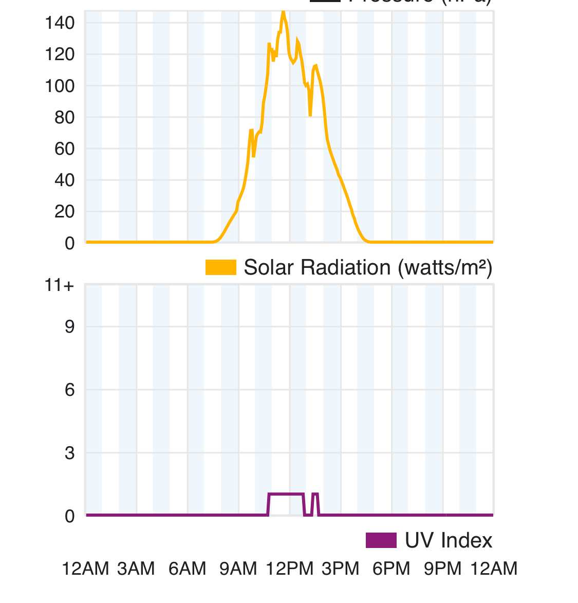

Omnibuswoman Posted December 4, 2024 Author Share Posted December 4, 2024 the graph at the top is yesterday’s Wunderground data on w/m2, which maps quite nicely on to today’s PV graph (at a lower output level as it was overcast), and demonstrates the aberration on yesterday’s pv generation graph. I’ll keep a close eye on this and will see if there are any other odd results. Link to comment Share on other sites More sharing options...
SteamyTea Posted December 4, 2024 Share Posted December 4, 2024 2 minutes ago, Omnibuswoman said: the graph at the top is yesterday’s Wunderground data on w/m2, which maps quite nicely on to today’s PV graph Be careful, collecting and analysing data can become an illness. 1 2 Link to comment Share on other sites More sharing options...

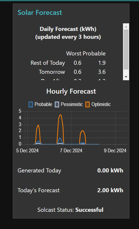

Bramco Posted December 5, 2024 Share Posted December 5, 2024 Solcast can also be useful for getting forecasts as well as I think for historical data -> https://www.solcast.com/ We use it for a dashboard done with the nodered ui tool - borrowed from another source And I know I need to fix it so the sidebar doesn't show..... 1 Link to comment Share on other sites More sharing options...
Alan Ambrose Posted December 5, 2024 Share Posted December 5, 2024 Should the focus be on the spike? Allowing for local haze, clouds etc could account for the rest, I think. Software glitch maybe? I can’t think that any physical conditions would account for a spike like that unless it was full summer but with 9/10ths heavy cloud. Link to comment Share on other sites More sharing options...

Omnibuswoman Posted December 5, 2024 Author Share Posted December 5, 2024 46 minutes ago, Alan Ambrose said: Should the focus be on the spike? Allowing for local haze, clouds etc could account for the rest, I think. Software glitch maybe? I can’t think that any physical conditions would account for a spike like that unless it was full summer but with 9/10ths heavy cloud. My suspicion is that the spike is what the generation should have been at that time, as the sky was (unusually) perfectly clear. However I will continue to monitor the generation data and if there are any more aberrations I will investigate further. I’ve already sent the info to the installer and asked for their view, but haven’t heard back as yet. Link to comment Share on other sites More sharing options...
