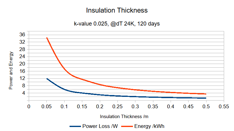

30 minutes ago, Jilly said:
Ask @SteamyTea, you need a lot more insulation than you think for ufh to be efficient.
If you assume, that during the heating season, that the ground temperature is at 8°C, and your UFH flow temperature is at 32°C, then that is a difference of 24°C.
Now if we assume that the floor insulation has a k-value of 0.025 W.m-1.K-1 and the heating season is 120 days (2880 hours).
Then, for each m2 of heating area you get:
So while there is diminishing returns on the insulation thickness, what has to be decided when digging, if the marginal costs.
Reducing the losses, will also reduce the heating season, but that does depend on the performance of the rest of the building as well.
How much? I was thinking 100mm as minimalist with 200mm being more like it.  Hence careing about total thickness of concrete and screed.
