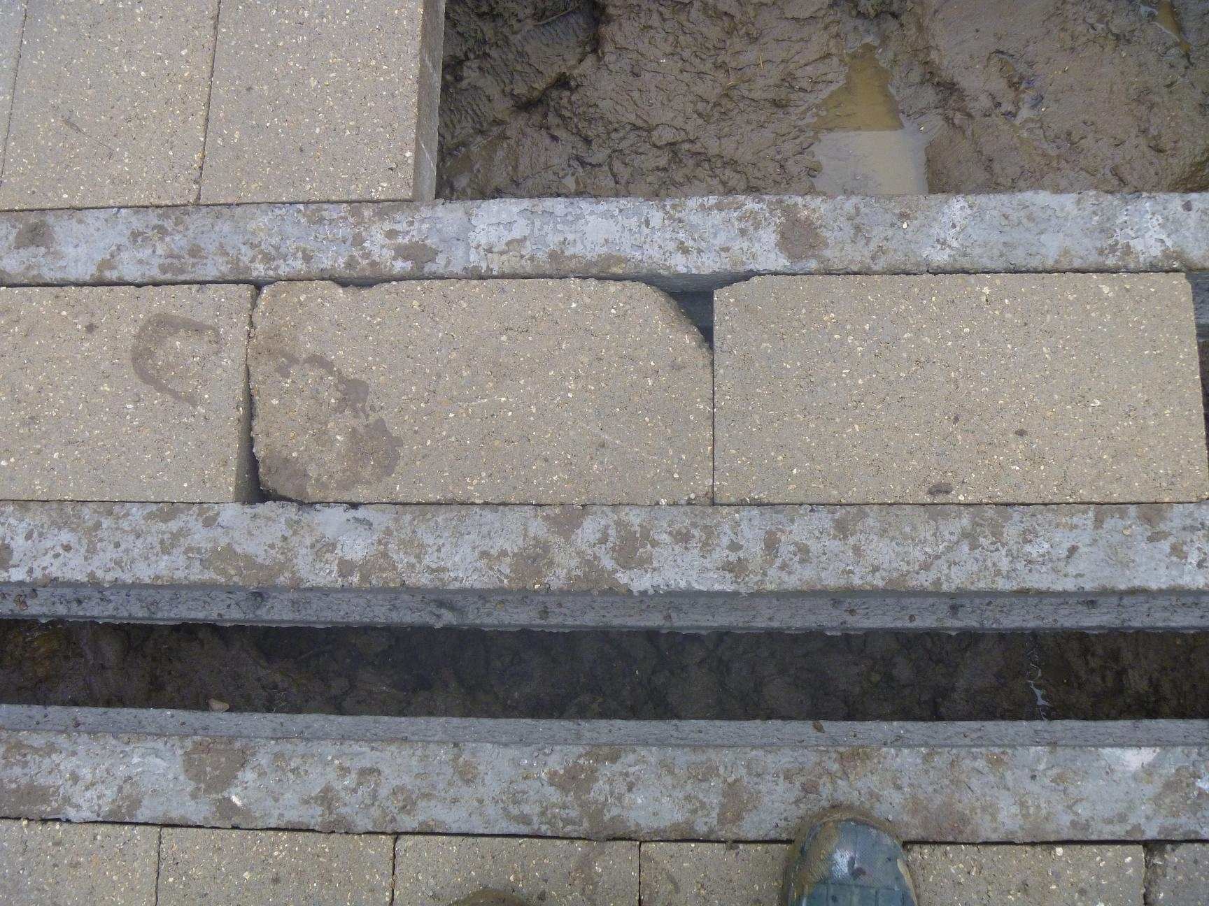

I’d just like to check that it’s normal to fit blocks with bits missing from the edges into B&B floor.
Will the builder just stick some mortar into these?  If so, will it matter if the mortar slops down to form a bridge to the wet ground, about 250mm below the beams?
Once the B&B floor is done, it will likely be many months before we start building the walls.  Should I tell the builder to just leave the holes, in case his weak mix (relative to concrete blocks) deteriorates through the winter, & we can fill the holes when we’re ready to build up the floor?
How will the small rectangular holes by the sleeper wall be filled?

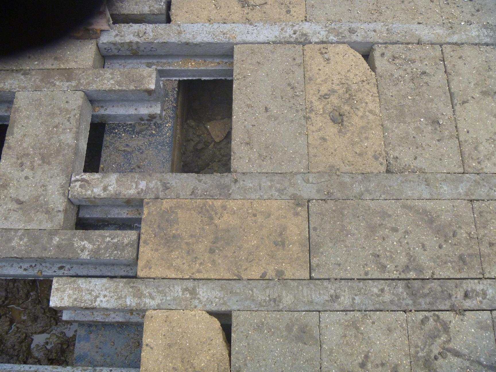

How will the gap between the beams in the picture below be dealt with?  Will the builder cut concrete blocks in half lengthways?
I have a feeling I’m over thinking this, but I work on the principal that even if you’re 99% sure, if you’ve time to ask someone who knows, you should ask.
& sorry for all the questions.  I will, of course, be asking the builder, but based on his performance over the past month, I think it’s as well to try to learn as much as I can here, because I don’t trust him to always offer me the best possible solution, or even do what he told me he was going to do the day before.

Request them to remove them and use them as cuts if possible.
They're shouldn't be blocks with large sections missing they should be whole and in good condition

If your builder thinks having blocks like that in there is acceptable then I’d be concerned about how many other corners will be cut during the build!
as above, they need to be replaced.

Yes he will cut the block to fit the smaller spaces
Its normal use up the chipped or damaged blocks for the cuts Looks like he’s already used these
The blocks he’s using look like leftovers from the foundations
The blocks should be clean and straight off the pack 2AAE4526-E807-42EC-B15B-A00AA33CEBE2.thumb.jpeg.2652ab32d747df61b8a2bf519f625ba1.jpeg

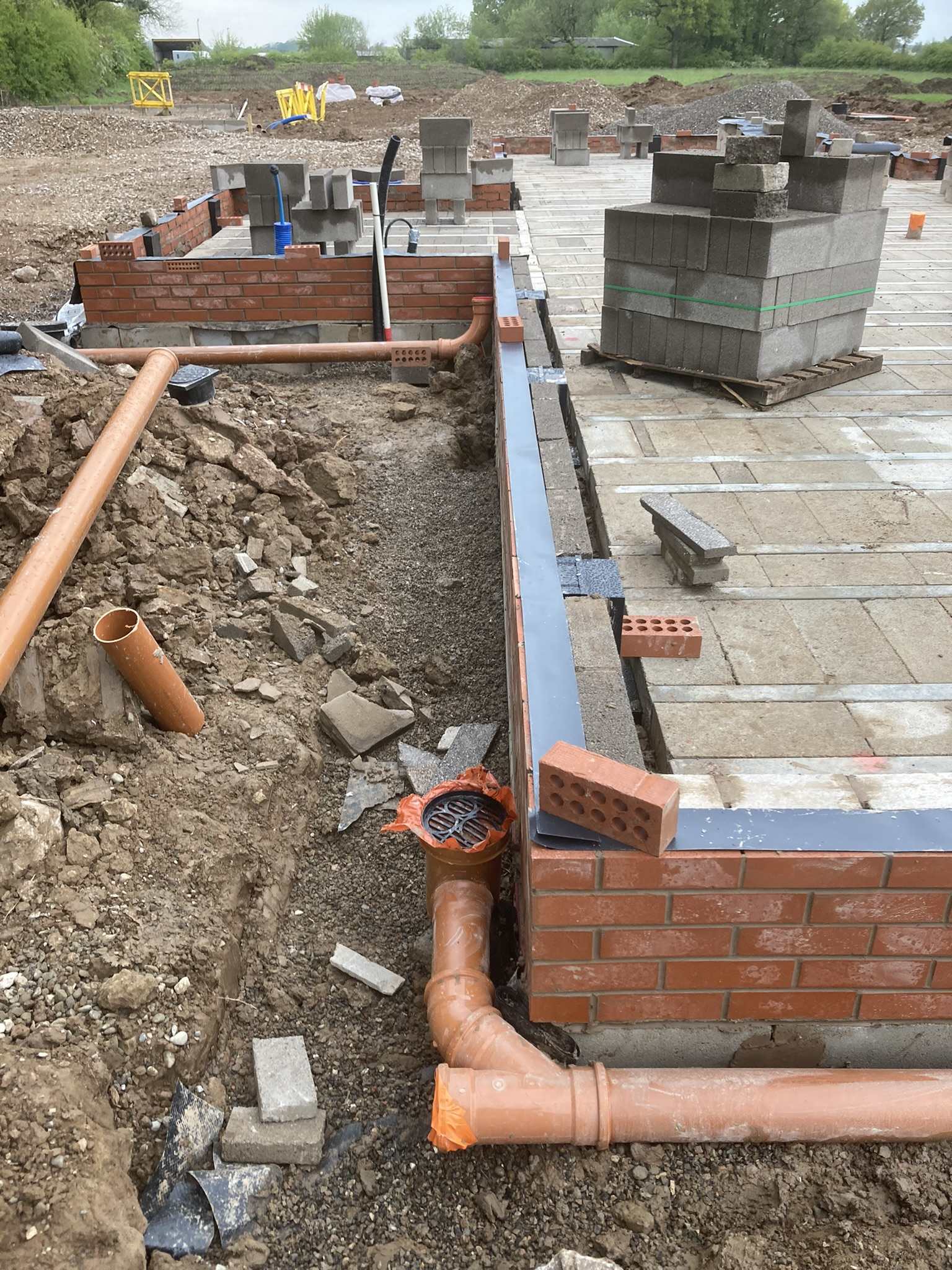

6 hours ago, saveasteading said:
The drains are interesting.
The picture with the drains isn't my site, sadly - it's a picture @nod put up to show me what my B&B should look like.  Thanks, Nod.
Posted
OK so it won't be left like that.
Also, note how Nod's cut blocks are not at the perimeter, but one block in. That's good but uncommon.
