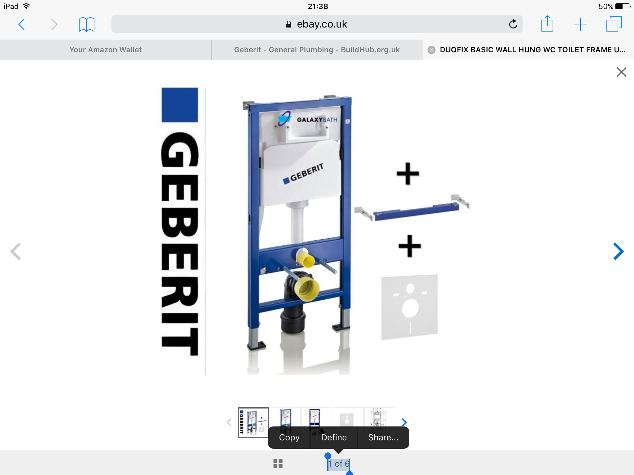

nod Posted November 18, 2017 Posted November 18, 2017 Just about to purchase four Geberit frames a systems the vary quite a bit in price duofix Sigma is there much difference between them Apart from price
Nickfromwales Posted November 18, 2017 Posted November 18, 2017 Don't get the "basic" frames as the brackets to fix back to the wall are just bolt together metal brackets with elongated holes, quite shit tbh, instead of the better threaded arrangements with captive nuts and lock ring circlip type nuts which keep things from moving that come with the better frames. Also, I noticed the basic range have the water inlet but no thumb wheel to shut the water off during parts replacement / servicing, so the one I fitted recently ( where budget was tight, and then some ) would need the water to the house shutting off to work on it. Not the end of the world but I can't really see how anyone would want to save the few quid there tbh.
Nickfromwales Posted November 18, 2017 Posted November 18, 2017 These are the pukka captive thread, adjustable and lockable ones This image shows the slide and bolt type that are less than great.

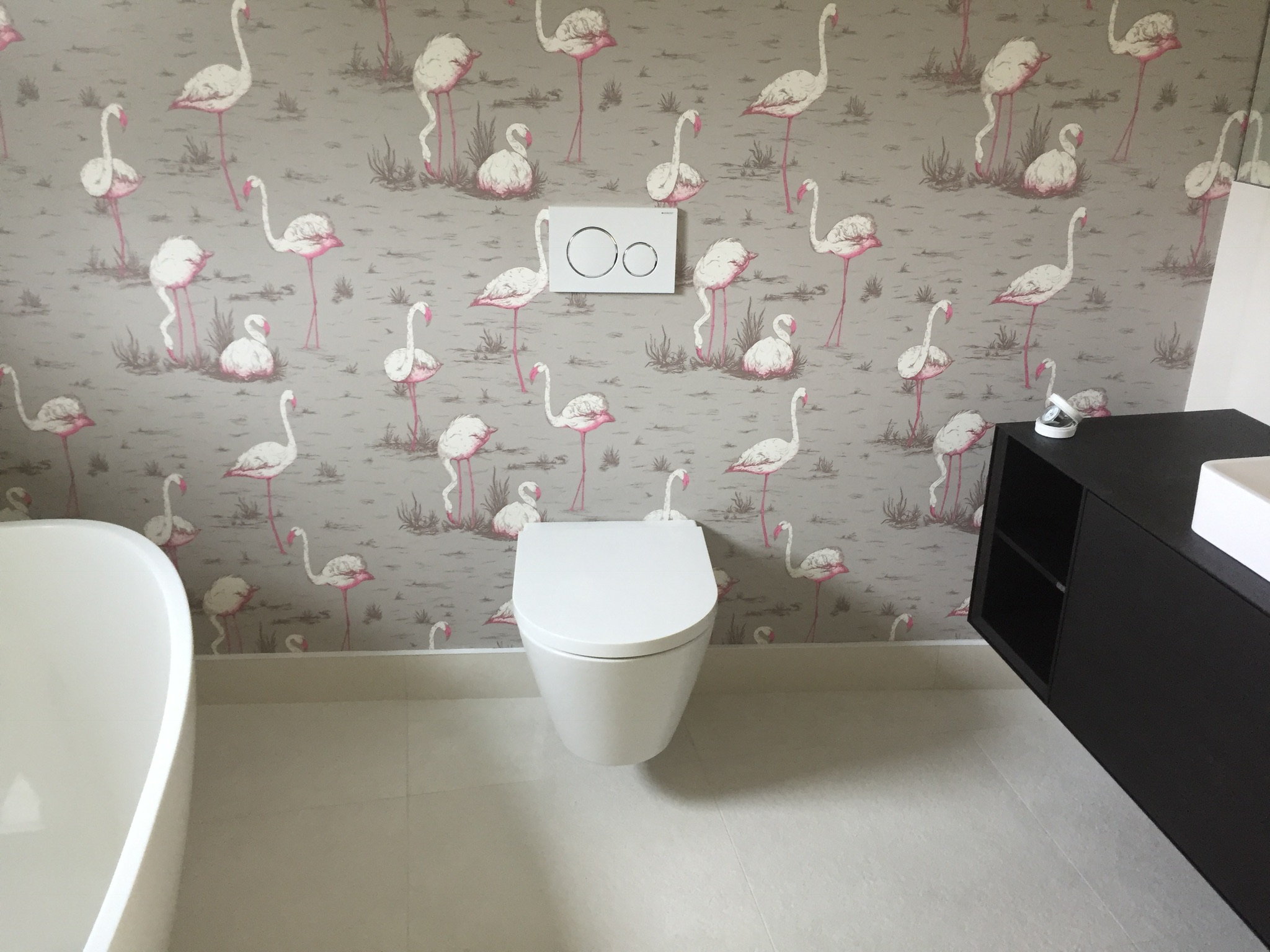

Nickfromwales Posted November 18, 2017 Posted November 18, 2017 The 820mm frames have the flush plate low, so the toilet seat lifts up and rests on it. The 1120's have the flush plate high enough for the seat to rest back against the tile / other whilst missing the plate. Pros and cons with each...... With the 820's the seat can rub on the plate if you, ahem, 'lean back' shall we say. With the 1120's, should you go with a mirror chrome finish on the plate, you can get a lovely 'reflection' of the man tackle being drained. I fitted a white plate on an 1120 frame for a customer which works quite well....
ToughButterCup Posted November 19, 2017 Posted November 19, 2017 Hmmm, don't tell me.....I know this one.... eermmmm this customer ..... she's a flamenco dancer Yes?
Nickfromwales Posted November 19, 2017 Posted November 19, 2017 11 minutes ago, recoveringacademic said: Hmmm, don't tell me.....I know this one.... eermmmm this customer ..... she's a flamenco dancer Yes? At the risk of this being read by said customer.......let me just say that I'd have part tiled that wall.......but that's with 2 boys who pee like one of those Crazy Daisy's you get for the garden . The wallpaper had 3 coats of water based matt 'varnish' so is, erm, "splashback" so to speak. . 1
