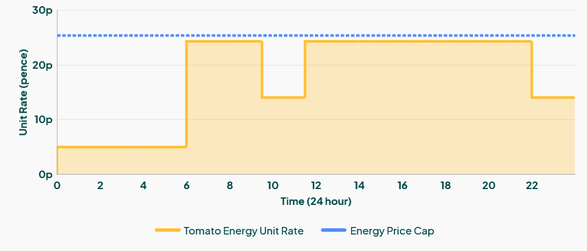

mk1_man Posted November 22 Share Posted November 22 I have been using Cosy (with batteries) and it has been great. However now looking to move over to Tomato Lifestyle. They offer midnight to 6am at 5p and then 9:30 - 11:30 at 14p also 22:00 - 23:59 at 14p, rest of the time at 23p and none of the expensive period between 16:00 and 19:00. Bonus is that the standing charge is only 44p Even without batteries this would be far cheaper than any standard tariff and if you did your hot water run in the early hours at 5p and possibly increased the temperature during this period also it could work really well. With batteries its a no brainer 🙂 2 Link to comment Share on other sites More sharing options...

Andehh Posted November 22 Share Posted November 22 3 hours ago, mk1_man said: I have been using Cosy (with batteries) and it has been great. However now looking to move over to Tomato Lifestyle. They offer midnight to 6am at 5p and then 9:30 - 11:30 at 14p also 22:00 - 23:59 at 14p, rest of the time at 23p and none of the expensive period between 16:00 and 19:00. Bonus is that the standing charge is only 44p Even without batteries this would be far cheaper than any standard tariff and if you did your hot water run in the early hours at 5p and possibly increased the temperature during this period also it could work really well. With batteries its a no brainer 🙂 That's really interesting, and could well be cheaper then octopus for ASHP usage... Esp in the winter! Link to comment Share on other sites More sharing options...

DOIGAN Posted November 23 Share Posted November 23 On 22/11/2024 at 12:00, mk1_man said: I have been using Cosy (with batteries) and it has been great. However now looking to move over to Tomato Lifestyle. They offer midnight to 6am at 5p and then 9:30 - 11:30 at 14p also 22:00 - 23:59 at 14p, rest of the time at 23p and none of the expensive period between 16:00 and 19:00. Bonus is that the standing charge is only 44p Even without batteries this would be far cheaper than any standard tariff and if you did your hot water run in the early hours at 5p and possibly increased the temperature during this period also it could work really well. With batteries its a no brainer 🙂 Just looking at Tomatoes website, looks like the Lifestyle is only from 1-6 now @ 5p, I am currently on Octopus Intelligent Go, have solar and 14kw of battery storage, is their any limits on Tomato? what is the customer service like? Octopus is great Link to comment Share on other sites More sharing options...
Thorfun Posted November 23 Share Posted November 23 Doesn’t look like Tomatoes offer an export tariff. I averaged 16.2p/kWh this month on Cosy and still managed to export £9 worth of PV. can’t see myself leaving Cosy unless something really good comes along. Link to comment Share on other sites More sharing options...

FarmerN Posted November 23 Share Posted November 23 2 hours ago, DOIGAN said: Just looking at Tomatoes website, looks like the Lifestyle is only from 1-6 now @ 5p, I am currently on Octopus Intelligent Go, have solar and 14kw of battery storage, is their any limits on Tomato? what is the customer service like? Octopus is great Still shows Midnight untill 6 IF you have an EV,but only 5 Hours at bottom rate without EV, in my quote. Really anoys me better rate if I say I have an EV. I have a charger but no EV , an EV charges here about once a month. Just don't want to basically lie, to get on best tariff. Link to comment Share on other sites More sharing options...
