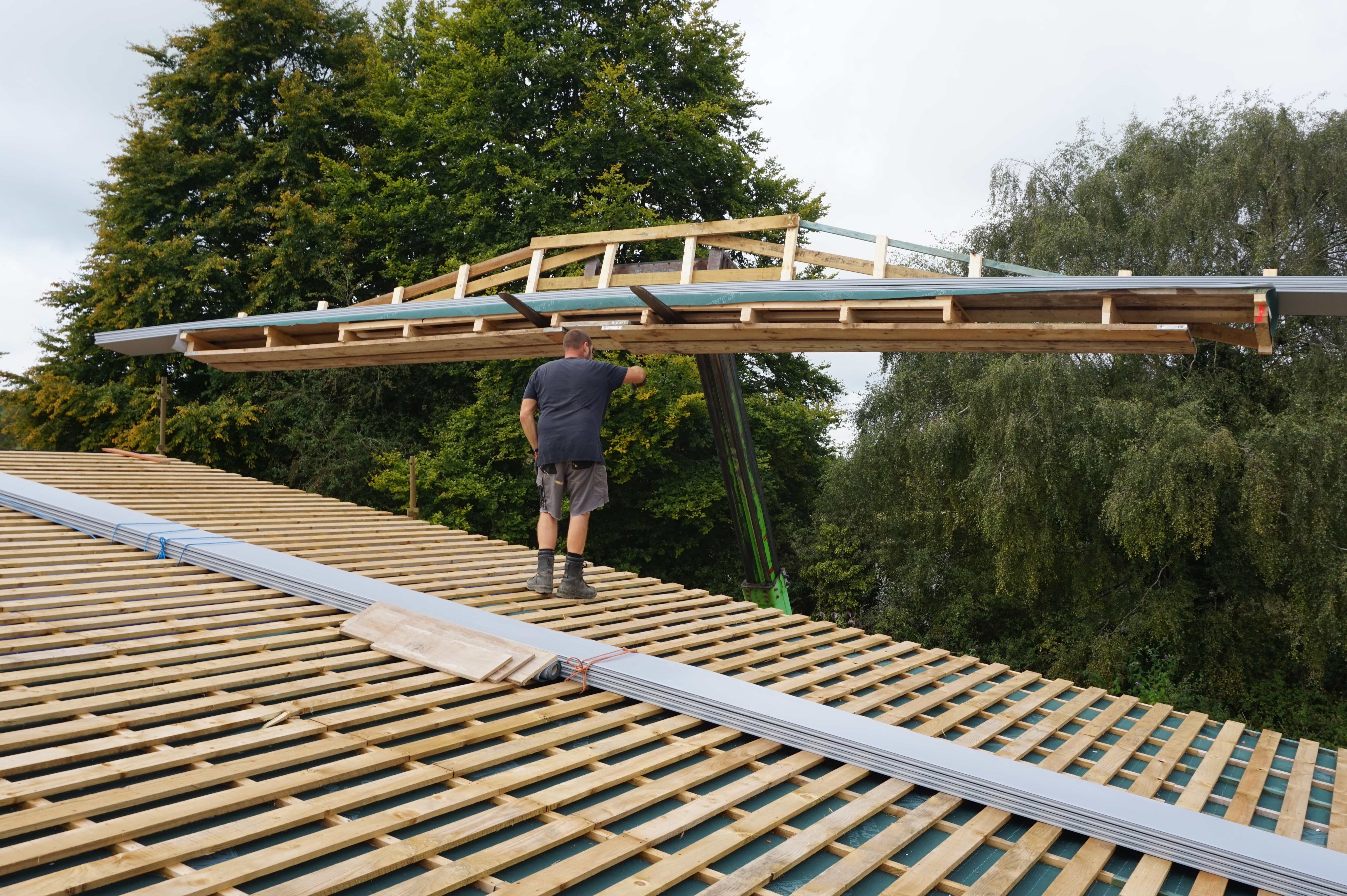

gavztheouch Posted November 17, 2024 Author Posted November 17, 2024 On 17/11/2024 at 19:54, Russell griffiths said: I did this. Expand This makes a lot of sense. Wish I had a nice simple roof with no dormers.
saveasteading Posted November 17, 2024 Posted November 17, 2024 The point of metal cladding is that it spans between supports. So you could have battens at quite a distance, according to the product. The cladding should not leak but might get condensation under it, hence this void /ventilation idea is sound. I'm not against standing seam as such, and the risk of leaks through screw fixings is removed. Why did I never use it? horrible to repair if ever a branch damages a panel etc. The flat bit is very flimsy and does not tolerate cutting for services. Why choose a no-screws product and then screw through it? Cost I gave every client the choice. In most cases they had been told it was best and not told anything else...including the cost. sarking in solid board, even osb then a breather membrane so it never gets wet battens up the slope, battens across the slope cladding. 1

saveasteading Posted November 18, 2024 Posted November 18, 2024 On 18/11/2024 at 07:43, gavztheouch said: alternative to standing seam Expand Profiled metal with screw fixings. If you choose one with the crowns at 330 ish centres and in slate grey, then it looks quite similar.
